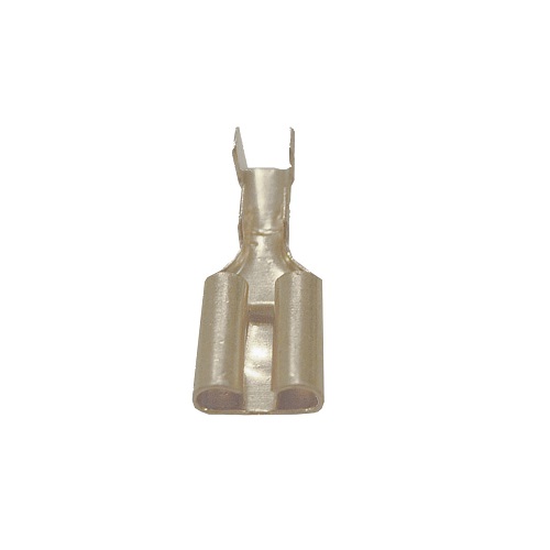

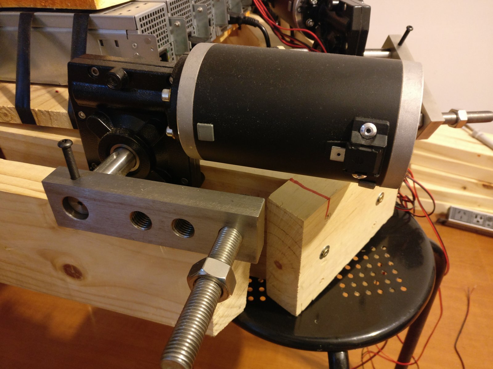

    I bought the same motor, how you connect the wire to motor?
  6. insanegr
    insanegr !N$@n€
    Jan 14, 2014
    503
    Athens
    16,722Coins
    +499 / 1 / -0
    @Racing Mike you can use this (cant remember what they are called in english:oops:)
    or you can solder a wire directly on the motor.

    I missed this question. I wondered the same and ended up just soldering 8-gauge wire directly to the motor terminals. I removed the rubber insulators from the motors and then taped over the connections with a real thick electrical tape. Use a ton of flux and preheat both.

    How's ya motors coping with heat have you had any issues ?

    So far - everything has been great with no overheating, even with me on it (180 lbs). I was hoping I wouldn't need to mount fans on the motors like you did, and so far we have been OK. I would say they are warm to the touch - but nothing more than that. I do only have PWMmax set at 150 in SMCutils because of all the documented MM issues.
