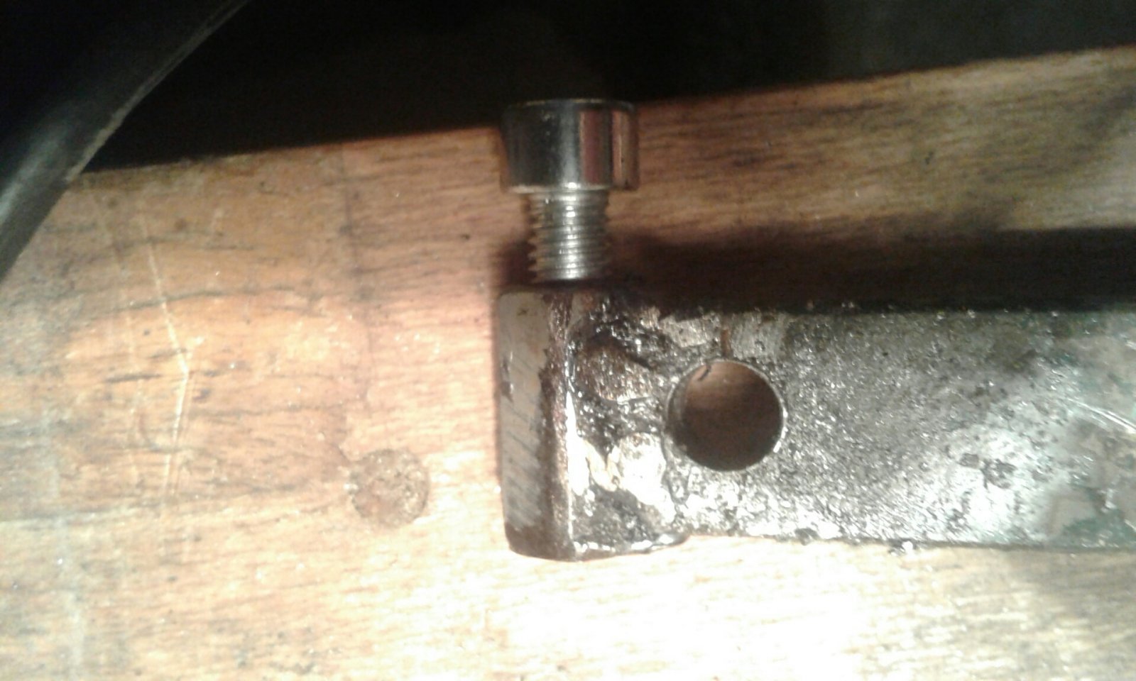

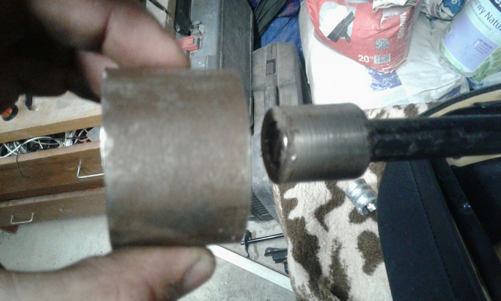

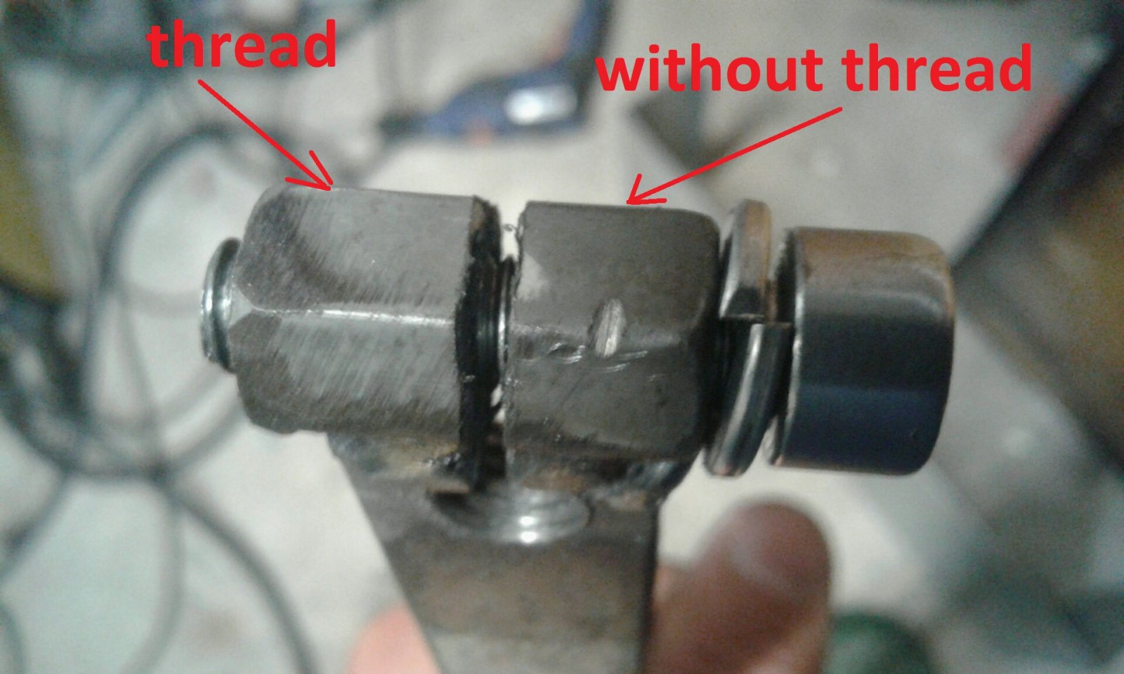

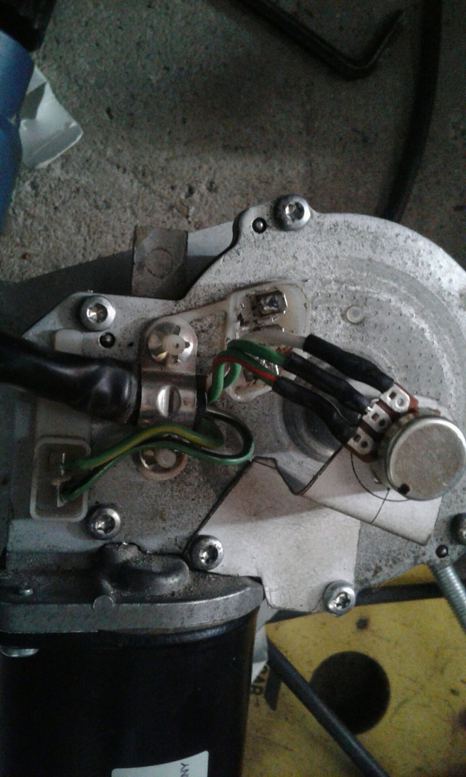

    mounting the arm to the gearbox

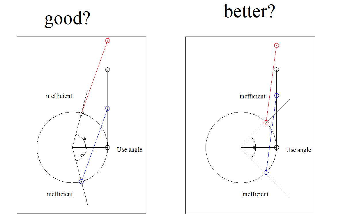

  2. tadeusz
    tadeusz New Member
    Nov 4, 2025
    34Coins
    Do I think right?
    22,049
    153,890Coins
    +11,154 / 57 / -2
    Yes, though about 80 degrees total is the more effective range for torque use.
  4. tadeusz
    tadeusz New Member
    Nov 4, 2025
    34Coins
    Today

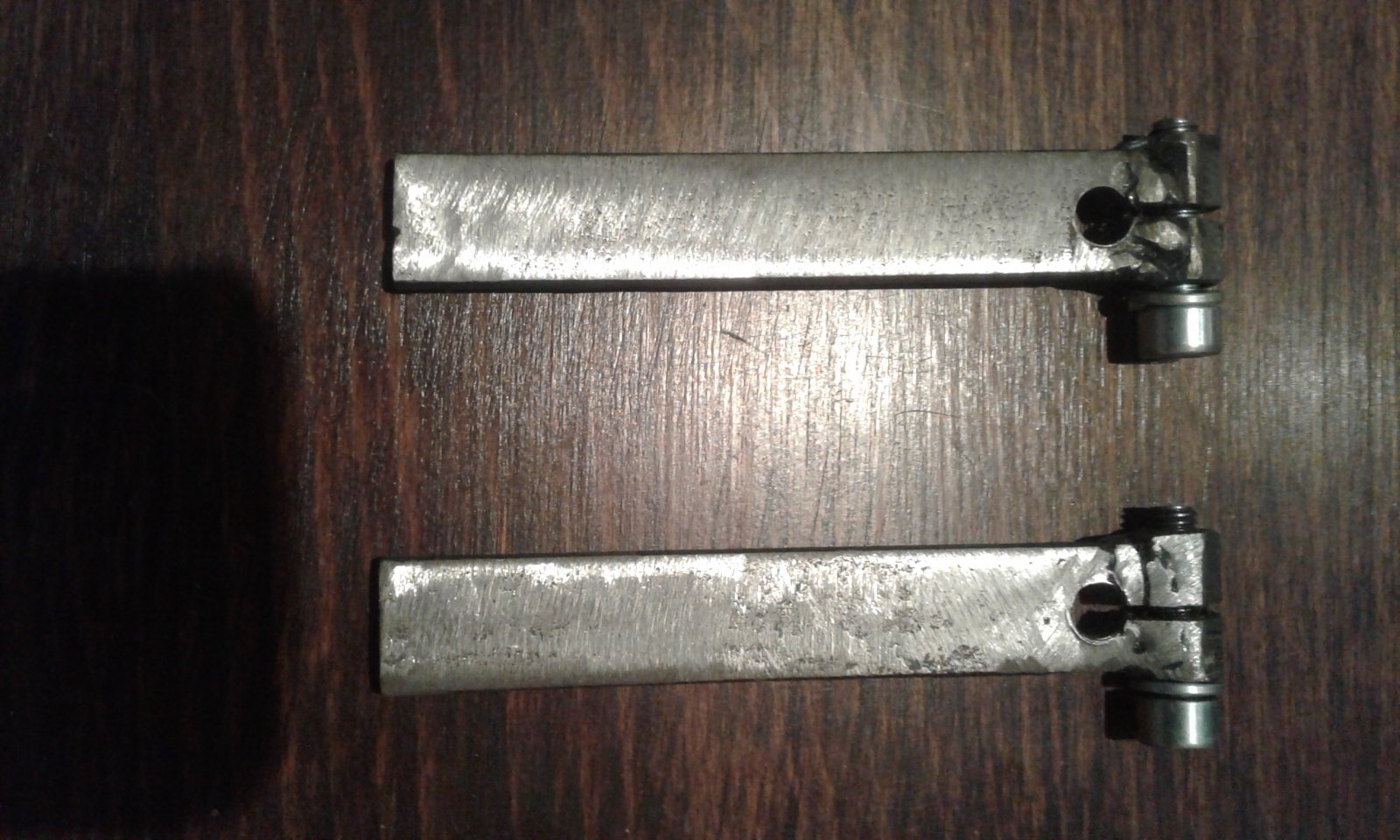

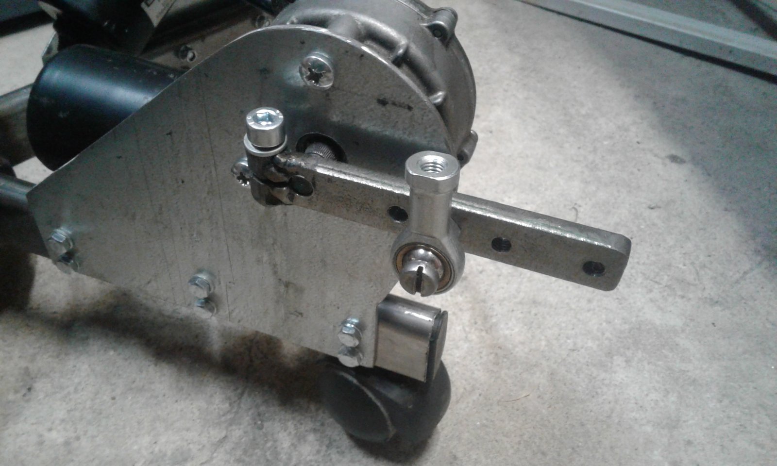

    today i made 2 arms
      File size:
      243.4 KB
      Views:
      384

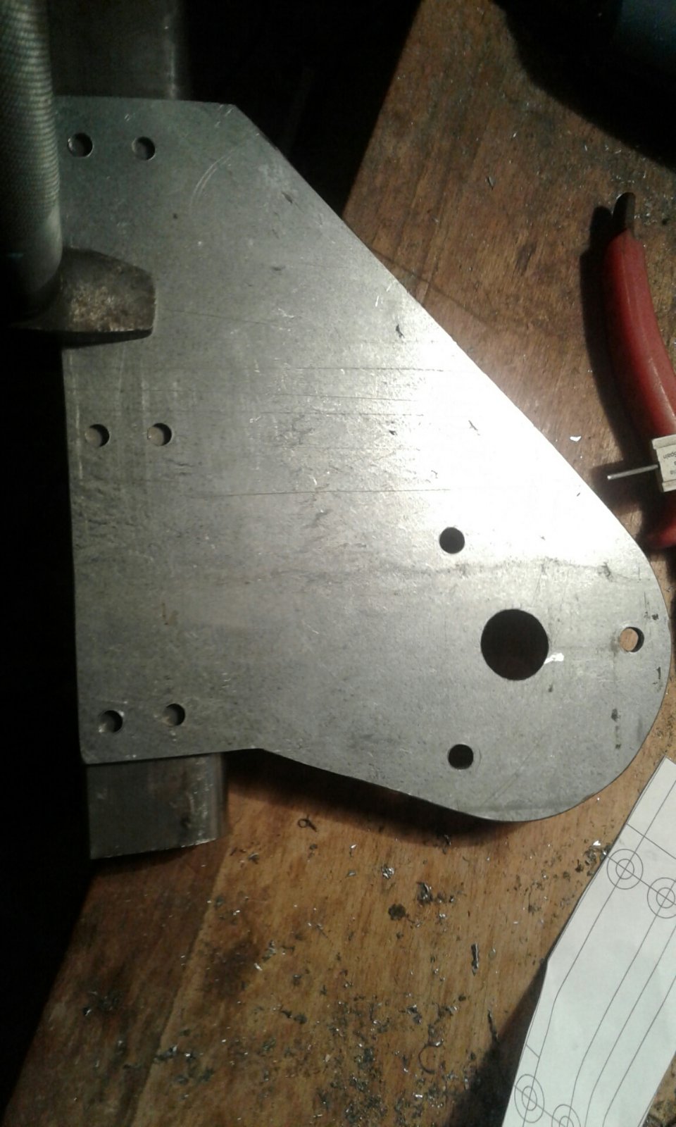

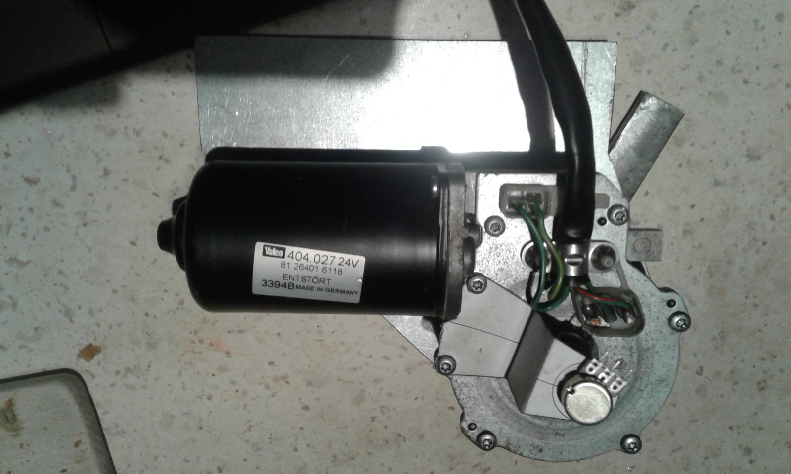

  5. tadeusz
    tadeusz New Member
    Nov 4, 2025
    34Coins
    wiper motor mount
      File size:
      174.3 KB
      Views:
      389
      File size:
      174.3 KB
      Views:
      398

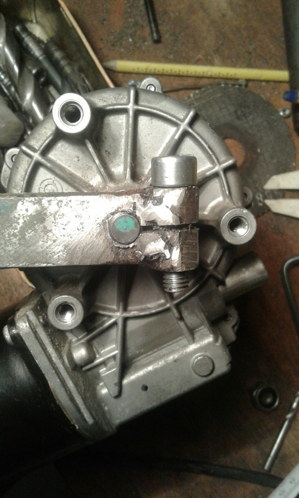

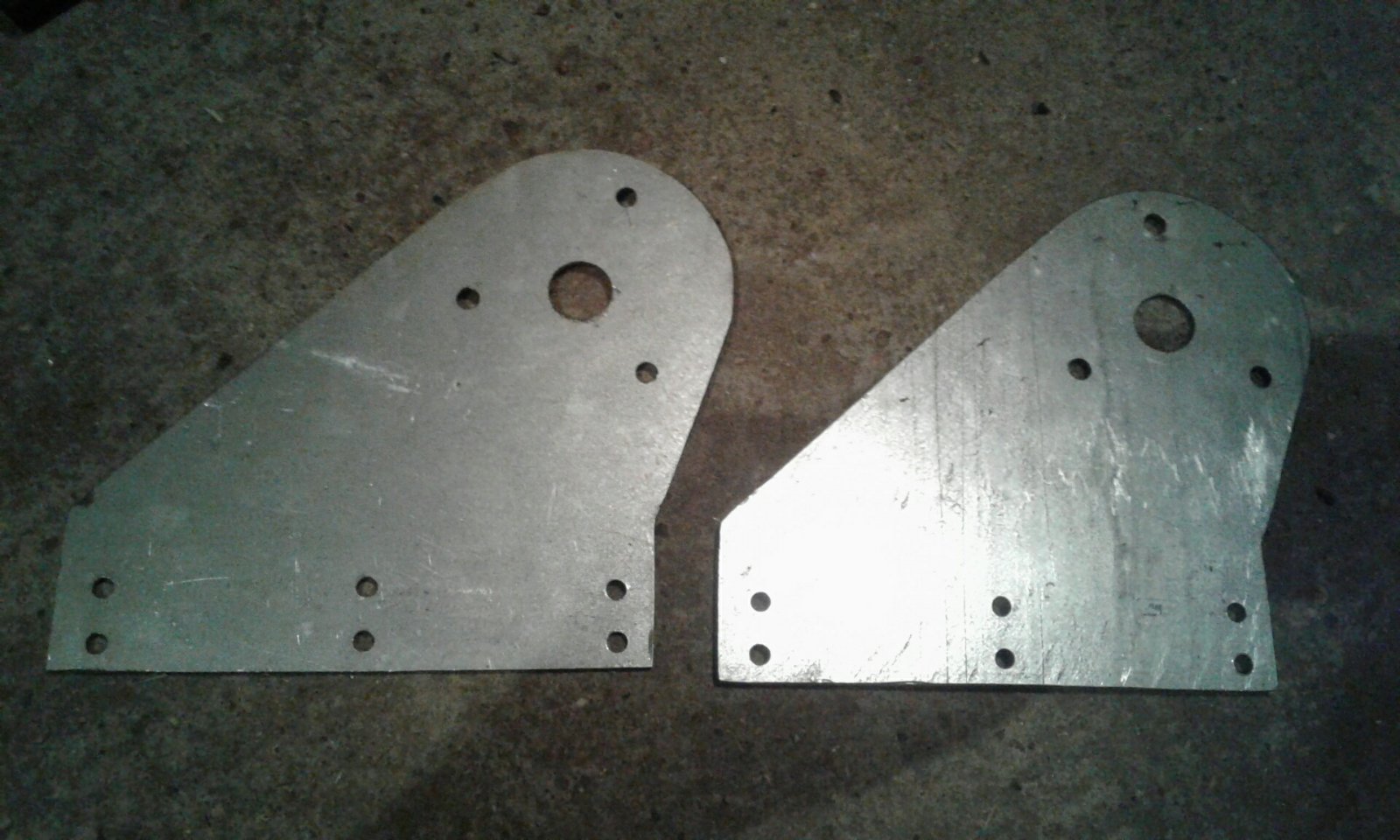

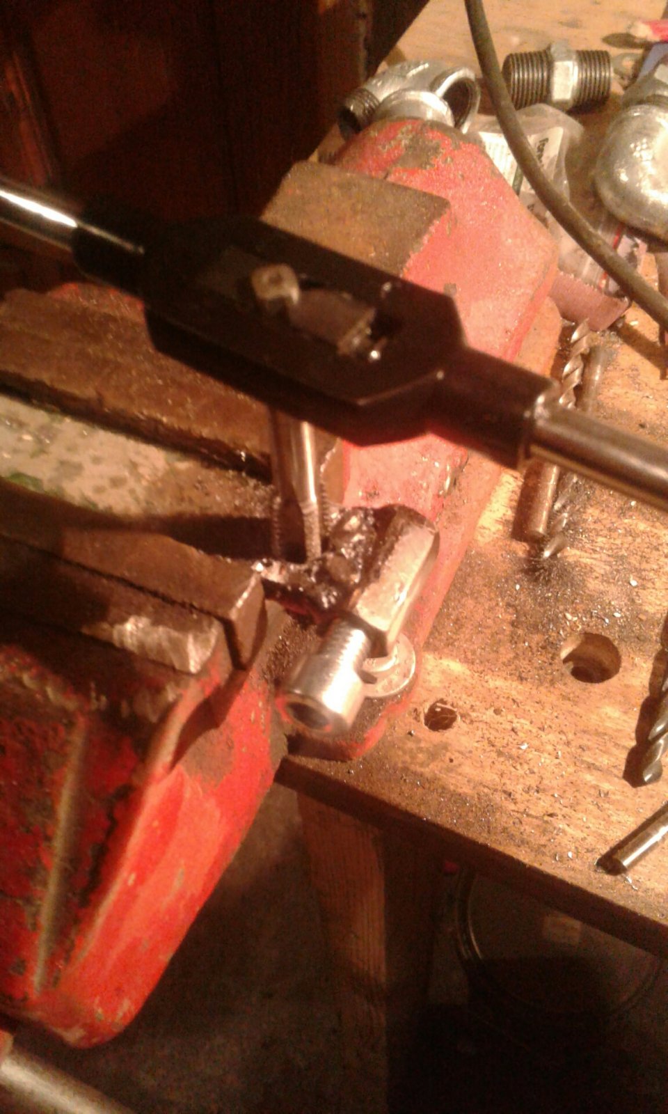

  6. tadeusz
    tadeusz New Member
    Nov 4, 2025
    34Coins
    wiper motor mount
      File size:
      216.8 KB
      Views:
      389
    22,049
    153,890Coins
    +11,154 / 57 / -2
    You can make options for the Center To Center (CTC) hole distance from the shaft to where the rod mount, but as you are using wiper motors, which are not very powerful, start small at around 40mm CTC, as the larger the CTC the faster the linear speed, but less torque. You can always increase CTC after initial testing if the motors can handle the mass being moved.
  8. tadeusz
    tadeusz New Member
    Nov 4, 2025
    34Coins
    Thank you
    for advice
    I was thinking of 3 mountings (CTCs) at the following distances
    35mm
    50mm
    75mm
    best regards
    Tadek

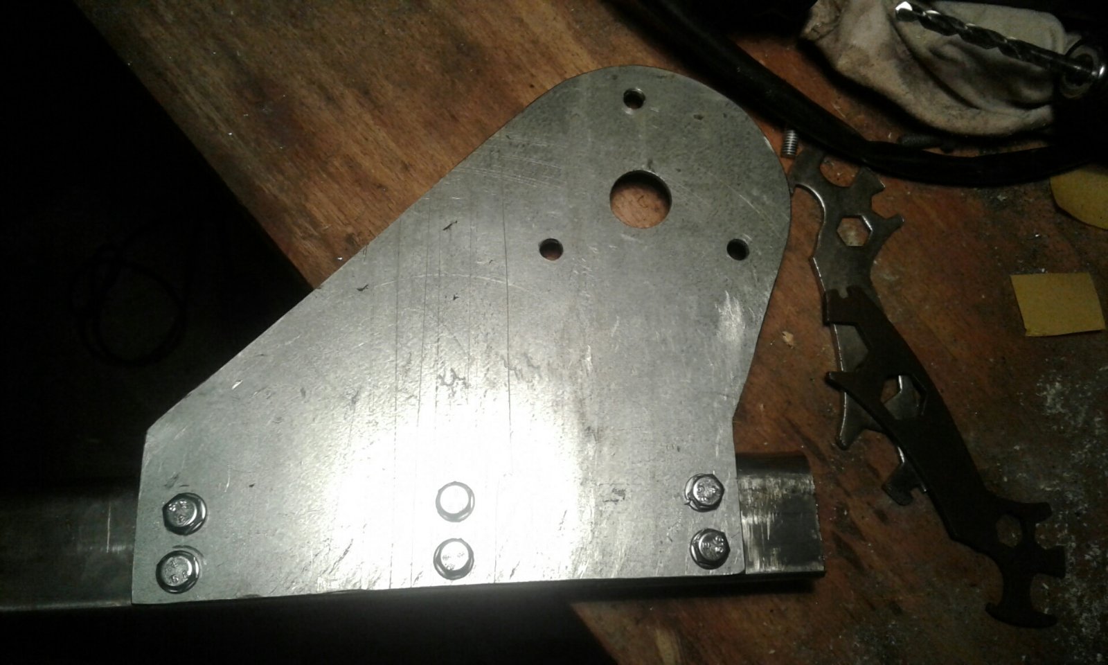

  9. tadeusz
    tadeusz New Member
    Nov 4, 2025
    34Coins

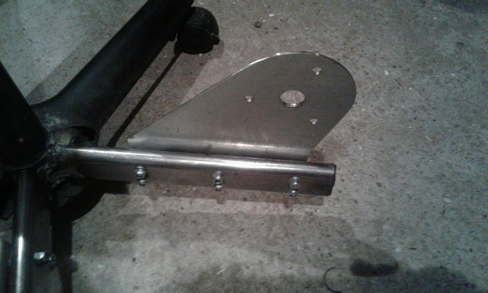

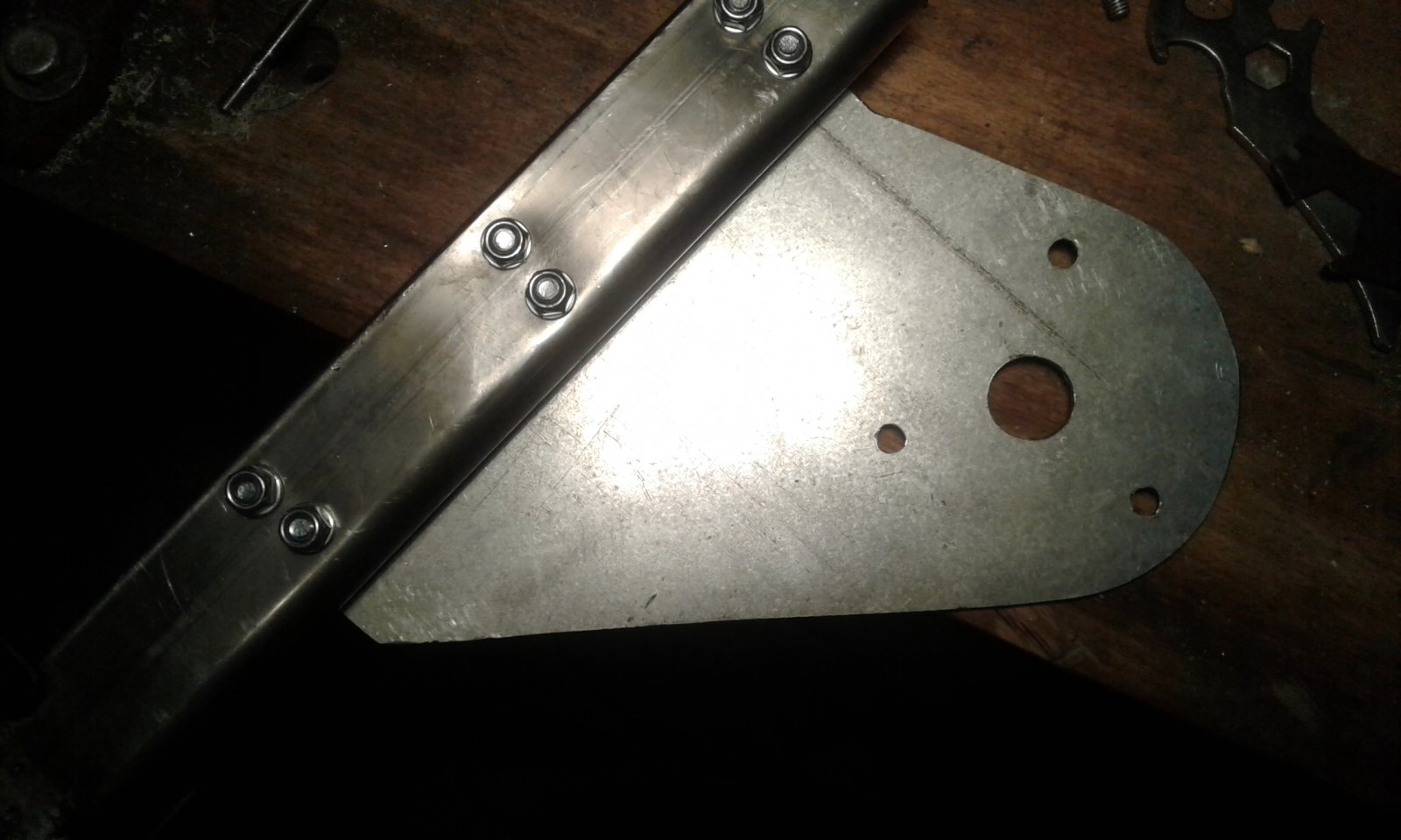

    Wiper motor mount
    differences in the holes for the engine
    3mm sheet
    6mm mounting holes
    for screws x 6
      File size:
      211.8 KB
      Views:
      392

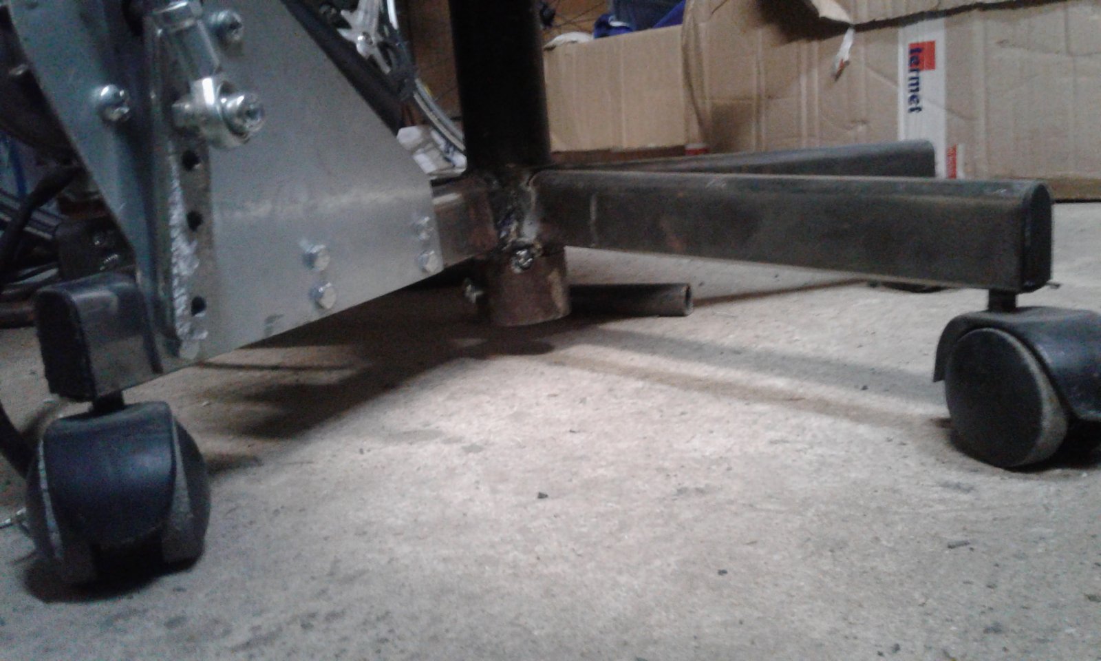

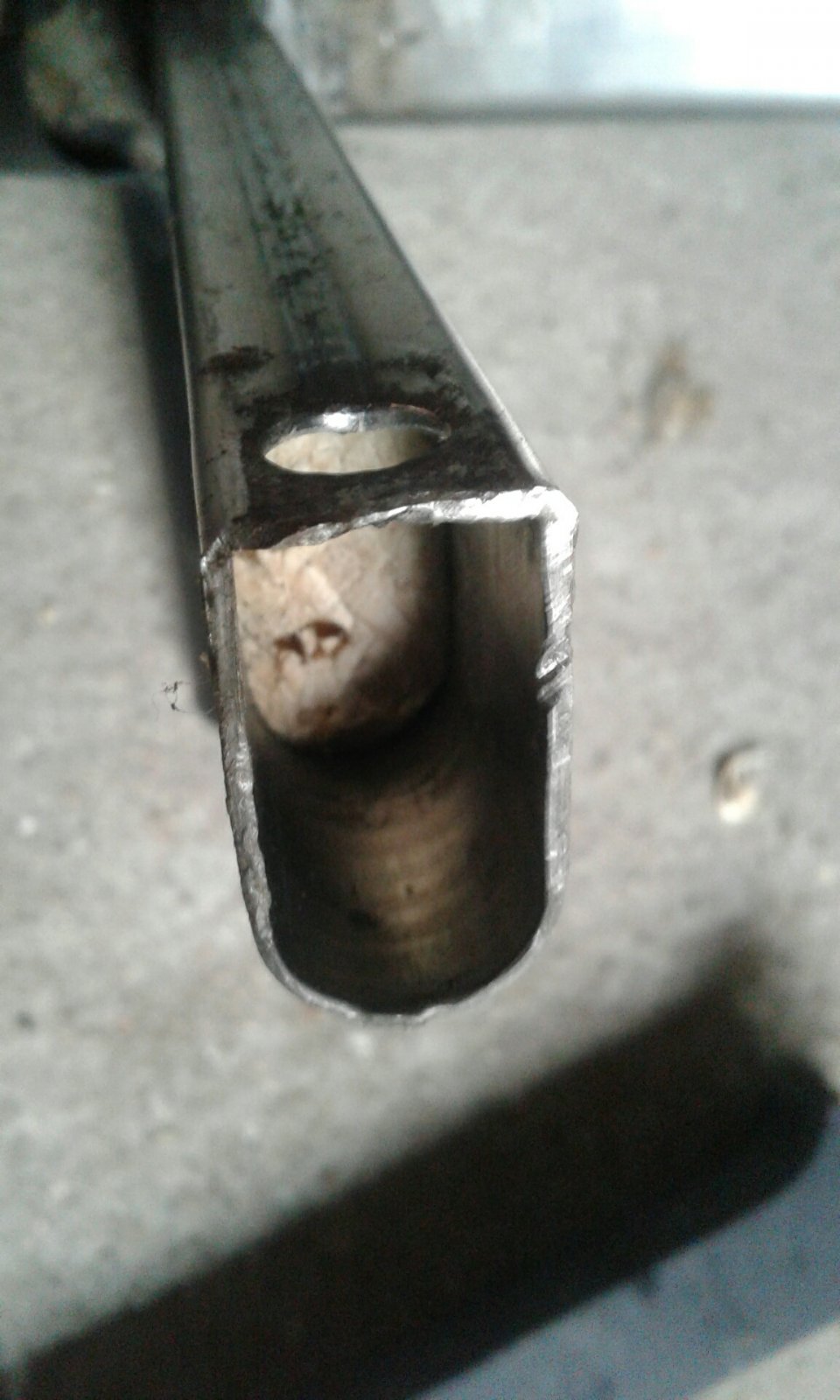

  10. tadeusz

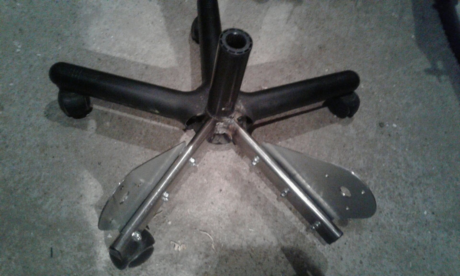

    tadeusz New Member
    Nov 4, 2025
    34Coins
    Base leg filling
      File size:
      322.6 KB
      Views:
      394
      File size:
      238 KB
      Views:
      356
      File size:
      161.9 KB
      Views:
      382
  11. tadeusz
    tadeusz New Member
    Nov 4, 2025
    34Coins
    Fastening leg holder

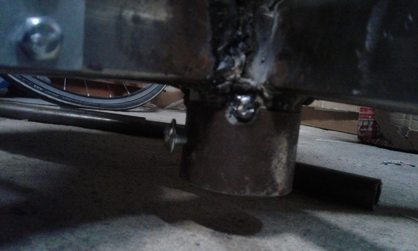

      File size:
      187.7 KB
      Views:
      376

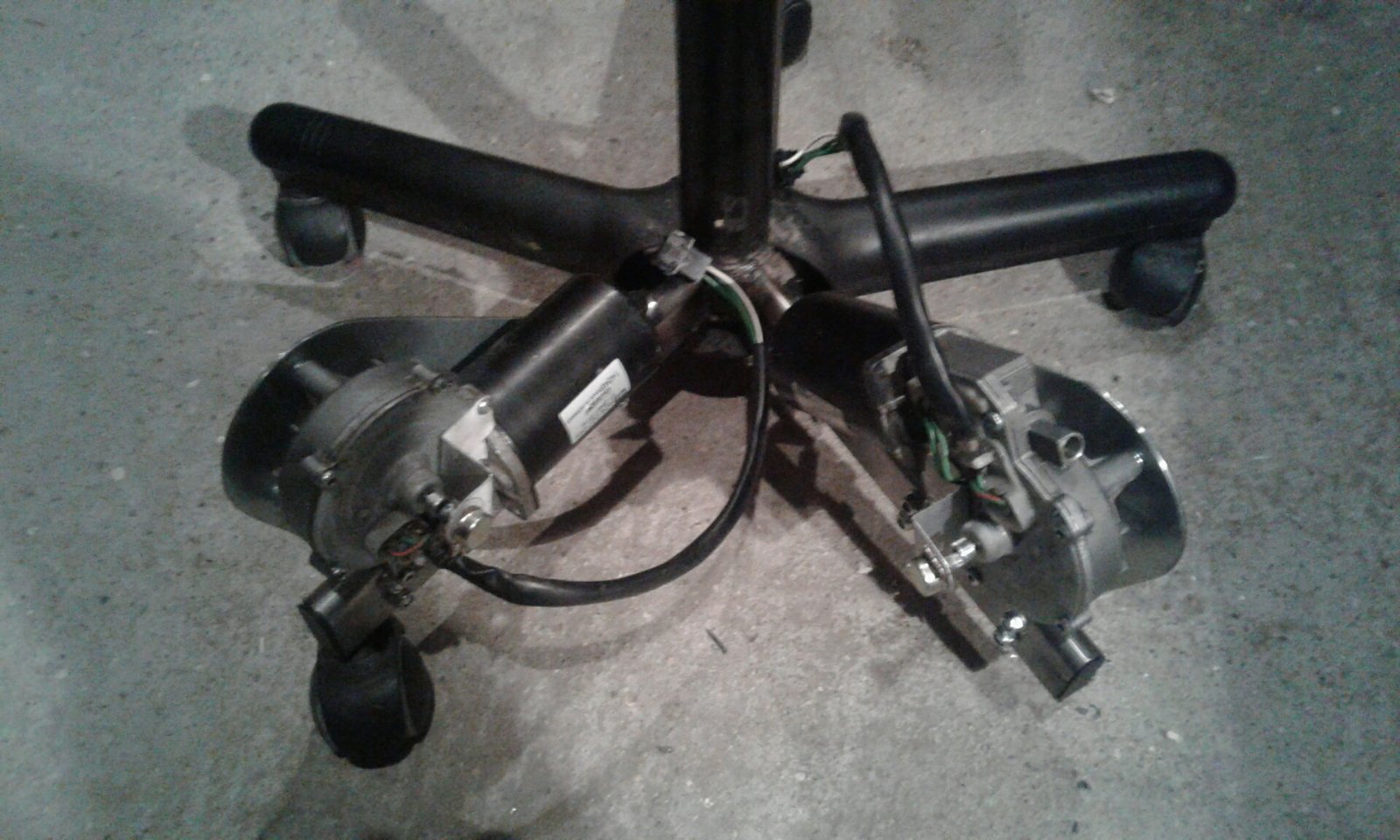

      365
  12. tadeusz
    tadeusz New Member
    Nov 4, 2025
    34Coins
    Mounting motors to mounts
      File size:
      224.3 KB
      Views:
      381

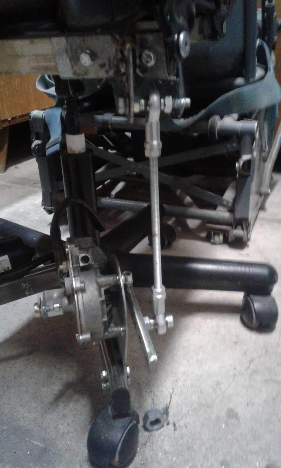

  13. tadeusz
    tadeusz New Member
    Nov 4, 2025
    34Coins

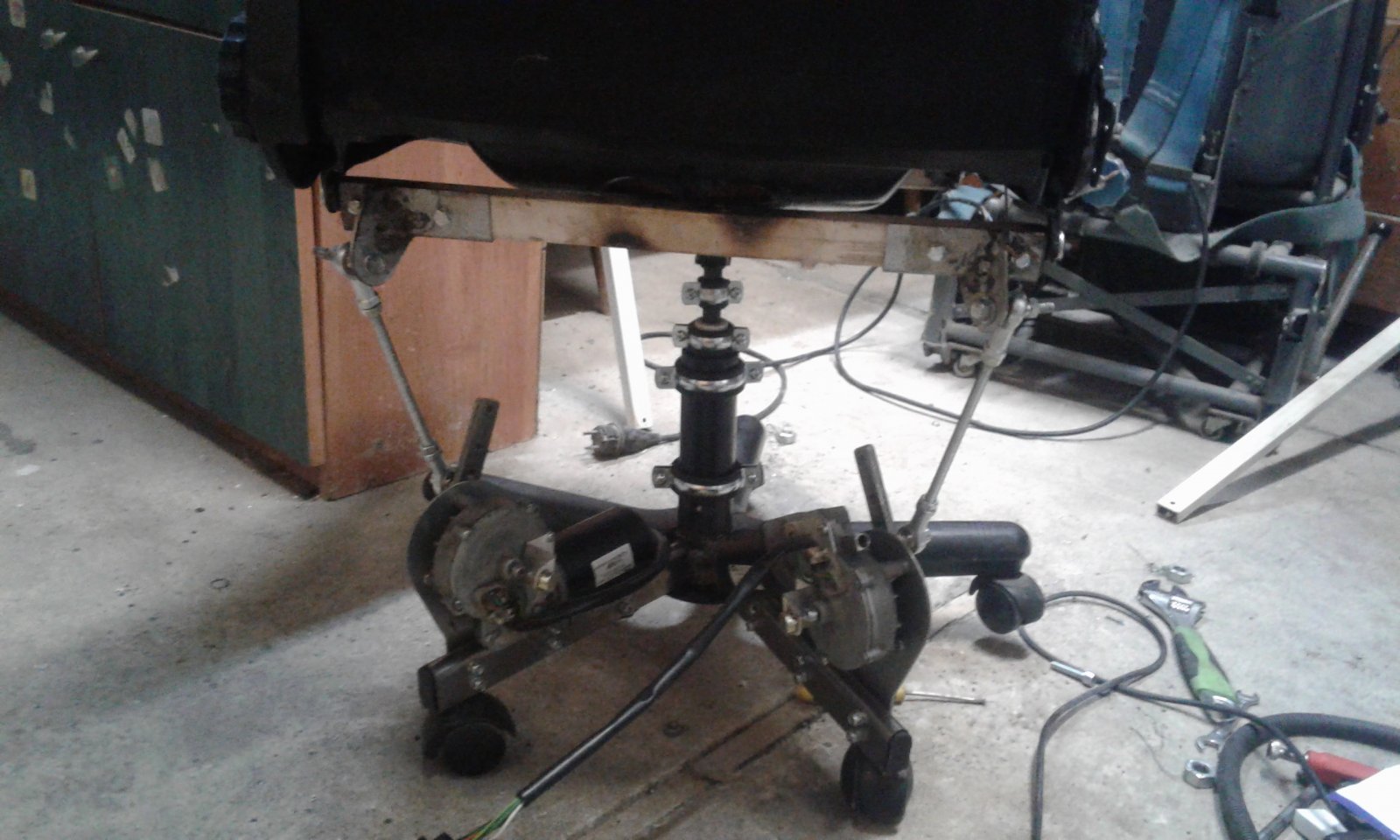

    lever with handle
  14. Lgars39
    Lgars39 Member
    Aug 13, 2015
    39
    Jura
    208Coins
    +17 / 0 / -0
    a very good idea for those who lack space!

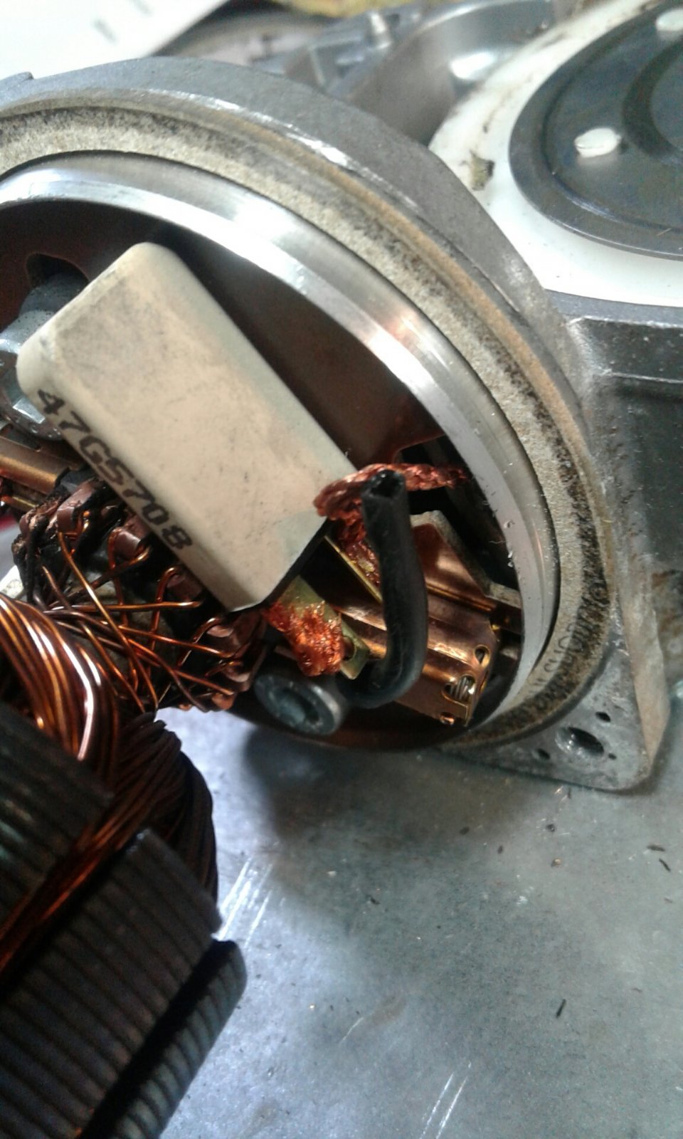

  15. tadeusz
    tadeusz New Member
    Nov 4, 2025

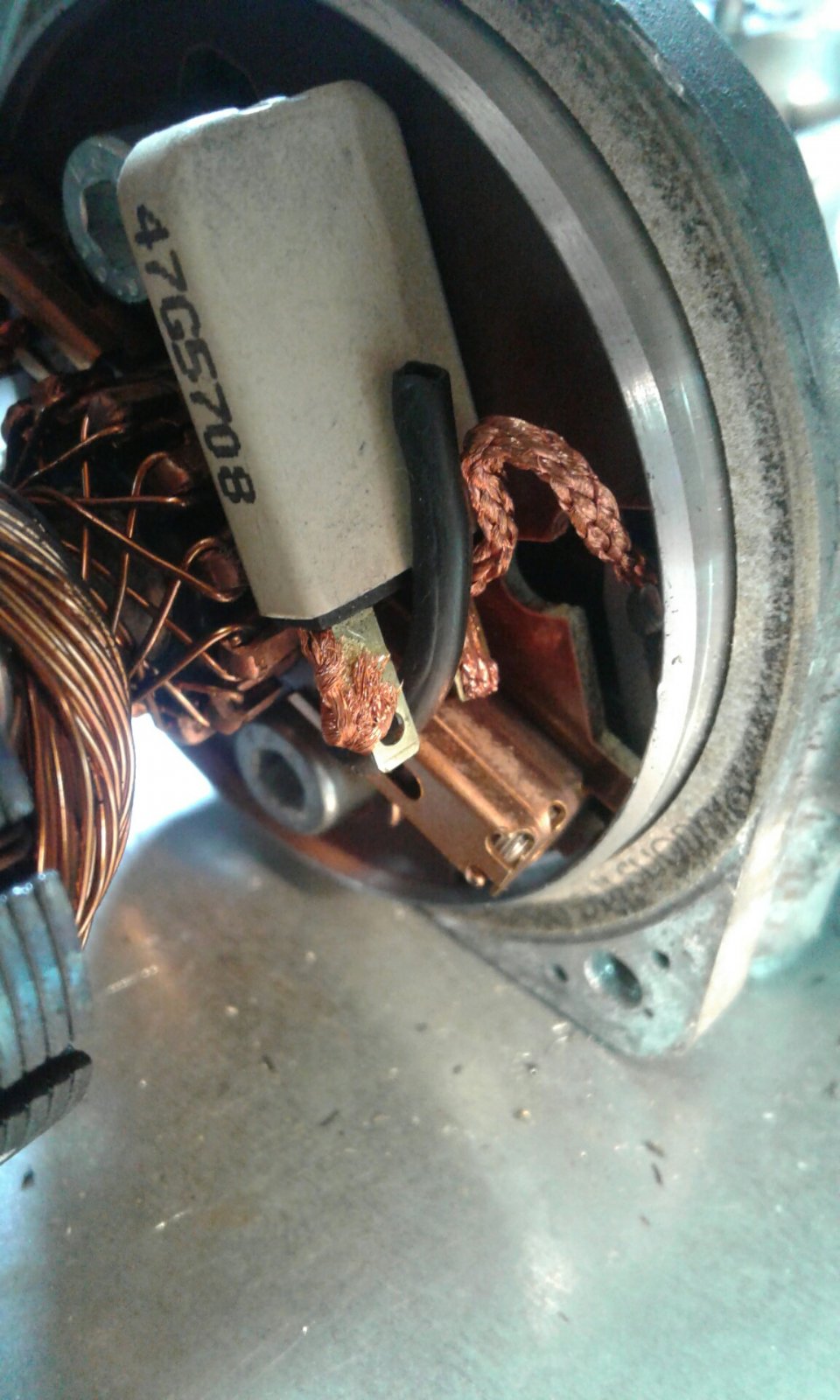

    34Coins
    Big thanks to Noorbeast :cheers

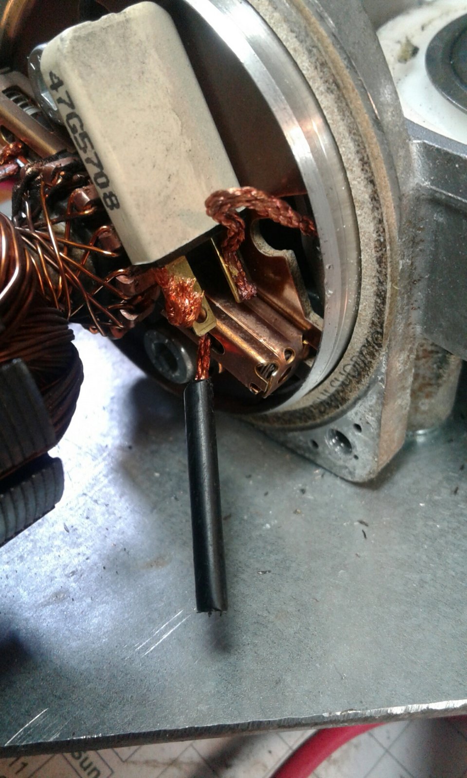

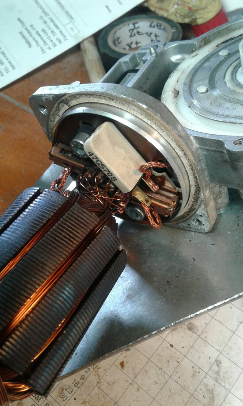

    motors ground isolation:

  18. thanh tin
    thanh tin New Member
    Aug 20, 2020
    24
    173Coins
    +7 / 0 / -0
    This idea is great, I also thought of using the seat instead of the metal frame because it is convenient
  19. tadeusz
    tadeusz New Member
    Nov 4, 2025
    34Coins
    thank you
    okay
    it will probably be much lighter
    the big problem is blocking the seat rotation
  20. tadeusz
    tadeusz New Member
    Nov 4, 2025
    34Coins
