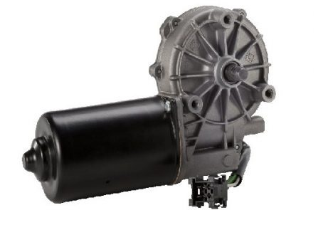

    Hi
    My first project will be small 2dof design
    budget with 2 24 v wiper motor
    Please
    Can anyone tell me where to find its characteristics ? :sos
    Wiper motor VALEO 404.027 24v MAN L 2000 (3 wiper)
    link:
    https://hansa-export.de/en/shop/swf-404027-wiper-motor-sw2l/
    paramets:
    Current
    24V DC
    Torque
    50 Nm
    Bolt circle
    72 Nm
    Model series
    SW2L
    Gear position
    LH
    EMV suppression

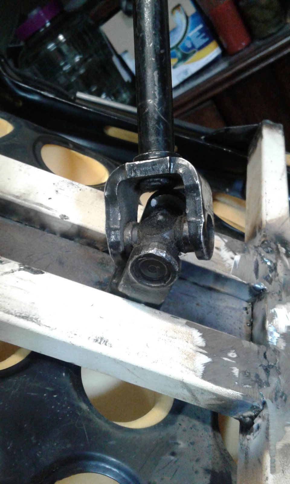

    tadeusz New Member
    Nov 4, 2025
    28Coins
    Steering stick from unknown car will be main joint.

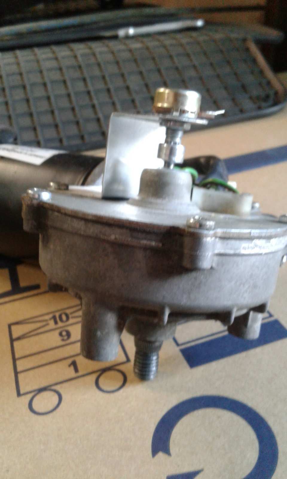

    Pot 10Kom is in Imbus fi 4mm

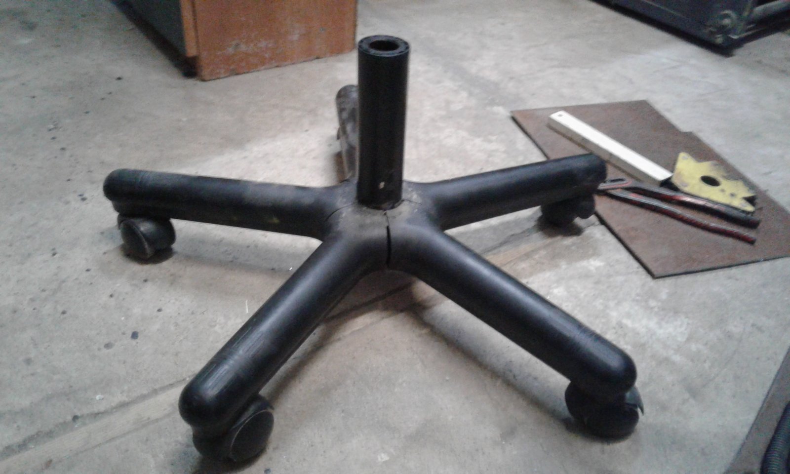

    Stand from office seat

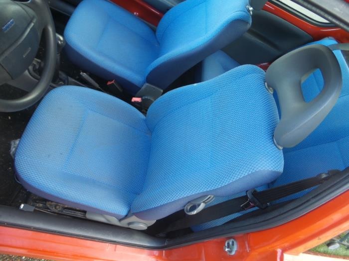

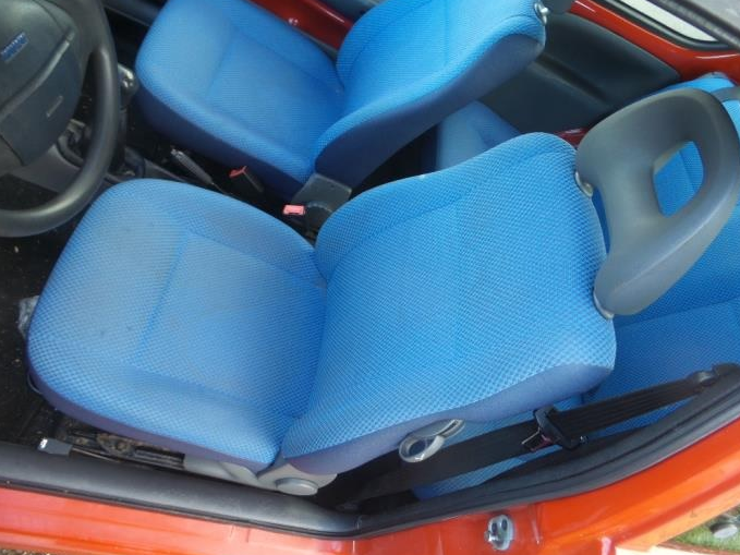

  10. tadeusz
    tadeusz New Member
    Nov 4, 2025
    28Coins

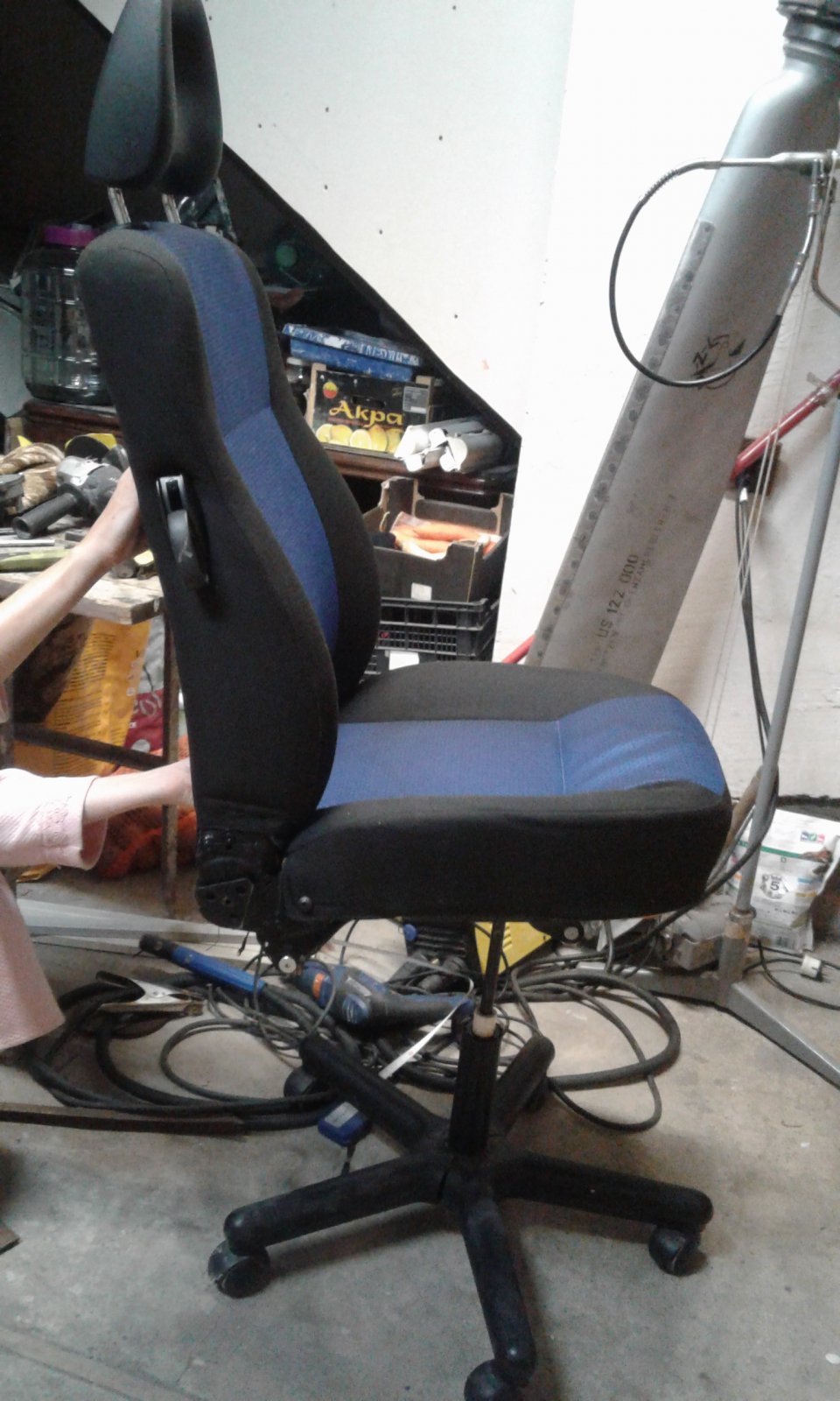

    seat from seicento
  11. thanh tin
    thanh tin New Member
    Aug 20, 2020
    24
    173Coins
    +7 / 0 / -0
    great, I can't wait to see your project
  12. thanh tin
    Aug 20, 2020
    24
    173Coins
    +7 / 0 / -0
    the seats are a bit heavy
  13. tadeusz
    tadeusz New Member
    Nov 4, 2025
    28Coins
    it look too light?
    special Steering stick?
  14. tadeusz
    tadeusz New Member
    Nov 4, 2025
    28Coins

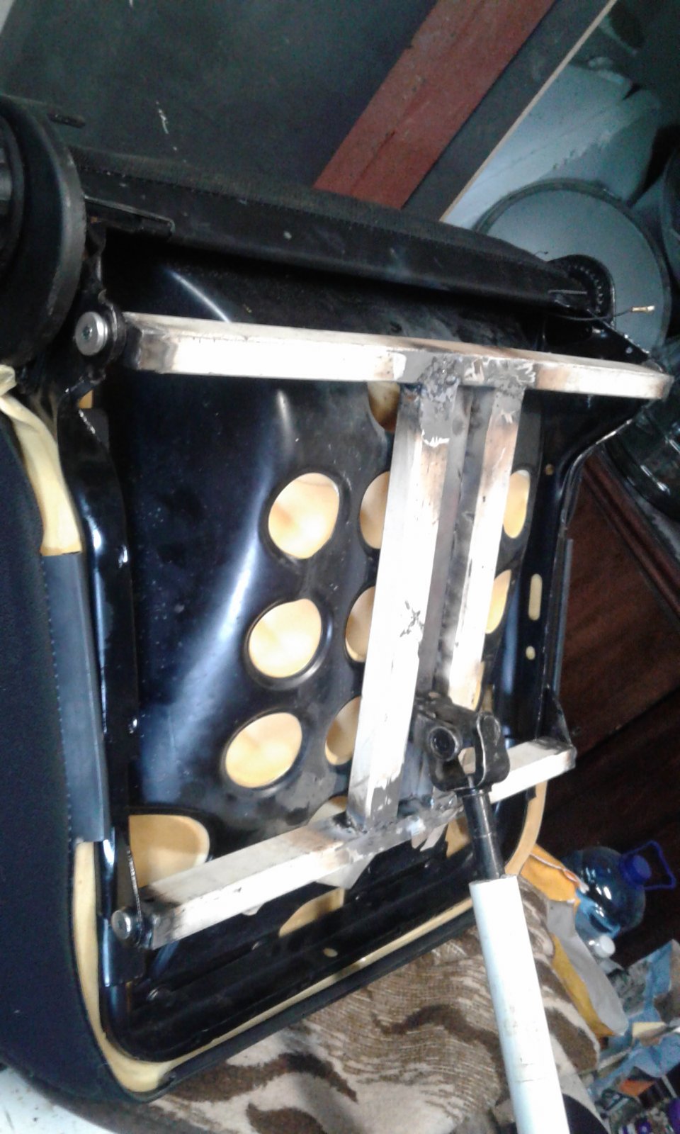

  15. tadeusz
    tadeusz New Member
    Nov 4, 2025
    28Coins
    I unmounted all the metal monsters
    to be not hevy
  16. tadeusz
    tadeusz New Member
    Nov 4, 2025
    28Coins

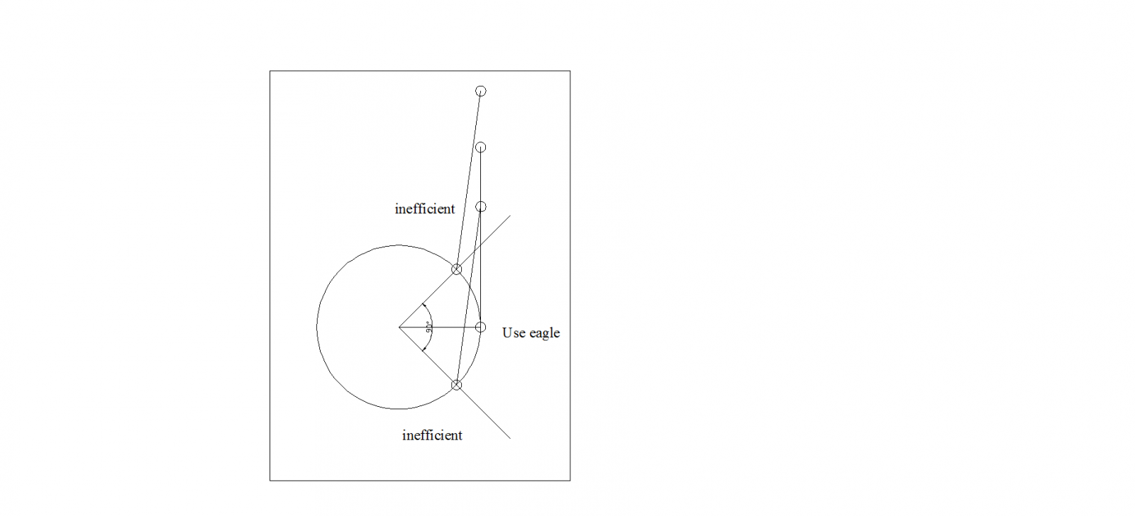

    please give mi a hint :think
    What is real angle of the leaver?
    I think 180 degrees is too much ?
    Thanks for help:sos
  17. noorbeast
    21,895
    153,001Coins
    +11,116 / 56 / -2
    A lever provides maximum torque when parallel to the seat with the rod at 90 degrees anything over 38-40 degrees up or down from there is very inefficient use of torque.
  18. tadeusz
    tadeusz New Member
    Nov 4, 2025
    28Coins
    thank's
    It mins that i can use angle of 90 degress ?
  19. tadeusz
    tadeusz New Member
    Nov 4, 2025
    28Coins
    m=r x f sin(fi)
  20. noorbeast
    21,895
    153,001Coins
    +11,116 / 56 / -2
    Closer to 75-80 degrees total is about the max range before torque efficiency drops dramatically, which just results in unnecessary strain on the motors.
