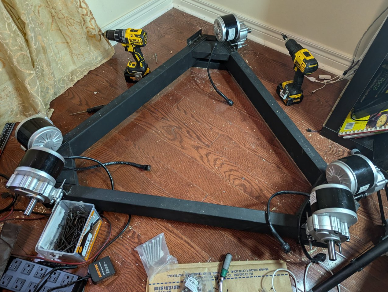

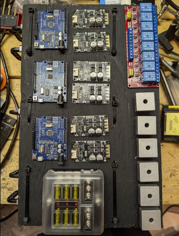

    Now that the metal brackets are ready, I have attached 5 of 6 motors to the base. I need to take the last motor with me to a friend for fabricating the motor arms

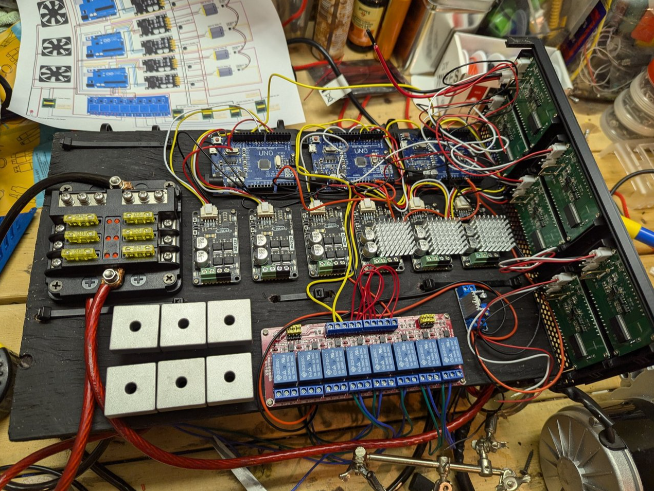

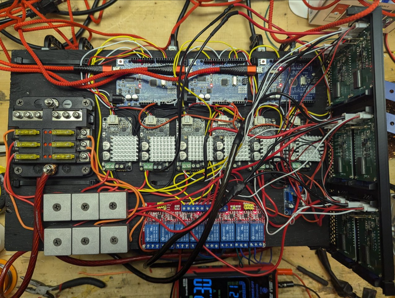

    Next, the Electronics Control Box. Planning the layout:
    Soldering and connecting components:

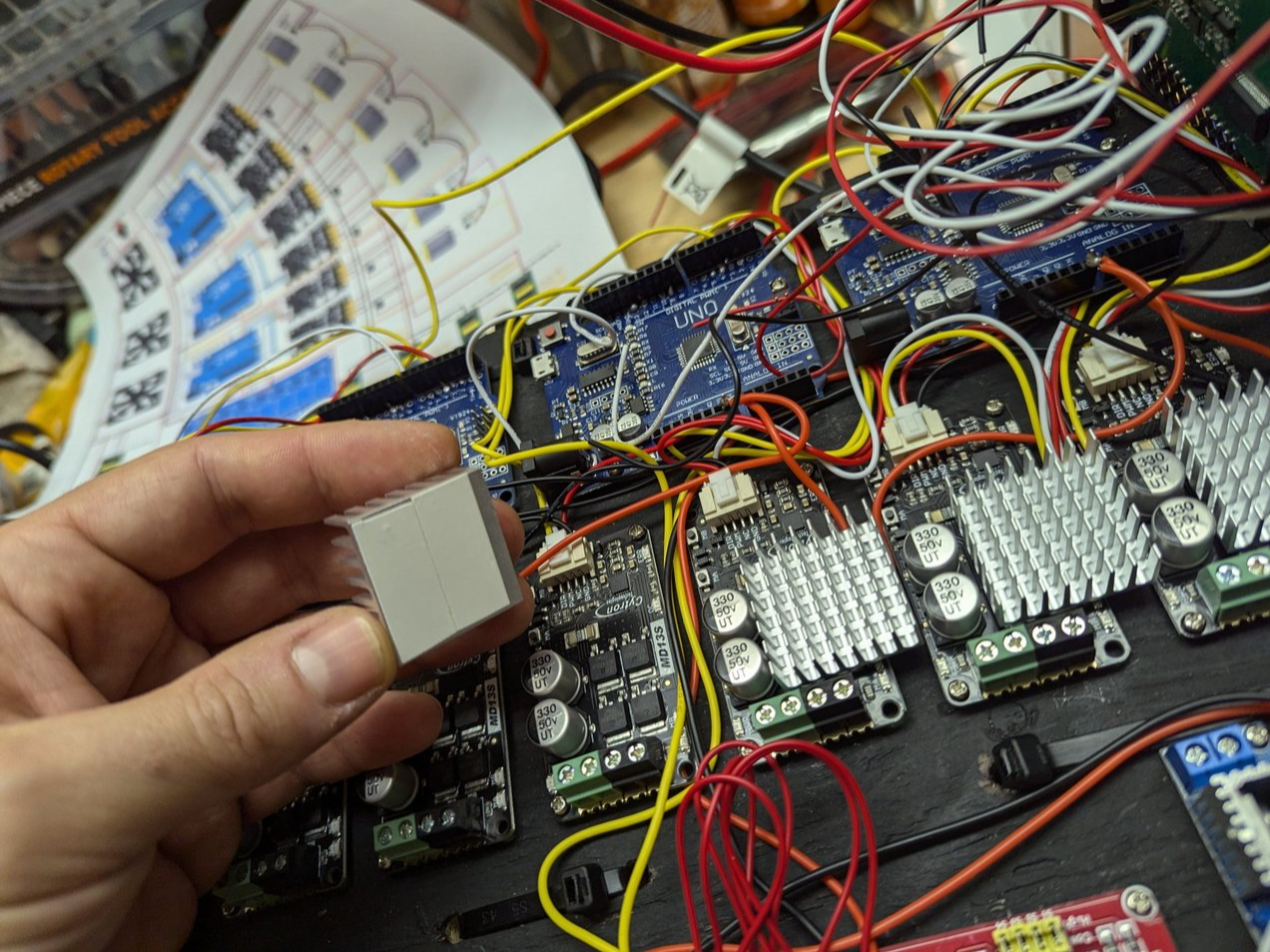

    Yes, I know my soldering is not good, but those thick wires really suck away the heat, so they are difficult to solder. It looks lumpy, but the contact is really solid. I will insulate it later, of course.
    Gluing on the radiators for the motor drivers with a thermal transfer tape:

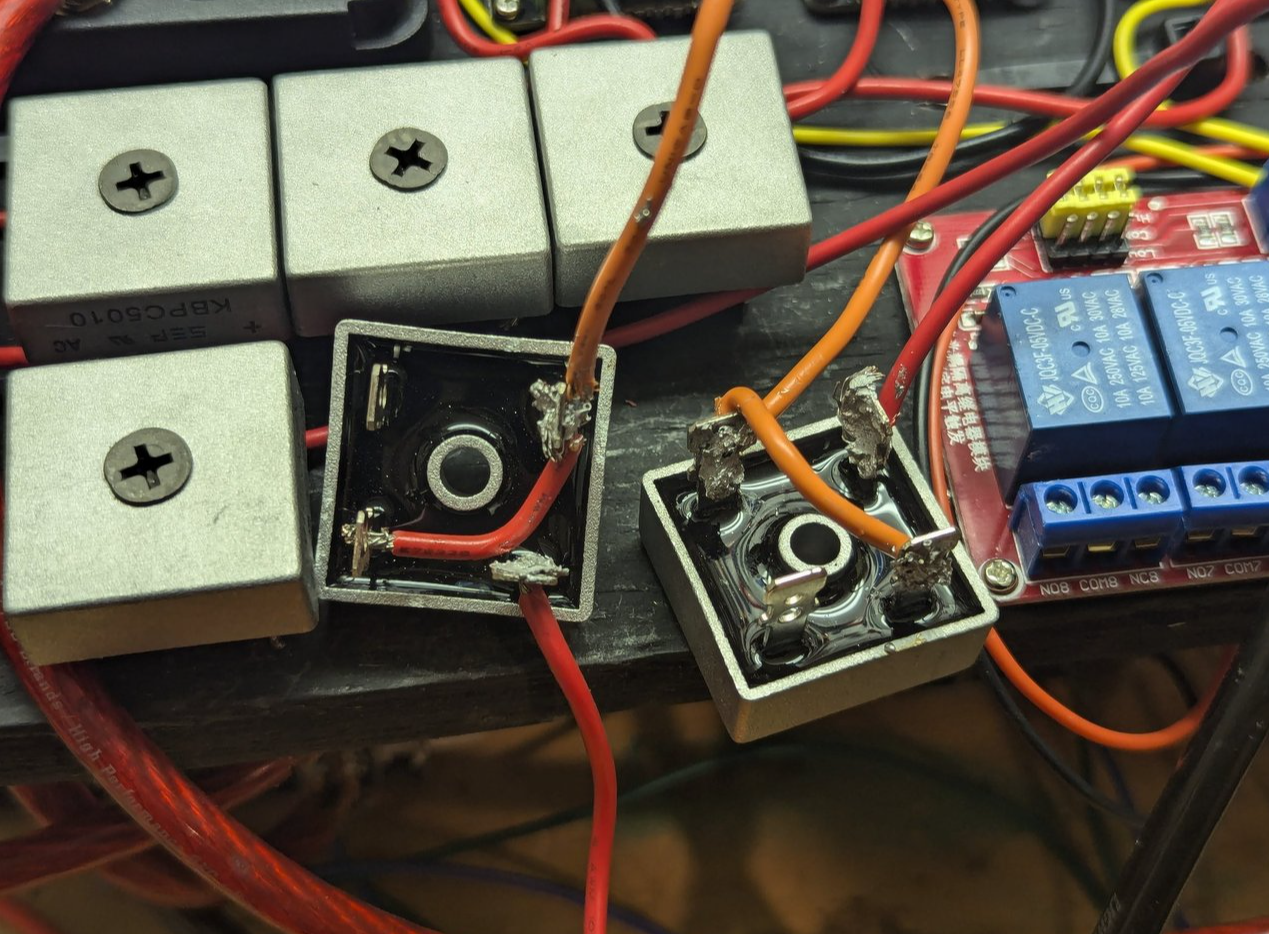

    Soldering the rectifier diodes:

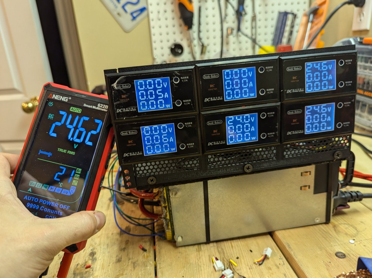

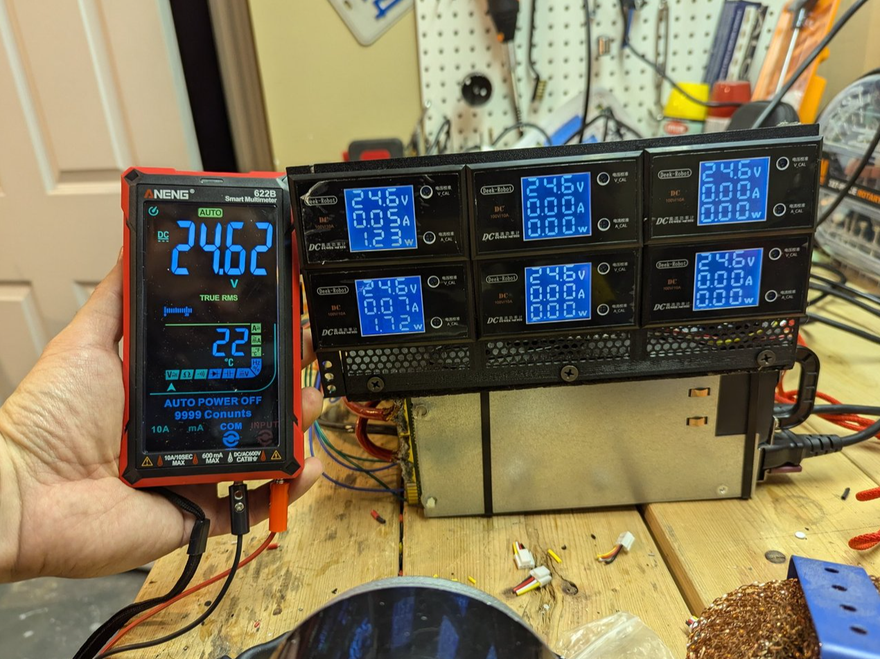

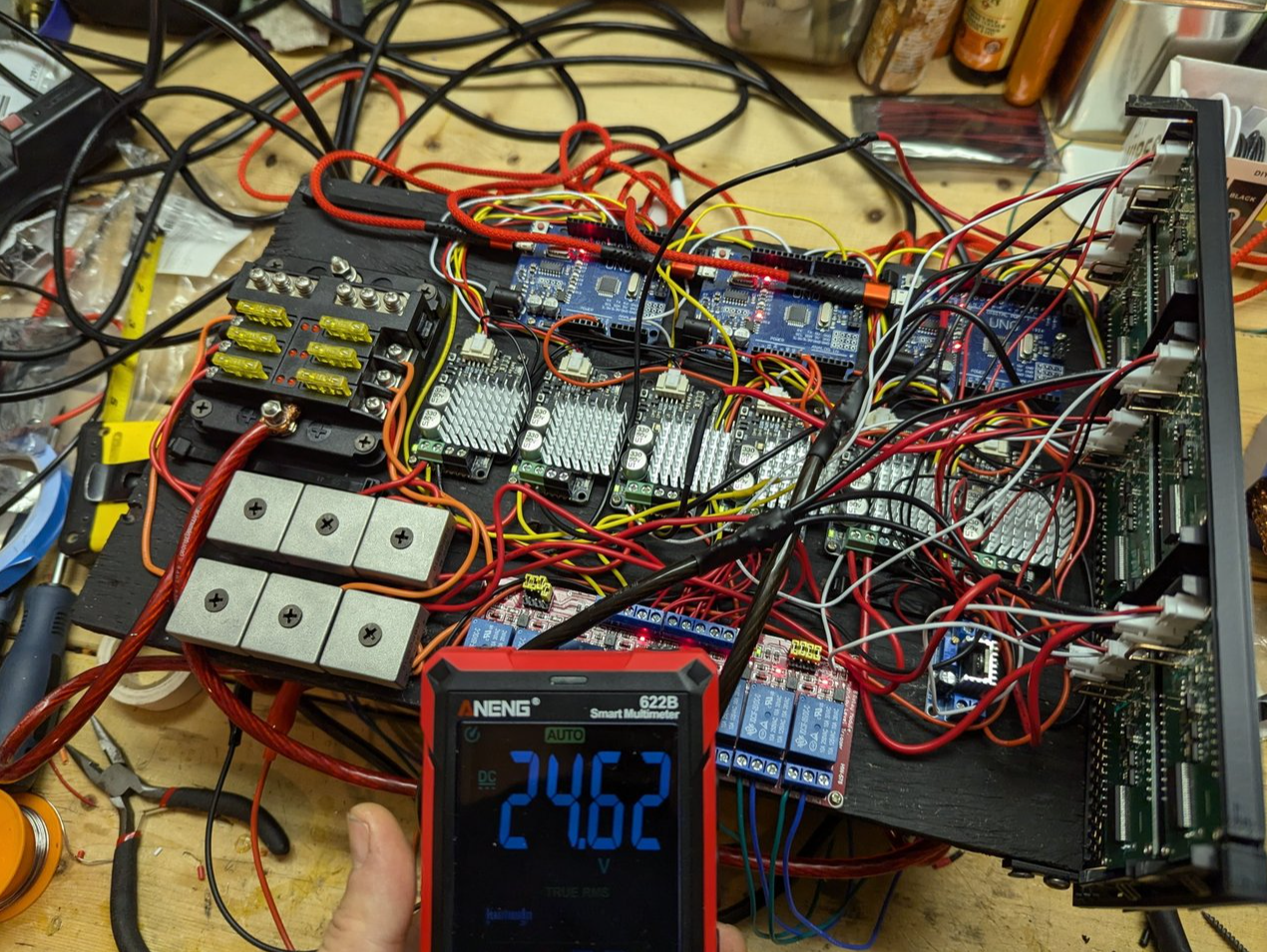

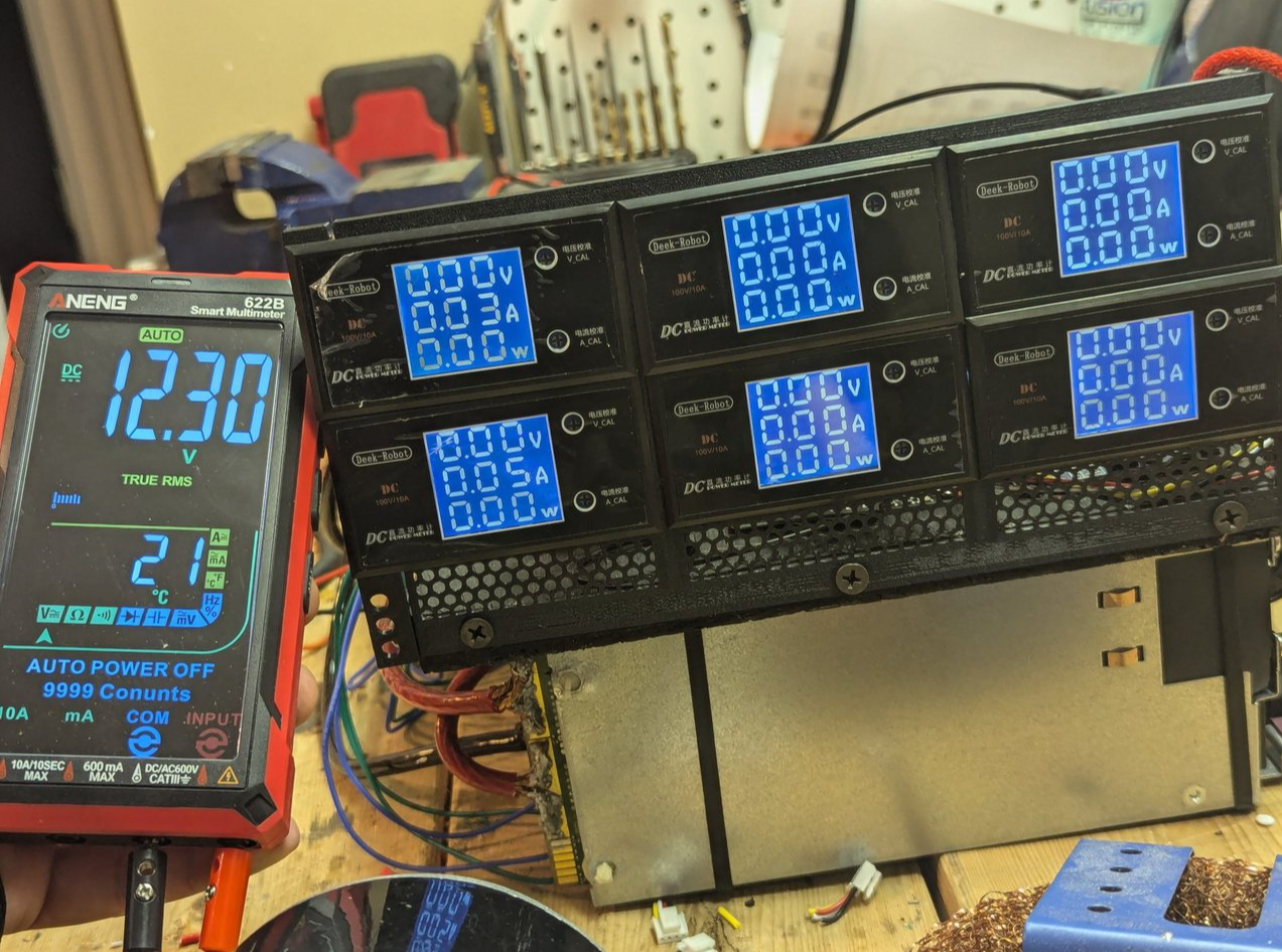

    First power-on test, checking the motor load displays:
    Almost done:
    We've got power!

    Here's a video of the first powered test! No sparks, no smoke, so I deem it a success. I connected a single motor and used the self-test buttons of one of the drivers, to make sure the motor was moving. So far so good.
    Next, I will design and 3D-print hall sensor brackets and magnet holders, flash the Arduinos with SMC3 and connect the motors. Then I will do the initial calibration. Hopefully next week I will be able to water-jet-cut motor arms, so I can assemble everything, and start tuning the platform. Lots of work to be done.

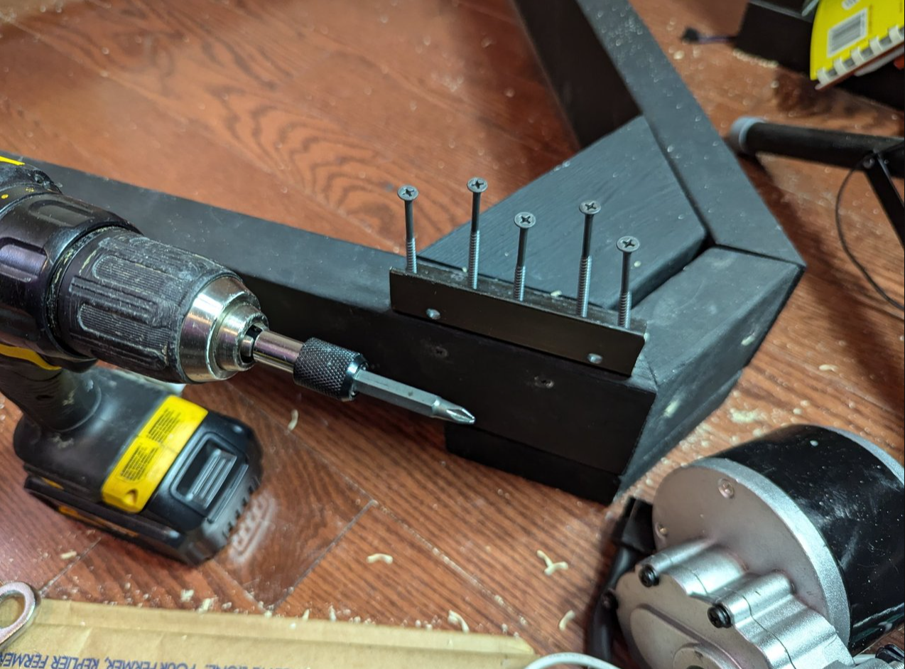

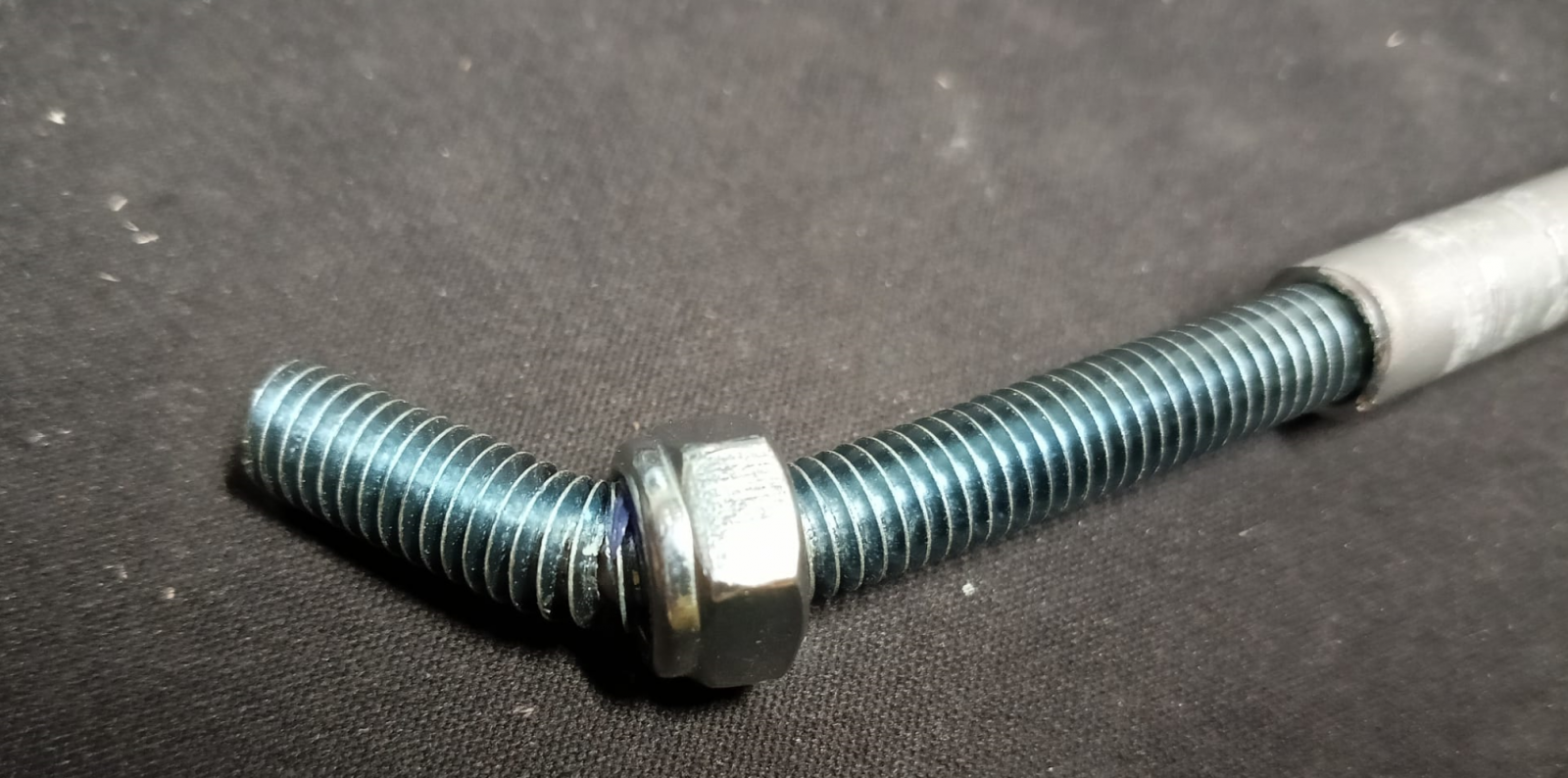

    Looking through your thread I think the motor mount will be too weak, 250W motors are really strong , below is a picture of the M8 rod that was bent today in my 2DOF
    I would suggest bolting the mount on both sides with the addition of a steel washer on the underside of the frame
  4. Ronan Design
    Jun 4, 2021
    270
    Toronto, Canada
    1,716Coins
    +142 / 2 / -0

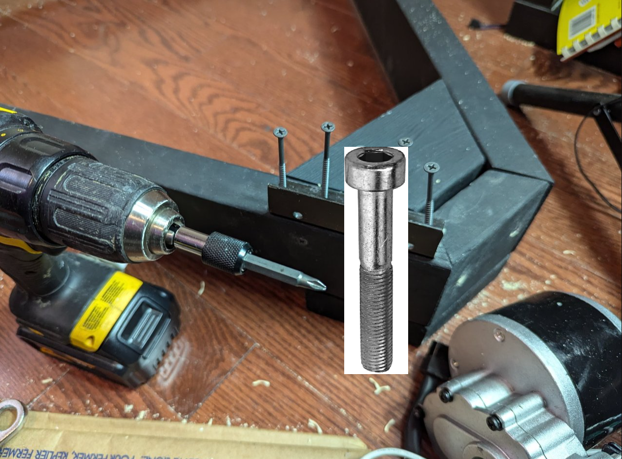

    I see what you mean. But to bolt through a 2x4 lumber I'd need really long bolts, and the location wouldn't work well on the underside of the frame. 5 long wood screws hold with a lot of force. I'm afraid that if that's not enough, the wood itself will not be strong enough, or the joints between the frame elements will give. I'll see how it holds on. If it needs reinforcing, there may be other options. i.e. adding 2 vertical metal brackets on the outside that run vertically along the outer wall of the 2x4. Or adding a mirror-image corner bracket and an additional piece of 2x4 on the 0utside to fix it on with another 5 screws.

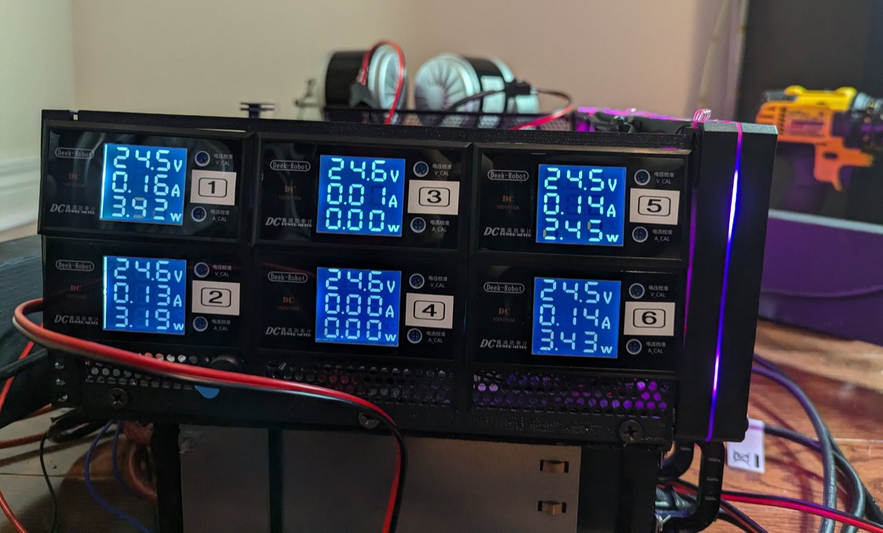

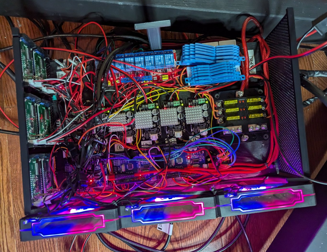

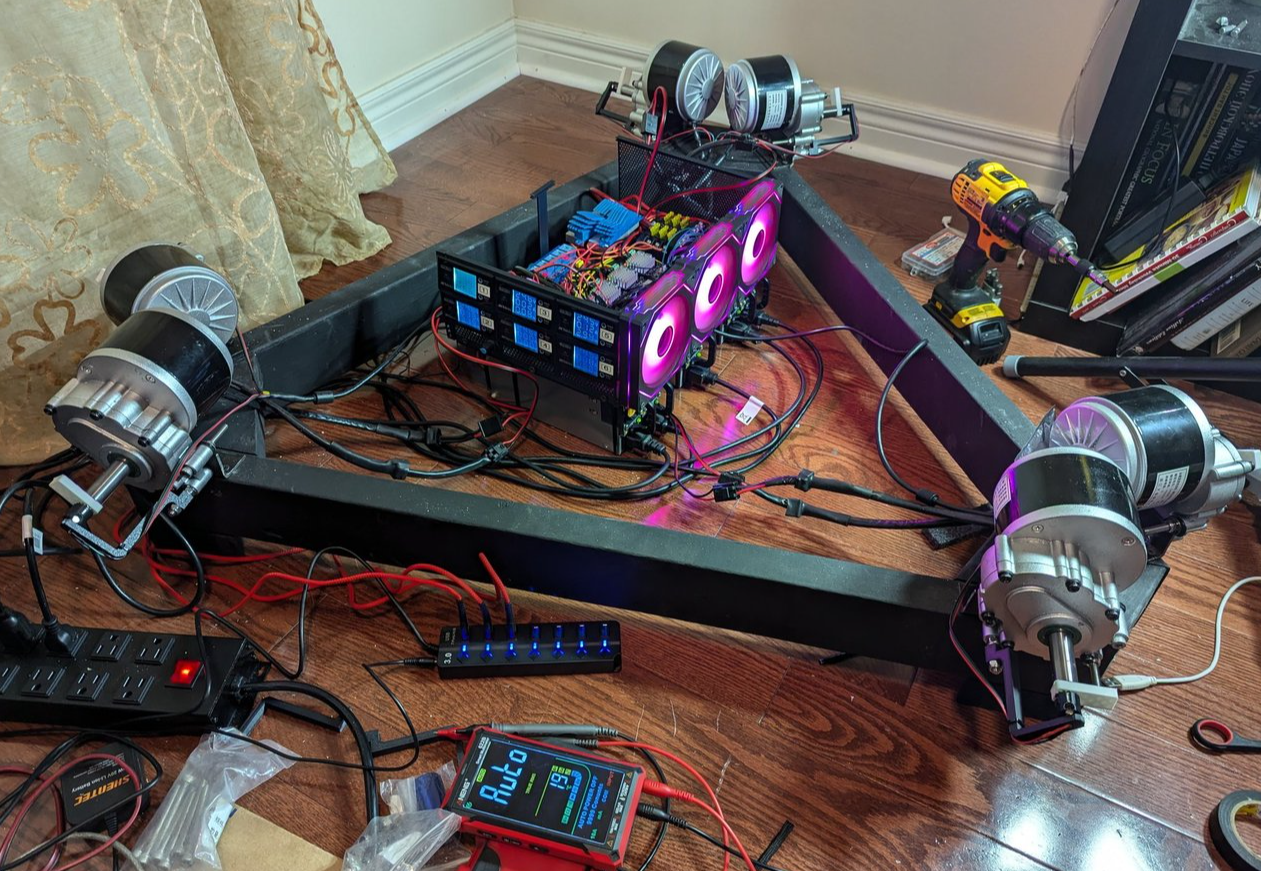

    Got the ECB fully wired and did a preliminary configuration. Arduinos are flashed with SMC3. Things are all connected and powered up. This is the first power-up with live power to the motors and hall sensors installed and configured. Things are not working properly yet and I have issues to solve, but we're getting there!
    The most important issue is noisy data from the hall sensors. I need to figure out where does the noise come from and how to isolate it. I know the same setup is working perfectly in my 2DOF. There is also some crosstalk so when one motor moves, the one next to it twitches slightly.
    Here's a detailed thread about the issue in the QnA forum.
    Here's the video of the first test:

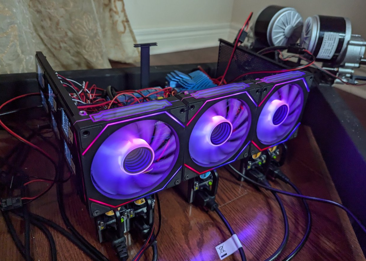

    The base with the ECB connected:
    ECB with working cooling:
    Some motors are struggling to keep in place - that's what the noise is coming from:

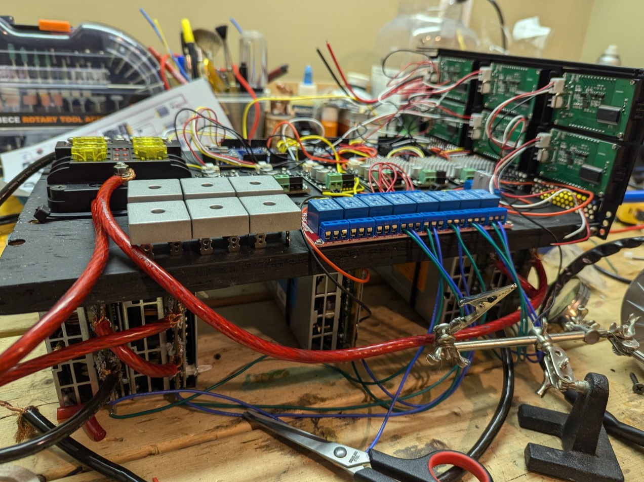

    The inner mess:

    Yes, noisy signals from the hall sensors could mean that
    1. The signal path from the sensor to the CPU (cables) suffers from interference, or
    2. The hall sensor itself picks up noisy magnetic fields (generated by the motor windings or high current cables nearby)
    To check wether 1 or 2 is true replace the hall sensors by resistive potentiometers. If the problem goes away it was #2.

    Wire-to-wire crosstalk (via electromagnetic fields) is only one possibility of EMI. Another is ground-bounce. If your power electronics share ground wires with the sensor signal path then current flowing through the wire leads to small voltage differences of the "local" ground points. For example 10A flowing through a 0.05 Ohm wire creates a voltage difference of 0.5V between the battery ground and the ground terminal of the power stage. If the arduinos are connected to different ground terminals they see fluctuations of the input signals even if the sensor output itself doesn't change.
    This gets even worse if high frequencies are involved. A wire not only has a DC resistance but a few nH of inductance can create a much higher AC resistance (called impedance or reactance).
    So if shielding of the cables doesn't help it's most likely a ground bounce problem.
    Separating the sensor signal path completely from the power wires can help.
