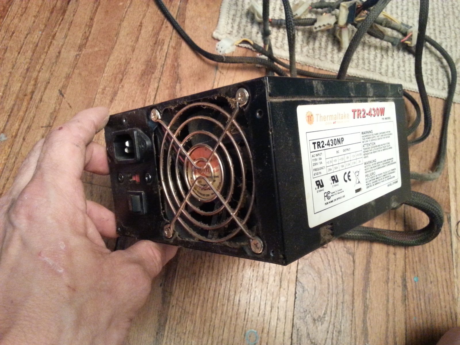

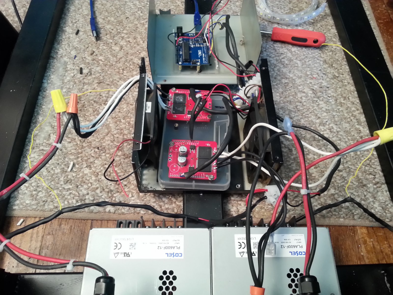

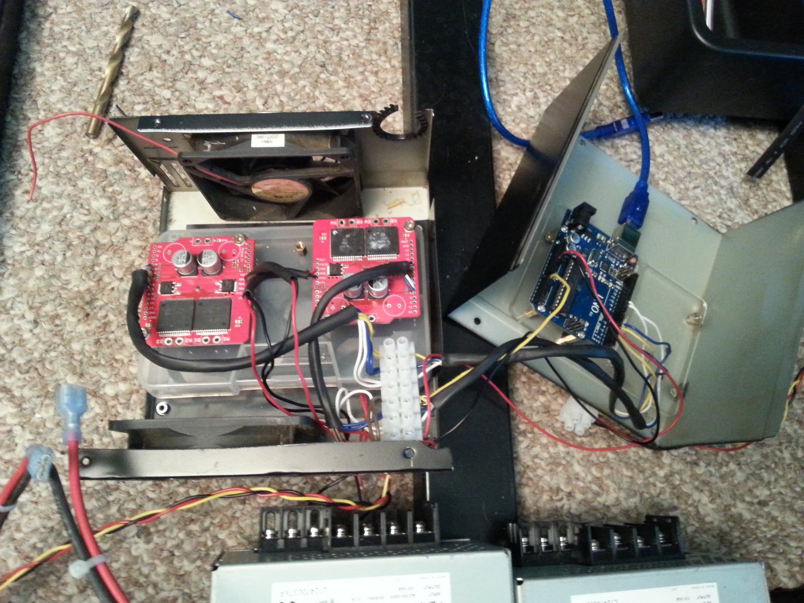

    ok update. my motos came early. got them yesterday so i started making my control box and getting the wiring square. I re-purposed an old psu from a pc. lol what a mess.

    @noorbeast so I get everything wired all fancy and .........nothing
    Maybe a victim of the doa mms @SeatTime mentioned.
    I' m using 2 and have two for back up.
    21,555
    150,950Coins
    +11,025 / 56 / -2
    Now that is disappointing!
    Post some clear close ups of your wiring and soldering for the resident Arduino/MM experts. @Pit is pretty good at spotting issues, but you need to provide enough info to make that possible.
  6. Pit
    3,012
    30,479Coins
    +3,097 / 31 / -0

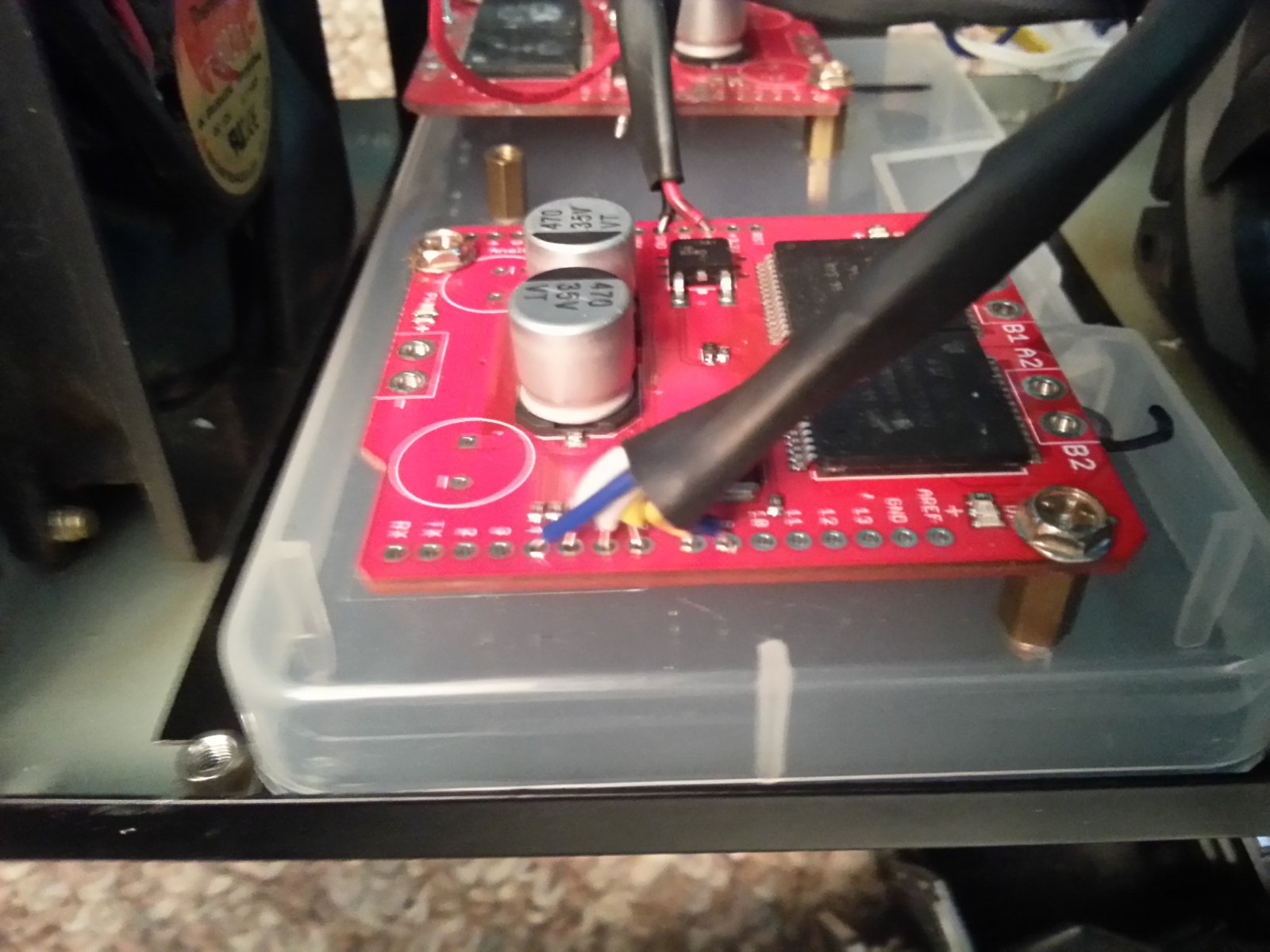

    One of the biggest faults is we solder and build all together without testing the parts before. Second the MMs are very "sensitive" if the temp of your solder has been to high, the board can be damaged. Third further I determined an issue shown by the picture attached to the posting. The screw covers the LED pins and if they will be damaged the 12V is going do destroy the MM. shortcircuit.jpg

    Ok I will check the screw. Thank you for pointing it out, I never would have noticed. Lol. I never thought this would be too easy. Just a little learning going on. And we all know an education isn't free. I have back ups. Heat from solder shouldn't be a problem. It is one of the few things here I have a little experience with as an HVAC tech years ago.

    yeeeeeees! ok got 1 motor working in smc3 utils. so it was a bad solder joint(cold joint at 12v pos out B2 on mm). Both @noorbeast and @Pit mentioned it and I should've checked better. when i wiggled all of the wires it came off resoldered and got left side chasing blue line. so stoked gonna mess with the other one later after dinner. Im sure its something simple. If not got two backup mm's.

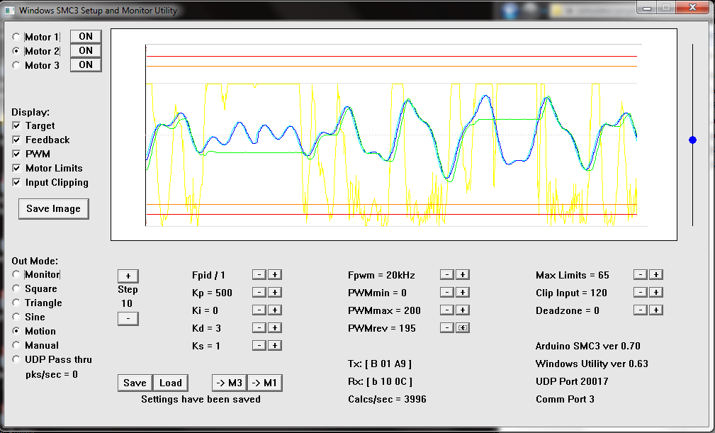

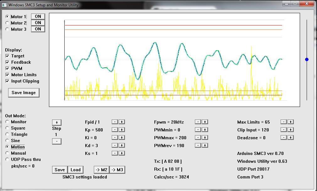

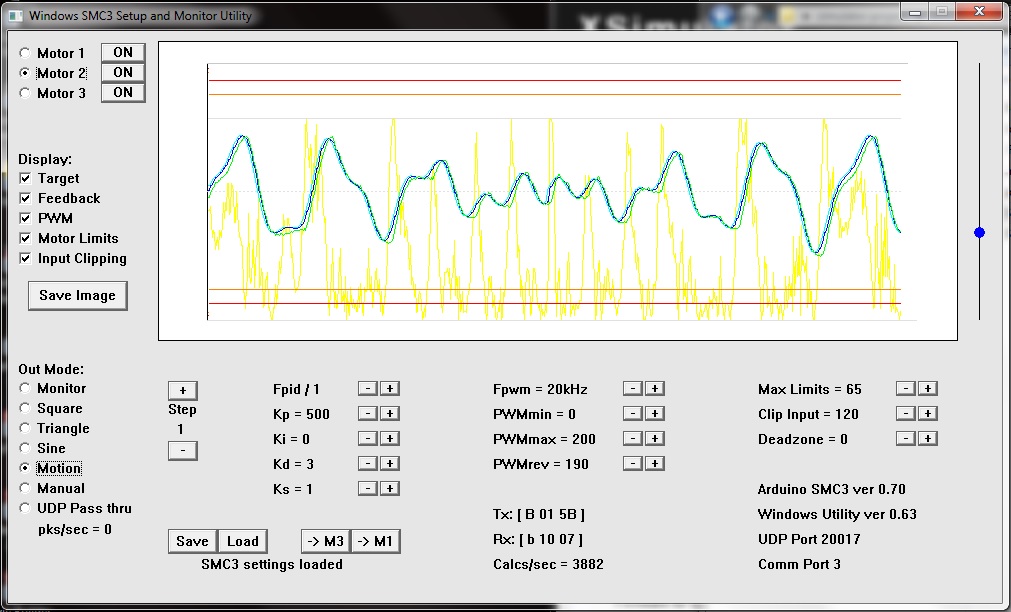

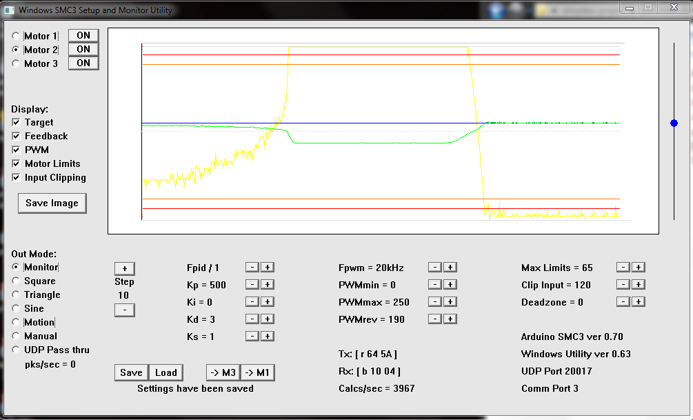

    ok there is a difference and im not sure why. motor 2 also will set just short of target and i can move slightly by hand before power gains to resist me. i can hear psu ramp up if i lean on the arm. also Axis 2 will not work in simtools. no matter the setting but motor 1 works fine? why is there so much difference in the yellow line(pwm). motor 1 seems way more responsive.
    so i can stall the motor if i put 30 to 40 lbs on the arm. signal clipped no movement i can set the arm manually by hand and it returns to normal. motor 1 does not move at all under same condition it resists me with more force than i can apply by hand.
    i can move it by hand and it will resist, or i can set it here just a little off the target and it doesn't move but is trying to again only at reverse.

  16. bruce stephen
    Jun 7, 2015
    1,286
    general contractor
    michigan
    9,115Coins
    +1,243 / 9 / -0
    it does this too. still seems like a lot of pwm at the point it calls for rev.

    You said the whole platform is 136kg total. The motors draw 24A ergo IMO the MM are "overworked". Probably you have to use a dual half bridge, meaning two MMs as one bridge. You are using the MMs as a half bridge already?
  18. bruce stephen
    Jun 7, 2015
    1,286
    general contractor
    michigan
    9,115Coins
    +1,243 / 9 / -0
    @Pit there is no load at this time...sry I should have mentioned that i am testing without the rig attached to the base. its just arm that weighs about 5oz each. motors may be too big (ie add more mm's) we will see, but you would know best. it works ok in simtools/iracing. waiting on thermal tape for mm heatsinks tho so i can't push it to tell. I've got two spare mm's so i can go that way if needed.

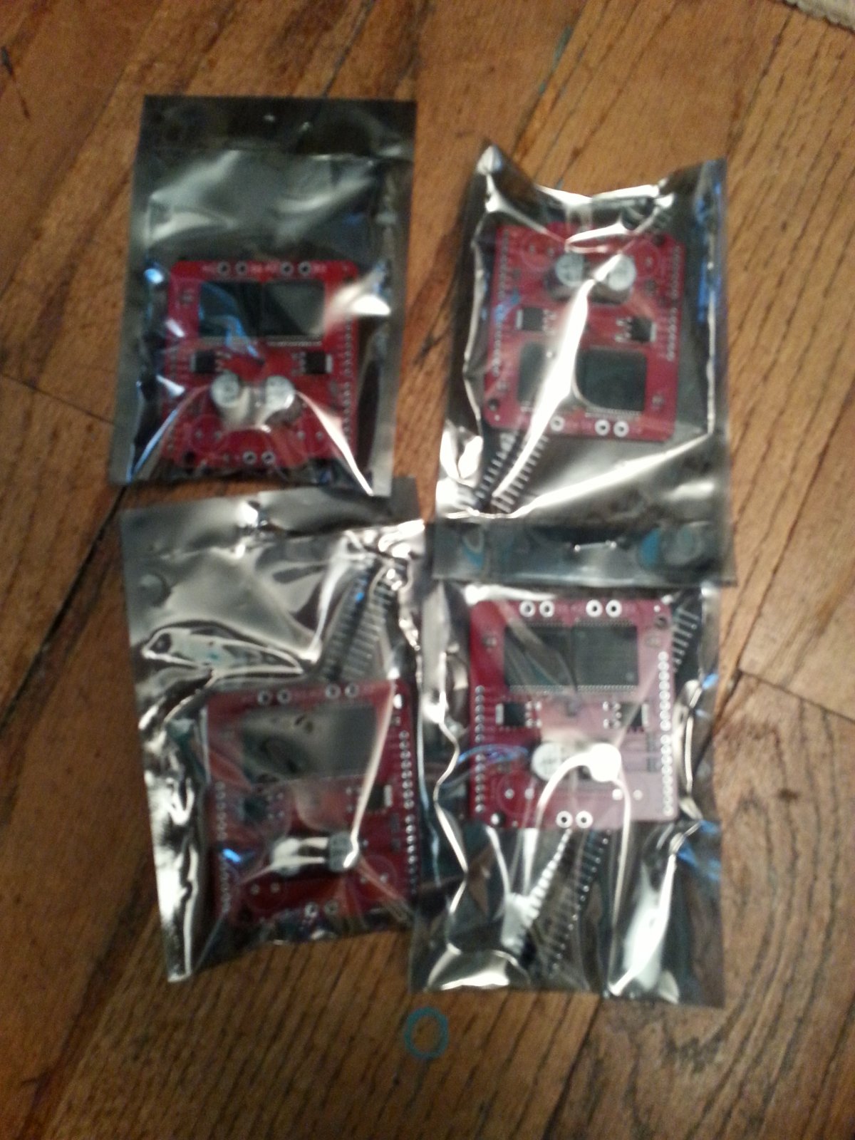

    Have you tested each output on the MM's ?? A1+A2, A1+B2 AND B1+A2 B1+B2 with a motor in both directions, sounds like your having same issues as me with dodgy MM's
  20. bruce stephen
    Jun 7, 2015
    1,286
    general contractor
    michigan
    9,115Coins
    +1,243 / 9 / -0
    Hope it works out @SilentChill. My mm's tested ok. Haven't opened the other 2. Are yours marked "spark fun" on the back? They do get hot quick. No heat sinks yet. Didn't have fans wired in then but was just testing. I didn't push them for long. Only a few minutes. Never hit thermal shutdown but Imo I had to be close. They were very hot.
