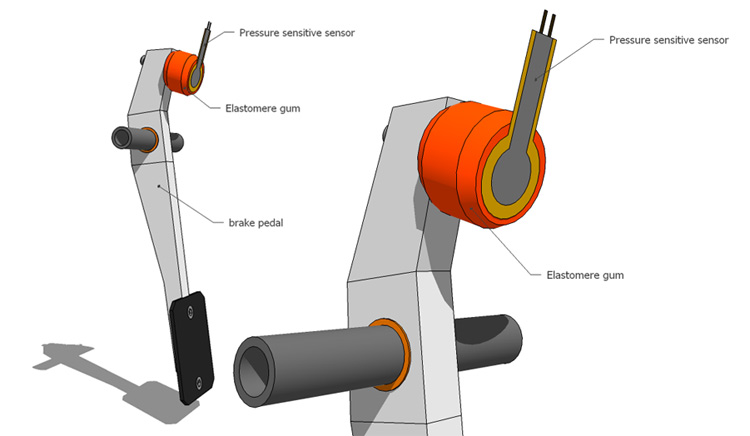

    I just found (conrad.de) that pressure sensor:
    It costs around 12€, has a durability of 10.000.000 operations and works like a pot with 1V-5V.
    Should work fine in combination with a progressive elastomere gum, so the pedal can move a bit and the sensor won't get hurt by blank metal.
    German data sheet: http://www2.produktinfo.conrad.com/date ... _150NS.pdf
    Anyone tried one of these?
    Cheers,
    Jay

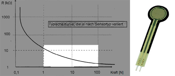

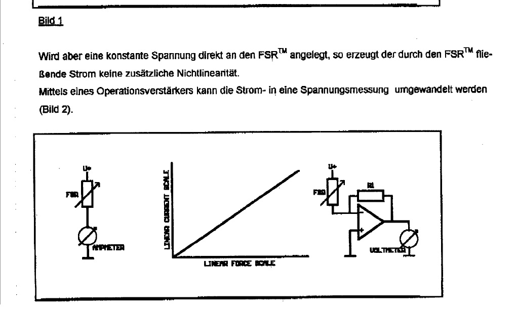

    I have one, i only tri it with gameport (long time ago) and multimeter. It need op. amplifier to get linear progression.

    The sensor has 15kΩ@1Nm/100g and 3kΩ@100Nm/10kg. Should be enough for the software. I'll give it a try :)

    But look at graf, its behave like you little push and its go from 1000kOhm to 10kOhm instantely, then there is small area where you can use it and then its almost insensitive. I was able to stear with it by putting PET bottle to it an push thru it (i can contrl force mutch better. In datasheet they have circuit with Op. amplifier to get linear proggresion. zapojeni.jpg
