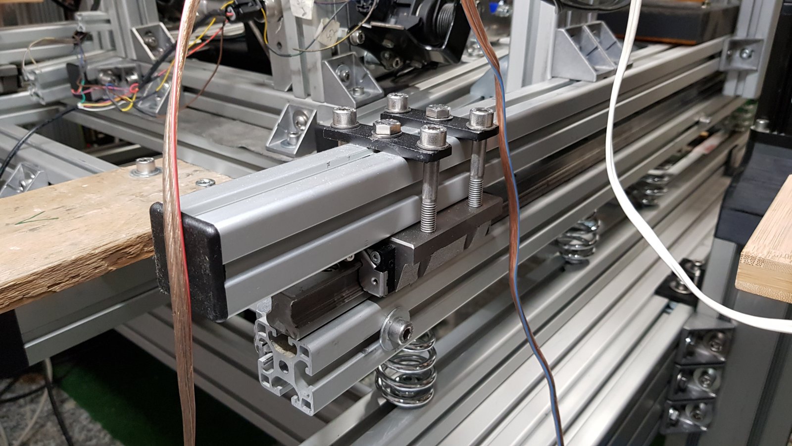

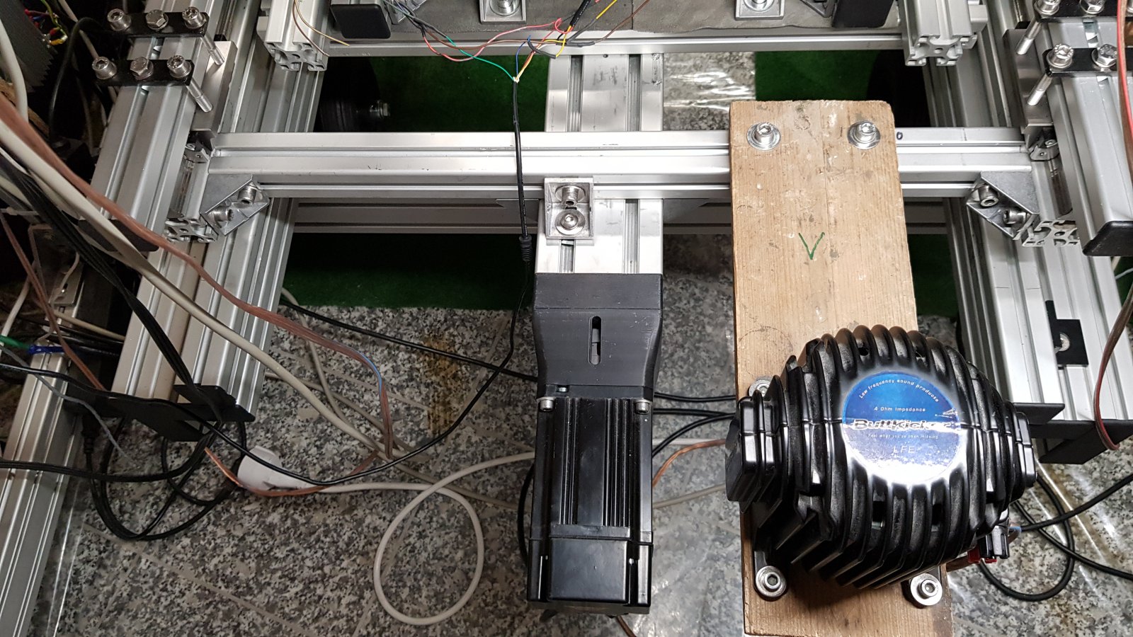

    I want to show an alternative method to simulate braking, pushing wheels and pedals against the driver.The concept is to produce a force to the driver instead a motion such as surge, to eliminate the swing effect.

    Interesting idea, and Quite complicated design, seems like a transformer. I wonder what is the purpose of the yellow beam moving underneath the simulator in the first video?
  5. wingert
    wingert Active Member
    Aug 10, 2020
    115
    660Coins
    +89 / 0 / -0
    4DOF

    I also use a similar system but instead of moving the pedals and steering wheel, I move the seat itself on its sliders using a 120kg/cm DC servo. It gives a great surge effect especially when combined with more traditional motion. (I have it on a hexapod).
    Some people are rightly concerned that changing the distance between the seat and wheel/pedals can be detrimental to both muscle memory and realism but the trick is to apply a large enough force to feel like you are being pushed towards the wheel or pulled back from it over a very small travel, but also not so strong that you can't resist the force when braking. This way, it gives the sensation of G-Force without actually changing the distance. As with all motion effects, subtlety is the key - it feels more impressive than it appears.

    my concept is not to sit on the moving slider, I have it before, as possible feeling only a force, because if you map a acceleration value (longitudinal acc.) to a position value you have dimension mismatch feeling a kind of swinging.
    E.g. under braking to find a brake point, you increase and decrease the brake force, so in real the deceleration vector varies only in amplitude not in direction, if you do the same after transforming to a position you get a forward backward movement. (swinging)
    A short reduce of driver position to pedals and wheel correlates to real behavior under braking.
    E.g if a driver has no seat belt and hits a wall (enormous deceleration) his head even crashes against wheel or windscreen.

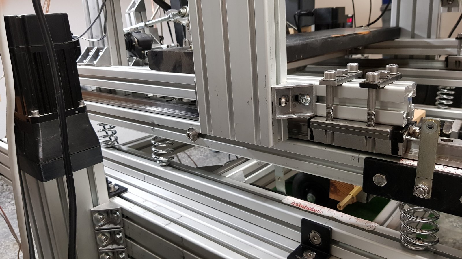

    just appendix sliding wheel mount with springs to get some sustained force in hands.
