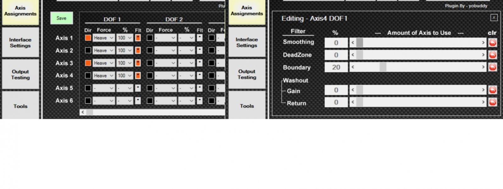

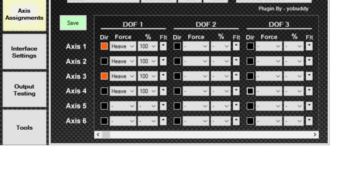

    Hi, i am testing with my Simulator and try to get as much heave in Iracing as possible so i use 100 % on DOF1, but i only want it on 20 % of the axis.
    So i use 100 % in Axis Assignments and 20 % in the Filter for every Motor on that axis ...
    From the feeling and my scale i have used it doesnt change , do i miss something ? It still goes all the way up and down .. as when using 100 % and no filter
    My sim (similar to this https://www.xsimulator.net/community/threads/3-dof-heave-seat-mover-motor-24v-120w-fr-en.9248/ )

    Can you post a pic of your axis assignments buddy?

    Hey guys , this are 2 videos, same part of the track, döttinger höhe ...
    I used only one Dof, on 4 axis (4 Motors), so no other dof can influence the heave (extra2) in iracing
    Shouldnt it be like, if i have a way of 10 Centimeters for 100%, if i use the boundary filter with 20 Percent, it will not use 10cm, it will use 2cm to put all the 100% information in ??
    This one is 100 % and no filter
    This one is 100% and 20% Boundary on all axis on that only dof ..(extra2 ).
    If i understand that boundary in the second video should only use 20 % of the way which is used by the first video, or not ?
    but as far as i see it uses the same amount of way ...

    Hi, played around in default profile with heave ....
    Settings Way
    100% /0 % Boundary 9,2 cm
    100%/25% Boundary 7,6 cm
    100%/50% Boundary 5 cm
    100%/75% Boundary 2,7 cm
    100%/90% Boundary 1 cm
    So this means in my config the boundary works complete opposite ?
    Bug or Feature :)

    @yobuddy , is this a problem when it works the opposite way ? I get more way when i use 20% and less way when i use 90% ... Are there any calculations which are using this values ?
  11. yobuddy
    5,408
    50,691Coins
    +5,166 / 19 / -0
    Hi @Ringorumble ,
    It's a Bug buddy, I fixed it for SimTools 2.1 already.
    Nice testing man!
    If you use 50% for boundary thou, it works as expected :grin
    Anyway, its all fixed and will be out shortly.

    on my 2DOF, I have a motor for right / left and a motor for front / rear. how, and where to limit the effects? on axis I can put a limit in% and on Boundary too, what's the difference? on the right engine I put roll and Sway. on axis I put: roll 100% boundary 100% Sway 100% boundary 100% if I want to limit Roll, or limit on the axis or on the boundary?
  15. noorbeast
    21,592
    151,215Coins
    The Axis Allocation for a 2DOF should total near 100%, not be 100% for each force.
    The Axis Allocation is how much of the total movement is available for each force. The boundary filter is a sort of limiter.
    If you set the Axis Allocation force to use 20% of the axis, say for roll, it will use all of the 20% of the axis movement only when the game input for roll is at 100%.
    If you set the Axis Allocation force to use 100% of the axis for roll, with a 20% boundary, it will use 20% of the axis movement when the game input for roll is at 20% and will ignore any higher inputs.
