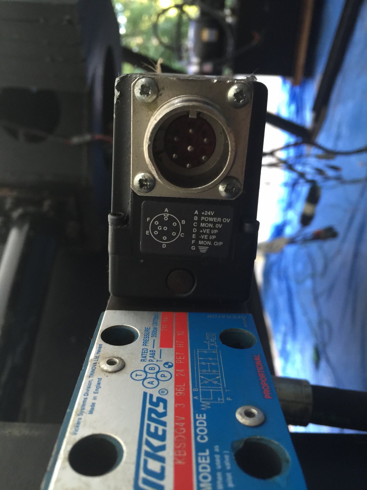

    Ok so I have been looking on this forum for a few months now and have been wanting to build a motion simulator for years. But now I feel like it is time to finally post something. The reason being is because I just recently purchased a Maxflight VR2002 Simulator from craigslist! The machine is huge and weighs over a couple tons! If you don't know what I'm talking about I really recommend looking them up.
    I have been putting it together for the past month now and any help I can get would be greatly appreciated. I bought the machine with a few missing and vital parts but feel like all the essentials could be recreated with a couple arduinos. I am missing the computer, robotics/electronics controller and encoders. However since this simulator was originally intended to be a roller coaster simulator and I want it to be capable of more than that like flight simulation, the computer and software is not really needed. The encoders can just be bought of Ebay or Amazon for not too much and the only part that I believe is going to be a challenge is the robotics/electronics controller.
    The simulator uses hydraulics to lift the machine and turn it on the two axises and the robotics controller is in charge of taking in all the data from the encoders and sensors while also sending out data to the valves telling them when to open and close. The first pictures I attached are of the connections and wiring for one of the two main valves (They are identical). I need to find a way to control these using an arduino (or something better if it exists and isn't too expensive). So I guess my first question would be what's the best way to control these valves and connect them to an arduino?

    hydraulic is not an easy way... Are your valves on/off or proportional?

    The valves are proportional to turn the unit and then there's the on/off valve to raise/lower the unit. Thx for the links:thumbs

    Alex,you could use ardunno with relays for on off function and need to know if proportional is voltage or current controlled. Also is the servo bi-polar meaning swings negative and positive either voltage or mA.

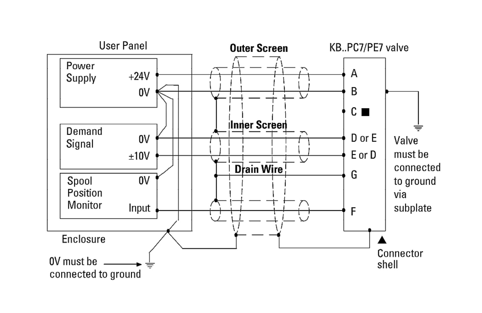

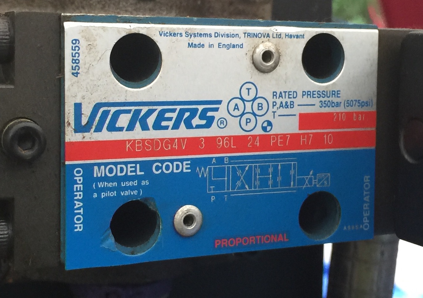

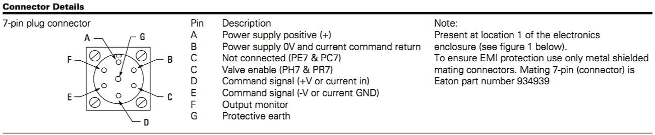

    I believe that the valves are voltage controlled. I attached a couple more pictures of the connections, what model it is and a pdf of the manual if that helps. Not sure what you mean by the second question but I'm pretty sure the answer is in the pdf.

    Alex, You are in luck. The driver is inside the valve block meaning it is voltage control +- 10 volts dc. This is easier to obtain than the 4-20mA model with external driver.

    Read the pdf you posted carefully and understand it's meaning. Do you have any of the control boards that came with the sim?

    No unfortunately I don't have any of the control boards :(. I know that an arduino can only output 5v, do you know how I could get that to 10v?

    That's + and - 10vdc. Somewhere at home I think some info is available. I'm traveling now and will look when I get home.
