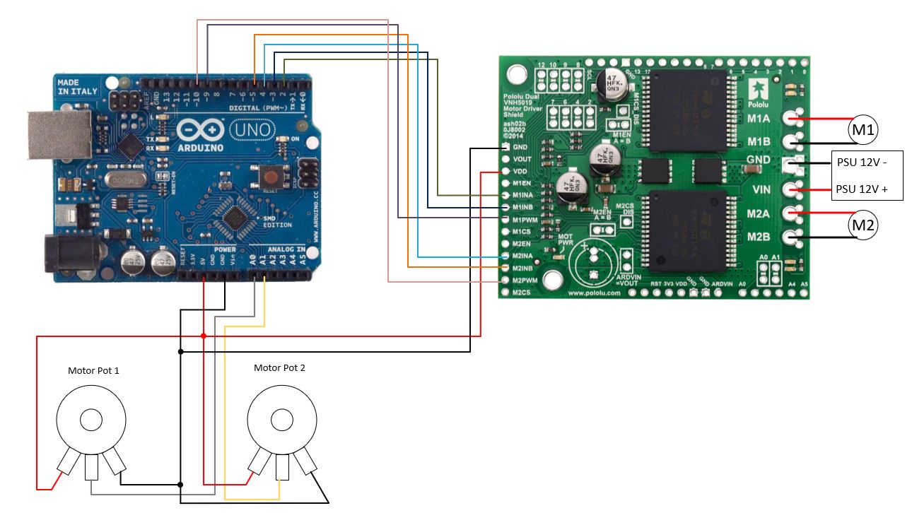

    Would this work without any code changes? I've used the existing connections on my Arduino as its set up right now with the MM.

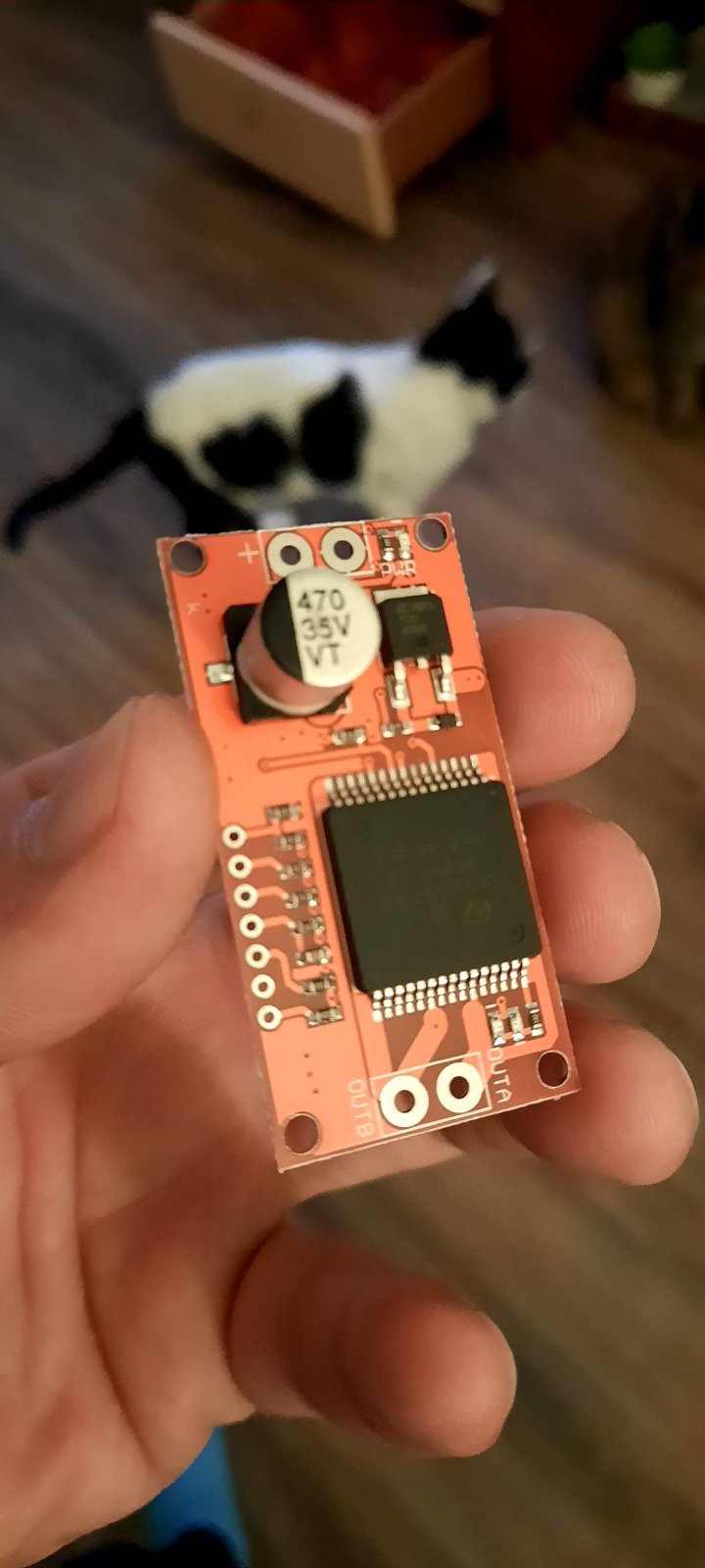

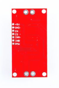

    About the shield...try to use 2 single channel boards instead (see pic) with VGA heatsinks. they run better than the shield and you'll have a board per motor, means less stress, heat maybe more power. I'm running my motion sim every day for 4-5 hours without any problems. No heat, I just use one 120mm fan to keep them cool. I have VWwiper motors. You don't need to change the code for this, just the wiring.

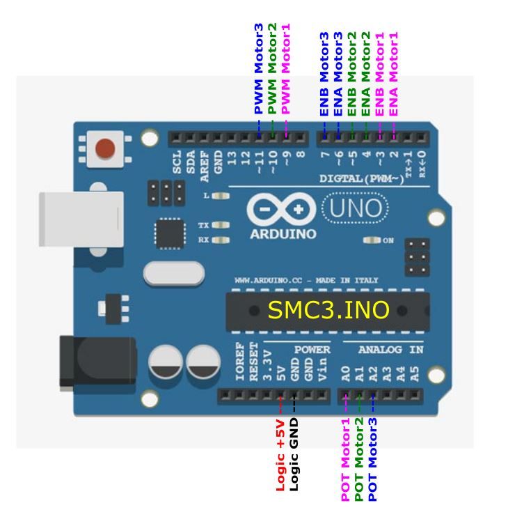

    See the Pinout on the attached picture. you have to connect 5V, GND, ENA, ENB and PWM for Motor 1 of your UNO R3 with 5V, GND, INA, INB, PWM of your driver board and do this for the other one too
