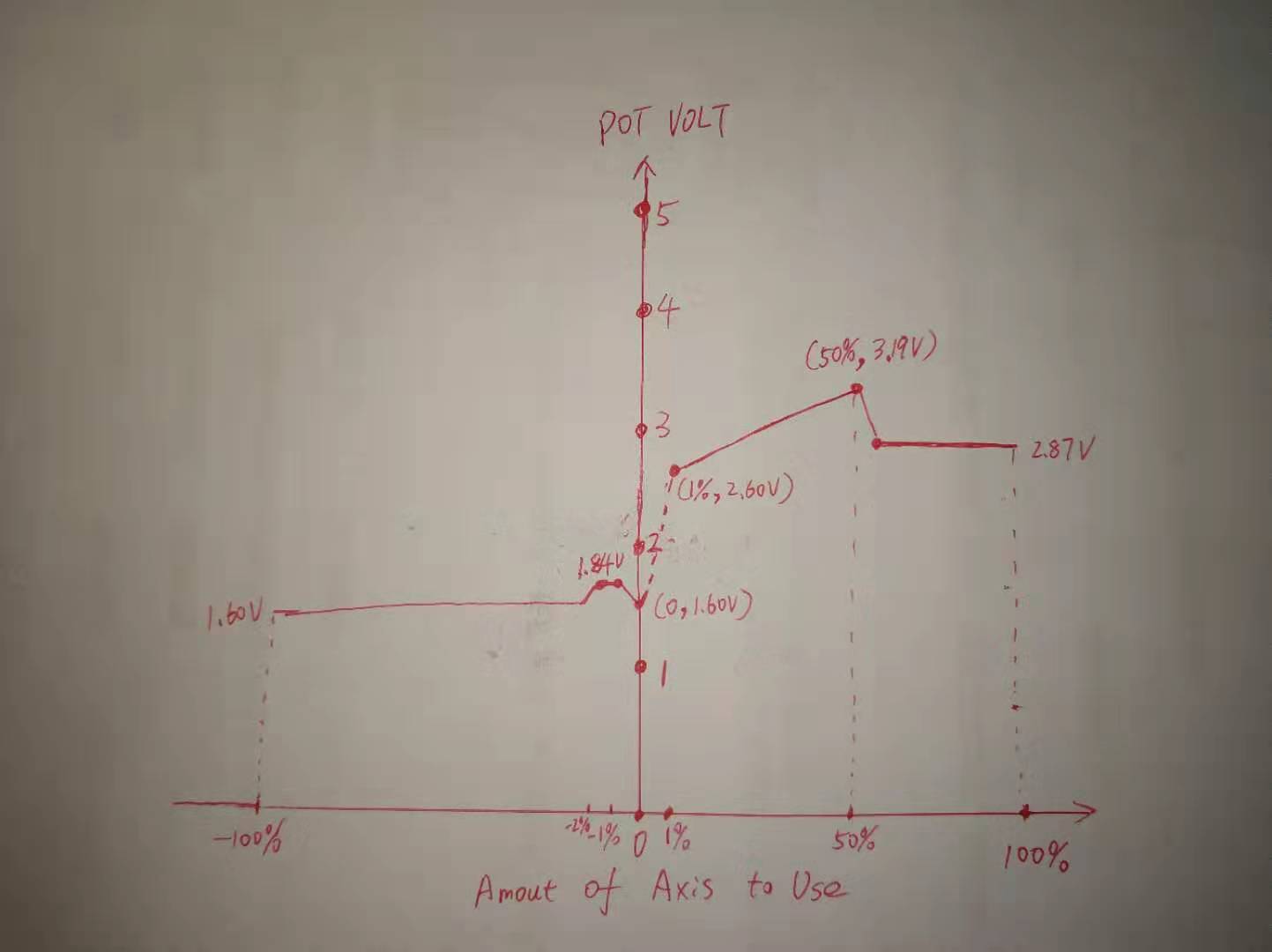

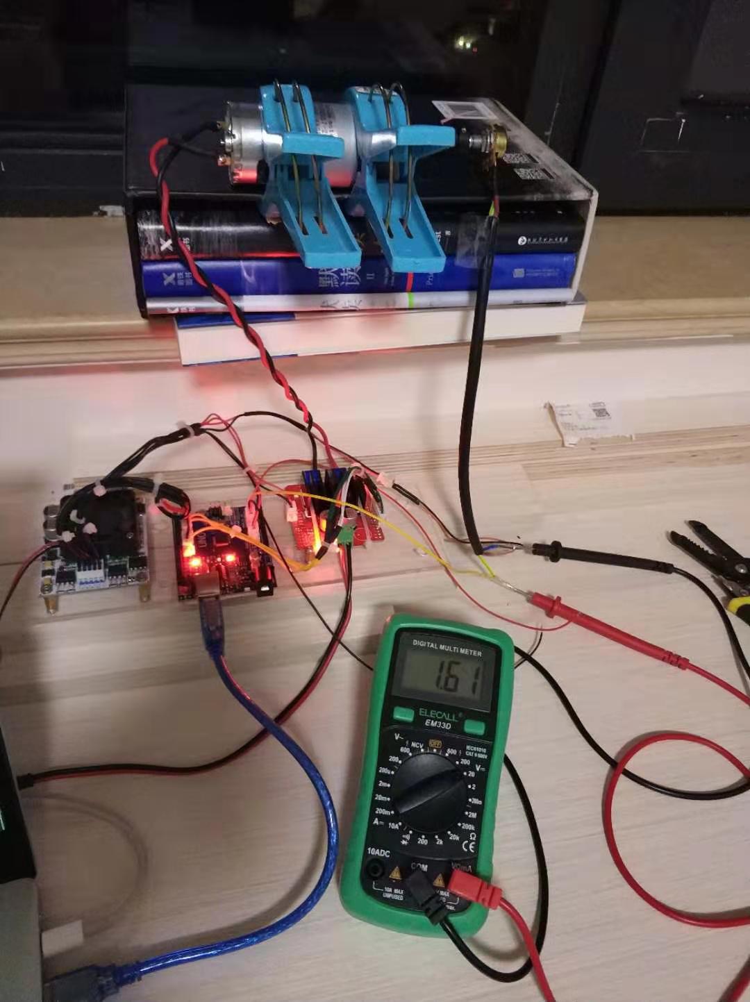

    Thanks prodigy for you advice, although there is still no change, but there may be a clue.
    Here is what I did:
    I reset all the settings of simtools;
    > I only assigned axis1a to have a 50% roll force(the rest axis remained blank);
    > In interface setting I only write [A<Axis1a>];
    then in output testing it still raced to 1.58V position.
    New discovery is in testing when I dragged the "amout of axis to use" of roll ,
    The Axis% & PotVolt relation I found is like:
    (you can see the graph below as well):
    at +1% it moved to the place with pot reading of 2.60V
    from +1%~+50%, it rotated almost linearly from 2.60V to 3.19V
    the time I hit +51%, reading became 2.87v, and stayed the same all the way to +100%
    One conclusion here is the motor moved quite as expected on the positive side.
    if I hit "clr" it returned to 1.60V,
    when I dragged it to the negative side.
    at -1% or -2%reading became 1.84v,
    and to any place lower than -3% it would jerk a little and stop at 1.60V
    So the negative side is all dead end.
    And to answer your question at last: SMC3 utils(tuning software) doesn't and can't be run in the background while simtools working.
    Thanks!
    SoftKitty

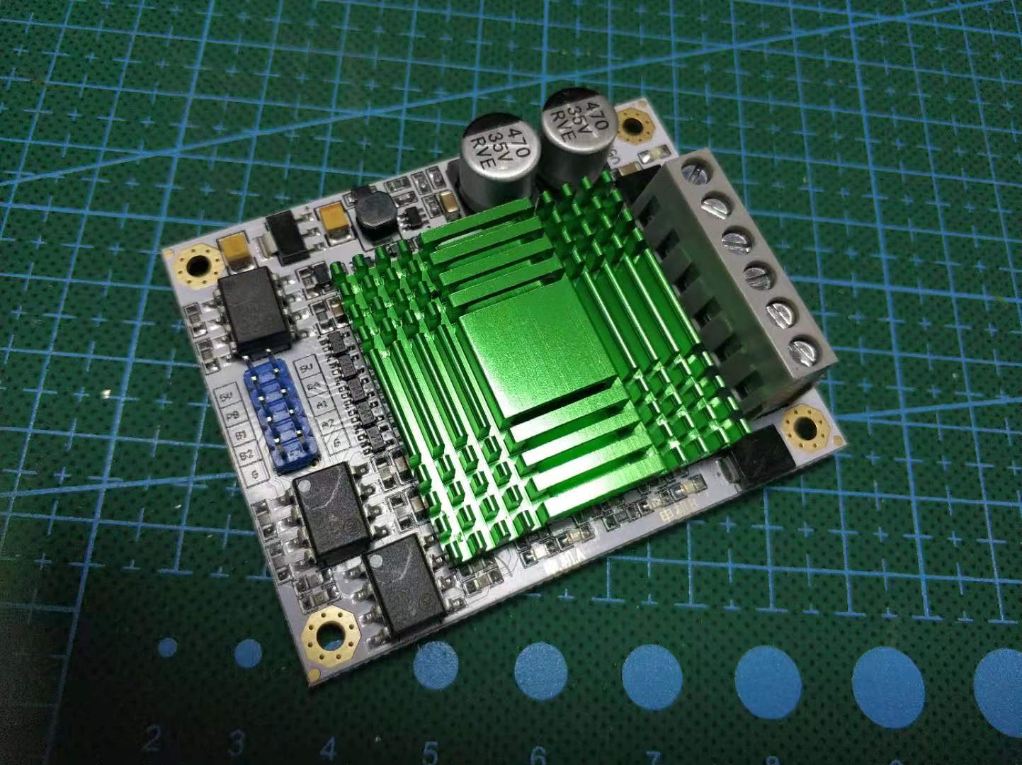

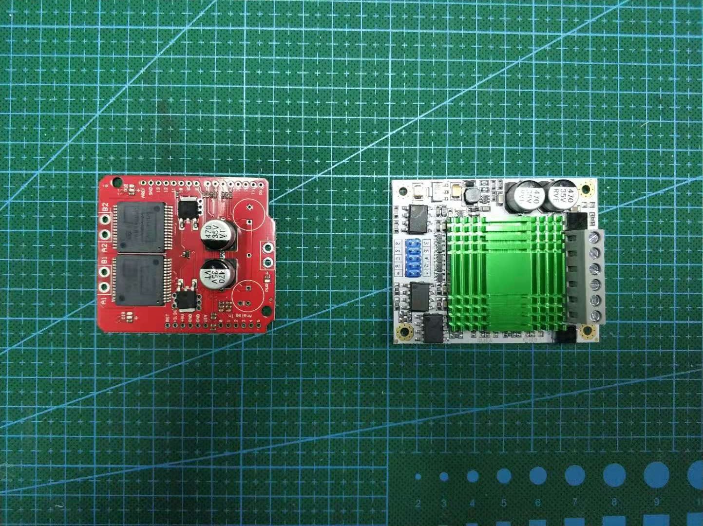

    just now I wired motor and pot to motor3(driven by the red MM board)/Pot3
    and same thing happened like motor1.
    so at least not the green driver board's fault, next I will try on another arduino board, or another laptop PC.

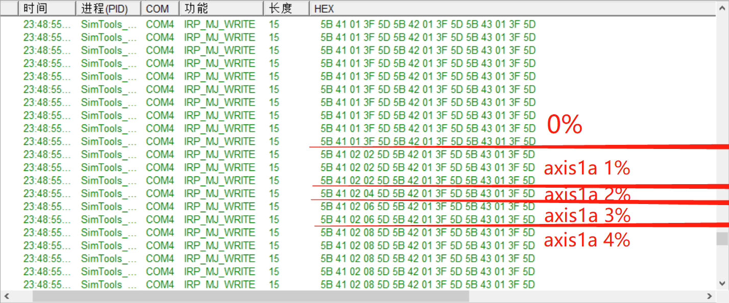

    I finally find the cure for the center position problem
    It's the "language for non-unicode programs" settings
    It has to be set as English(United States)
    One of my laptop is running in Chinese, another in Japanese, both will have the 1.60V problem.
    I even monitored the COMpot to see what it was sending.
    In a non-unicode language setting other than English,
    default Compot output right after "Turn on" is a unusual number "01 3F"
    which was the 1.60V position order.
    and anywhere the axis is below mid point, output will stay on these numbers.
    (So the motor won't react to negative side)
    only when axis use was greater than 1%, will the Compot send linear numbers.
    so it can only move decent on positive side.
    That's how I knew I couldn't blame the boards or other hardware, the Compot was sending wrong message.
    Maybe simtools can fix this in the future versions? make it more compatible?
    Anyway feels so good to finally find a solution!

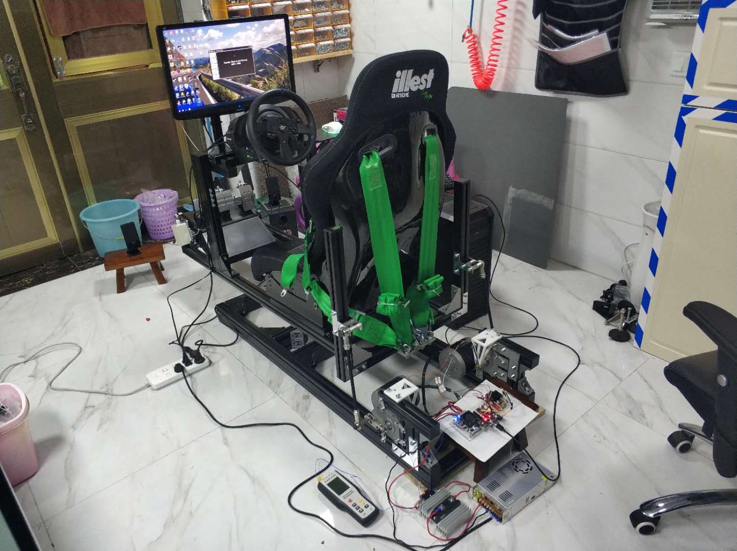

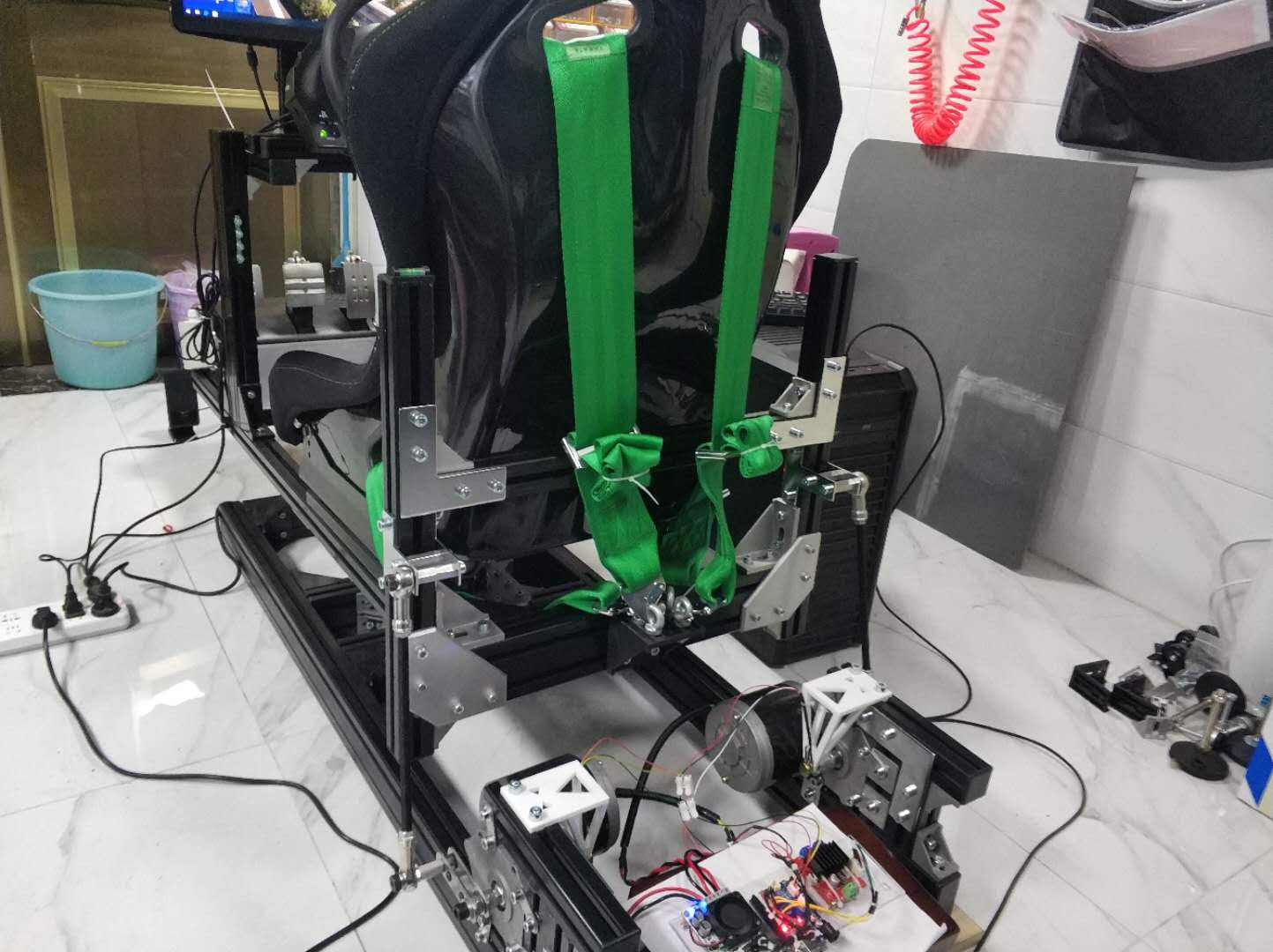

    Everything all set, I had a test drive.
    Although each motor is rated 600W, with max pwm setting, one 600W PSU can handle those two,
    it seemed the comments in the motor page were right, that actual power output is not that high.
    And I pasted a thermocoupler on the heat sink of the drive board, it never went higher than 26degrees Celsius(ambient 10 degree).
    The vertical bars connected to the rods were weak, I will fix that.
    And the motor makes noise when "idling", I will play with the SMC3 settings more to see if it can disappear.

    The 2 aluminum bars behind you, where your motors are connected, are flexing a lot. Maybe you could try to make them stiffer, it would be better for sure. Maybe with one horizontal bar between them.

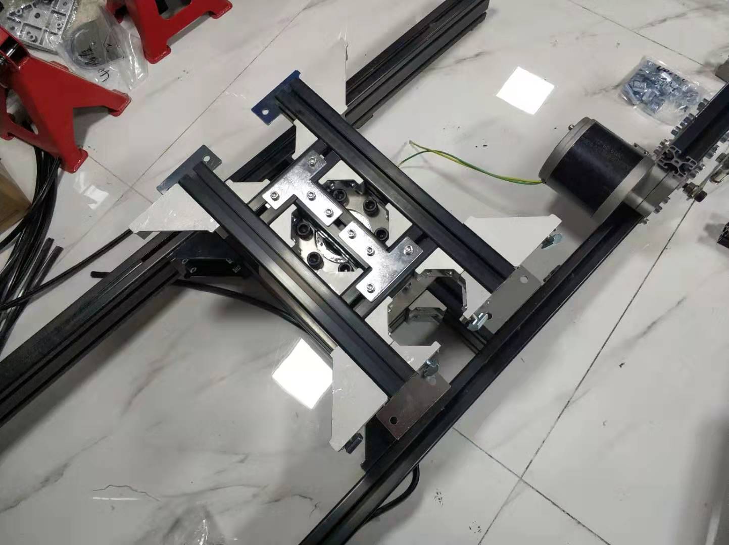

    Yes, sir. So I did this.
    Now it's really stiff, The kick feel of shift-up is more intense.
    The seat makes some snap sound when I invert the load or hit something:D
    some damping device may become the next step.

    my frame is also made ot of aluminium bars. Those free standing ones MUST be really stiff. The next thing ist that my frame itself twists a lot. I mean the part, where (your) seat is mounted.
    Maybe it would be a try to let a friend drive while you are watching the frame...
    The frame carrys a lot of additional weight like the Monitor etc. That also causes more twisting.
    BUT... I like your Construction. It looks very professional. :thumbs

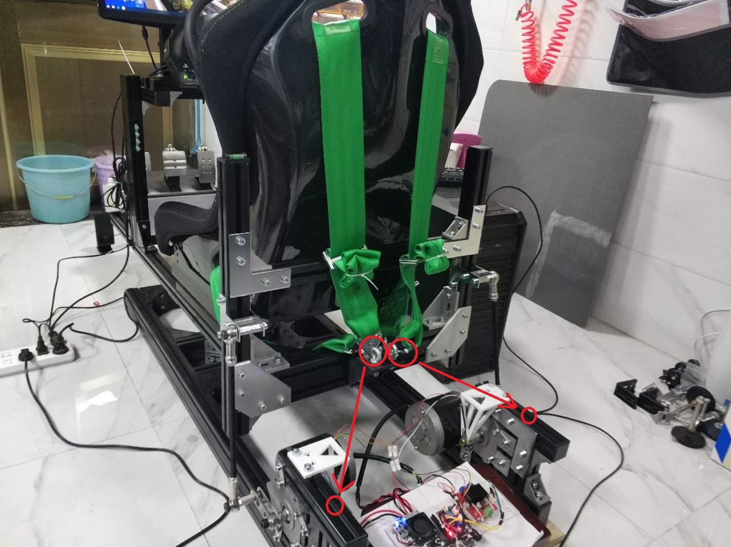

    If you mount your seatbelt on the motor mount behind you (like in picture above), you could potentially have a passive seatbelt motion. The seatbelt will get stiffer when you brake, it gives a nice sensation when braking and also cornering. It's great to use with Surge and Sway.
    The negative side of passive seatbelt is that you will also feel the seatbelt when you use pitch and roll, which is not that realistic, but it didn't bothered me much.
    You can try it, it doesn't cost you anything, maybe you will like it.
    On my rig I have attached behind all 4 points of seatbelt, so I can feel shoulder belts and side belts when the rig is moving.

    i use 2x ibt-2 for one motor but still shutting down motor, you think if i ordered the green board will fix the problem?
