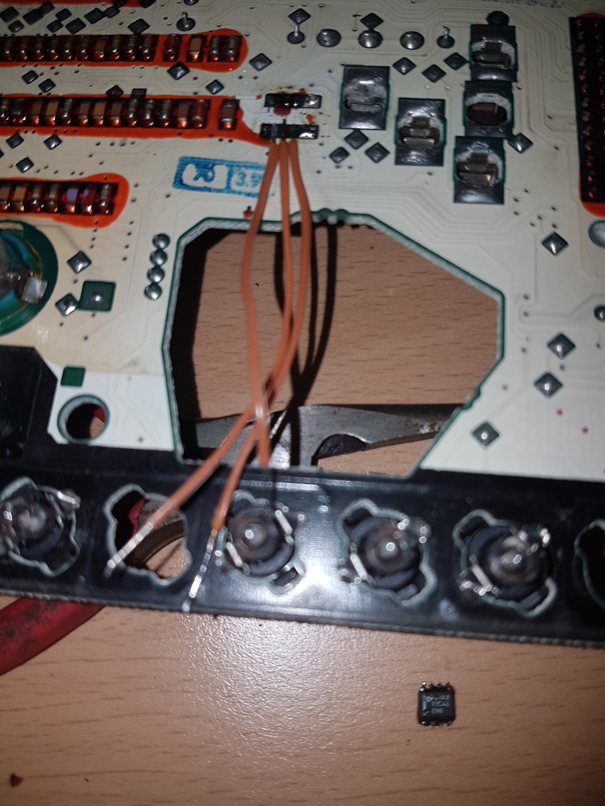

    i know its been a long time since i posted, 1 because i got a new ssd, and 2 ive still got this on going problem with the gauges flicking up and not correctly calibrated, im not that good on ardunio and dont know where to start to write my own code to go from game dash to arduino if someone can point me in the write direction thatll be great,
    on a more happy note ive been hacking the 93c46 smd chip to code it back to 000000 miles for when i have the complete rig..... well to a point i can racing, just so i can see how meny miles ive done in the rig, im using a damaged bmw cluster that the rpm and the odometer lights dont work but i can soo the miles so i can see if this has worked, i hate smd stuff but ive got on order a etching kit to make my own pcb so i can do it better for the real dash, lots of fun fun stuff comign soon :)
    i know this is cheating but ive had to surrender and buy symprojects pro-gauge till i can find out how to get the ardunio to work with all 4 gauges working, any advice will be great thank you.

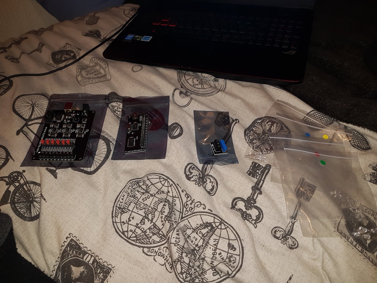

    got off dialysis today to be greeted by the postman, my order from symprojects has come and heres the stuff i got:
    below is the symprojects,
    Pro-gauge + signel extender
    Pro-shift
    5x green,blue,red,yellow 5mm leds
    all in all £79.40 British pounds, concidering the Pro-gauge was £49.50 it has 8 outputs 1 for rpm and 1 for speed then 6 others for water temp and the likes.
    i know i could of used simtools game dash but im not that good with coding and couldnt get it to work,
    im not giving up the idea of using game dash and simtools as i did pay 60 pounds for it and im wanting to us it to add motion at a later date.

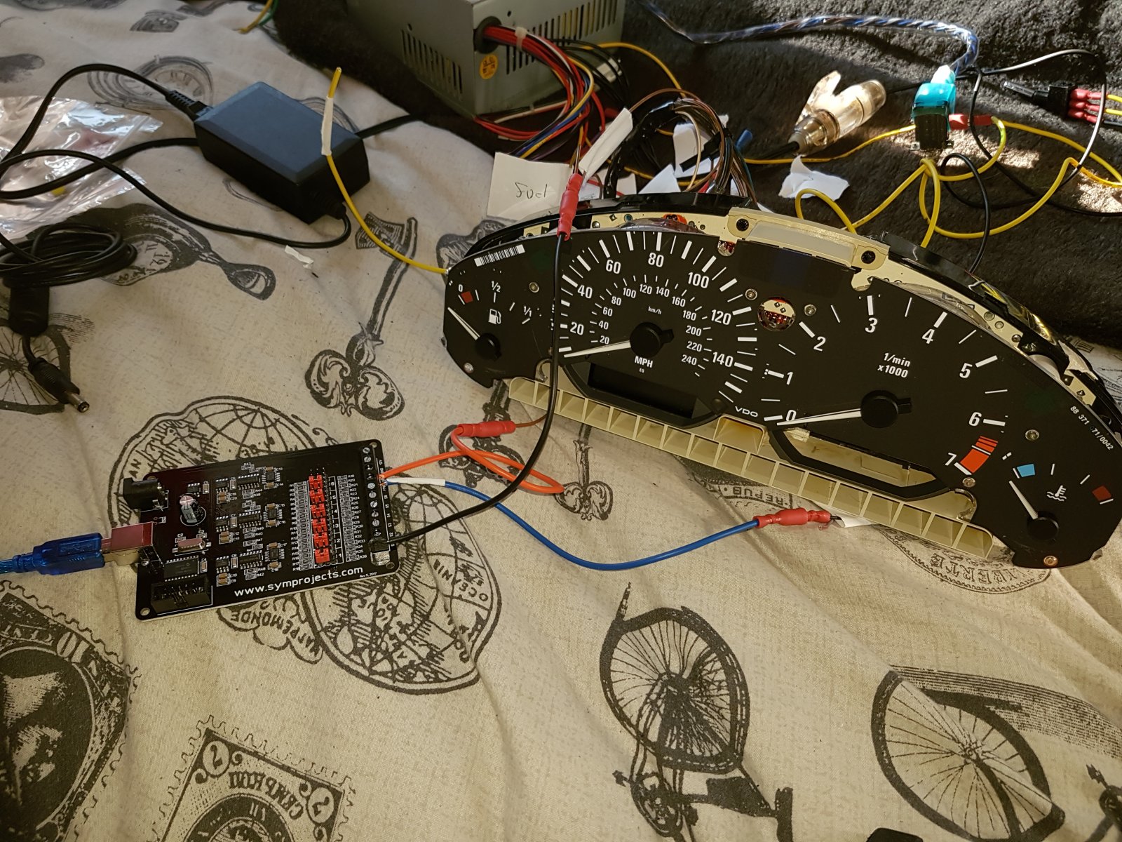

    below is the pro-gauge connected up and im doing some calibration atm before i get it all enclosed in a nice box

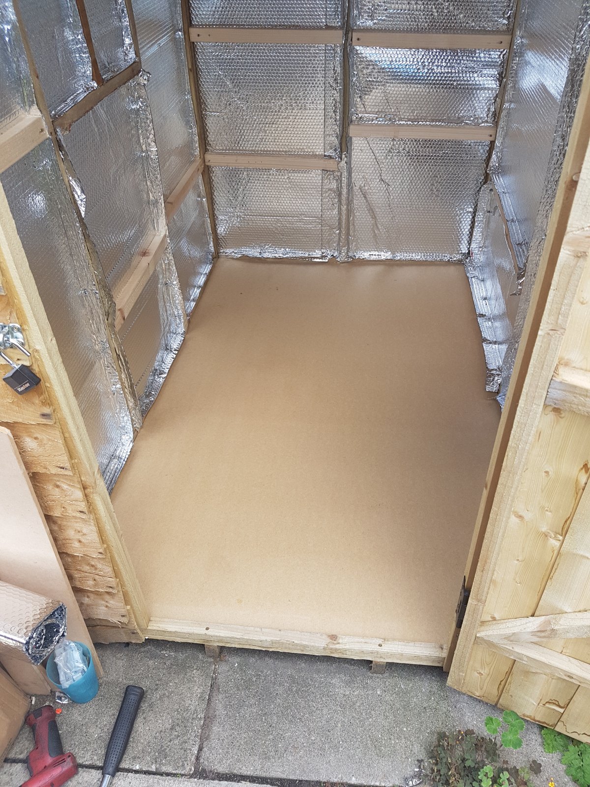

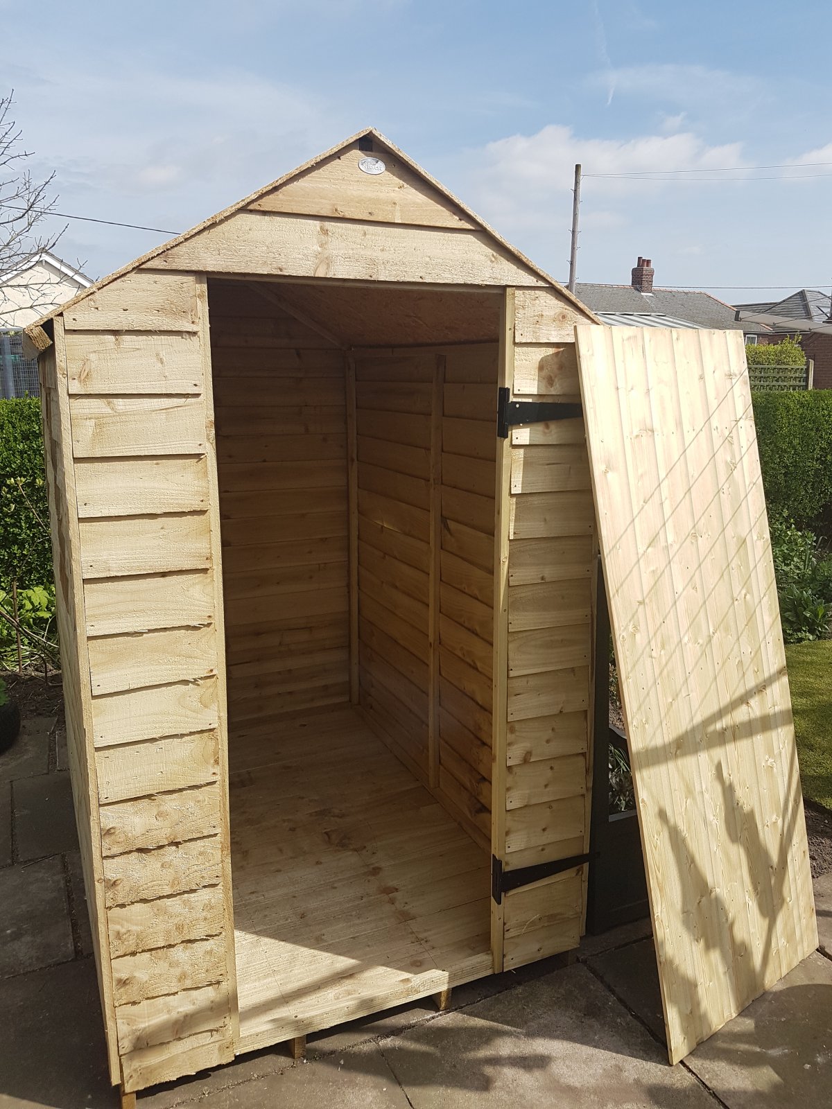

    GOT NEWS!!!!!!!!!!!!!!!!
    shed is built for the sim :)
    sorry i didnt take a photo of it complete but it is all done..... well got to get insulation and board it out but the main bits done :)

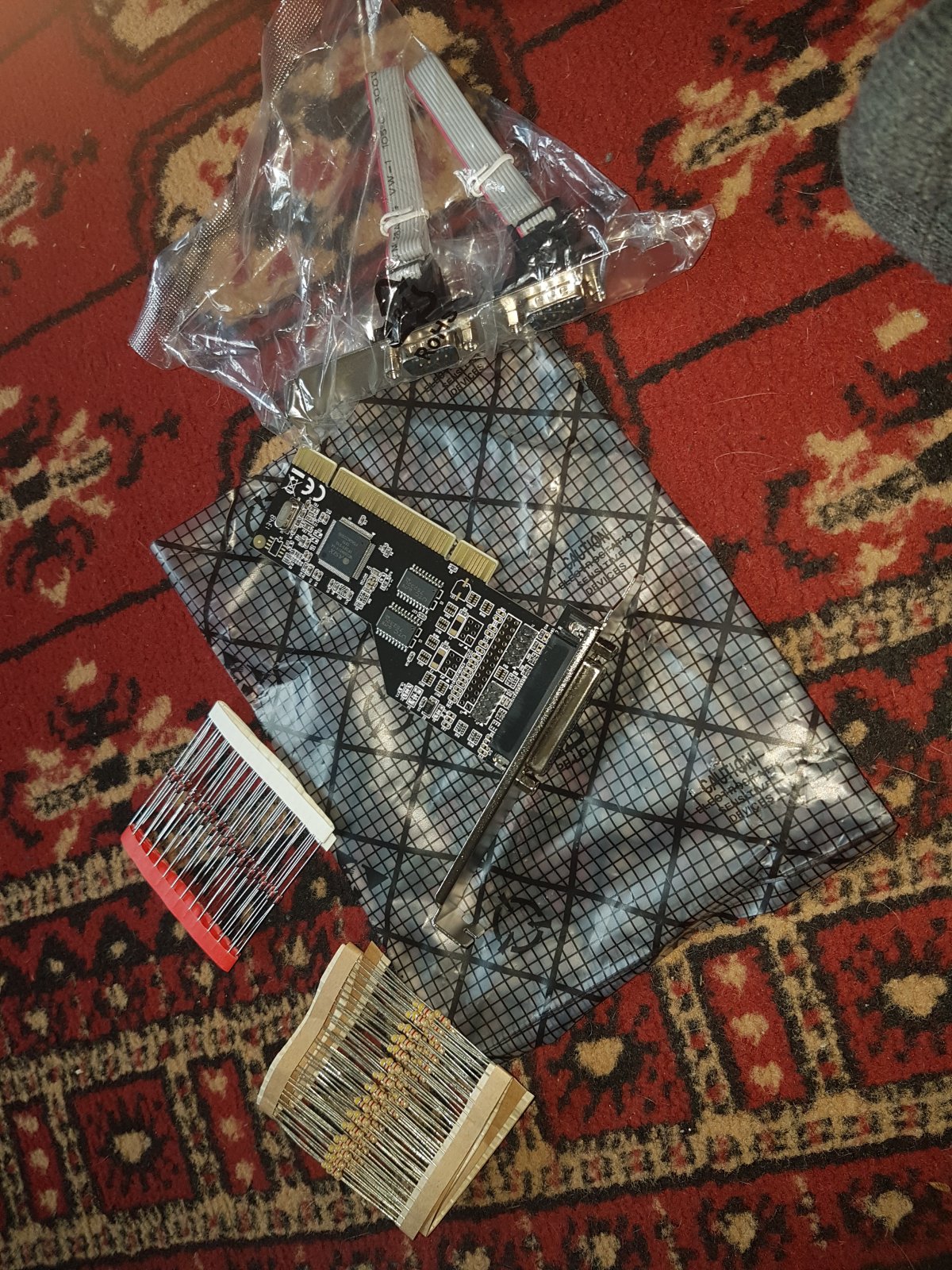

    in the mean time ive been busy on ebay buying stuff and one thing unrelated but will keep me in good order is this :) got two btw
    got my order from ebay well some of it.... zener diodes, 4k7 resistors and a serial card for the programming/workshop pc
    20170412_140553.jpg ,

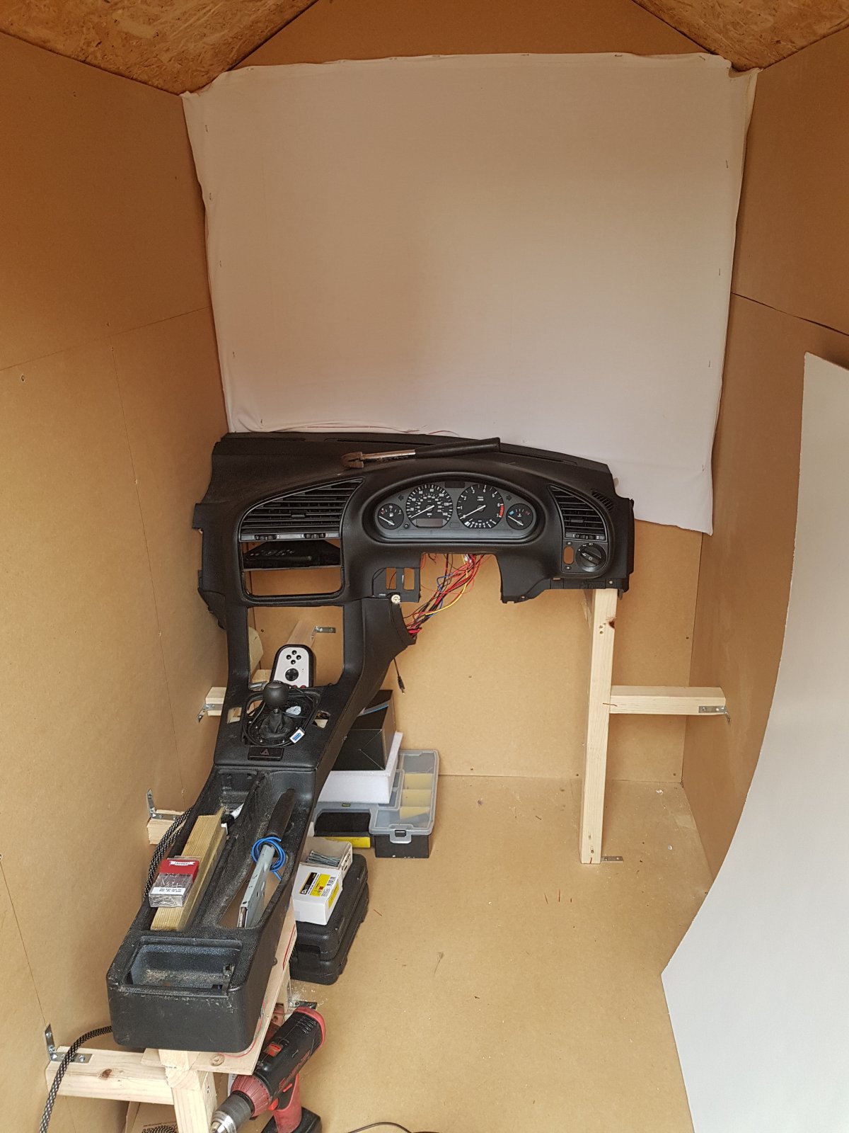

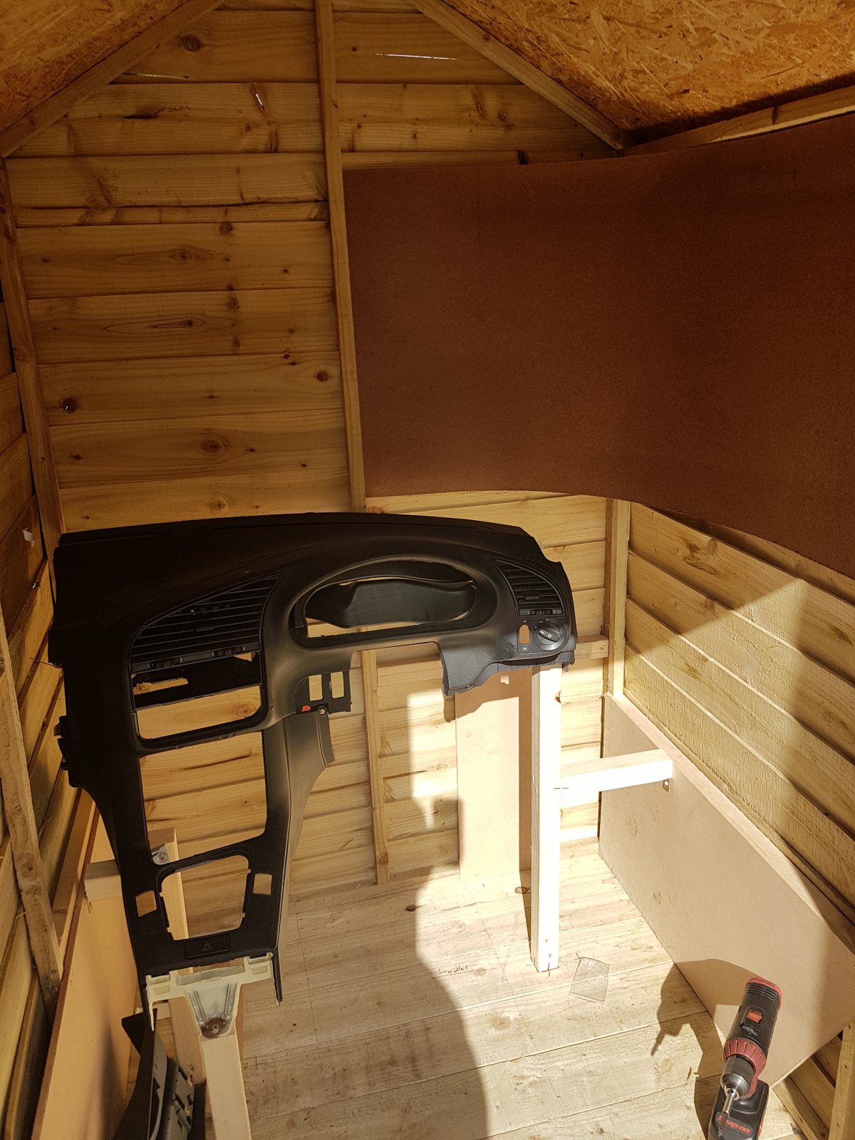

    then i i have to take it all out again after instaling the dash so i knew where to put the support beams
    so i could then do this....
    and the reason for the white hardboard well does this give you any clue
    been a good few days my health has been good enough for me to do this and im yet to go to the big diy shop in town to get some more goodys..... ps im taking the trailer haha lots of good stuff :)

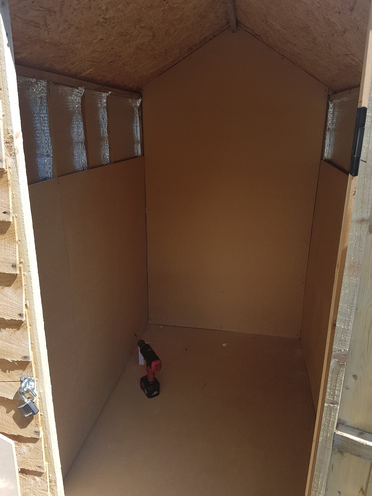

    got the instlation all installed so now it time to panel it out......
    hmmmmm my cats on the trailer..... and i need the wood thats on it :(..... work postponed hahahahaha
    right now on to the good stuff

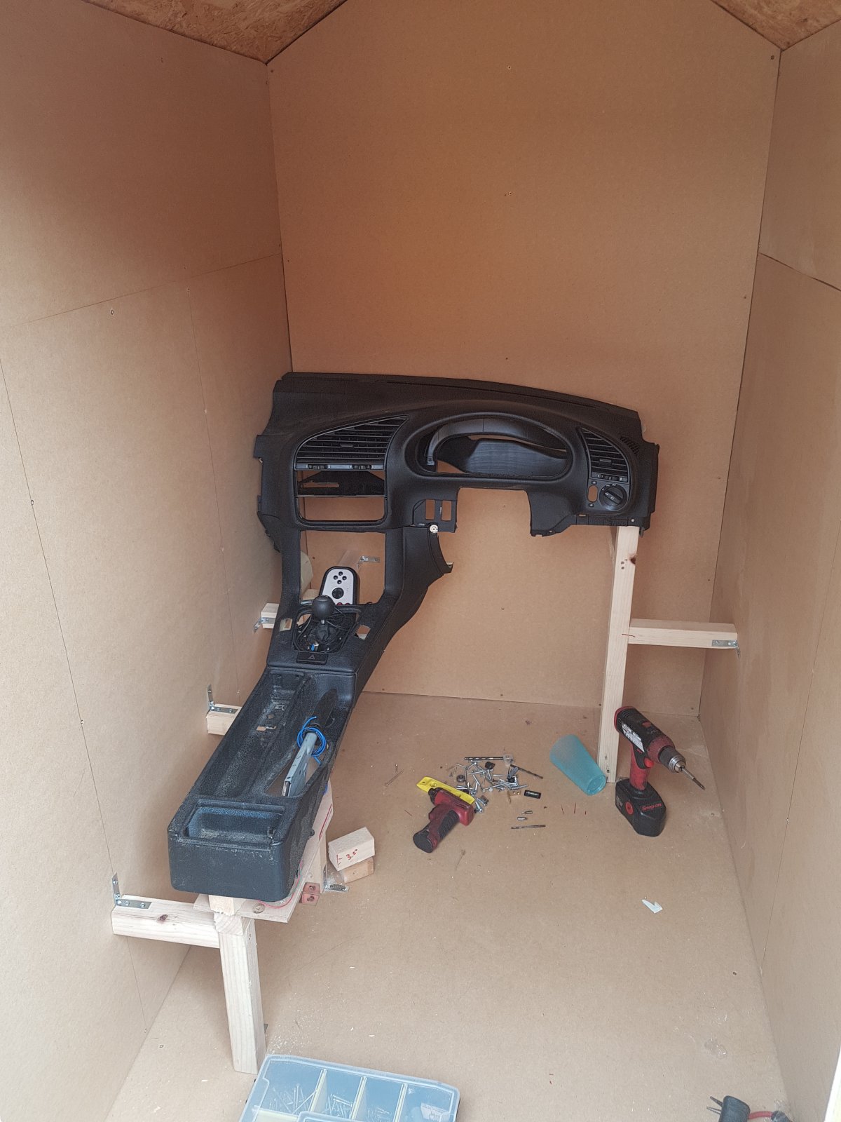

    floors in....
    got some walls done and its hard work with kidney failure... im not moaning im just sayijng i drank alot that dayu hahaha,
    skip ahead abit and i got the dash in
    there more but not got pics yet, just a very secure door has been built and lockes fitted someones gonna think im hiddening something,
    got some plans drawn up for the motion still working on the best way to do it,

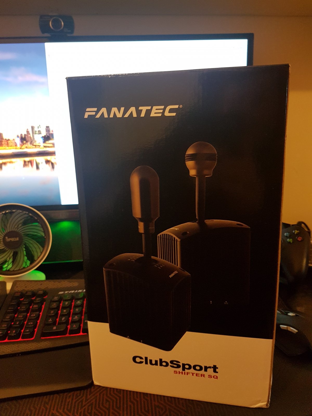

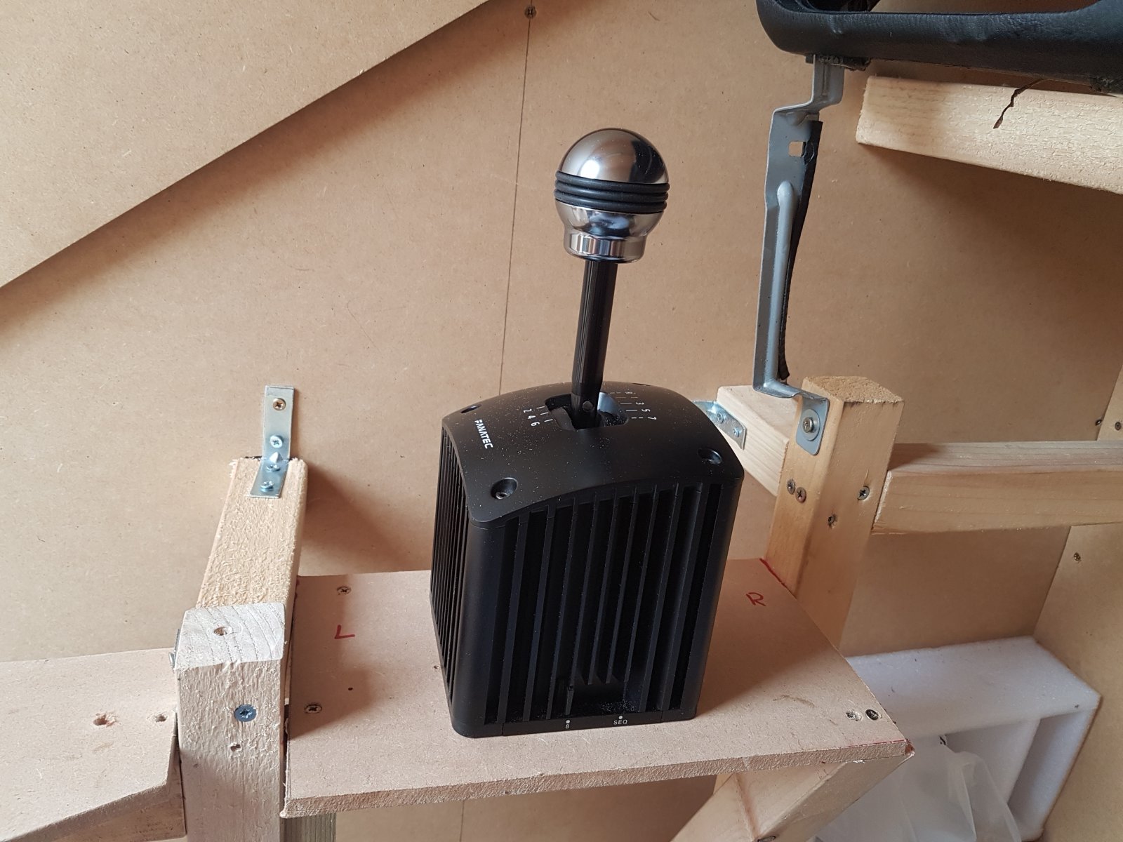

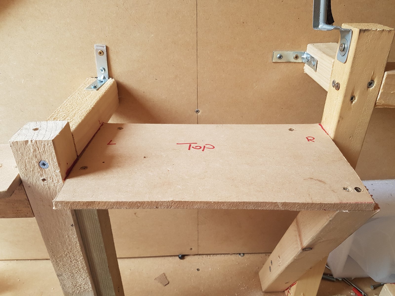

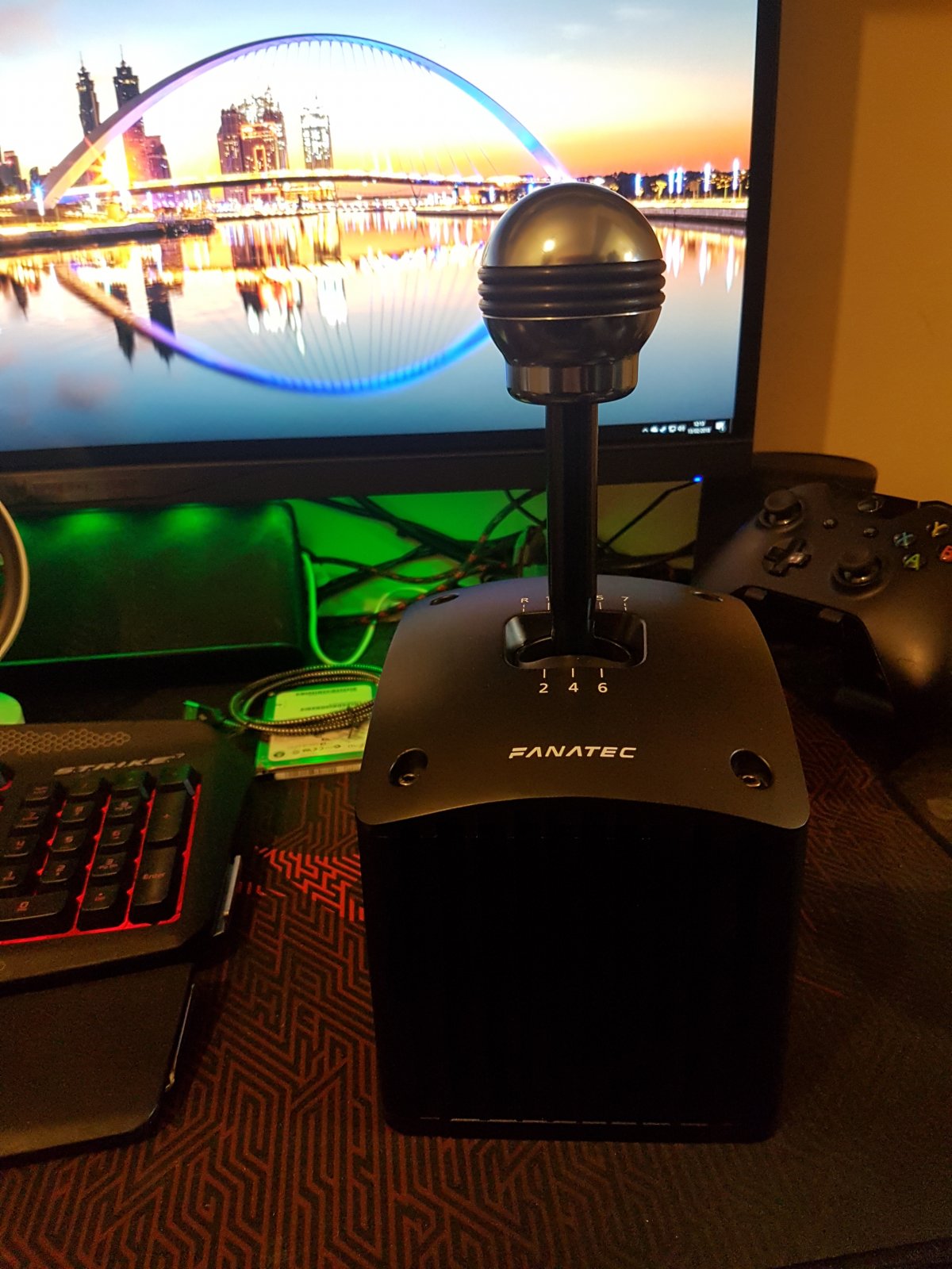

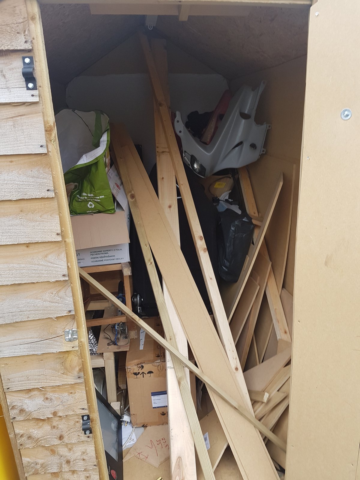

    hey all, well its April and in the UK in it very hot..... not a cloud in sight, so I got some work done in the sim shed,
    first thing I have to do I clear it out of all the junk and wood that has been stored over winter.....

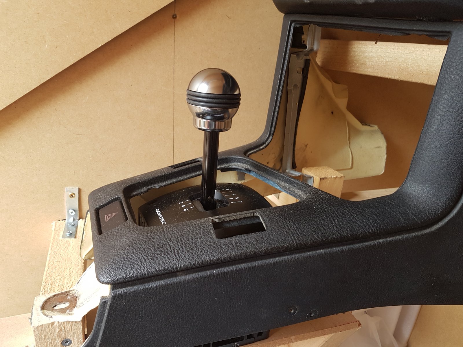

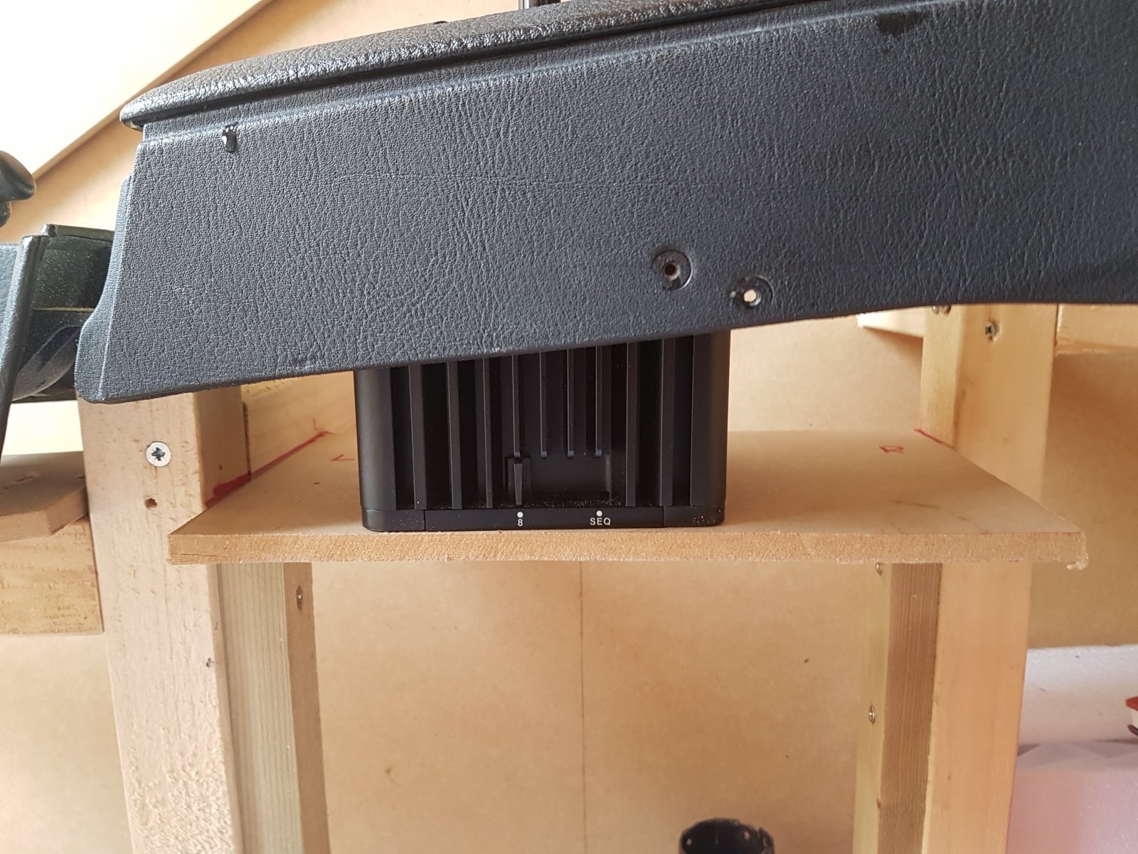

    here I used a scrap bit of MDF to make a base for the Clubsport shifter,
    square it off best I could, I could get the table saw so it had to be a hand saw for now, but will be getting it out soon as i can get at it,
    here is a couple of photos of it in place sort of, and also with the center console
    and here it is attached in place and i can tell you i can tug on that all i like it ain't moving,

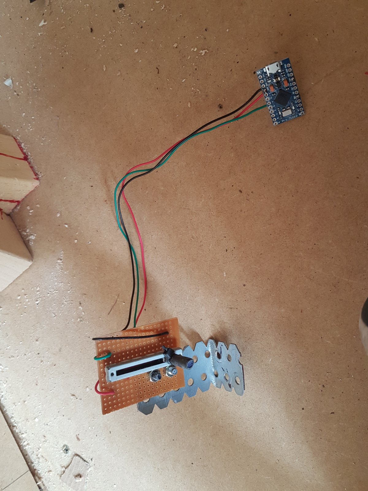

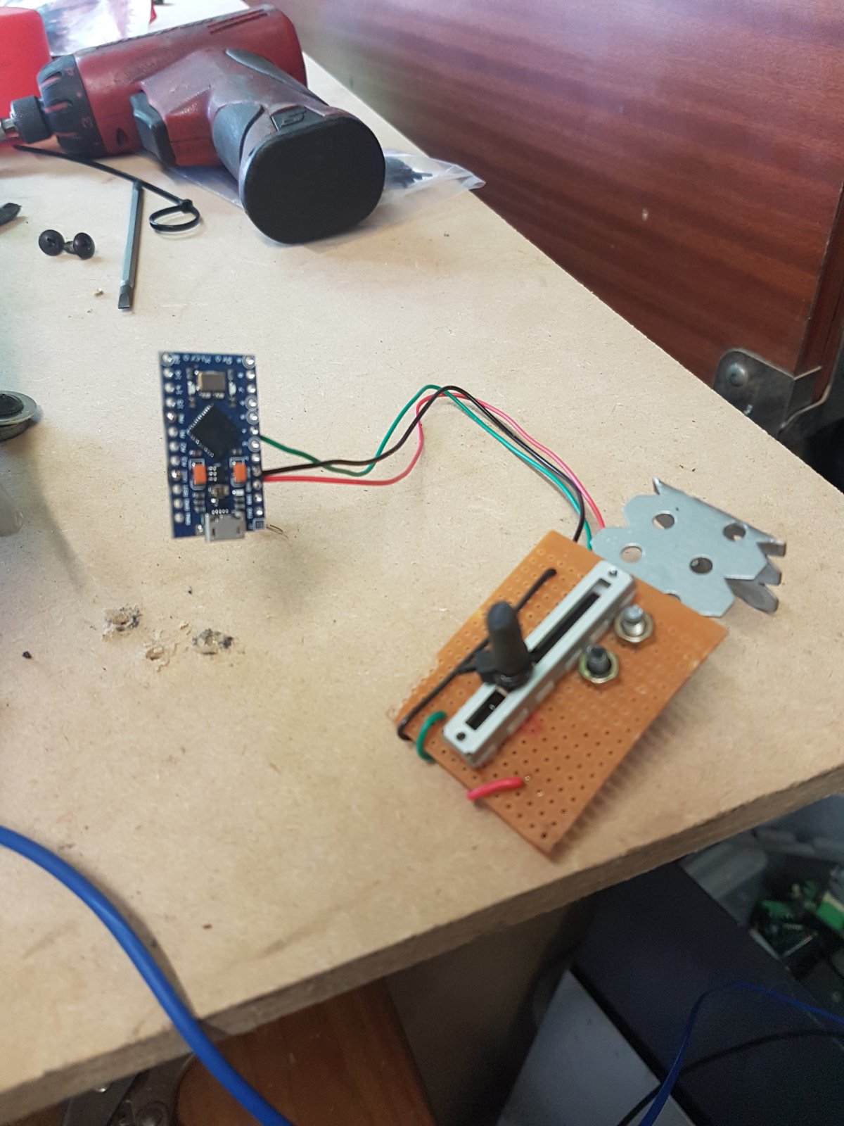

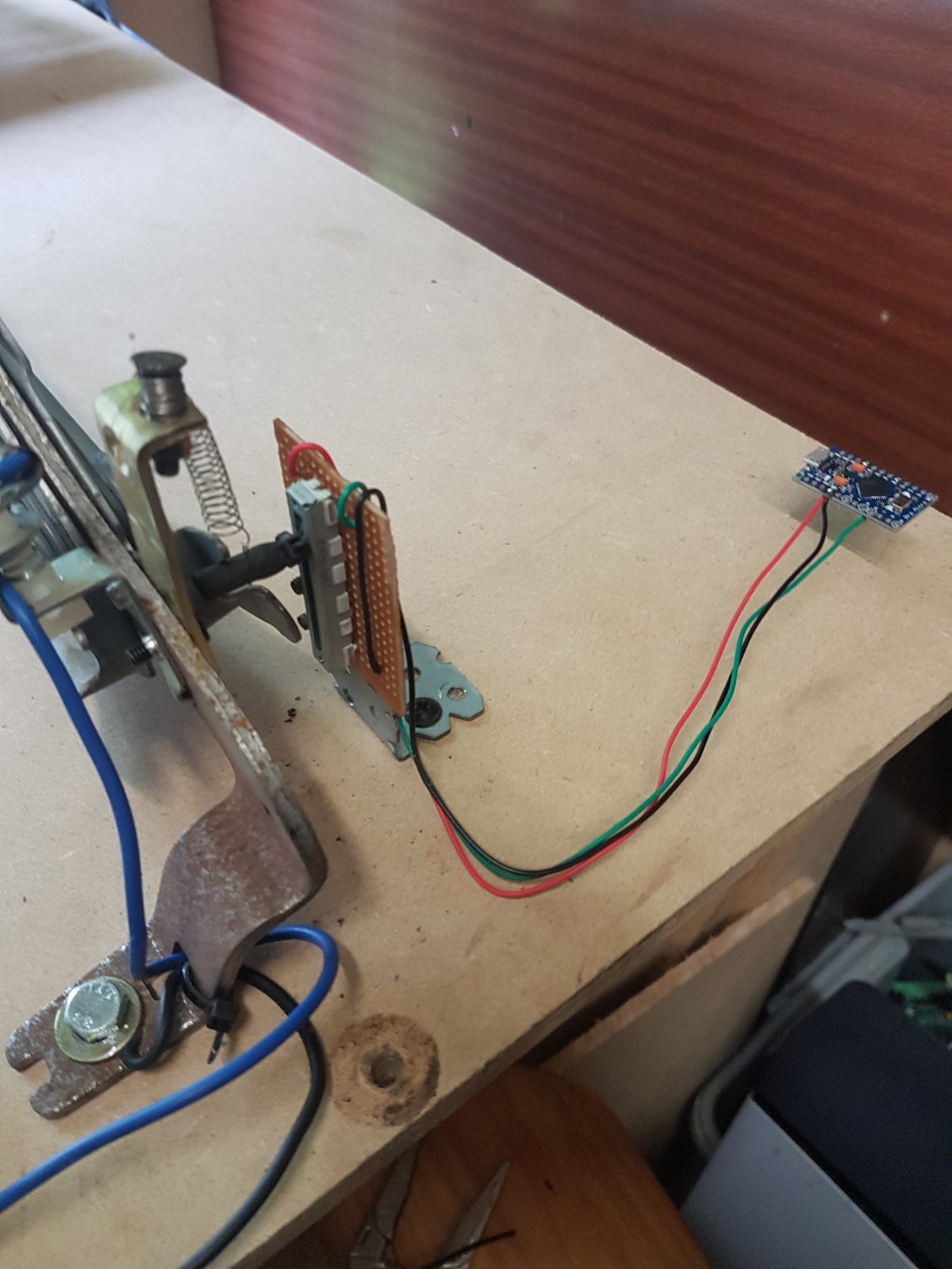

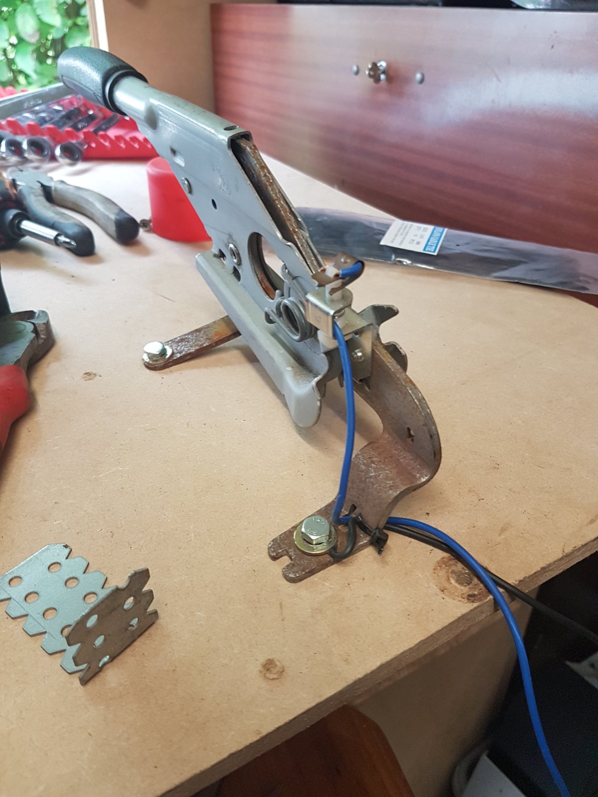

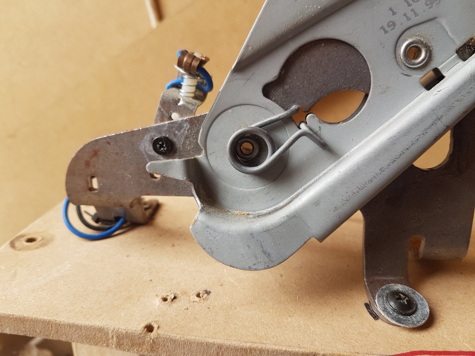

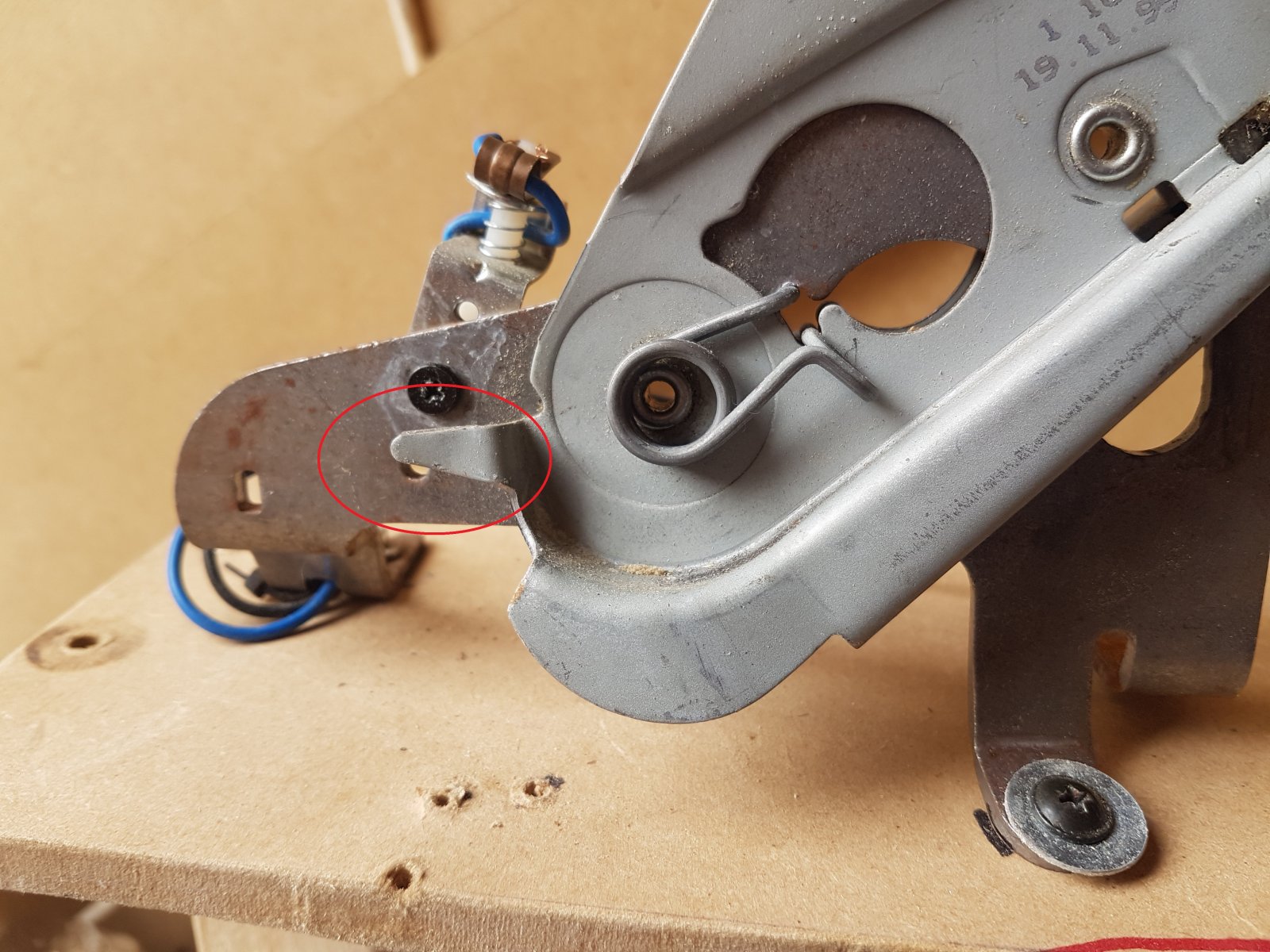

    the second was to have a look at the analog handbrake as the center console was hitting this
    this is what the slide was attached too
    so I've had an idea to use the pivot point of the handbrake here 20180417_130123.jpg
    may need to use epoxy or weld a pot in place, wiring to the Arduino will be the same,

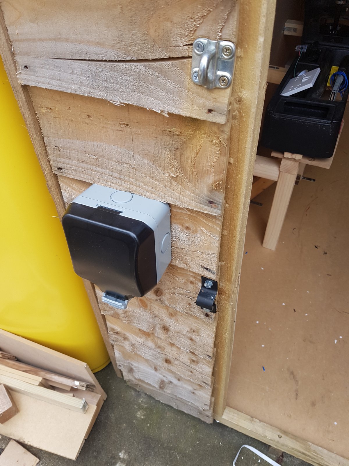

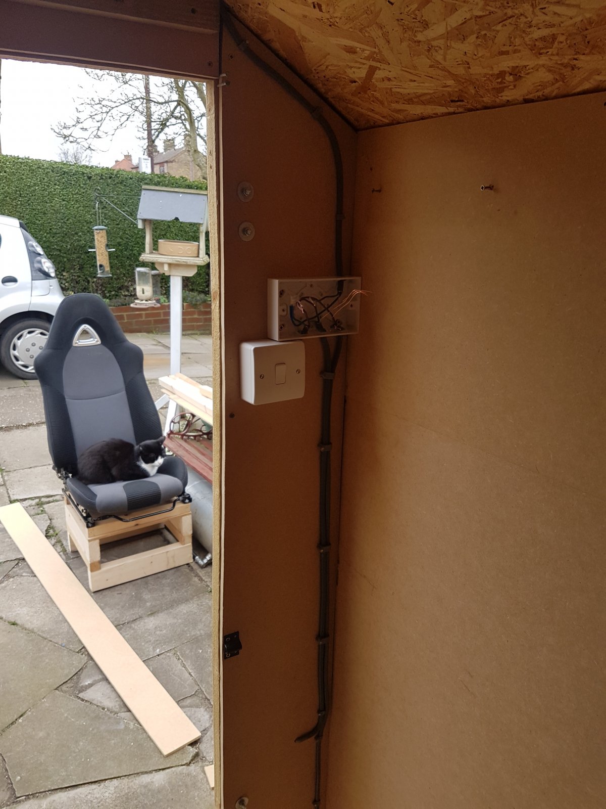

    got the 240v electrics almost in place, this looks dodgy but this is the input for power i could get hold of a caravan plug so ill make a double-sided plug to connect it, just got to not be silly and poke the other end lol,

    but yes let ignore that for now, and I've been working on the sockets and switch
    and yes my cat has claimed the Mazda RX-8 racing seat lol
    P.S if you're wondering how I'm going to change from h pattern to sequential shifter I'm going to use a car door look actuator to switch between them

    Well I can update you all on the weather.... it’s hot.... very hot... I finished the 240v electrics and have power in the shed, got the temp pc cobbled together and got a post just need to install windows 10 and in tidy it up, didn’t take any picture but I think it was about 28 c outside in the sun in felt like a million.
    And with it been so hot that’s all I got done.... I may have drove to raf coningsby to watch the Lancaster and typhoon fighter fly for abit so that stopped the work....
    Other then that not much hoping for a cooler day on Saturday I won’t be outside tomorrow but will sort the pc out, I’ll hopfully be out Saturday with the pc and some gauges and a game running :p
