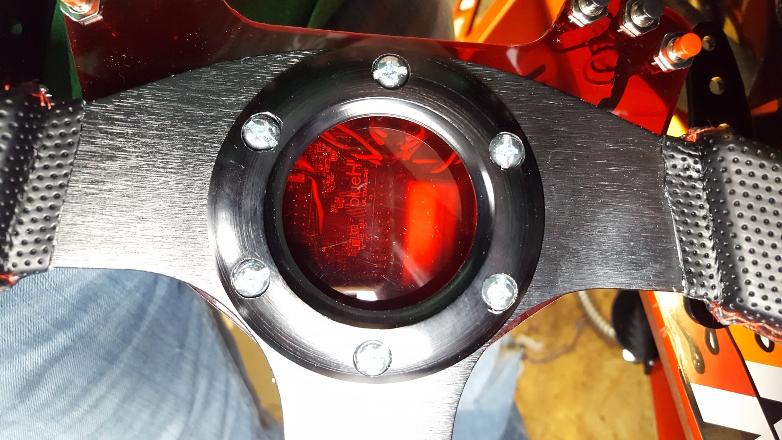

    While getting help setting up my simucube from Jason Jodarski (ty) over at Iracing forums, he pointed me toward this little device. It has an onboard charger and is Bluetooth 4.0. It can be used for pedals, buttons, keyboard, quaderature, and many other types of input. It has a config utility with an amazingly simple GUI and needs no drivers or software to run except for BT4.0. It can also control LEDs.
    http://www.u-hid.com/home/overview_bboard.php
    [​IMG].
    Below is an overview as well as a basic setup guide.

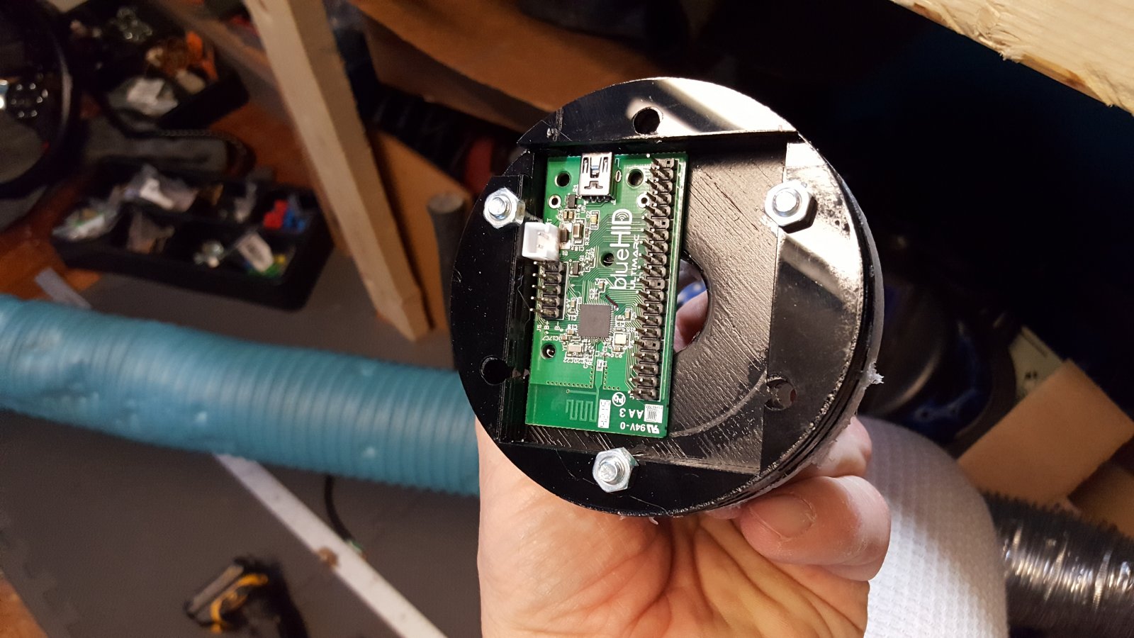

    First make sure you have bluetooth 4.0 support.
    If you have a windows 7 pc you will need a CSR dongle. along with the CSRSTACK software.
    WARNING THIS DOES NOT APPLY TO WINDOWS 10 DO NOT INSTALL CSRSTACK ON A WIN 10 MACHINE.

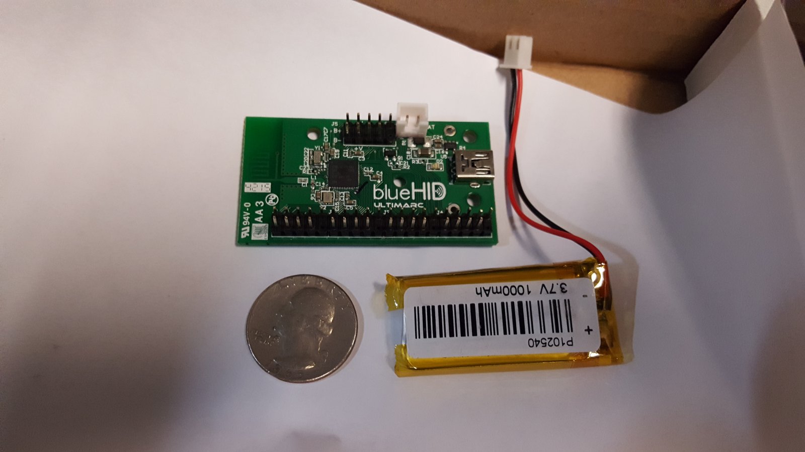

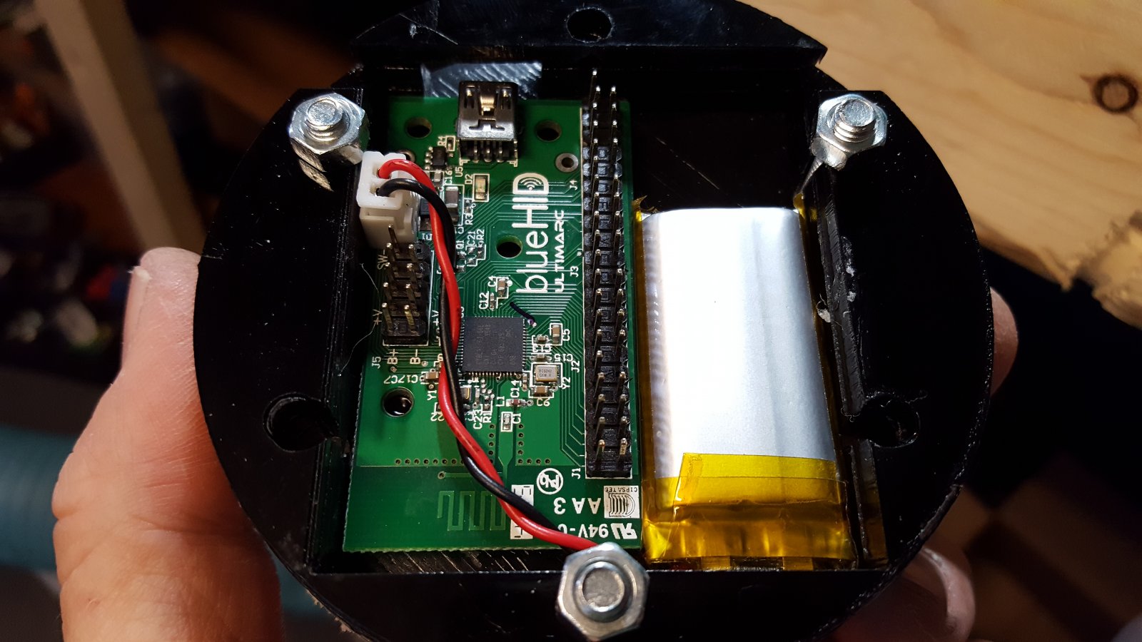

    When it arrived I was surprised at the small size. The battery is the one that Ultimarc offers.
    As you can see it is simply a 1000mah lipo @3.7volts. this is a very common battery and can be redily found at a discount on ebay like this one for a couple dollars.

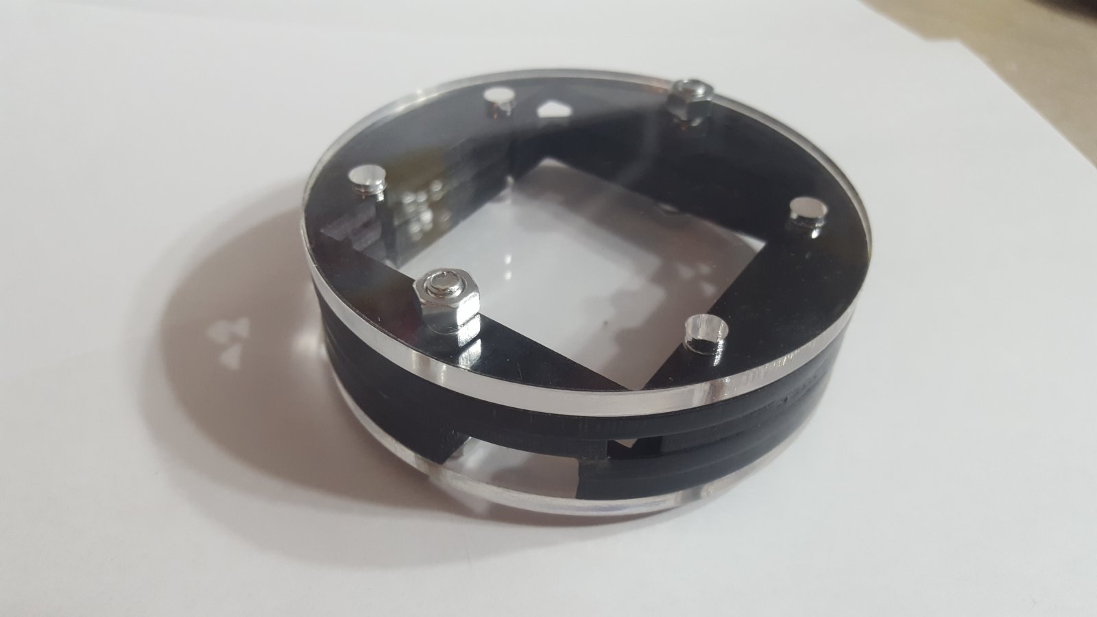

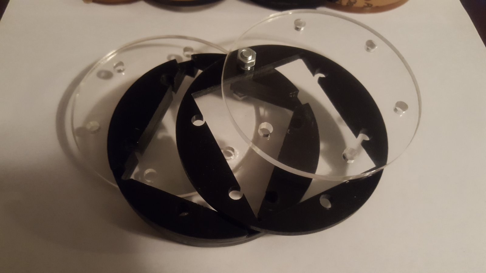

    I got the unit all charged up then decided on a simple layered acrylic "project box". (files coming shortly).
    Your gonna love this lol. So next I used HOT GLUE to fix the battery and circuitboard to the @RacingMat QR. there are 4 layers of 3/16 acrylic which is plenty of room for the "spaghetti" wiring.

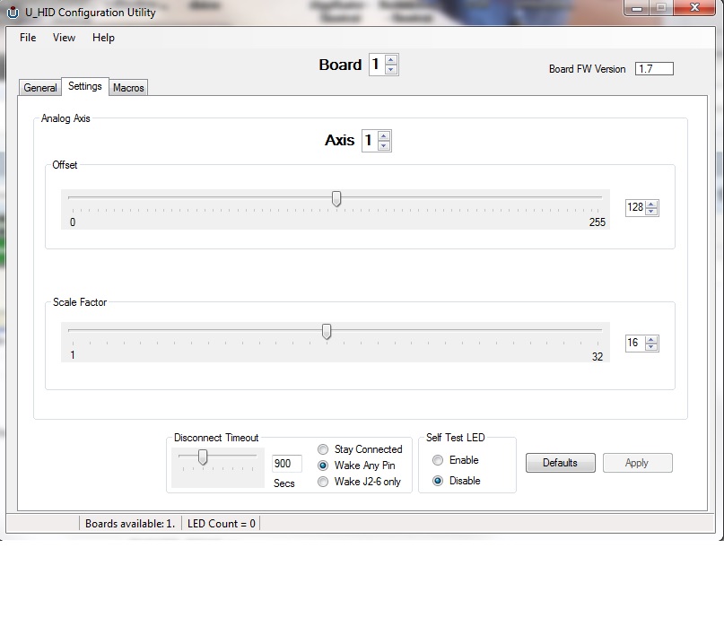

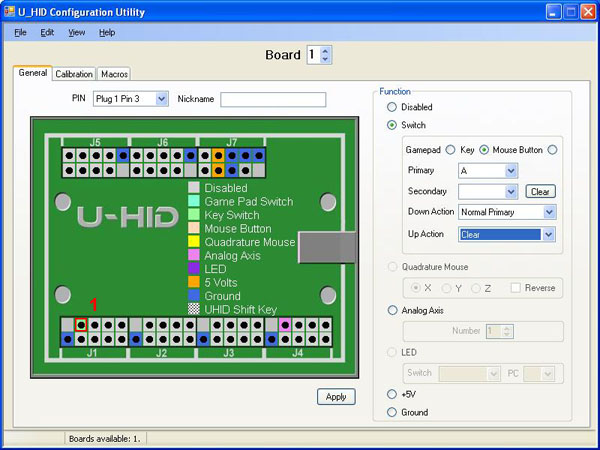

    The next step is to download the U-Config Utility. This GUI is what sets the Bluehid apart from other solutions such as leonardo/promicro and teensy, although those are great low cost devices.
    As you plug in switches, buttons, etc., I used N.O.( normally open) buttons and switches, you will be able to define the function in a number of ways. also any pin can be assigned as a ground this expands the wiring options.
    There are a few ways to save power. I use the wake any pin with a long delay. I just press a few buttons as I'm mounting my wheel. Others are putting a power switch on pins J2-6 and using the appropriate setting.
    GL:thumbsEnjoy!!!!

    Roughly how many hours did you get out of the 1000mah ? I know i can run a solid 45 min on 900mah in RC with a pair of Hungry 1/8 servo's....but as to what a Button plate draws in mah/h.....no clue.
    I dont mind charging more often to get a smaller pack.
  9. bruce stephen
    Jun 7, 2015
    1,286
    general contractor
    michigan
    9,115Coins
    +1,243 / 9 / -0
    It would be fine I'm sure. Next one I'm just using a 650mah. I have a bunch from drones.

    I got three weeks, racing a couple hours almost everyday, with only 10% higher capacity. Good thing is if you let it die it will run with the cord (power/charge only there is no serial/usb interface).
    I plan on a button box with this device. I am gathering parts. Less wires the better.

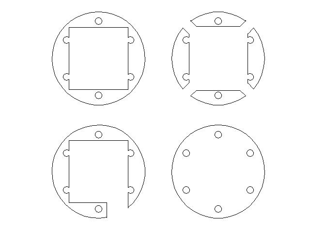

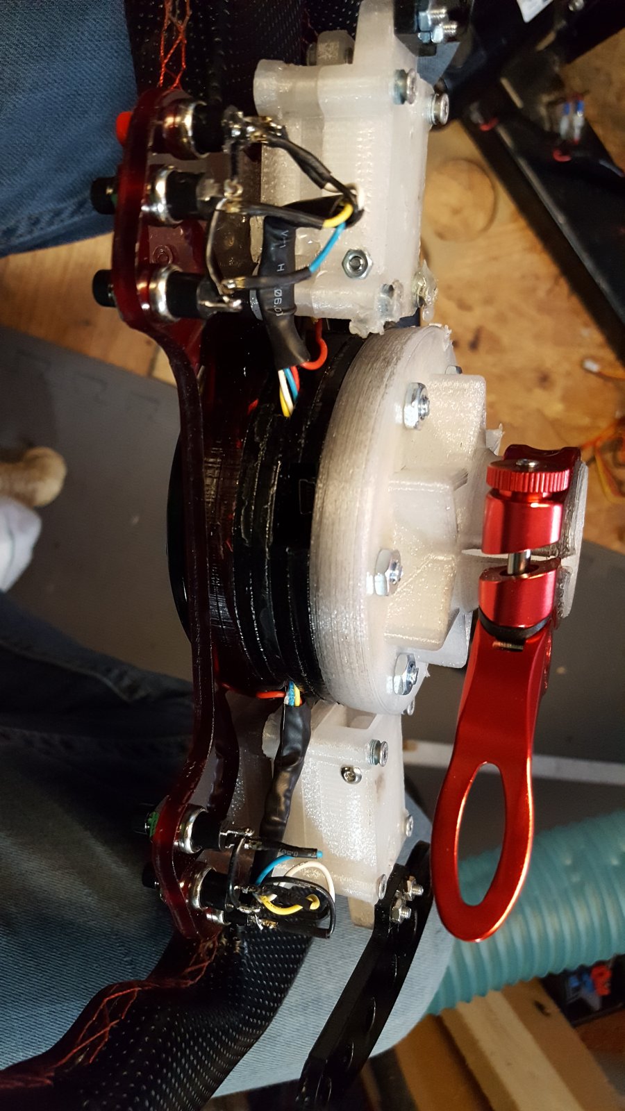

    This is a wheel spacer, electronics box. I would be happy to share the files but they are .mdr format for moshidraw(the app my laser runs from). Unfortunately it doesnt allow export to anything other than image files like bmp and png.
    • Like Like x 6

    If you could post in PNG i, can convert that to pdf, then convert from pdf to DWG/DXF. To be honest it would probably be quicker to just draw it lol. What be the outer diameter of the disc Mate

    88mm. I can post it later. I just wasnt sure if it was useful that way.

    Yea thats fine mate cheers. As long s i have 1 known dimension it works

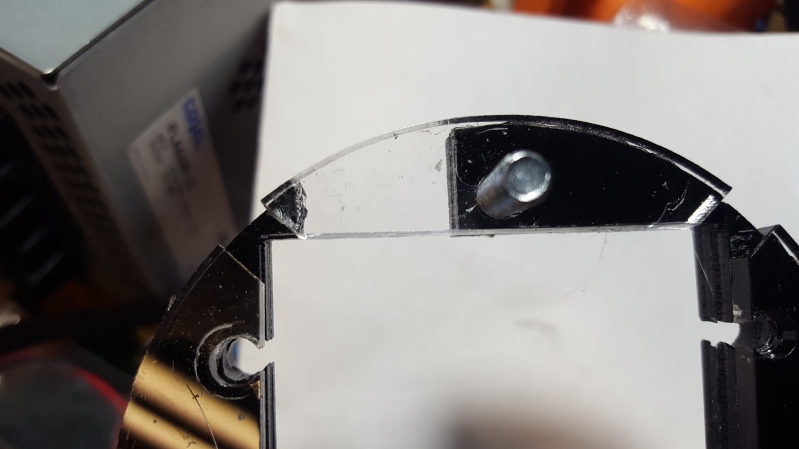

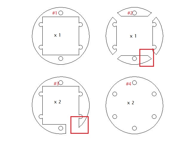

    @bruce stephen I think this is basically what you have. Have you glued some bits together?
  17. bruce stephen
    Jun 7, 2015
    1,286
    general contractor
    michigan
    9,115Coins
    +1,243 / 9 / -0
    yes
    when you stack them you will want the part on #2 to lay on the part from #3. this will separate the holes and provide strength.
    the top piece is clear. i am going to experiment with sidelighting the clear layer.
    then i glue just the three pieces together 2x#3 and 1x#2.

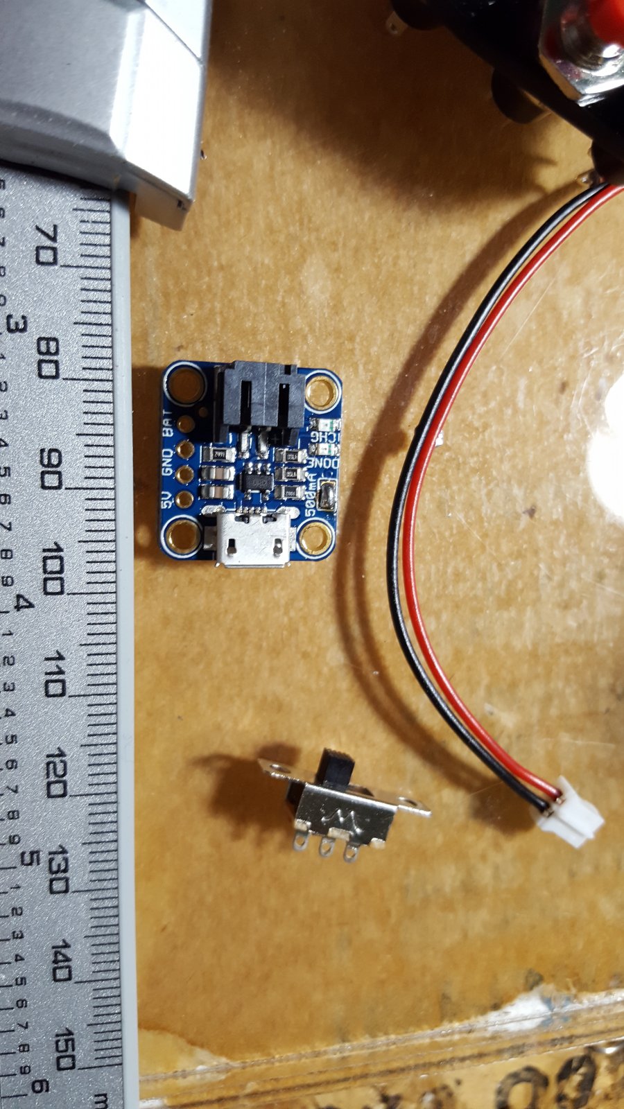

    I plan to mount my Battery and my Board inside my Wheel enclosure with no real easy access where it will be installed. Therefor I need a header to extent the Micro USB port on the board itself.
    These should suite nicely.
    http://www.ebay.com/itm/311713710994
    Im also contemplating how i can do a quick change battery tray of sorts for the enclosures.,,..but im coming up blank with ideas. :think
    Smallest reasonable Mah pack i can find is 43 x 24 x 10 so the room in the enclosure is limited.

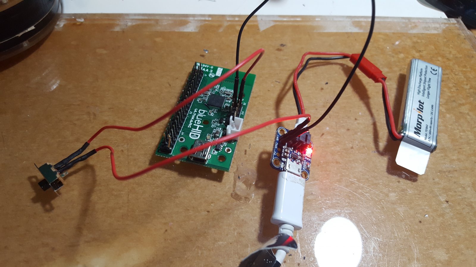

    funny you should mention it. I just got these in the mail yesterday. I will be using it to charge the battery it has charge indicator leds the blue hid doesnt have this.. thw switch is used so the Bluehid can be left in always on state. On long oval races the board will shut down during a long green flag run.always on prevennts this.
    https://www.adafruit.com/products/1904

    This is how the circuit will be wired. this will also let me use very common usb-c (most new phones) to charge. 650mah battery shown.
