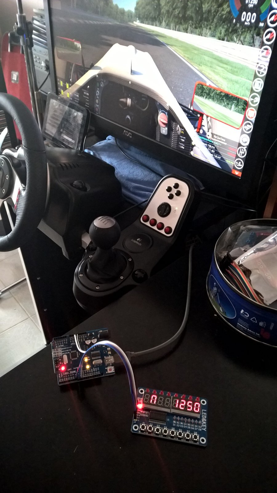

    I got an TM1638 Module for Arduino that I use with AssettoCorsa, it has 8 leds but just 1 color - red - for led (there are modules with two colors for led: red and green)
    I use the Arduino software from one AC member that you can find here: http://www.assettocorsa.net/forum/i...2-1-3-for-ac-v1-0-rewrite-auto-updater.14172/
    Leds can be lit in one or two sequences, so 8 leds or 16 leds (two times 8 leds), but are thought for the two colors modules, so I changed the sequence to anyway use the two sequences but with just one color:
    the first sequence it lits up one led at a time from left to right, the second one lits the leds always from left to right but keeping 'em all lit.
    A video is better than my confused words :)
    Edit:
    This is the code I used:
    PROGMEM prog_uint16_t ledsLong[2][17] = {{0, 256, 512, 1024, 2048, 4096, 8192, 16384, 32768, 256, 768, 1792, 3840, 7936, 16128, 32512, 65280}, {0, 1, 2, 4, 8, 16, 32, 64, 128, 1, 3, 7, 15, 31, 63, 127, 255}};
