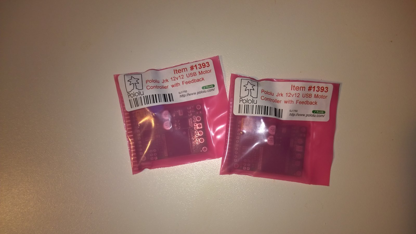

    I got the two pololus yesterday, and if my daughter should ever decide that night is fine for sleeping... :rolleyes:

    MAKE sure to clip the little blue thing's together, Seen oh soo many guys (myself included) who just solder both on separate, They hold MUCH better when clipped together and soldered as a whole.

    I had some problem with those blue things on one pololu. with the first one all went smoothly, but with the second one I had problems with the soldering of the power clip and with the pot (I didn't solder it to the fb but to the aux... well, it was 1am...).
    Then I started the JRK Configuration utility and again the first motor was a success, but the second... After setting all parameters as @bsft suggested, I set Max and Min values through the learn tool, but I didn't invert the input direction and as I started the motor it was a mess.:confused:
    Another 30 minutes of work and I fixed the problems, set SimTool settings according to the switch from Ard-MMs to JRKs, lauched AssettoCorsa and enjoyed the rig coming to a new life :D

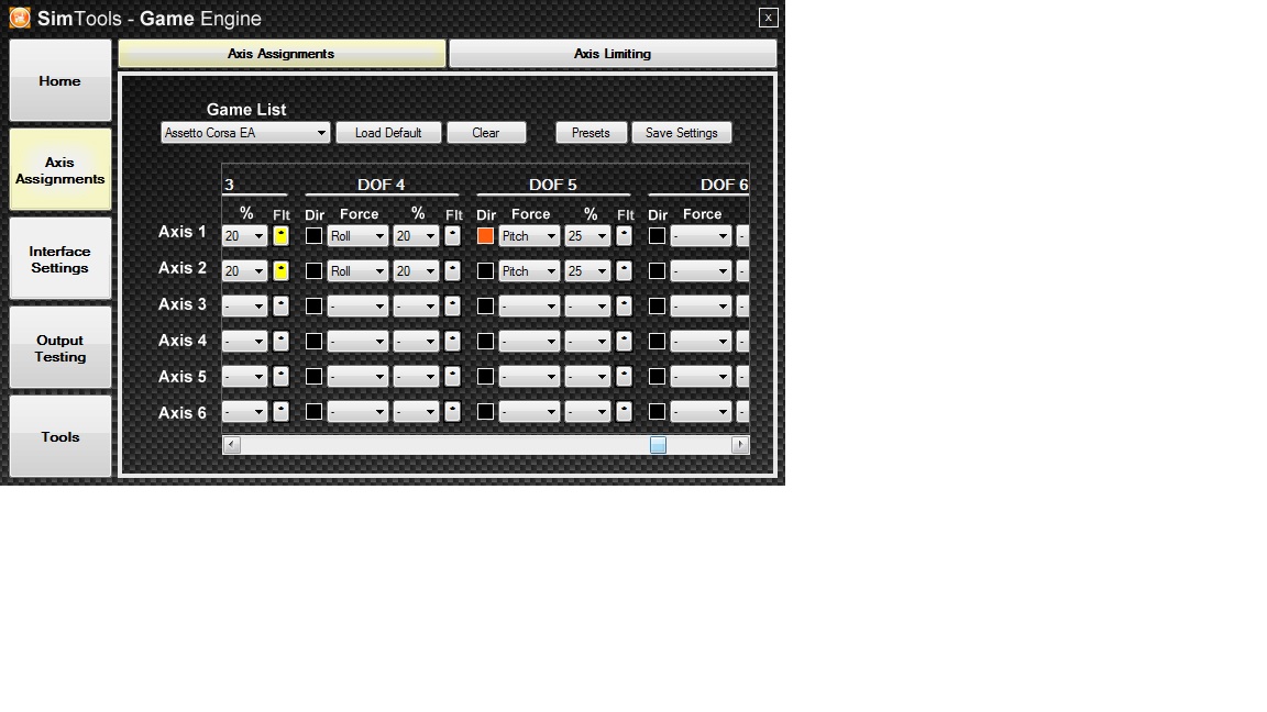

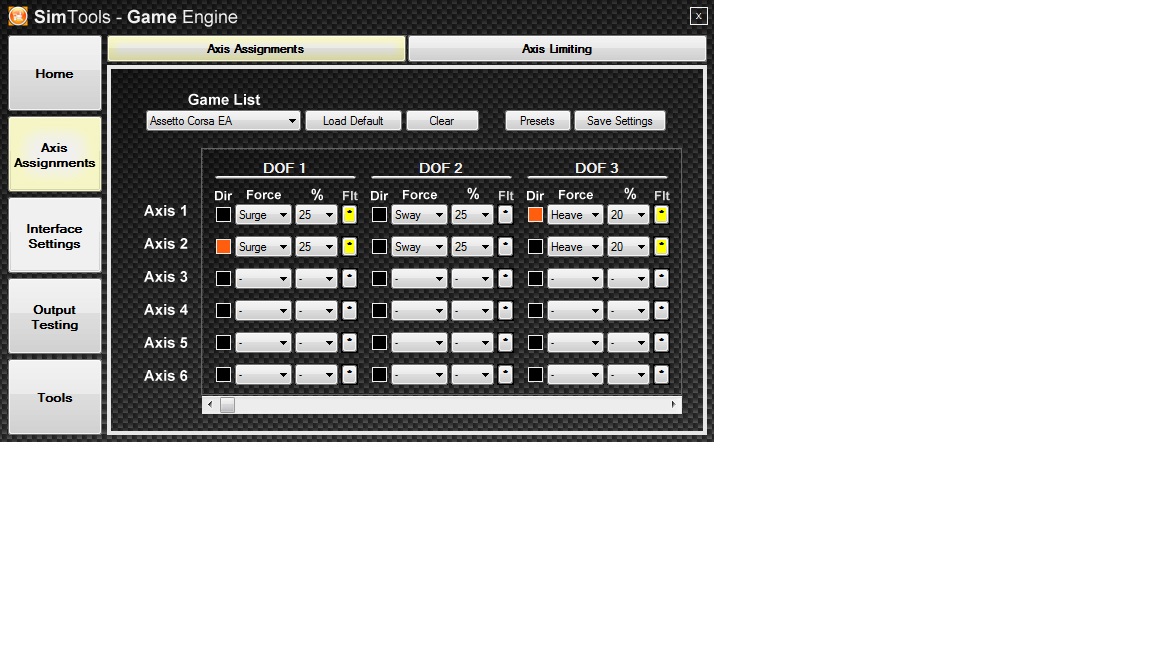

    I think I used about 3 in the boundary filter @Blame73 , just take it out if need be, and my motor directions are probably wrong compared to yours, just test each force and get the directions right.

    @bsft: I have rather similar settings, only "Roll" and "Pitch" way less %. "Roll" I use most notably for the curbs.

  15. bsft
    @Blame73 In the tuning centre, Try decreasing the surge MAX number down, it should be very snappy on juice pedal mashing and should also give you the desired gear change effect.
    Make surge MIN bigger if you like less braking feel force.
    EDIT, in the tuning centre for surge, make sure the little tick box is un-ticked, that way you can have 2 numbers.
    @Pit , thats why we have documents for profile setting, so each person can individually set how they like the motion.
