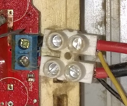

    Due to my stupidity I'm a new adept to the 'MotoMonster Explosion Party' :(

    Oh dear looks like you reversed the polarity ?

  9. SilentChill
    2,645
    20,588Coins
    +3,566 / 34 / -0
    That wouldn't blow it up tho. You have the 12v input wires wrong way round on your pic if your colours are red for positive and black for negative
    Right input = Negative
    Left input = Positive

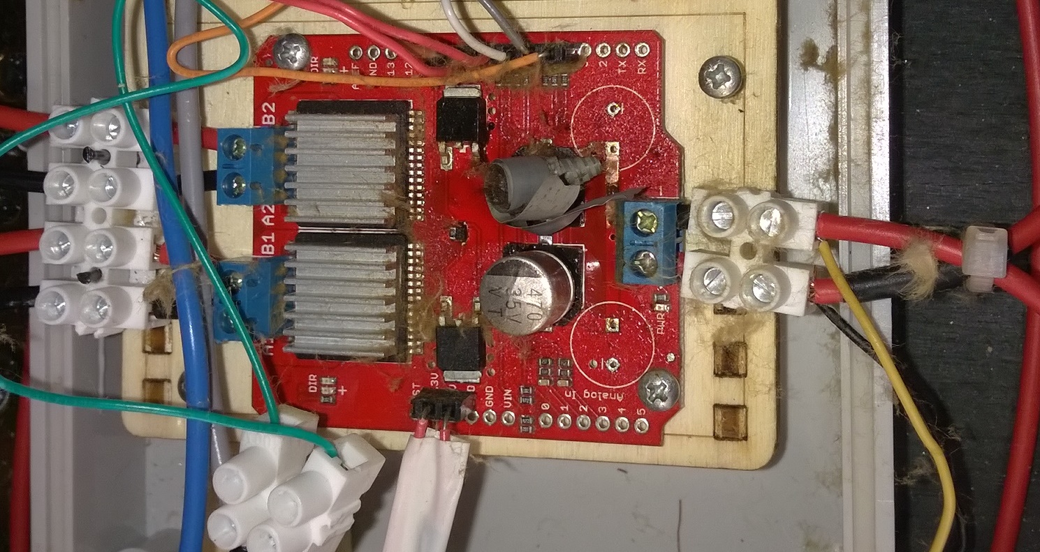

  10. SilentChill
    2,645
    20,588Coins
    +3,566 / 34 / -0
    If you just replace the capacitors it may still work you would have to try and see.
    I did the same with one of mine and it still working now.
  11. Blame73
    Blame73 Well-Known Member
    Nov 6, 2014
    1,215
    8,303Coins
    +1,129 / 4 / -0
    thanks for the info @SilentChill , I'm going to try replacing it.
    Do you remember the specs of the capacitor?
  12. SilentChill
    2,645
    20,588Coins
    +3,566 / 34 / -0
    470uf 35v I just used a random 470uf 24v I think .
    Just make sure you check your motomonster power input polarity before you connect it. And then check it again and then connect it up ;)
  13. Pit
    3,012
    30,482Coins
    +3,097 / 31 / -0
    Agree, 5v does never kill the MM or Arduino, and please @Blame73 NEVER use two red wires even if one is marked with a black tape. At least the lagging (or wiring isolation) is not as well it should be (friendly bashing ;) ). The damage is not so big, in your stead I would order more than only one sample.

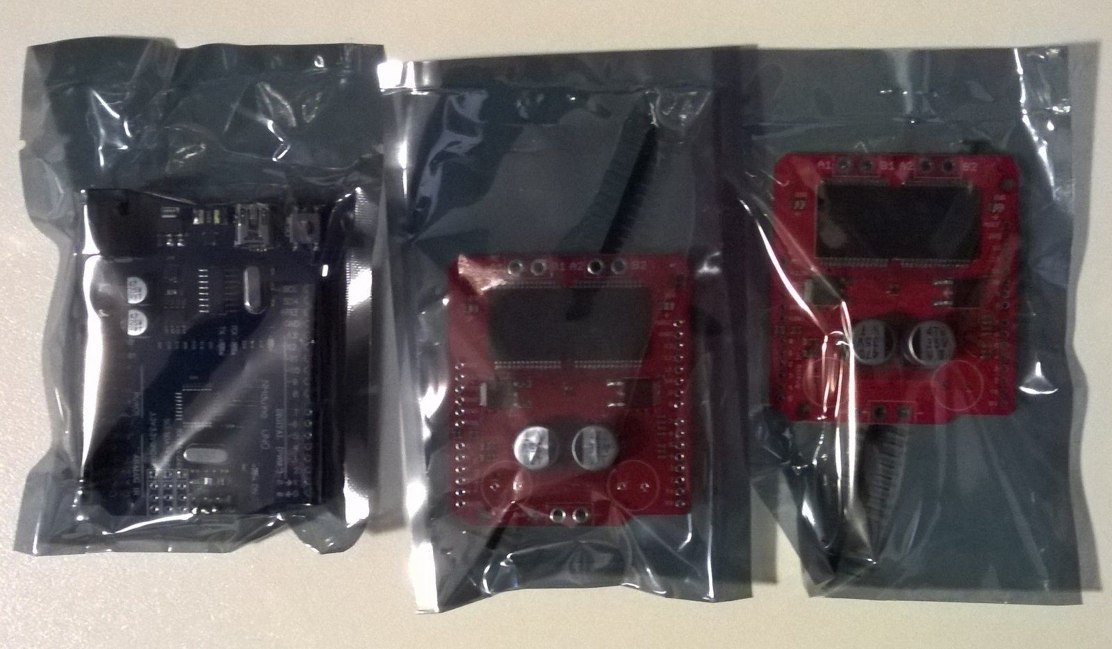

  14. Blame73
    Nov 6, 2014
    1,215
    8,303Coins
    +1,129 / 4 / -0
    You're both right, I shouldn't do any works on Monday morning
    Putting the wires back I switched the two wires
    Ordered the capacitors, I'll try to fix the MotoMonster.
    Meanwhile, lucky enough, I got today the 'Chinese stuff', little money and 'just' one moth for delivery (usually it took two months).
