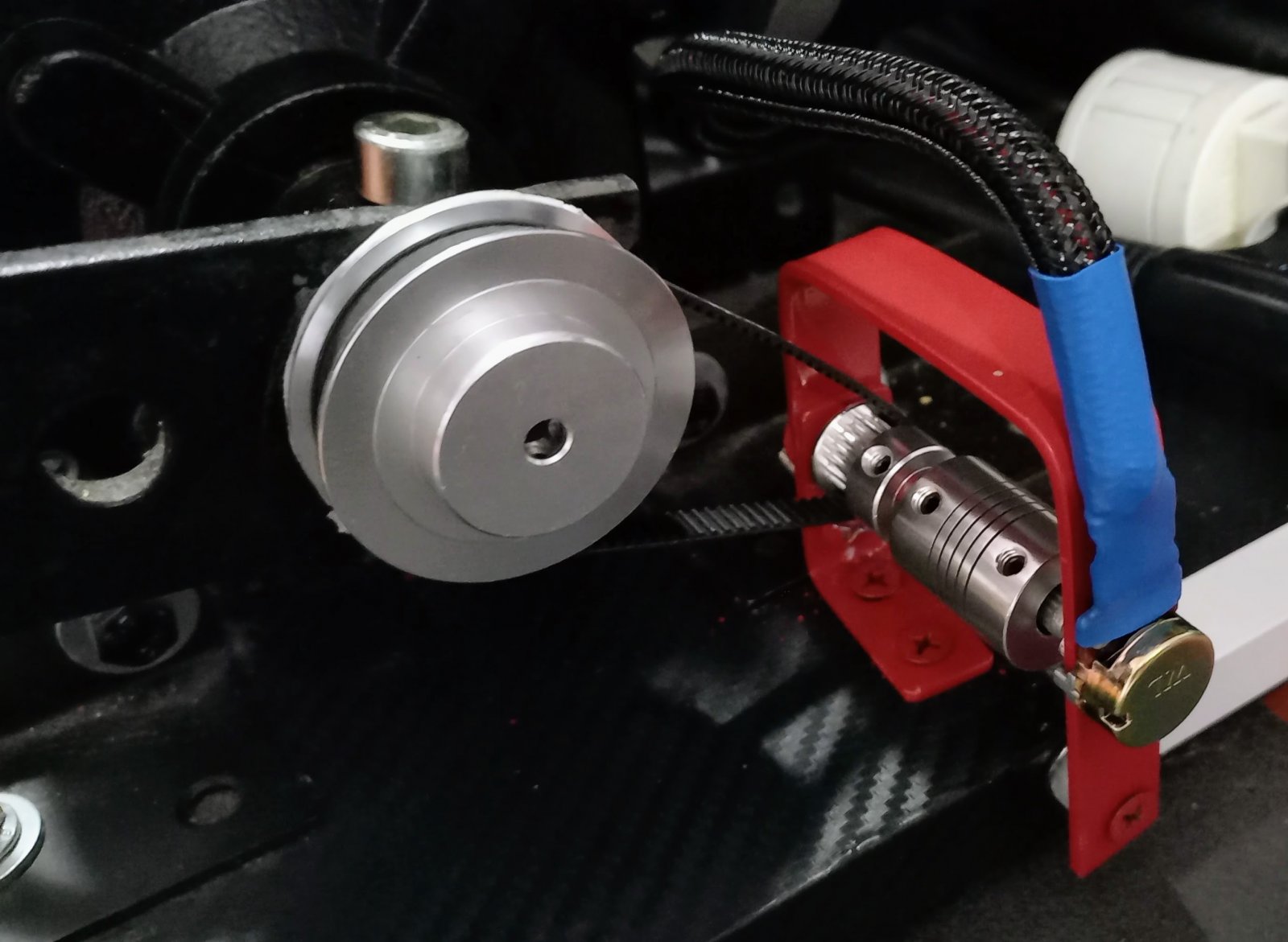

    Meanwhile, since I redone all the soldering and wiring I decided to change the pots positions too.
    I had pots on the center of the shaft but this way I had very little range available, maybe 40° and I was losing a lot of informations.
    So I bought a 3D printer synchronous pulley (60 to 20 teeths) and built this
    Now I have to buy two new hall effects pots, the ones I had before stopped working some months ago
