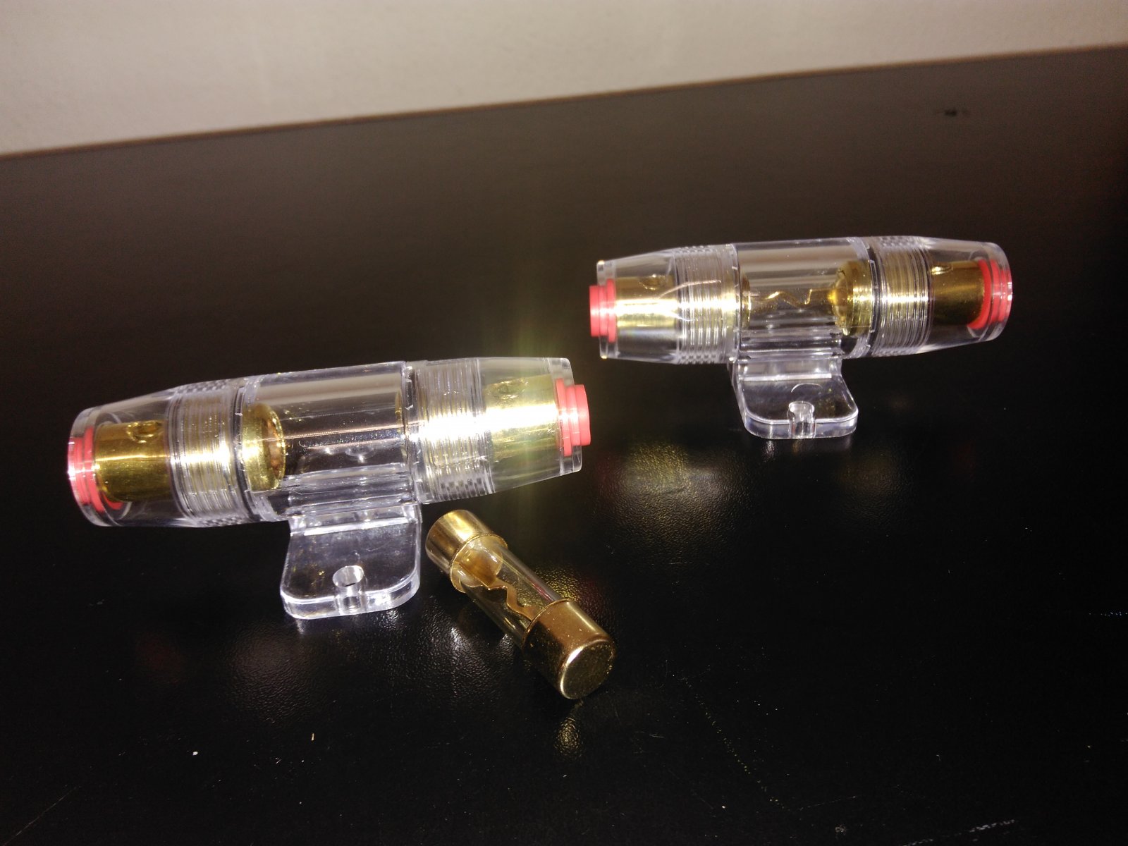

    After 4-5 months I got what I ordered from HK...

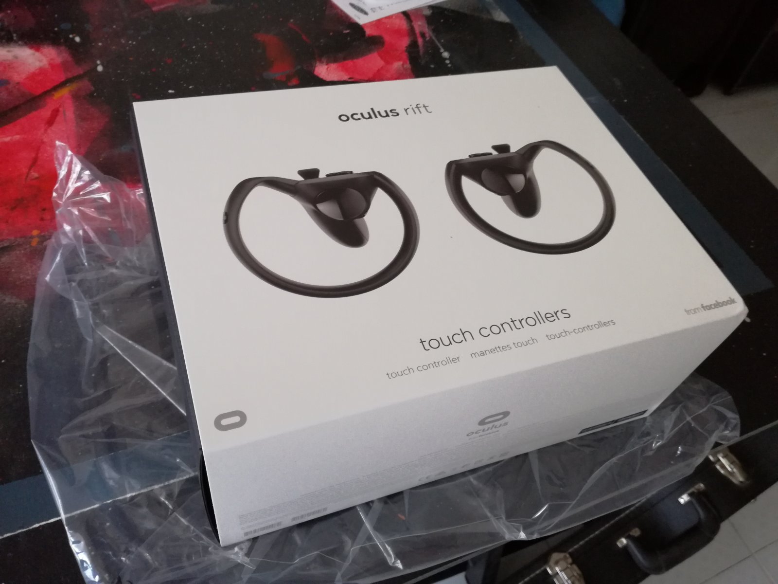

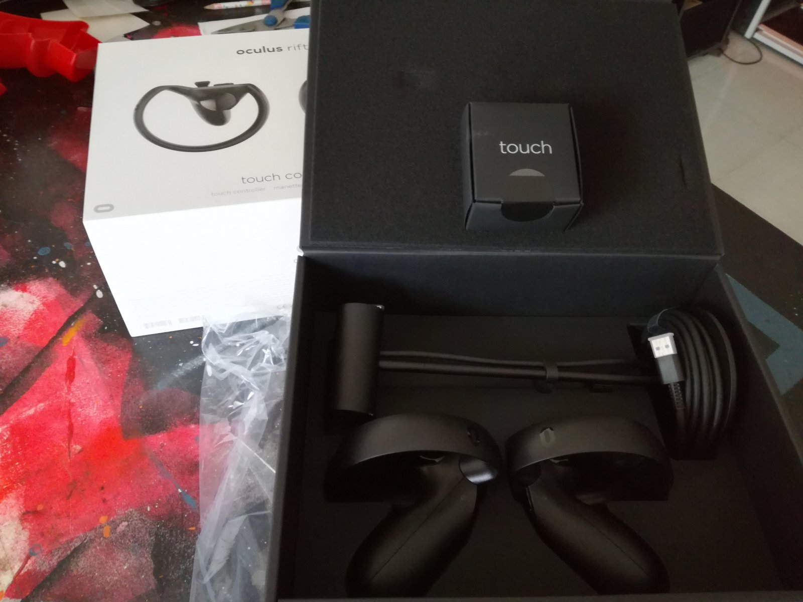

    And in three days I got what I just ordered!
    So, you, VR touch guys... what games/apps MUST I have?
