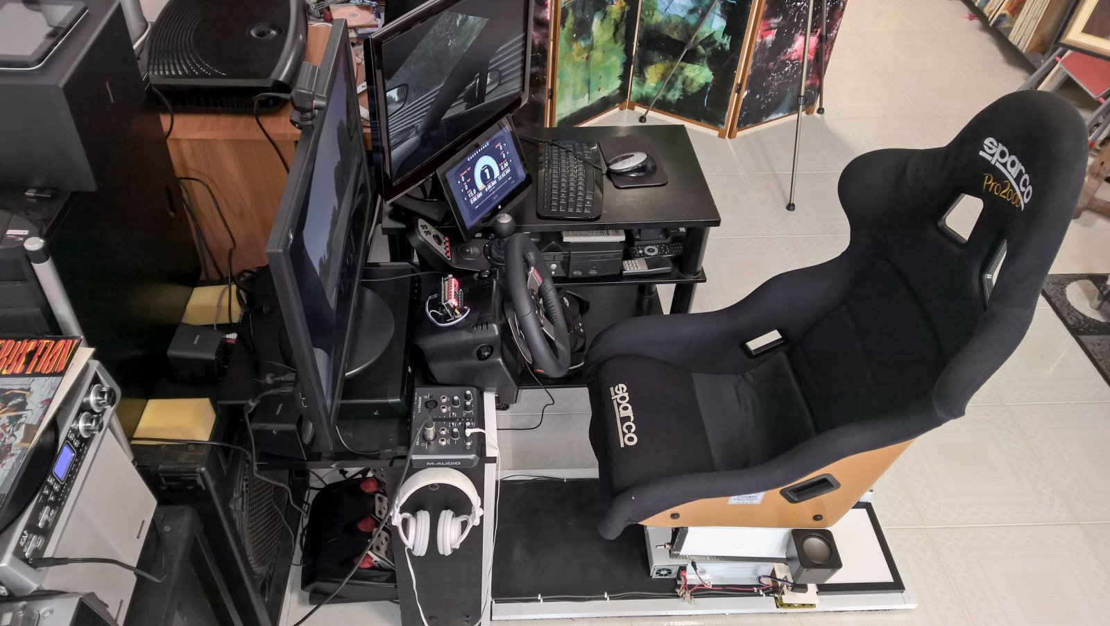

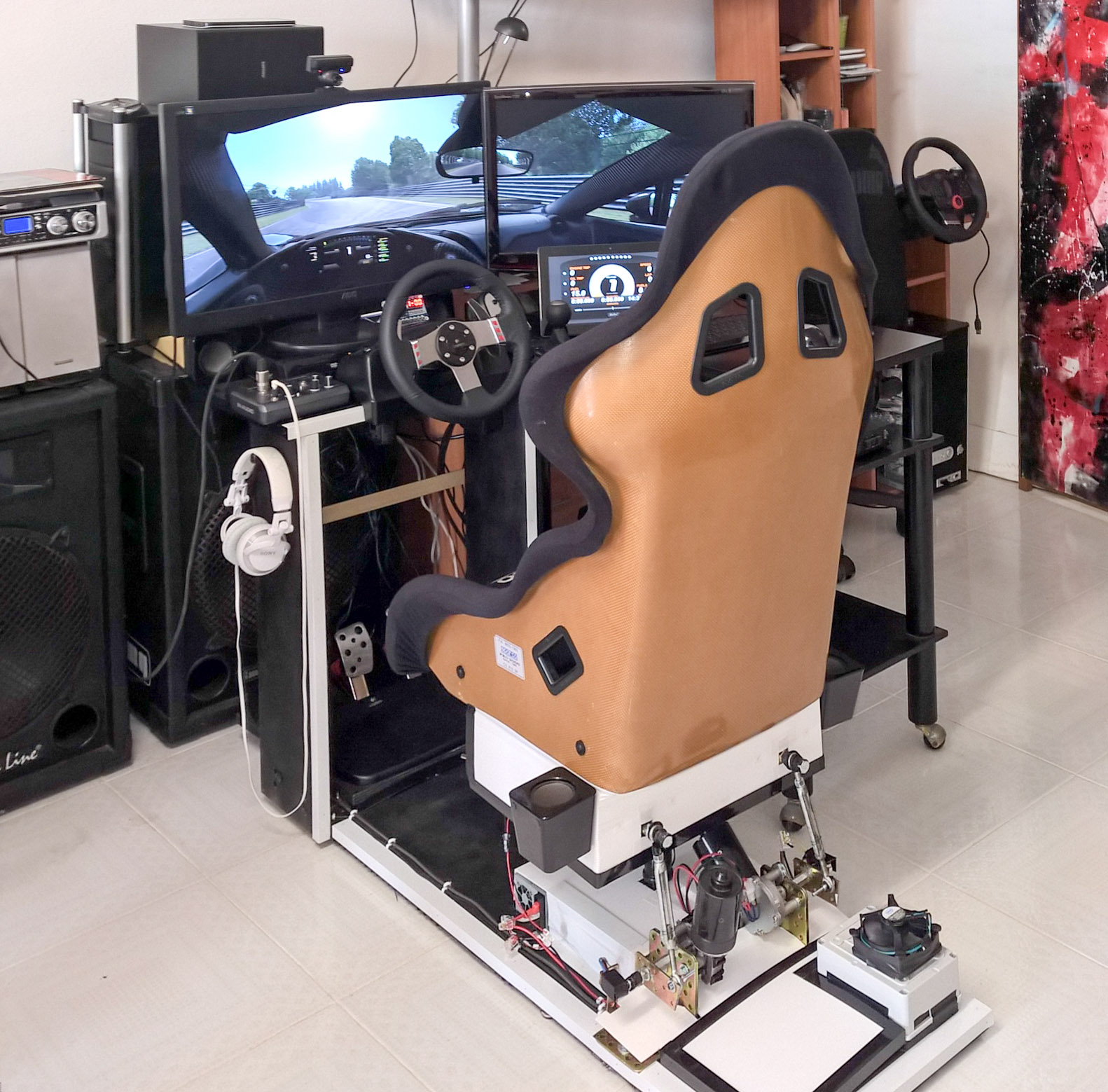

    I edited the OP to reflect the last stage of the rig with the following info and pics:
    I edited this post so that, should anyone wanted to see the actual 'state of art' of my rig, wouldn't have to dig through the pages of the thread.
    The ingredients for my recipe:
    • PSU: HP DPS-600PB (12v, 47A, 575W)
    • Controller: Currently I'm using
      • (2x) Pololu JRKs 12v12, but I can easily switch to
      • Arduino UNO R3/Monster Moto Shield.
    • Universal joint
    • Seat: Sparco Pro2000
    • Pots: (2x) 10k 300° linear
    • Mortors: (2x) Wiper Motors
    • Switch
    • Wheel: Logitech G27
    • Joystick: Thrustmaster T.Flight HOTAS
    • Monitor: AOC E2752vQ 27" + Samsung SyncMaster T220"
    • Soundboard: M-Audio M-Tech
    • Sound System: Philips 5.1
    • Board: TM1638 + Arduino UNO
    • Board: 7" or 10" Tablet
    • Cam: PS3 Eye for FaceTrackin
    • PC:
      • CPU: i5-4670k + Cooler Master Hyper TX3 EVO
      • MB: Gigabyte GA-H97-HD3
      • RAM: (2x) 8Gb HyperX Fury
      • HD: Kingston 120Gb SSD + 1Tb HD
      • GPU: Sapphire DualX R9 270x 2Gb
    • Wires, wood, plastic...

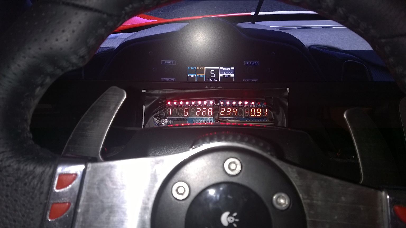

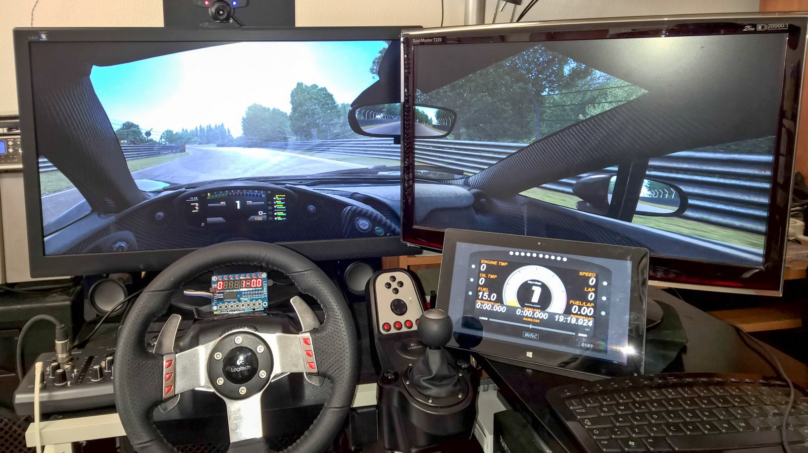

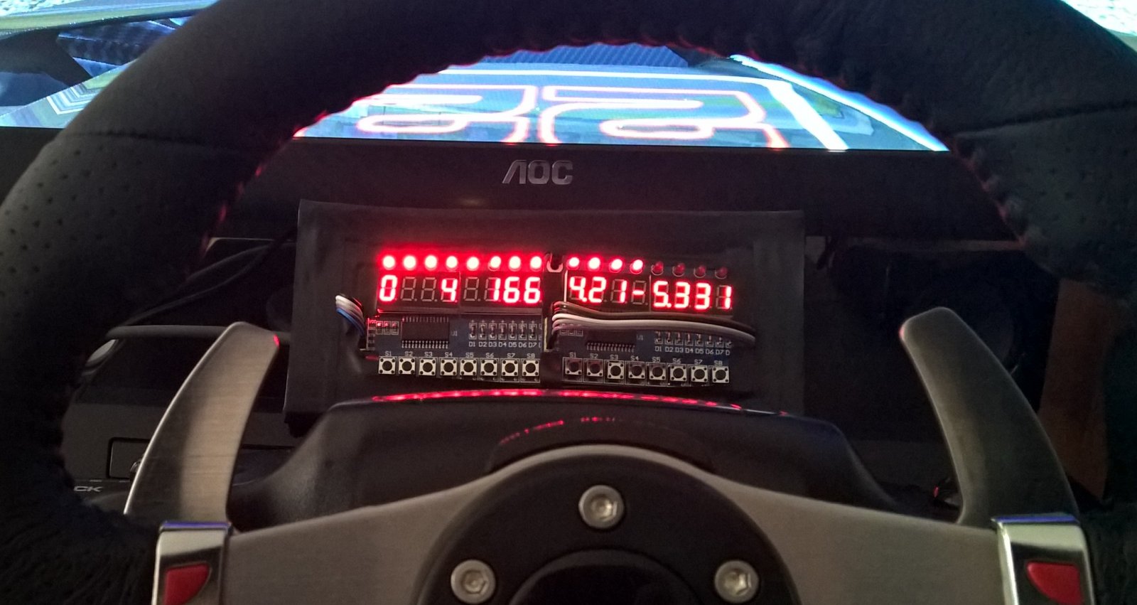

    Just a small update: I figured out how to run two TM1638 modules and I changed some code so that now I got displayed:
    lap
    gear
    speed
    fuel left
    delta
    and, of course, 16 leds for rpm
    • Like Like x 6

    Nice work with the displays @Blame73, would you mind sharing the code as I am sure others would be interested.
  8. Blame73
    Blame73 Well-Known Member
    Nov 6, 2014
    1,216
    8,314Coins
    +1,139 / 5 / -0
    I'd be happy to share it @noorbeast , but I first have to ask for premission from the app's author, cause I modified it in order to run the second app that drives the second module.

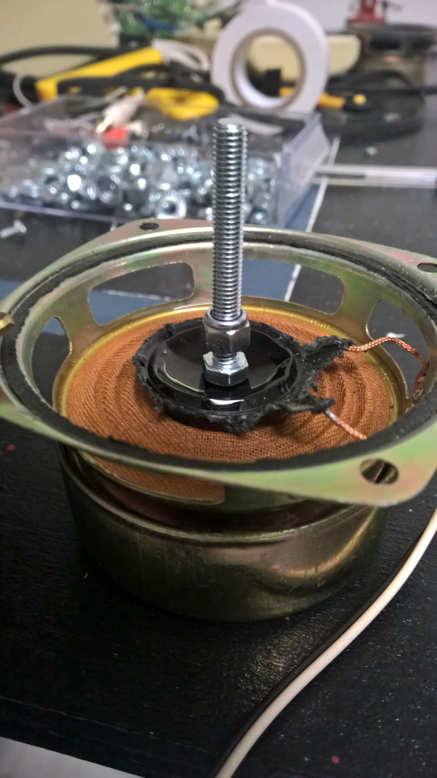

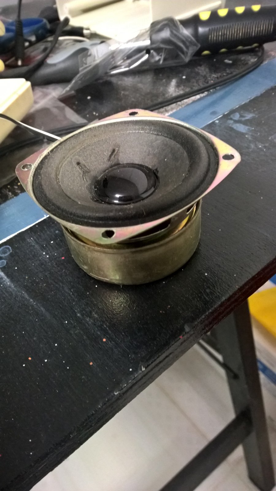

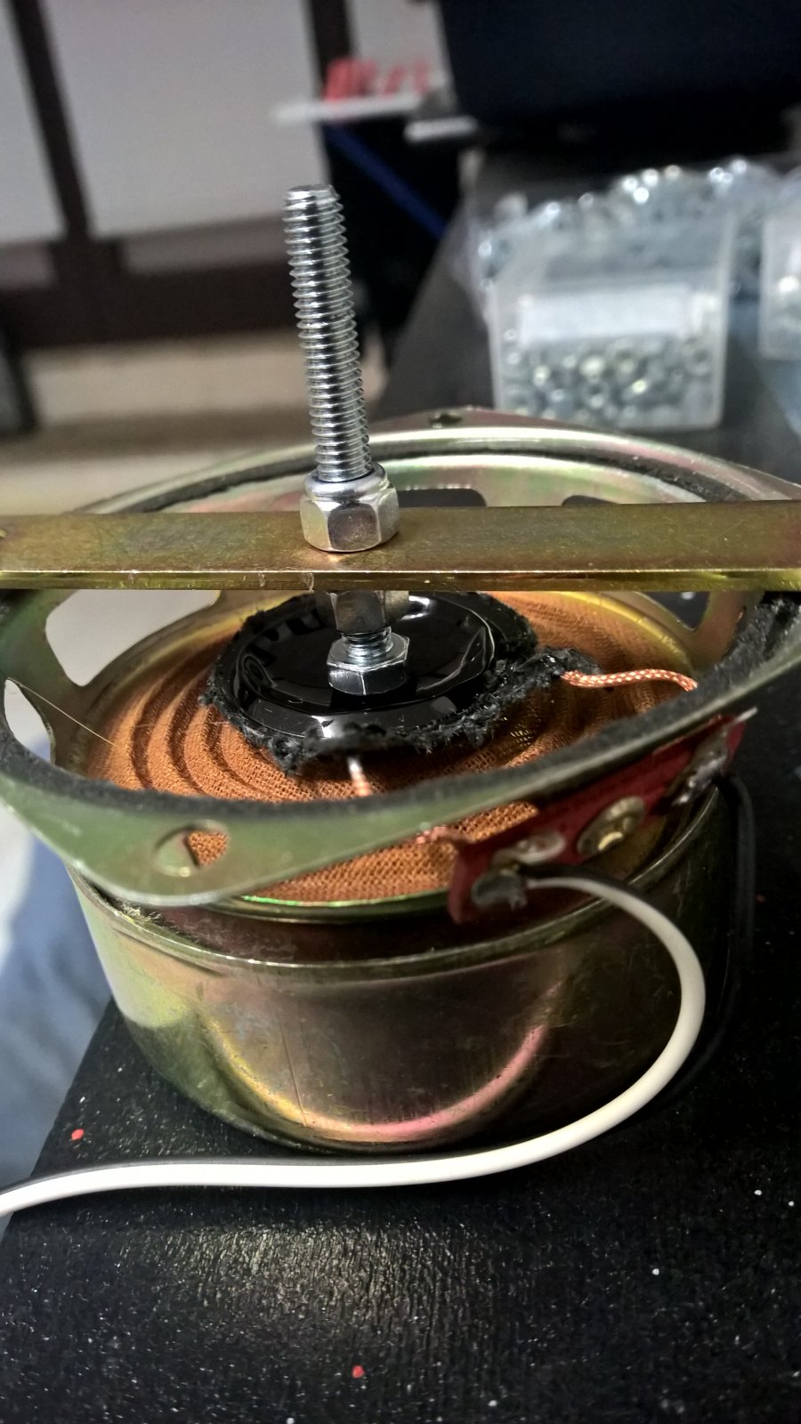

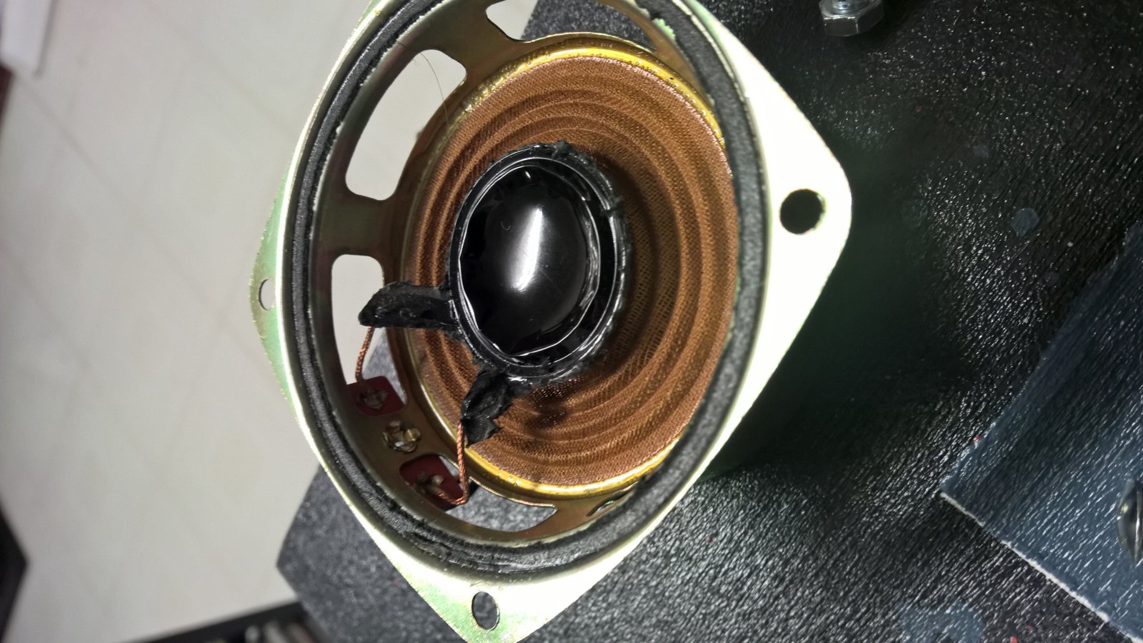

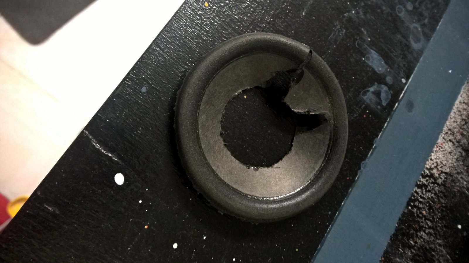

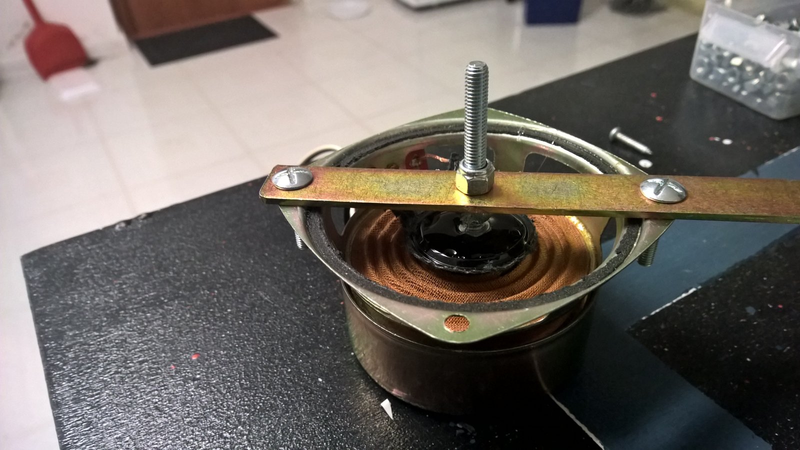

    I wanted to try some bass-shaker so I built myself a couple ones starting from an old PC speaker I had around.
    The speaker ain't that big but I just wanted to try and see if it worked for then try with bigger ones.
    I have to say the experiment was a surprise, I was no confident at all at the beginning.
    Now a step by step of what I did:
    • The speaker I started with (use a subwoofer or a woofer, NOT a tweeter!) WP_20150424_23_28_16_Pro.jpg
    • I cut the cardboard, paying attention not to cut the wires too WP_20150424_23_28_55_Pro.jpg
    • Pushed the 'bulb' (sorry, don't know the name in English...) so that now is no more convex, but concave WP_20150424_23_29_47_Pro.jpg
    • Then I used a long nut finding the height till the upper holes and screwing it to a little rod (maybe I should use a more flexible one) and to the speaker WP_20150424_23_30_37_Pro.jpg WP_20150424_23_39_01_Pro.jpg
    • Finally I filled the now-convex base with glue that I let harden overnight so that vibrations from the speaker are transmitted to the nut that, vibrating itself, transmits 'em to the base of the seat it will be fixed to WP_20150424_23_49_28_Pro.jpg
    Since it was a really satisfying experiment I'll soon replicate it with bigger speakers, I think about 15cm ones

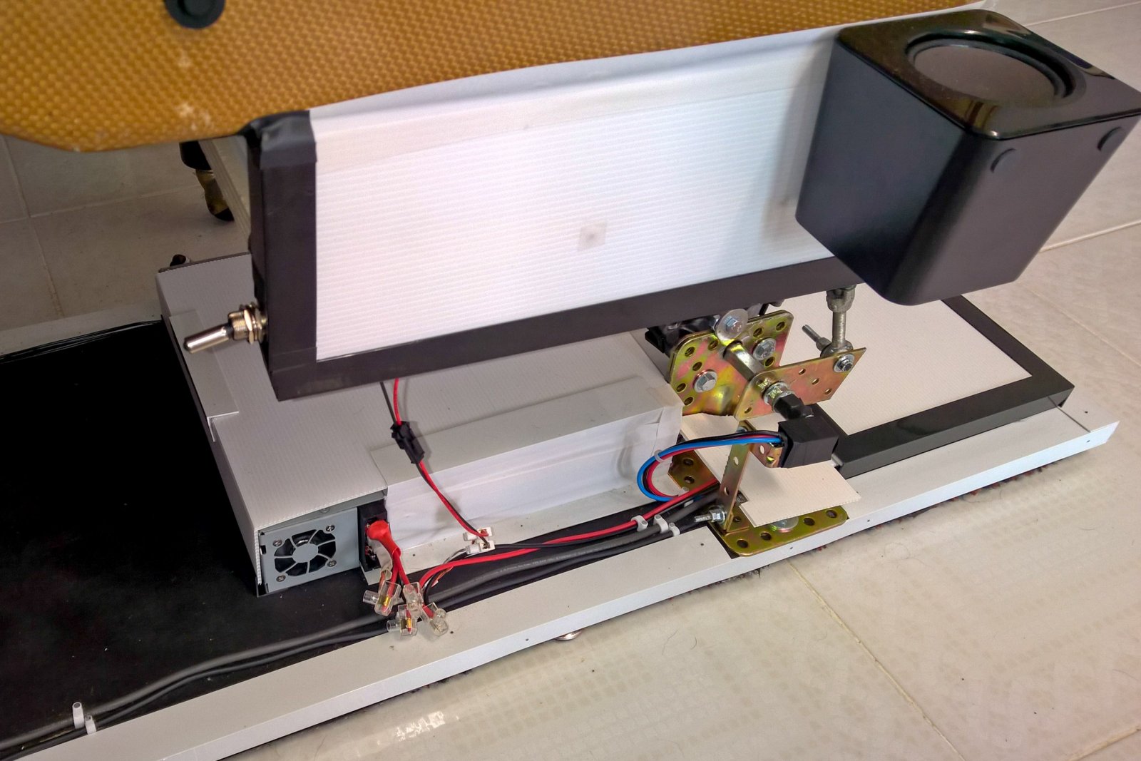

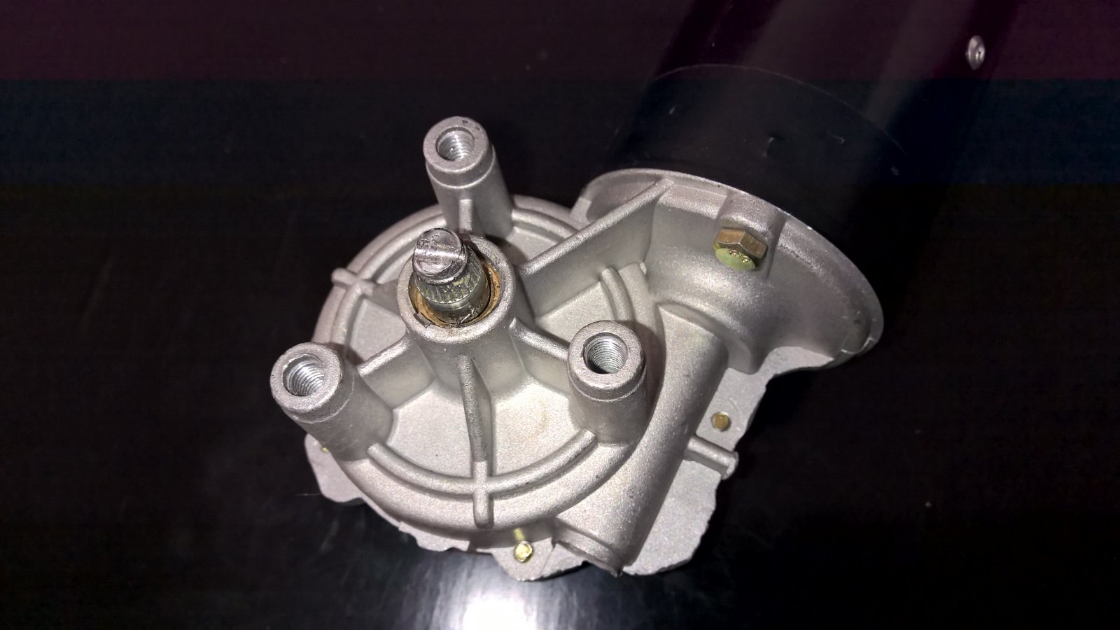

    Seems like drilling an hole for better fixing the lever arm is not the best choice. The second motor's broken too:
    Soldering that close to the motor won't be easy at all !
  12. Pit
    3,007
    30,512Coins
    +3,098 / 31 / -0
    wow, what a mess. I hope you can solve it. Unbelievable that the chassis of the motor has been broken...

    Since the author never answered me, I'm posting the changes I made in order to be able to use two TM1638 Modules. Should he complain I'd remove it.
    Basically I just changed his app (acSLI) so that I could load it twice. I modified the code so that it now appears as a new app, acSLI2.
    Then I edited the code for lighting (in the 16 leds mode) the first 8 leds on the left module and then continuing lighting the second 8 leds on the right module.
    I also modified the button functions. On the first button - that I use on the left module - I have 'lap', 'gear' and 'speed', and on the second button - that I use on the right module - I have 'fuel left' and 'lap delta' (I got rid of millis on lap delta and moved it a step to the right in order to have a separator between the 'fuel delta').
    To install the app just copy the acSLI2 folder in the apps\python folder (where you should already have the original acSLI) and enable it in AssettoCorsa. Then upload the 'TM1638_LeftModule.ino' and the 'TM1638_RightModule.ino' to your modules. REMEMBER TO MODIFY THE COM PORTS according to your pc!!
    You have to set the leds to 16 leds mode, to do so press button 8 + button 1 to switch from 8 to 16 leds mode.
    ALSO, I'm now using modules with just one color (cause the two colors modules I got are a bit too big), so, should leds not work, switch from green to red leds pushing button 8 + button 2.
    (one of these days I'll modify the sequence for using the two colors: green leds for the first 12 leds and red leds for the others - 13 to 16)
    I hope I've been clear enough. Enjoy the two modules.
    PS: a tip: you can copy your user.cache file from acSLI to acSLI2 app
