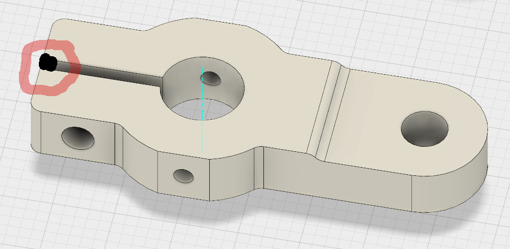

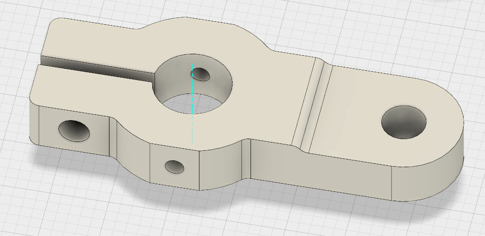

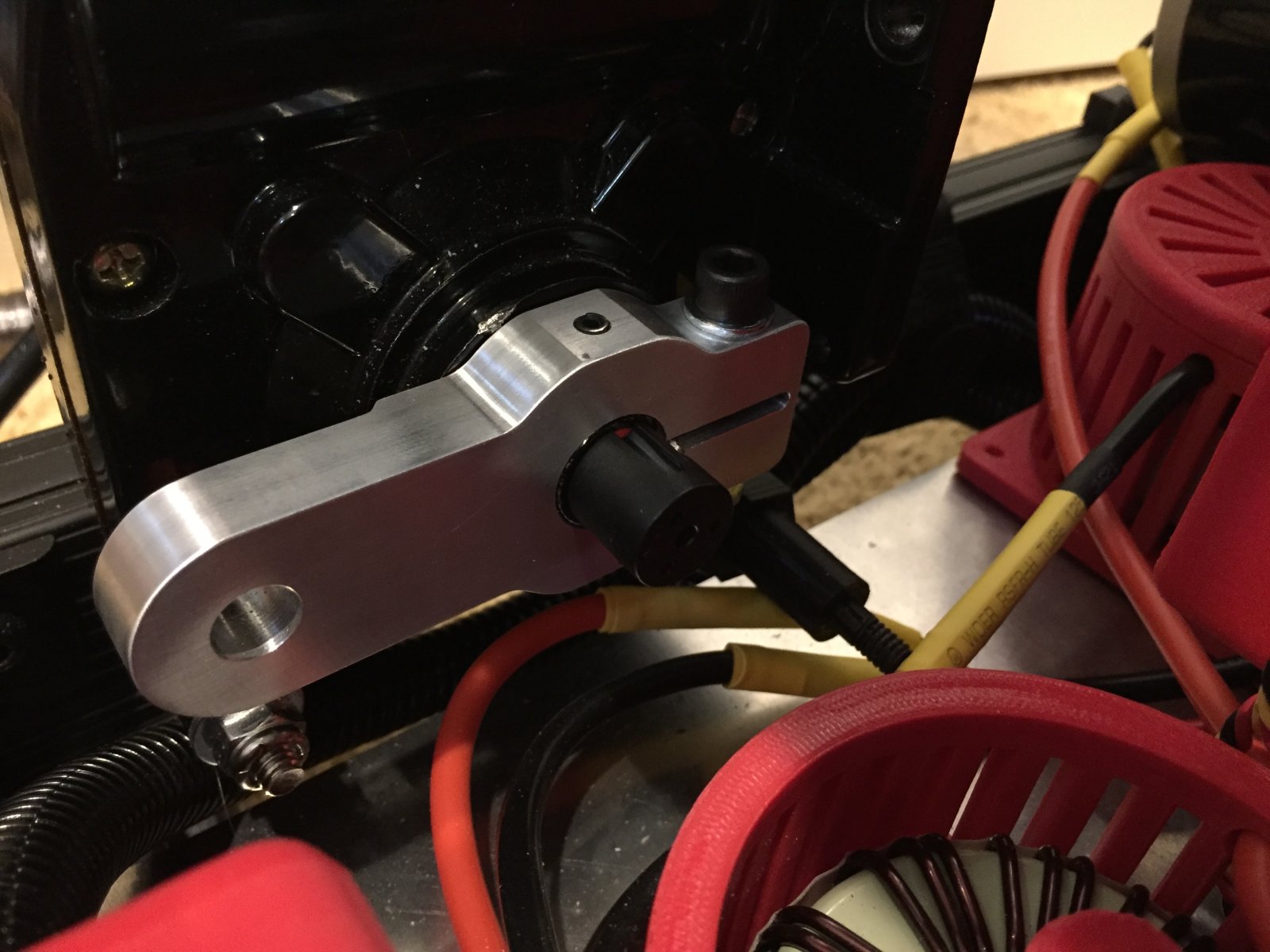

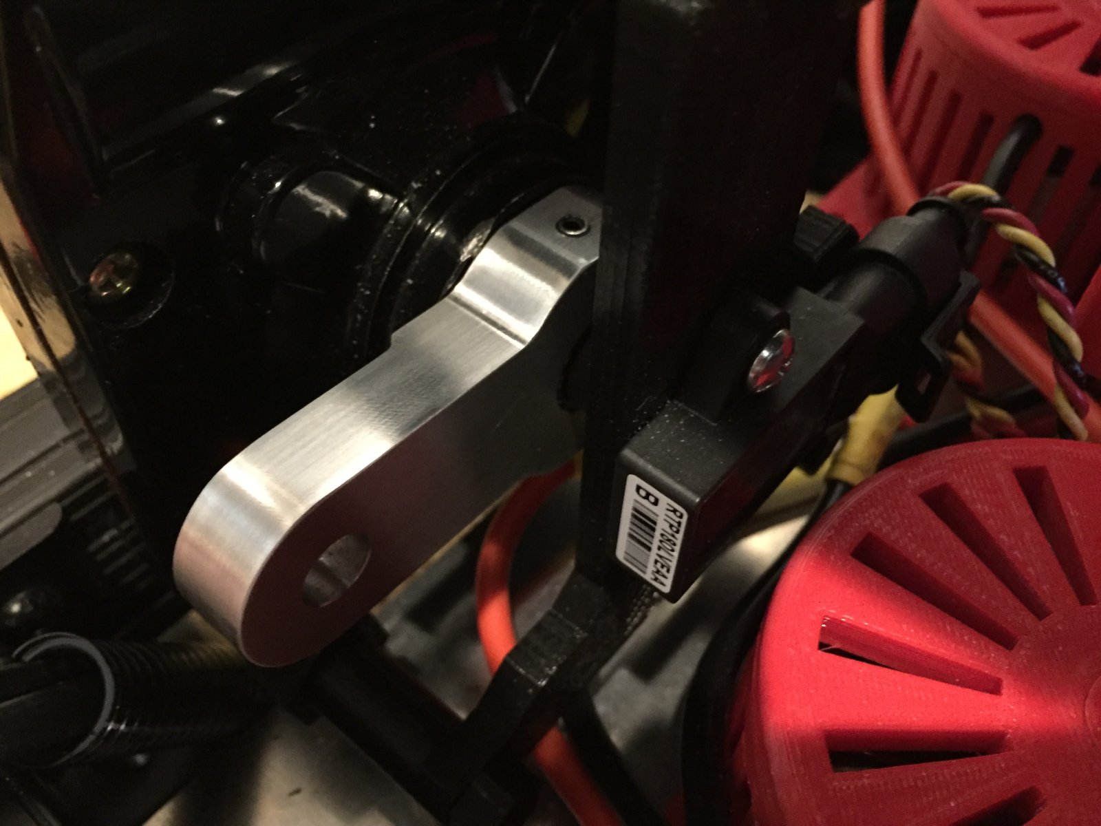

    I used clamping with a roll pin. It’s been rock solid.

    Self-designed with one caveat and I have a machinist friend who cut it for me. He also made a really good suggestion and modification to the design. Instead of the clamping clearance being all the way from shaft to clamping end, he left a bit right at the edge. Otherwise they are to drawing.
    He said that without that bit, the clamping bolt would bend the clamping arms and weaken the clamping action. By leaving that little bit, the bolt tensions and clamps the other way - at the shaft. If I was doing it again, I'd extend the clamping arms out a little further to give the clamping bolt more leverage but these are great with zero loosening as they are. Extending may not be necessary. BTW, the guy is an amazing machinist. His work is art.
    The zip file has my original .stl file seen in the render.
    And I realized just now the OP was asking about attaching a shaft - not an arm.
