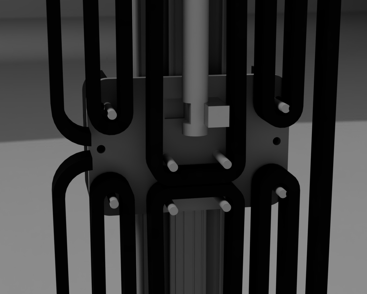

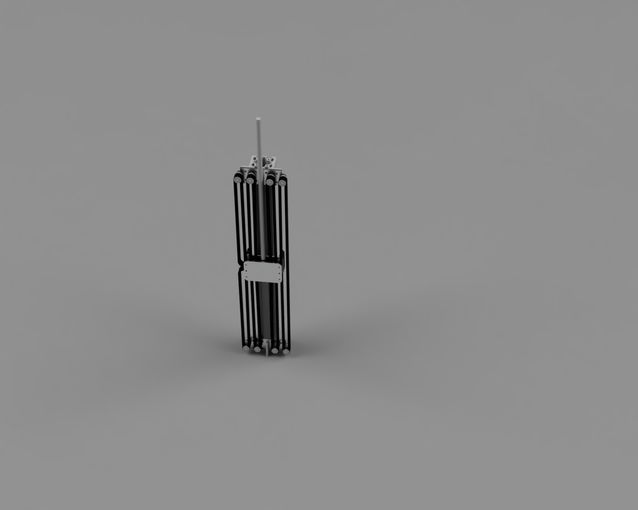

    I've already come across a couple of problems which mean I'll want to start the design over from scratch but before that I thought I'd see what other peoples thoughts are.
    My basic concept is to bolt two end mounts and some 12mm linear rail to a 2"x2" aluminum extrusion. A carriage would be pulled up and down these rails with a 4:1 pulley system driven by a BLDC motor. The actuator rod can be aligned with the centre of the belt so most of the forces align well and the whole assembly can be fairly low profile so the rod isn't centred very far above the aluminum extrusion either.

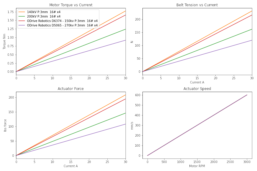

    Using Gates MGT3 belt (3mm pitch 15mm wide) with 16 teeth pulleys seems to work within their specifications for toque and belt tension whilst producing decent actuator forces and speeds with available motors.
    I was trying to use lots of standard and repeated parts like 1" long dowel pins and 3/8" machine key to transfer loads from the rod and pulleys into the machined aluminum plates. I think the machining can be kept pretty simple and 3d printed parts can probably be used anywhere machining parts from multiple sides would otherwise be required.

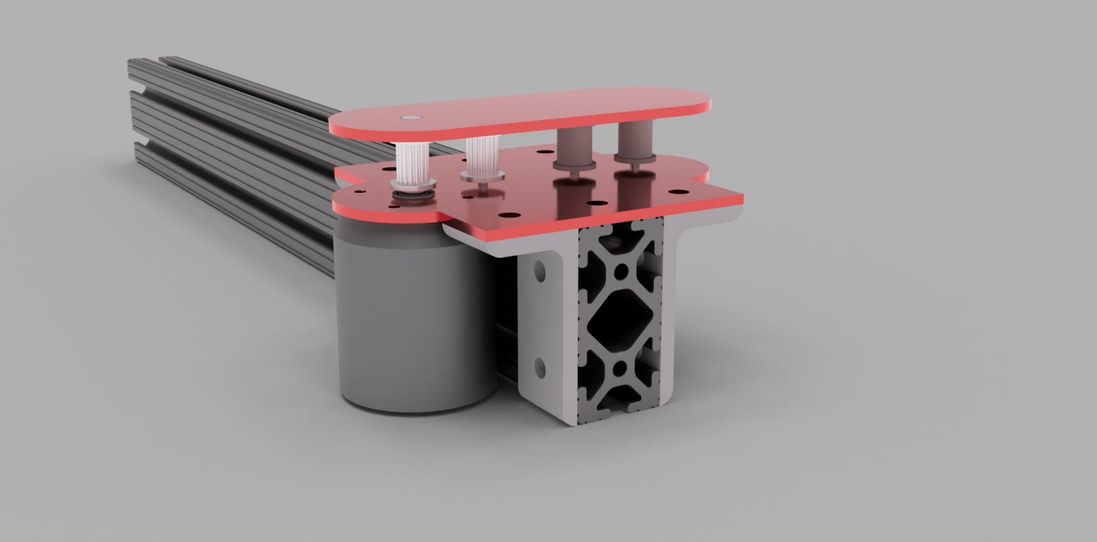

    I haven't really decided if I should mount the motor directly to the end plate or to try having it mounted to the extrusion and connected through another belt to offer some more gearing flexibility and higher motor speeds. The fixed end of the belt should also be secured in the centre of the carriage instead of at an edge which would also remove the need for two of the pulleys one the carriage required to clear the rod.

  2. drumlight

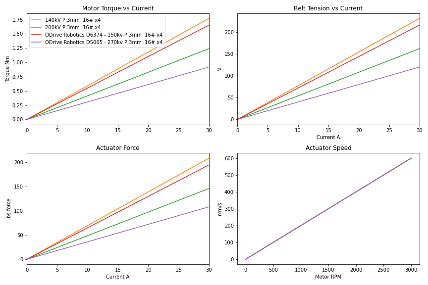

    Here is the same graph without the transparent background which looked fine until I saw it in my browser. index1.png

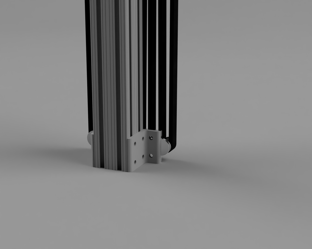

    I looked into using 5mm pitch belt because it allows 10 teeth pulleys as the smallest and it works out very close to the 3m pitch with 16 teeth. The extra size of the belt would still have required a wider design (I think ~5" is possible with 3mm pitch belt) unless you went to a 2:1 pulley system at which point the extra strength of the 5mm belt was required because the loads are twice as high.
    The belt should be pretty easy to secure in the centre with a scaled up version of the clamps they use on XY 3d printers (its also what will allow the belts to be tensioned). If other things hadn't already depended on the pulley location I would already have removed two diagonally opposite pulleys in the middle of the carriage, added two clamps for each end of the belt and then have the belt path run between the two clamps from one side of the carriage to the other. The location of smooth and toothed pulleys would end up reversed on each side the system.

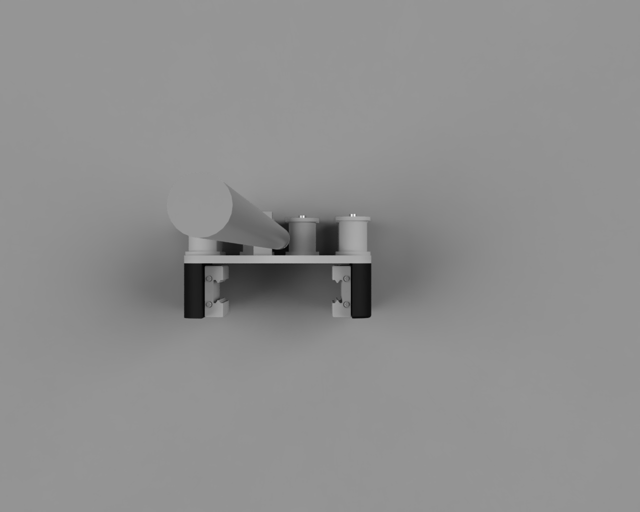

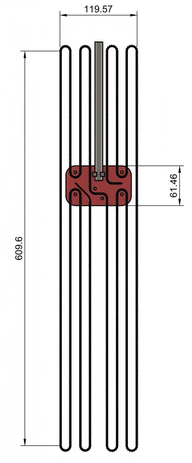

    This is more practical belt path and it should accurately represent a 3GT belt pitch line for 16 tooth pulleys. I think this is about as narrow as it could be made and is basically 120mm wide. The carriage that pushes the rod doesn't need to be so big that it limits the available travel range significantly.
    Edit: This pulley layout is wrong in a couple of ways. Firstly I never drew the 4:1 ratio I was aiming for and then when I relocated the fixed ends of the belt I split the pulley system into a second and unnecessary parallel system.
    For the motor I had something much more like this in mind https://flipsky.net/collections/e-skateboard/products/bldc-motor-h6355-160kv-1620w . At a 30A peak it should produce actuator forces close to 200lbs if directly driving one of the pulleys. I think on average the currents will be much lower so maybe the peak could be pushed higher still.

    why are you using so much belt and a pulley arrangement ?
    i think you can make a simpler design with a gearmotor and a simple belt loop

    Those are definitely neat designs but I still see some advantages; the first chain driven example seems to be using a 16 tooth sprocket on the motor and if it is a 6m pitch chain that would give a pitch radius of 15.3mm. The belt pulleys are exactly half this size so would produce twice as much force from the same motor torque.
    The chain is directly carrying all the force in those actuator so it is under greater stress (especially where the rod connects to the chain in the first case) and then also require a motor with much more torque or a gearbox. In my design very few parts ever see the full force of the actuator and connecting the rod to the carriage is the area I'm most concerned about.
    The pulley system quadruples the forces from the actuator but also importantly keeps the belt tensions low enough to be viable, a 9mm wide belt would have been right on it's specification limits even with the 4:1 pulley system but the 15mm wide belts seem more than strong enough.

    Hi can you tell me where you build this for.
    Youre 2nm peak force gives 20kg/cm no need to make a 1to4 pulley system, thats only diveded this little force.
    There is no reduction to give more force and lower speed with this motor.
    regards Ad

    Without the pulley system dividing the forces by 1/4 the belt I used wouldn't be strong enough; other bigger belt options exist. I don't think actuator speeds are being limited by the pulleys; 3000 RPM should be acceptable for the belt and pulley combination and results in 600mm/s speed.
    I might have overshot how much force is required in an actuator as I kind of guessed at that. My basic thought process was a sim platform might weigh from 200-lbs to 350lbs. I think a hexapod design is essentially connected by equilateral triangles so depending on the exact position and direction the forces from the actuators sum somewhere between 6 * 0.5 = 3 and 6 * 1/2 * root(3) = 5.2.
    I assumed to be responsive the platform would want to accelerate at a few m/s^2 so having the peak actuator forces approach 200lbs made some sense to me. I'm sure you wouldn't want/need that all the time and I'm pretty sure a smaller motor could be used but I figured I'd start with plenty in reserve.

    You make a mistake
    You get 600+mm/sec at 3000rpm with a 38mm Diameter pulley,and then you come at 10kg peak force with 2nm motor peak force

    Another advantage from the pulleys is it reduces the holding torque required across the board. Assuming a platform weighs 300lbs I think there is a static load required from each actuator of 300/(6*1/2*root(3)) = 57lbs. With the pulley system this will require between 5-10A steady current but without the pulleys it would be close to the maximum current I wanted to run the motors at.

    i made a mistake youre talking about a 3,8mm D pulley for that speed and you come at 100kg force.
    you need a lot more belts every tooth from a belt can handle some force ,with a 10 tooth pulley you get 6 tooth contact with 90kg its 15kg every tooth. If a tooth can handle 3kg max you need 5 belt and pulleys on motor shaft
