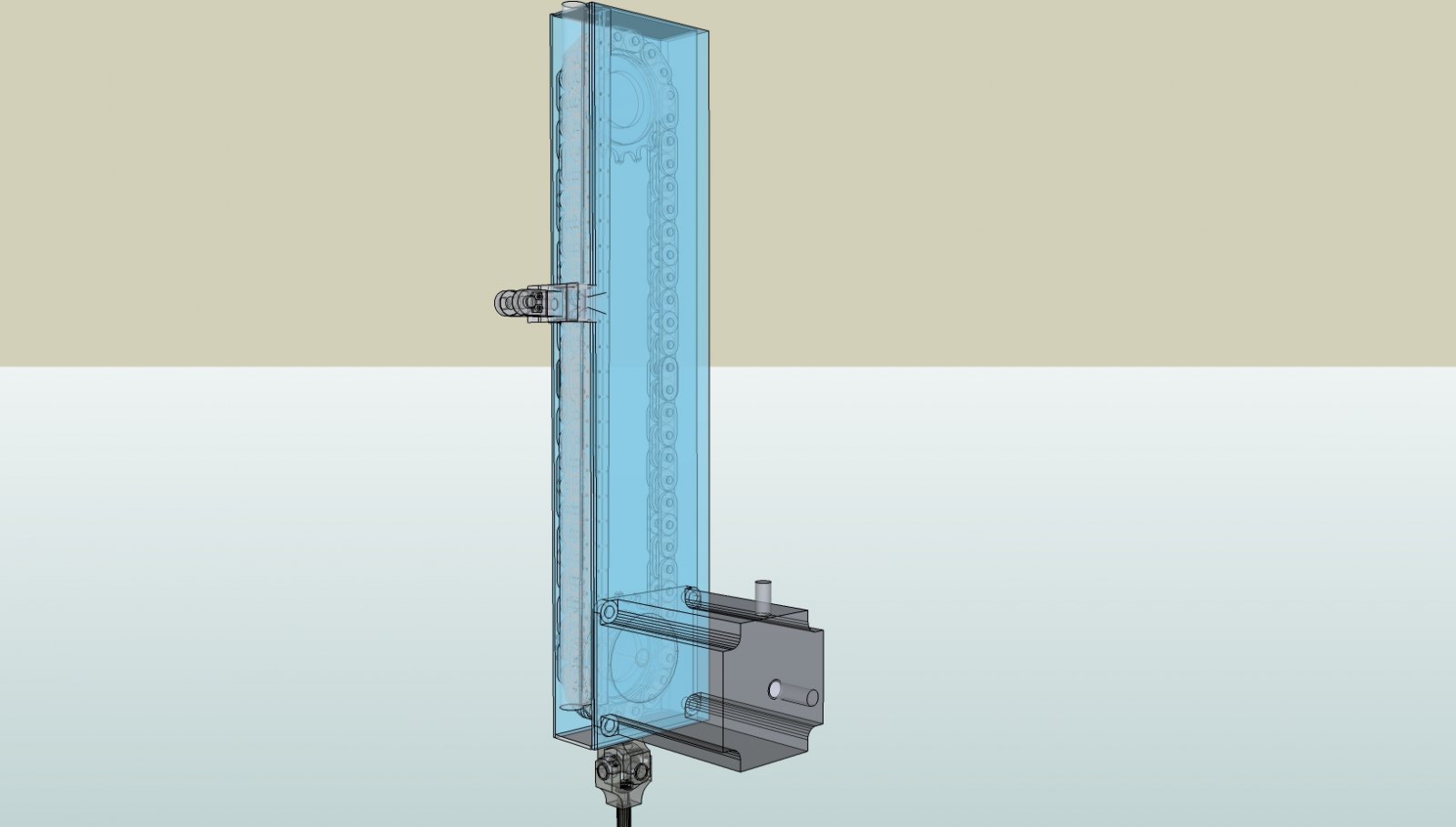

    Since months I am pondering on a chain driven 6DOF. This thread is now reserved for future postings about an other kind of 6DOF which has - as far as I know - never build before. This can be realized in an easy way and should not to be too expensive. IMHO the chain / belt driven system can be very effective, very fast, less noisy and cheap(er than any former DIY actuator 6DOF). Stay tuned ;)

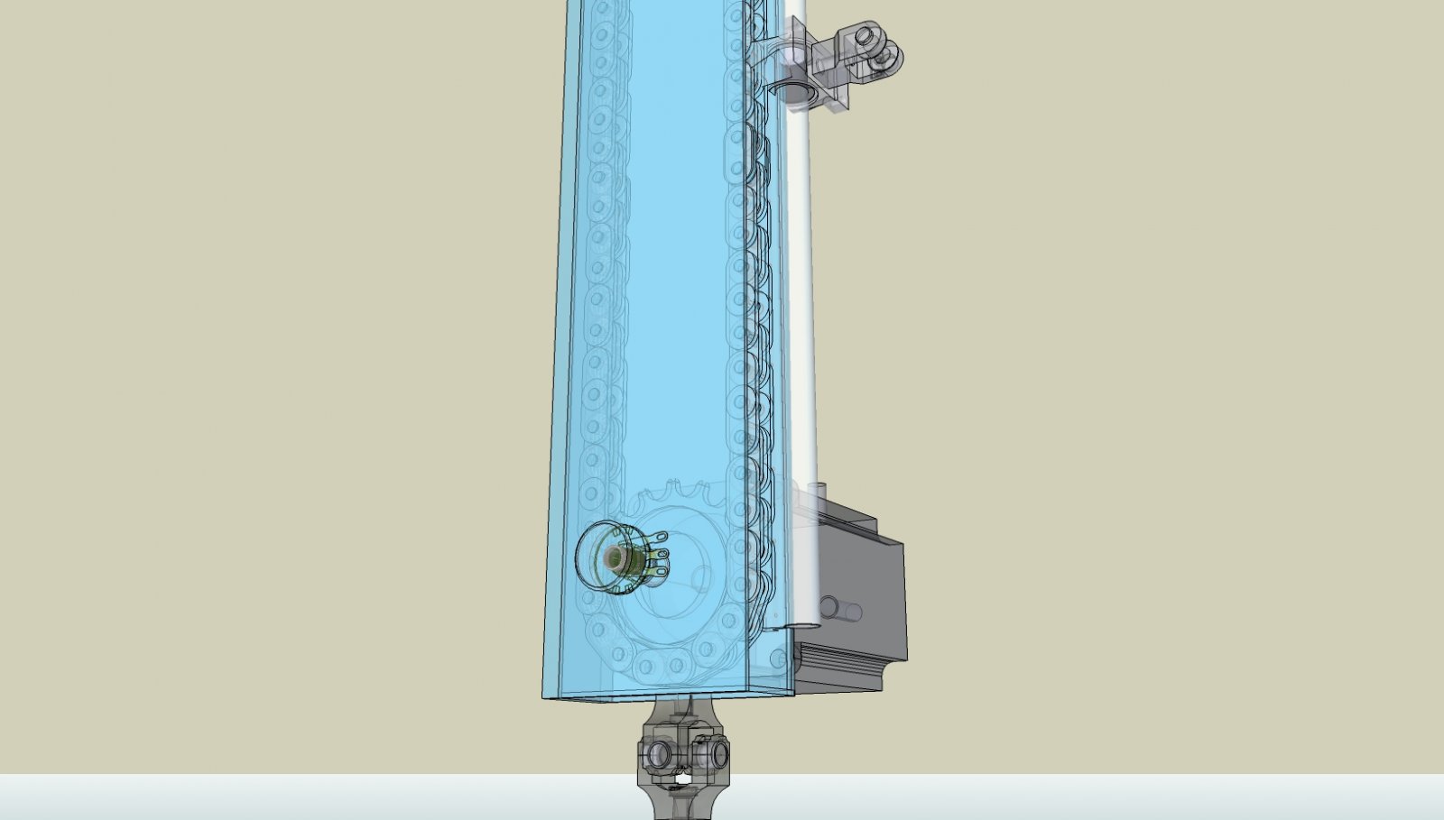

  6. Pit
    3,013
    30,416Coins
    +3,088 / 31 / -0
    some progress, but pre alpha...

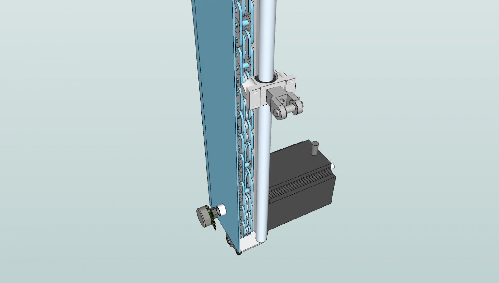

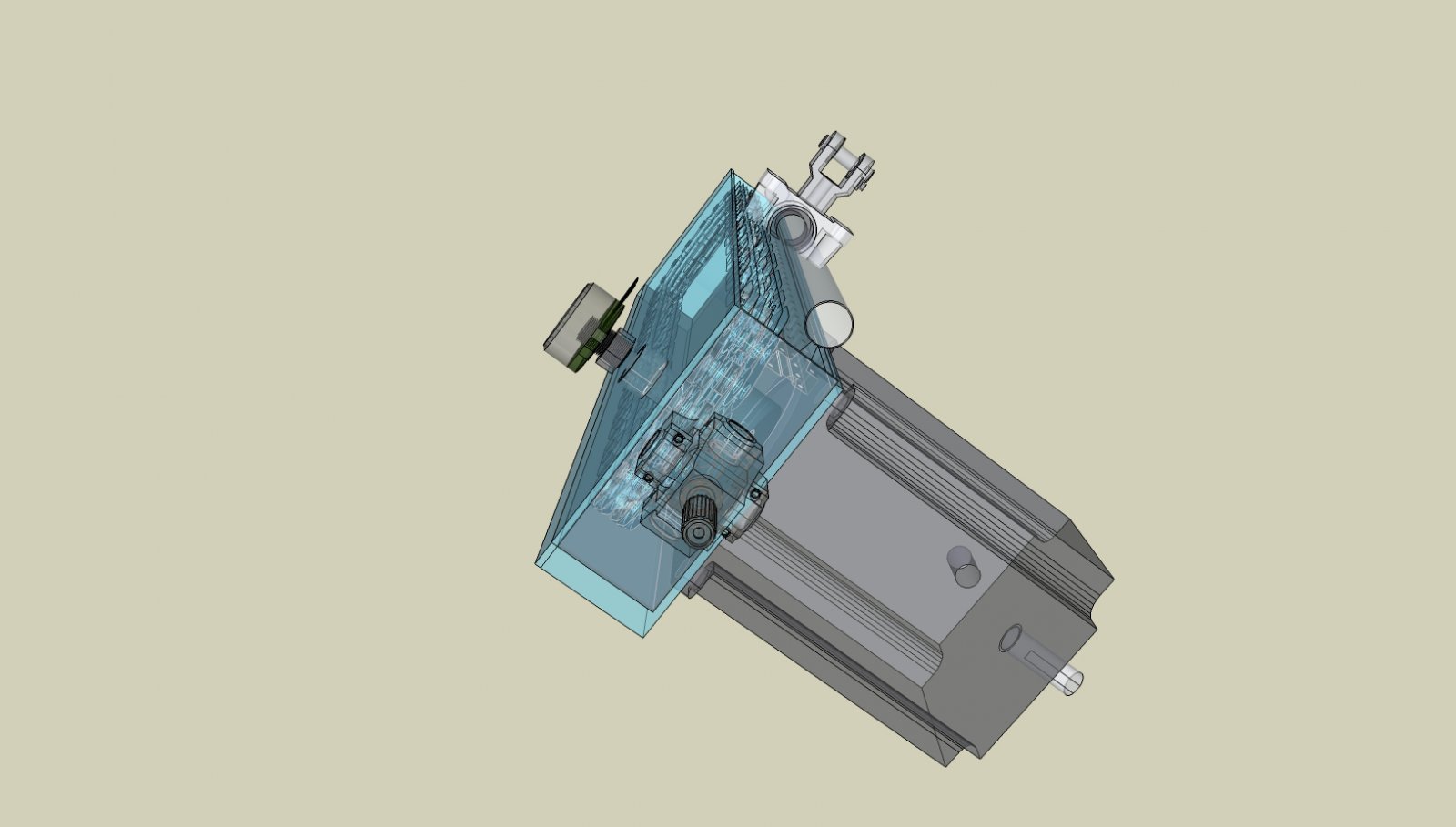

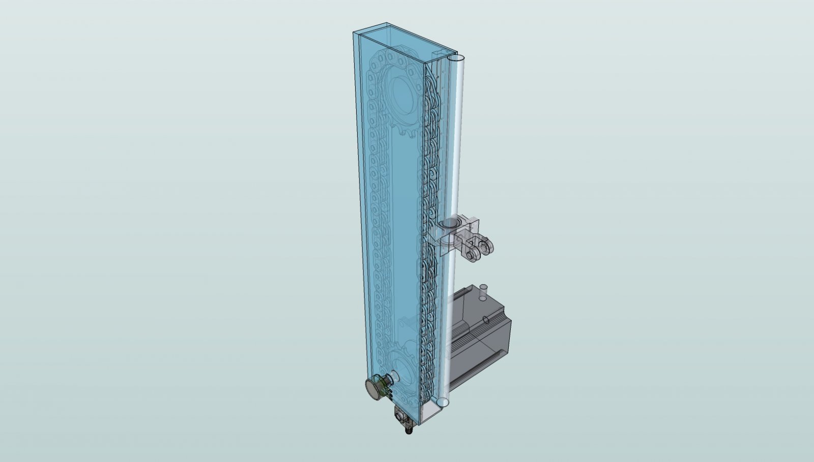

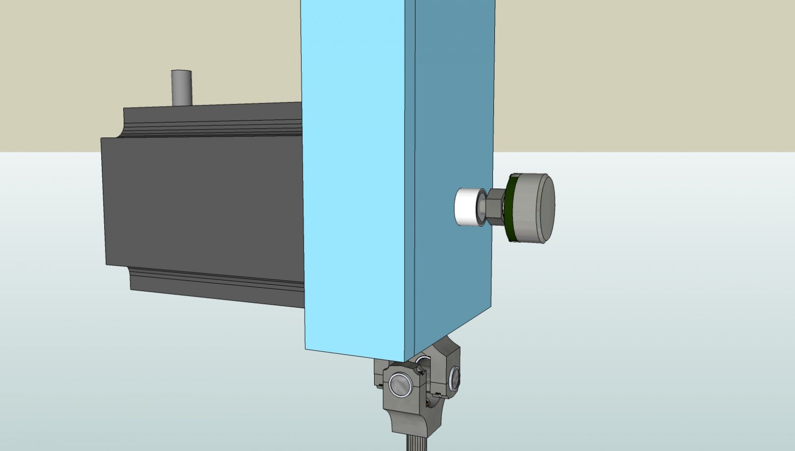

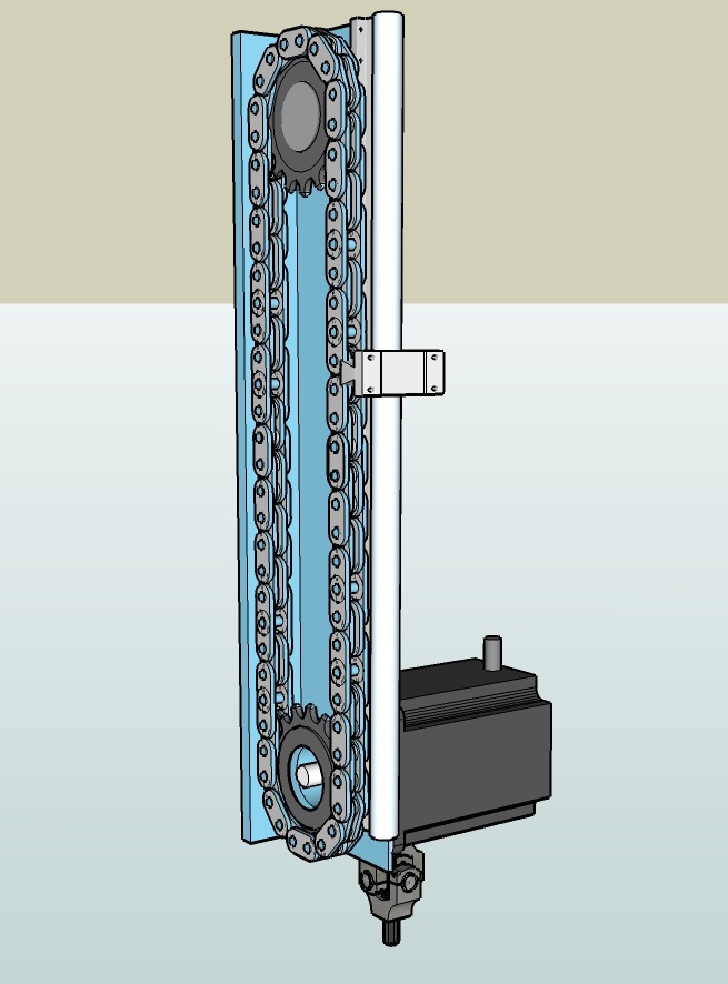

  7. Pit
    3,013
    30,416Coins
    +3,088 / 31 / -0
    more progress, almost beta:
    chain actuator1.jpg chain actuator2.jpg chain actuator3.jpg chain actuator4.jpg chain actuator5.jpg chain actuator6.jpg
  8. RacingMat
    2,234
    20,895Coins
    +2,084 / 21 / -2
    good project! nice drawings @Pit
    my 50 cents:
    - if the shear forces are too high (chain not aligned with bracket), you could use 2 rods with the chain in the middle
    - I think it will be noisy
    - where is the chain tensionner?
  9. Pit
    3,013
    30,416Coins
    +3,088 / 31 / -0
    Thank you mate for your feedback
    IMO the guided rail should handle the forces.
    I think I will use belts
    +1

    Ce système à l'avantage d'être robuste, mais sera bruyant et il sera très difficile de maintenir la chaine suffisamment tendue.
    This system has the advantage of being robust, but will be noisy and it will be very difficult to maintain sufficiently tight chain.

    With PMDC motors a gearbox will be needed.
  12. Pit
    3,013
    30,416Coins
    +3,088 / 31 / -0
    first of all I will choose a belt driven system, second the motor is a standard 24/36v geared motor nothing special. The motor on the photo is only for demonstration only
  13. BlazinH
    BlazinH Well-Known Member
    Oct 19, 2013
    2,145
    Oklahoma City, USA
    16,575Coins
    +1,831 / 32 / -1
    I don’t have any experience using linear bearings but I would be a little concerned about the side forces put on a single bearing and it holding up over time. Even if you don’t think a second rod is needed, I would consider adding a second linear bearing an inch or two above or below the main bearing. The second bearing wouldn’t necessarily need to be attached to the belt, but firmly linked to the main bearing to help keep it aligned so the side force stresses on the main bearing are minimized and shared by the second bearing which will have more leverage against side forces.
  14. Pit
    3,013
    30,416Coins
    +3,088 / 31 / -0
    rgr :)
  15. speedy
    speedy Well-Known Member
    Feb 1, 2012
    1,193
    Alexandria , Egypt
    7,918Coins
    +1,285 / 10 / -0
    My first simulator had a chain ,a steel rod and a geared 1/2HP AC motor ... see next video to have a fast good look ... maybe a shorter one would be effective with you .
    • Like Like x 6
  16. Pit
    3,013
    30,416Coins
    +3,088 / 31 / -0
    OMG, of course Speedy our Ingenieur of DIY did it already, nice to see how you designed it. :) I'll try to create a less complex (big) design but close to yours.
  17. speedy
    Feb 1, 2012
    1,193
    Alexandria , Egypt
    7,918Coins
    +1,285 / 10 / -0
    Now I'm sure it's in the hands of a better DIYer ... :cheers
    - The chain tensioner is the motor mounting plate itself ... just untighten its slotted 4 big bolts and the gravity would do the rest ... or left the motor about 3cm up to have enough space to unhook the chain .
    - The top Sprocket bridge could be beside any of the top teflon aligning rings ... I put it beside the bottom one to have the maximum movement control over the steel bar and to give a longer motion range .
    - Use the other chain center to mount a piece or two of rigid plastic to gain a stop point with a limit switch .
    Good by Gina !!!
