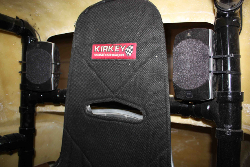

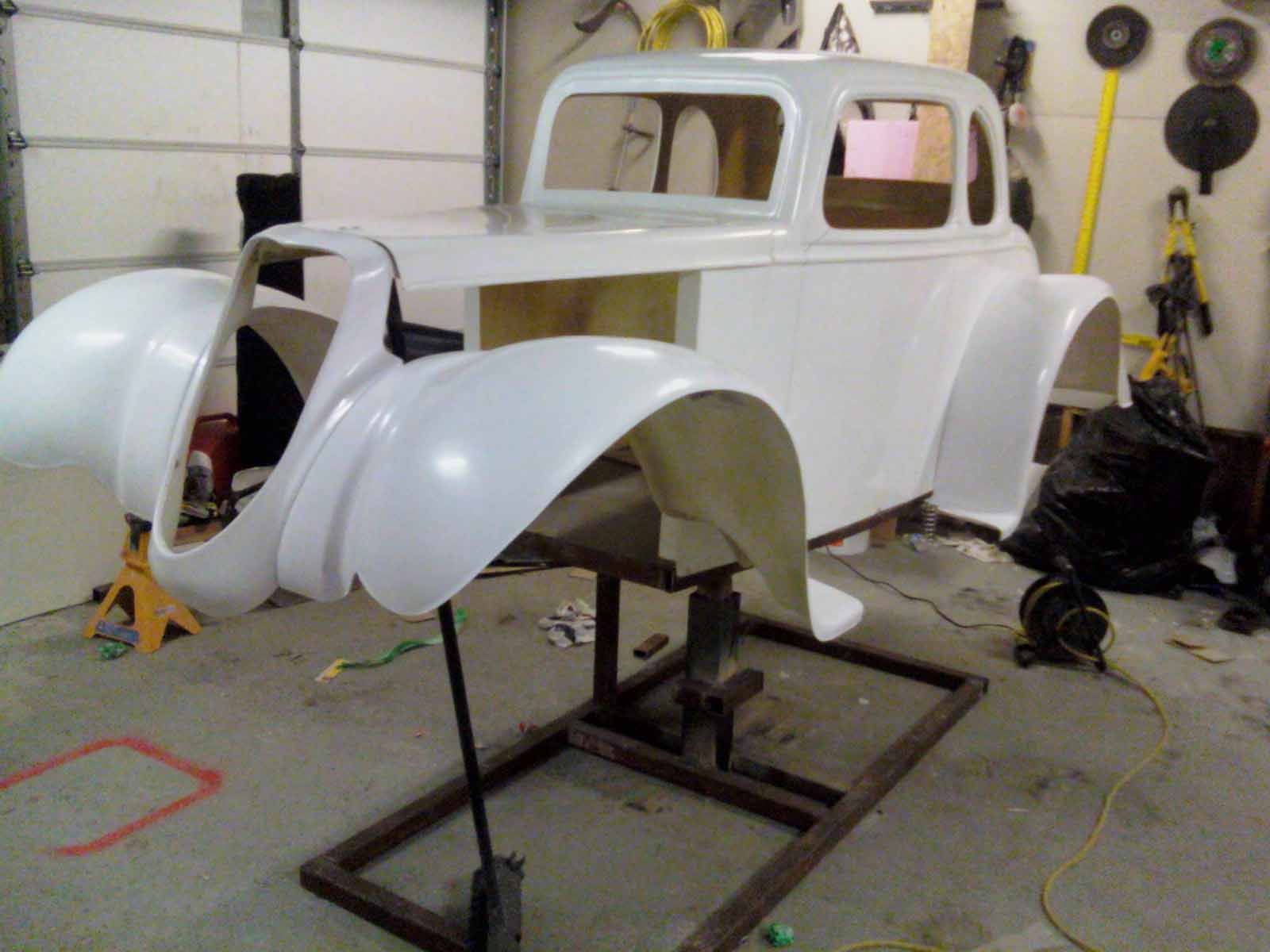

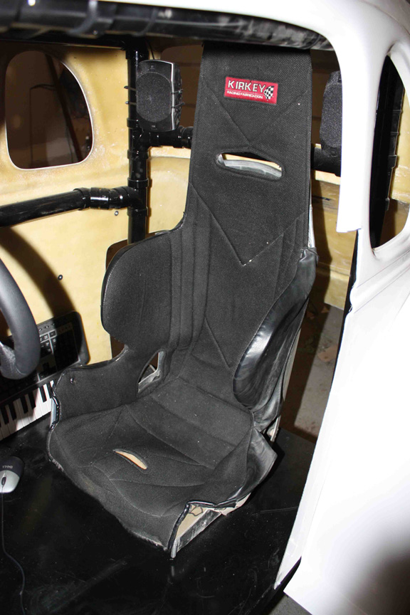

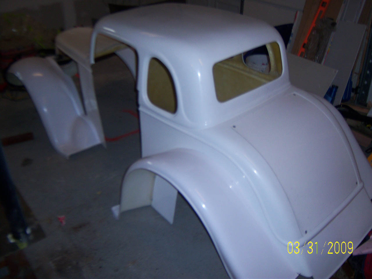

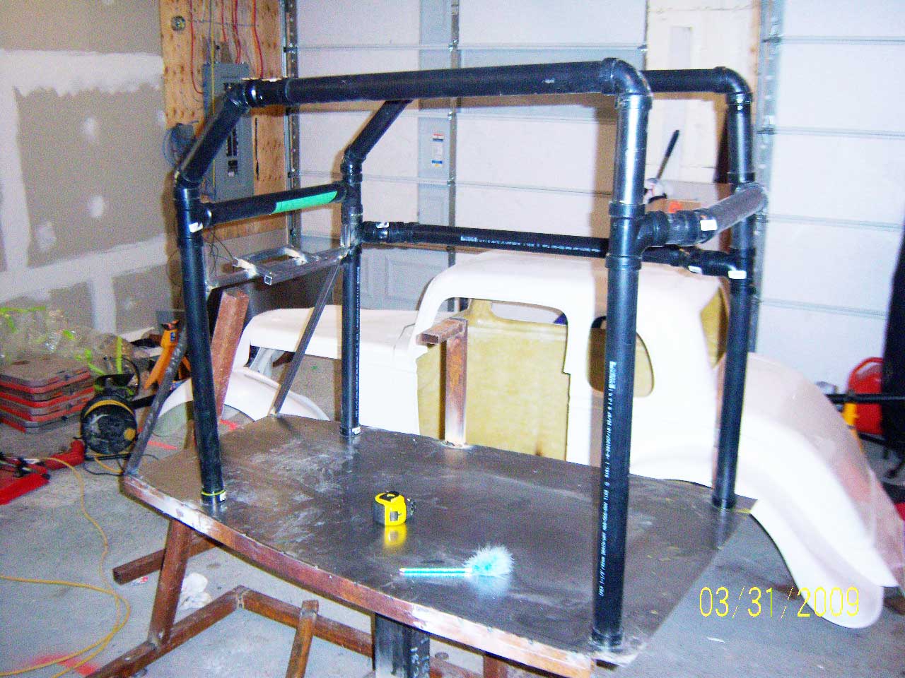

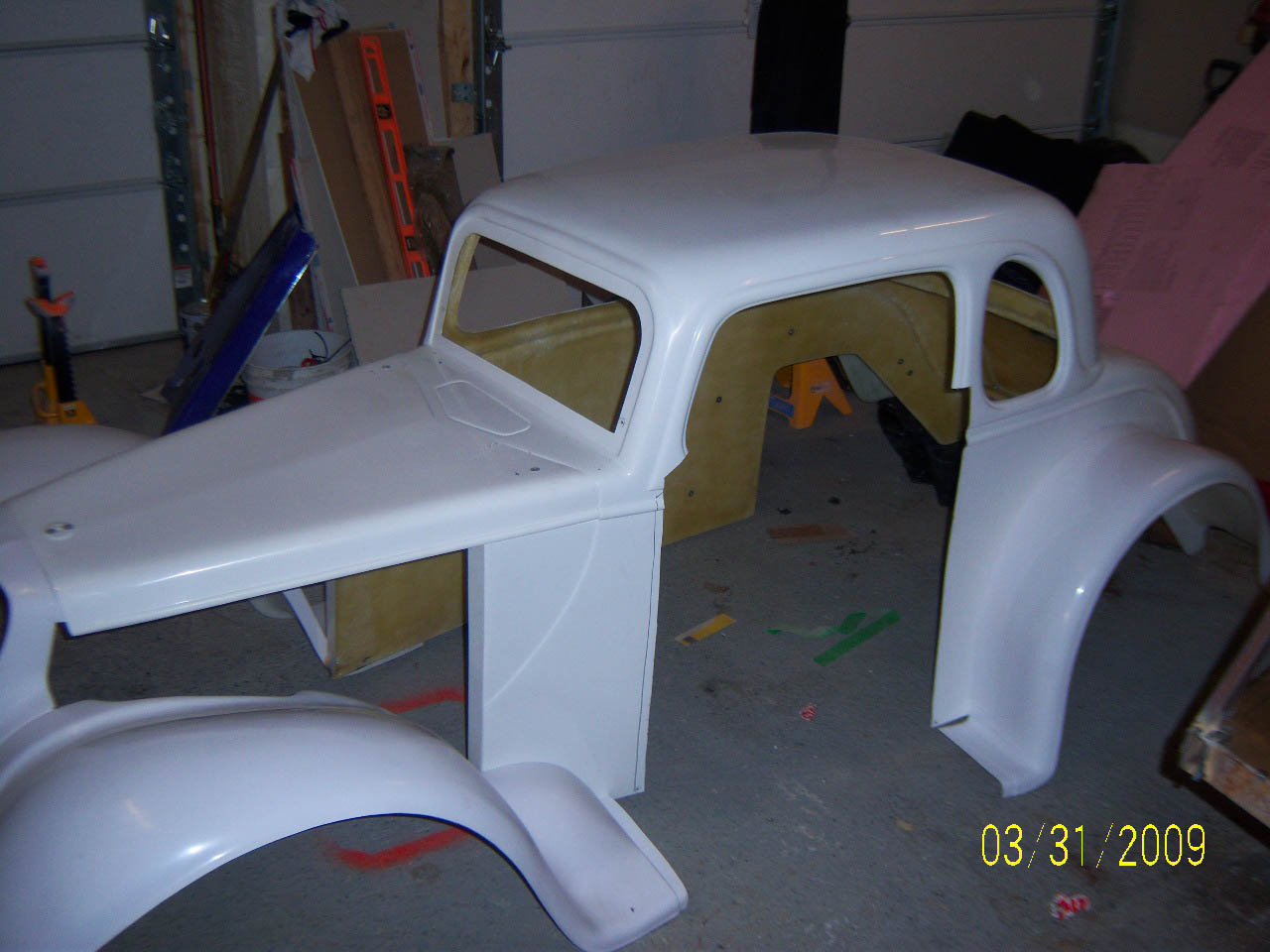

    Hi Guys thanks for responding i will be taking a legends car frame and body
    minus motor, rearend, misc. uneeded parts and mounting this to a driveshaft center pivot
    I will be adding a 24 Monitor and speakers to the unit...
    I will try to find out exactly how much the chassis without all that weighs...

    Wow, that's pretty cool. I really hope you wont shipwreck due to undersized actuators. I really would like to see this beast moving well.
    hint: Elektronikjack uses a DC h-bridge which he has gathered out of a forklift from junkyard. Maybe you are able to dig out something similar.
    How much are you going to spend on motors and gearboxes btw?
    Have fun!

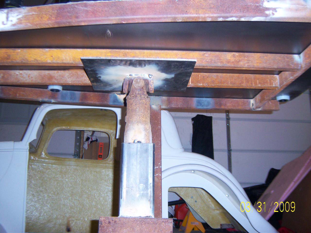

    Plan is to use the biggest dc motors i can find that R-eng/Tronic's new motor controller can handle..
    trying to keep cost to as little as possible however i have to have motion so my threshold might rise.... :brows: :brows:
    On another note does anyone have any suggestions as to how i might be able to test how much force is needed to tilt my platform??
  10. adgun
    adgun Active Member
    Jan 28, 2008
    532
    mechanic
    Netherlands
    5,769Coins
    +137 / 4 / -0
    use a libra/balance
    and fit a piece of wood between libra and simulator.
    regards ad

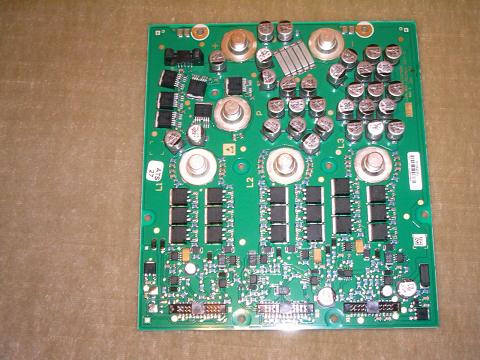

  12. ElektronikJack
    ElektronikJack Member
    Sep 15, 2007
    83
    Techniker Elektronik
    Germany Itzehoe
    - 40Coins
    DC motor
    Hi mohawk24
    very impressive project !!!
    i have some of this big 3 phases 24Volt H-Bridges left ( i think you can use it for 50Amps (up to 100Amps ?!?), Peak current of the Switchers is 440 Amps).
    if you whant to use it with the tronic controller you have to talk with tronic about a litte
    change in the software.
    But you have to think about a AC-Gearbox motor with a motor-driver.
    If you finish the complete car the mass, that have to moved by the motors, will grown.
    You can move the light seat-sim only by one hand and the are normaly balanced in the center of gravity.
    bye dirk

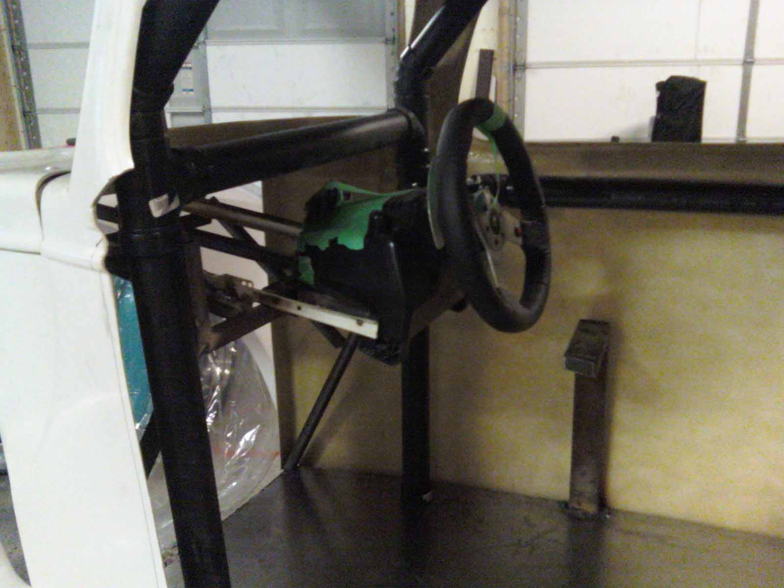

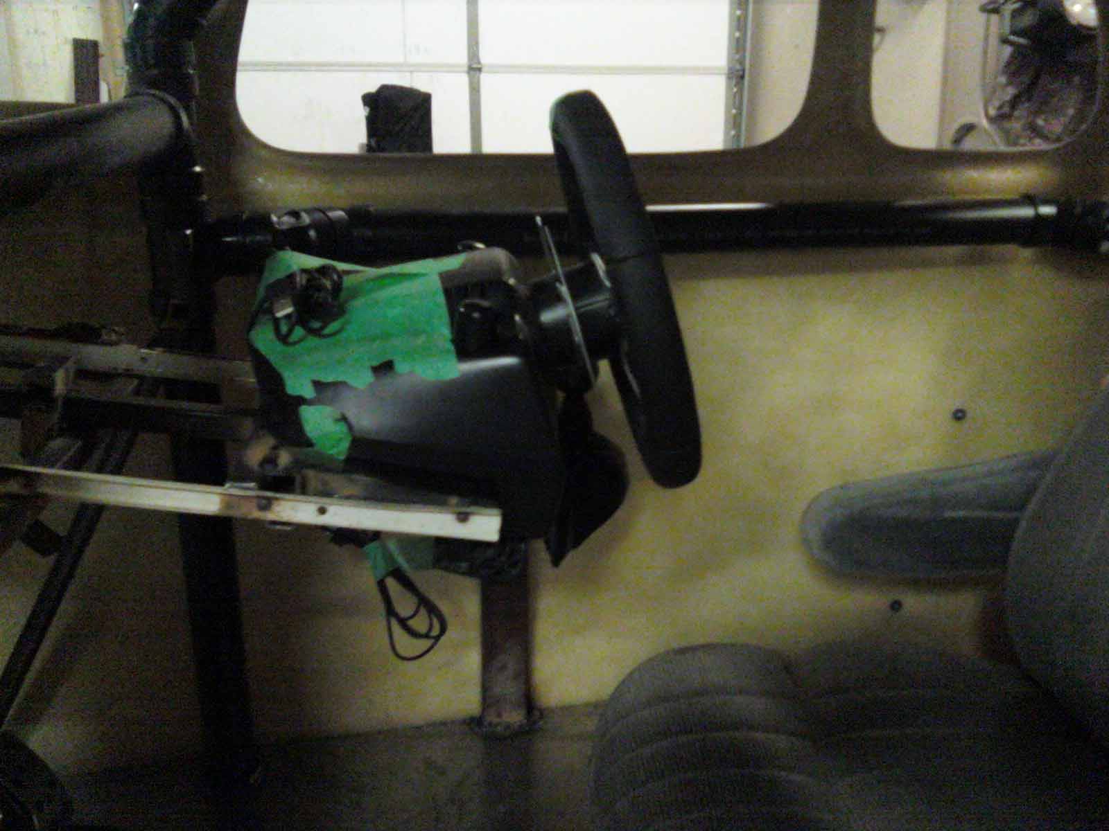

  13. mohawk24
    mohawk24 New Member
    Jan 5, 2009
    31
    0Coins
    Re: Beginning of my new simulator-UPDATES

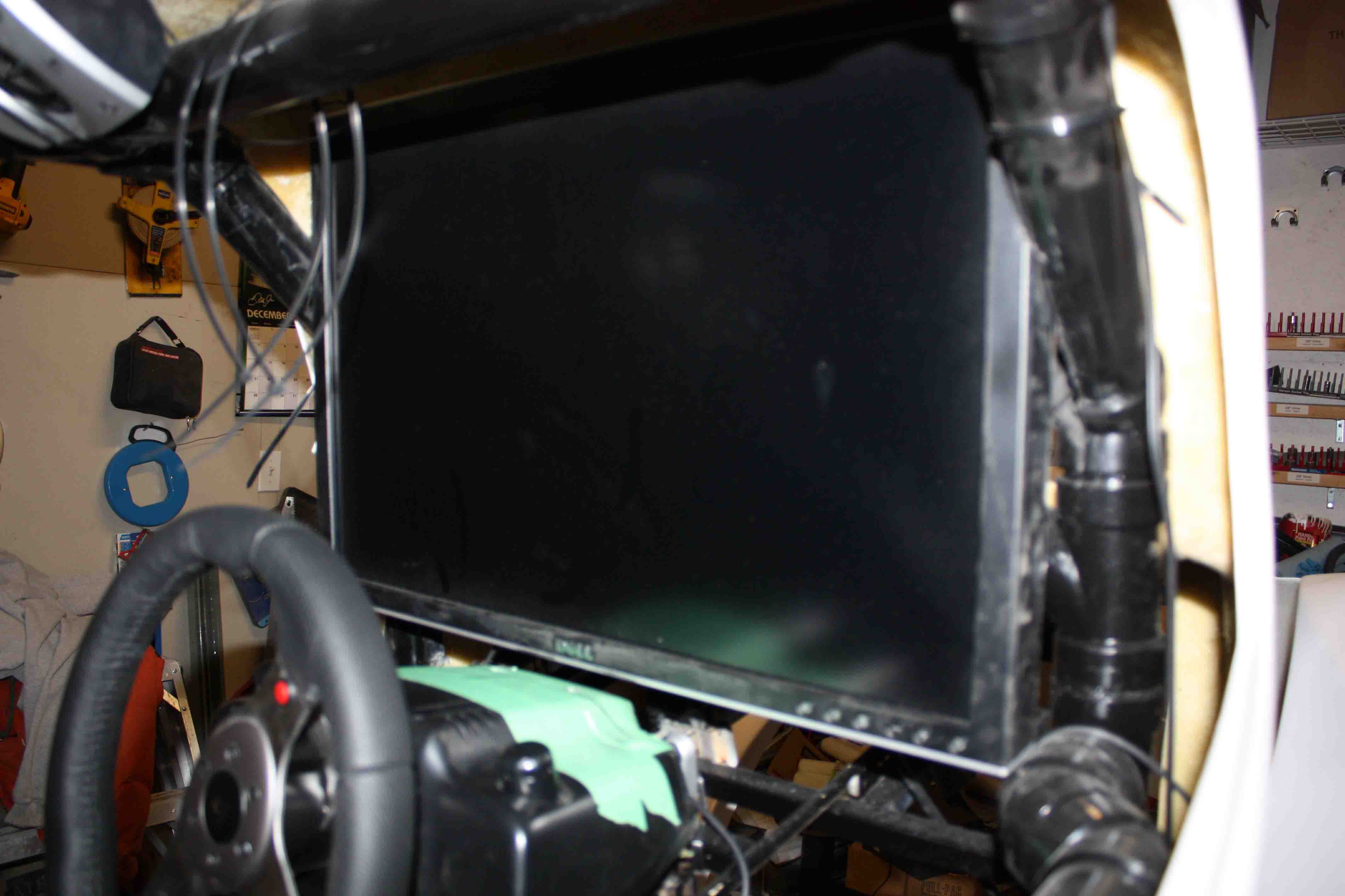

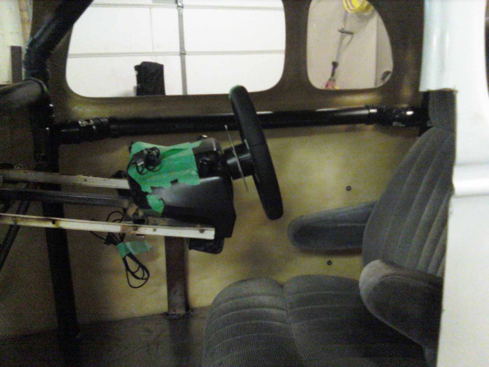

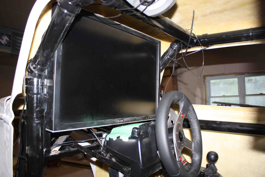

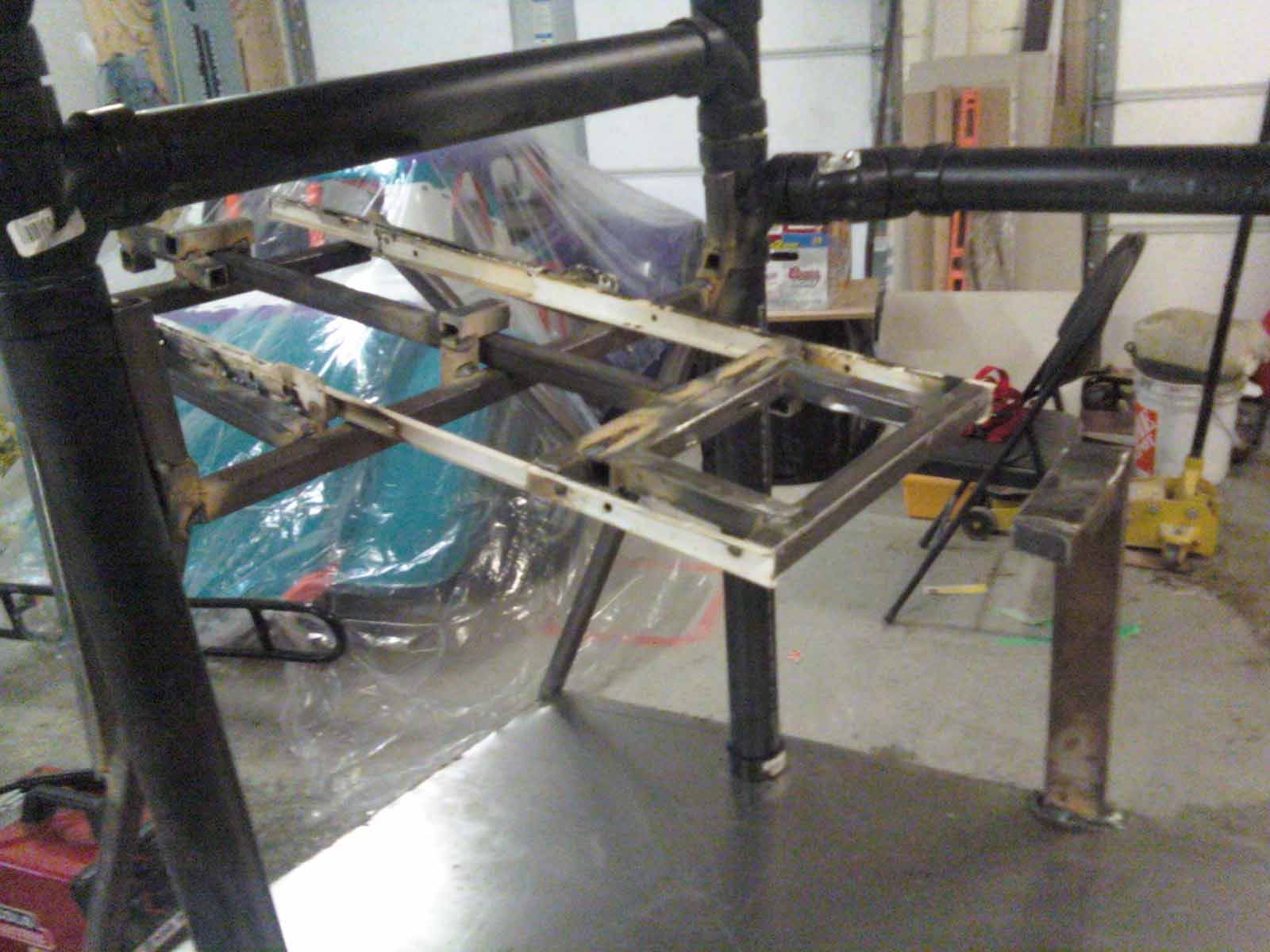

    Here are some updated pics of my simulator

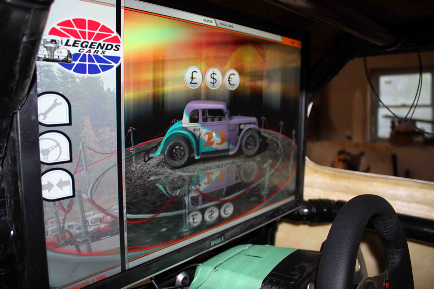

  14. RaceRay
    Nov 8, 2006
    4,657
    Hamburg, Germany
    23,875Coins
    +2,037 / 13 / -0
    Your DELL LCD fits on the inch exactly to the left and right, no more space for a piece of paper :)
    Where did you find this motors? 1.5 HP / 1120 W is enormous!
    I assume you want to control them with modified Tronics AMC interface and a frequency converter?

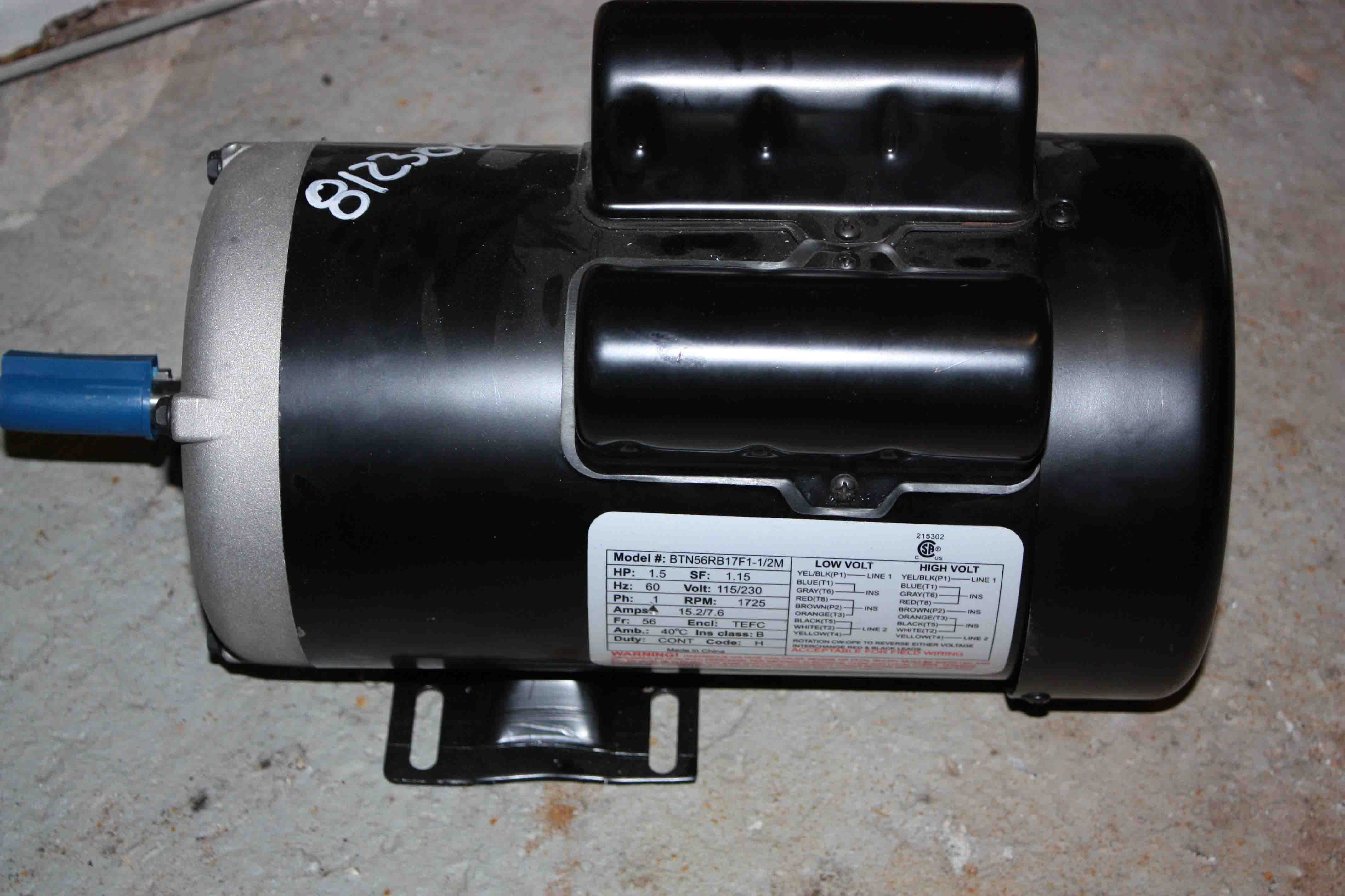

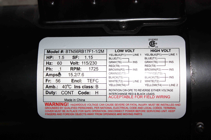

  16. mohawk24
    mohawk24 New Member
    Jan 5, 2009
    31
    0Coins

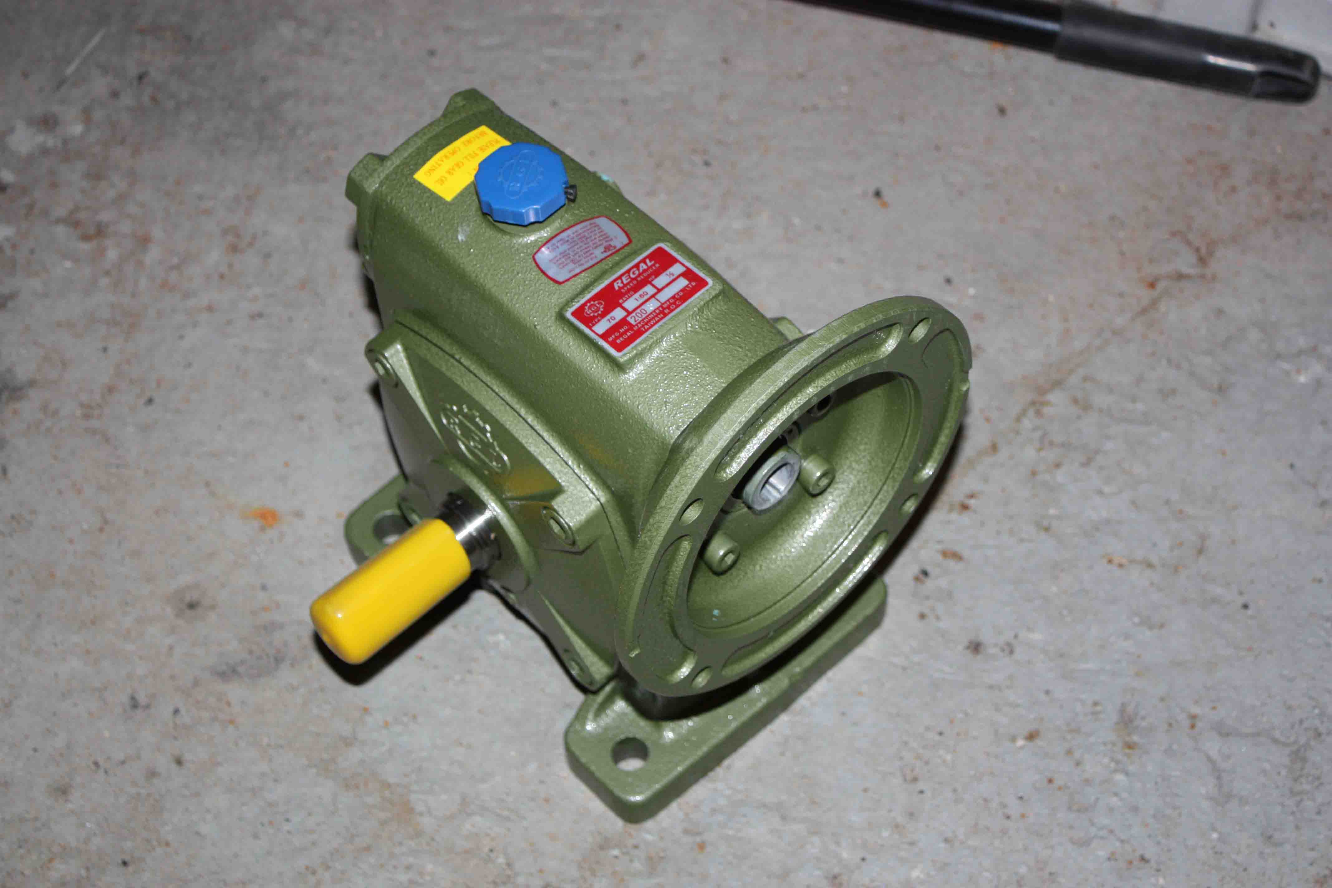

    The motors come from a store here in canada called princess auto....
    they are fairly cheap $ 180 canadian dollars so $1.50 anywhere else LOL....
    I will definitely be using Tronicgr's AMC 1.5 with the tweak to control VFD and AC motors...
    my platform is pretty big and heavy...
    I originally planned to only use a 19 monitor but i managed to shoehorn in a 24 LOL :cheers:
  17. RaceRay
    Nov 8, 2006
    4,657
    Hamburg, Germany
    23,875Coins
    +2,037 / 13 / -0
    Your project is gettting more and more interesting, would be great to see a first AC motion simulator with AMC and VFD here. I keep on watching your thread :)
  18. ElektronikJack
    Sep 15, 2007
    83
    Germany Itzehoe
    - 40Coins
    DC motor
    i have some (3PH) DC Motor (up to 24V) Bridges left!
    try to build the car in the center of gravity to reduce the needed force for the movement and make the system fast !
    bye elektronikjack
  19. mohawk24
    mohawk24 New Member
    Jan 5, 2009
    31
    0Coins
    Thanks for the advice electronicjack....
    I have built the platform so that all weight is balanced over pivot point...
    Steering wheel and pedals are adjustable to keep the driver positioned correctly...
    DC motors while strong enough....unfortunately I feel that only AC motors and drives will be sufficient to move my platform at the speed that I desire..... :eek: :brows:
    Tronic and R-eng are currently working on a high power bridge however I don't think that even 150 amps would help me...thus the decision to go AC...
    with the tweak that Tronic has made to the AMC to allow AC control I will be OK....
    I will have 3ph motors by this week still trying to find all parts for AMC or find someone willing to sell me one premade....
  20. mohawk24
    mohawk24 New Member
    Jan 5, 2009
    31
    0Coins
    Motor take two.....

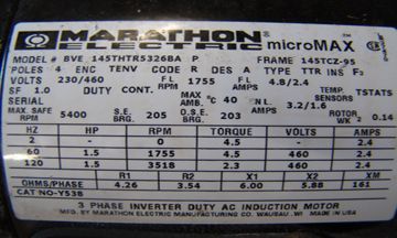

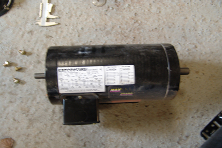

    I had noticed a fatal flaw in my original plan of action I had acquired 2 motors both were 1phase, my platform requires 3phase to operate with VFD's
    I have fixed that by purchasing 2 3phase motors from ebay....
    marathon 1.5 hp motors made specifically for inverter drives...with heavy duty insulation for heat protection....
    I'm looking for someone on this forum to sell me an AMC1.5 fully assembled and tested....
    question the motors have a shaft on either end...can i use either end ?????
