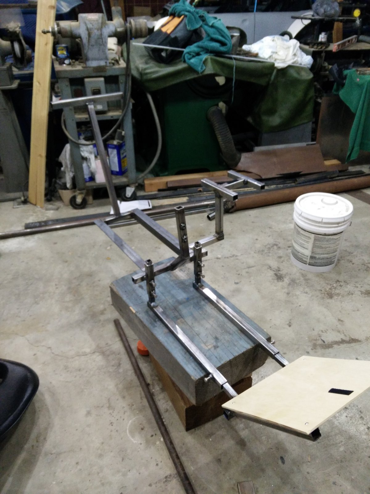

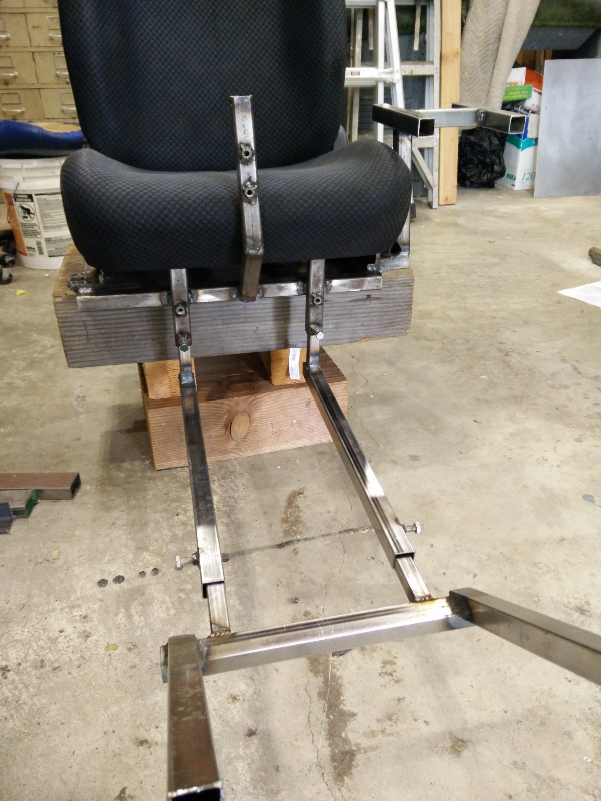

    Update! I've finished the majority of the seat frame. I'm going for shoulder mounted with onboard pedals/wheel/joystick. The frames on car seats aren't actually symmetrical, which caused a bit of trickiness when making the shoulder bar. If I could do it again, I wouldn't use a car seat. Lots of adjustability for the pedals and joystick height as well.
  7. bsft
    Carseats cheap, but can be heavy.

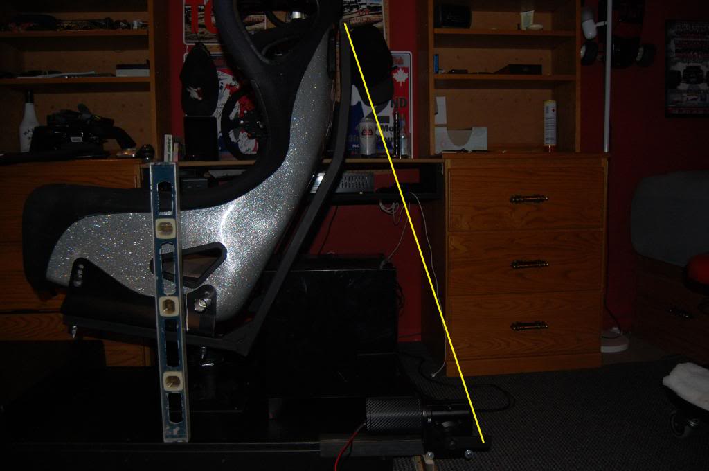

    Thanks for the feedback. Yes I've got the balance point marked and I'll check it a few more times before I commit to welding, just to make sure it is correct. I'm tempted to change out the seat for something lighter, but I'll see how it goes. As far as the motor gearing is concerned, 25:1 compared to something like 50:1 means a faster motor, but less overall torque, correct? So I should go with a shorter arm to make up for the lower torque value? Also, what angle should the motors be mounted. I've mostly seen the arm extending backwards, but what would change if I mounted the motors so the arm is parallel to the shoulder bar, or even at a 45 degree angle?
  12. Nick Moxley
    17,054Coins
    +2,504 / 30 / -2
    Without getting technical and measuring Exact #'s for degrees, This is Close to ideal for your angles....straying too far away from these angle's will only lead to more load on the motor's and slower performance.

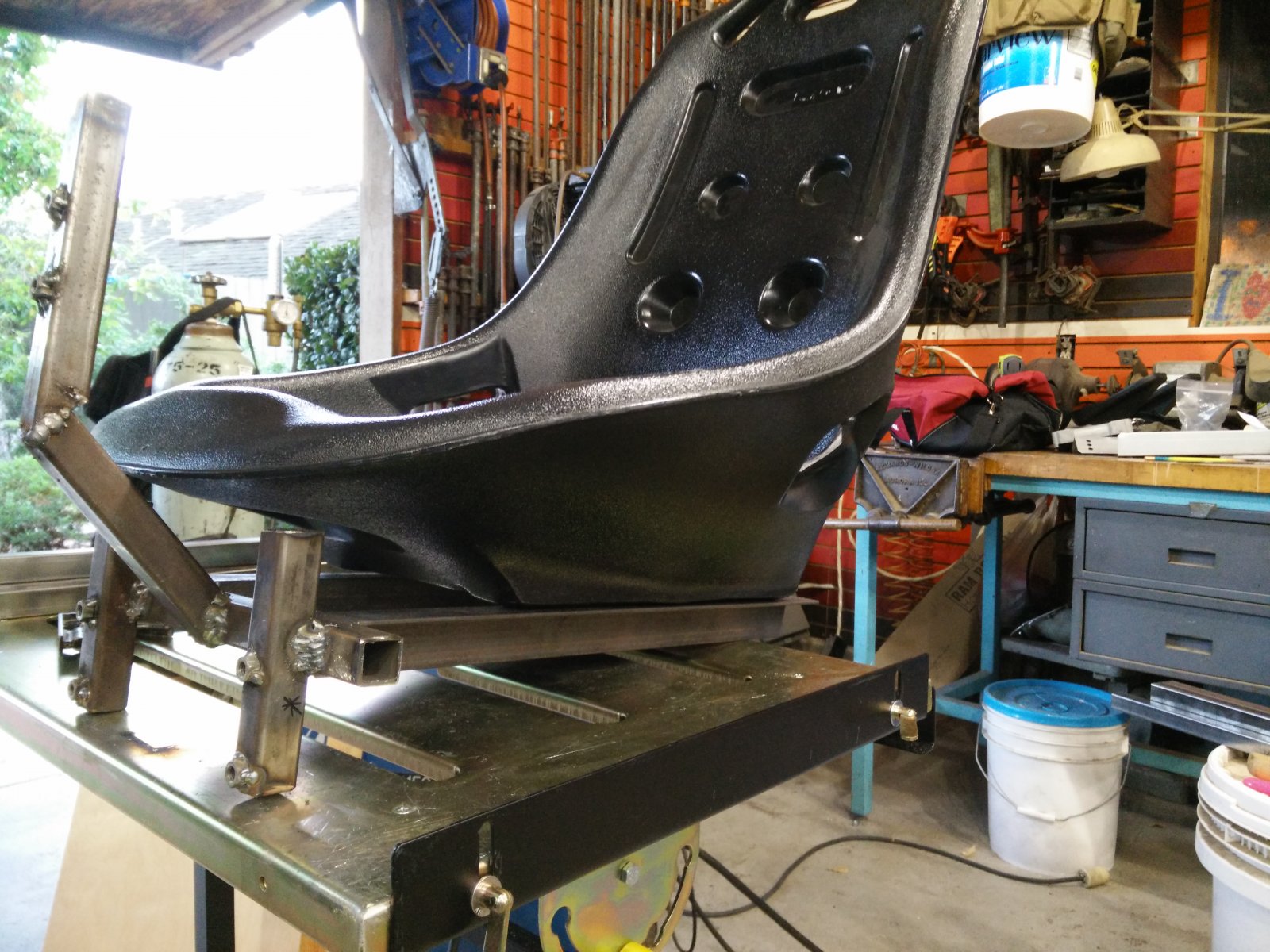

    Awesome, thanks. I've decided I'm just going to do it right and ordered a lightweight racing seat.
    It'll shave off 20 pounds of the final weight, a lot of that being topheavy weight on the chair back.
    I'm also going to take the opportunity and make the frame symmetrical.

    Quick update. I've gotten the new chair and redesigned the entire frame. It's much more compact and focused. Next up is competing the bottom frame.

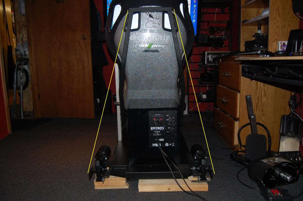

    I'm currently harness shopping, and noticed that some people use springs on the harness to simulate tension during braking. Can anyone let me know if that effect is worth the cost? Any adverse effects on the motors? Also, would trampoline springs work? They seem to be the cheapest option:
    amazon.com/Upper-Bounce-Trampoline-Heavy-Duty-Galvanized/dp/B005OCYUMI

    I have not finalized mine yet but tested the harness with elastic cords and can say it is definitely worth the little it costs to set up, with no real downside.

    I have not tried it without springs so I can't say what is would like that way. But I do like it with the springs, it works well. This is what I bought http://www.ebay.com.au/itm/SPRING-K...49?pt=LH_DefaultDomain_15&hash=item3aa916be91. I then set it up with 6 of the strongest springs of that kit. They are all mounted next to each other to give the whole setup more strength. I first thought all of those springs might be to small and I wasn't sure if it would work or if I even like it. But for the cost of this kit I thought I'd give it a try.
    As for affecting the motion, I personally can't tell the difference between wearing the harness or not. If anything, wearing the harness adds to the immersion especially under brakes as you feel the pressure of the harness on your shoulders.
    I think it works well.

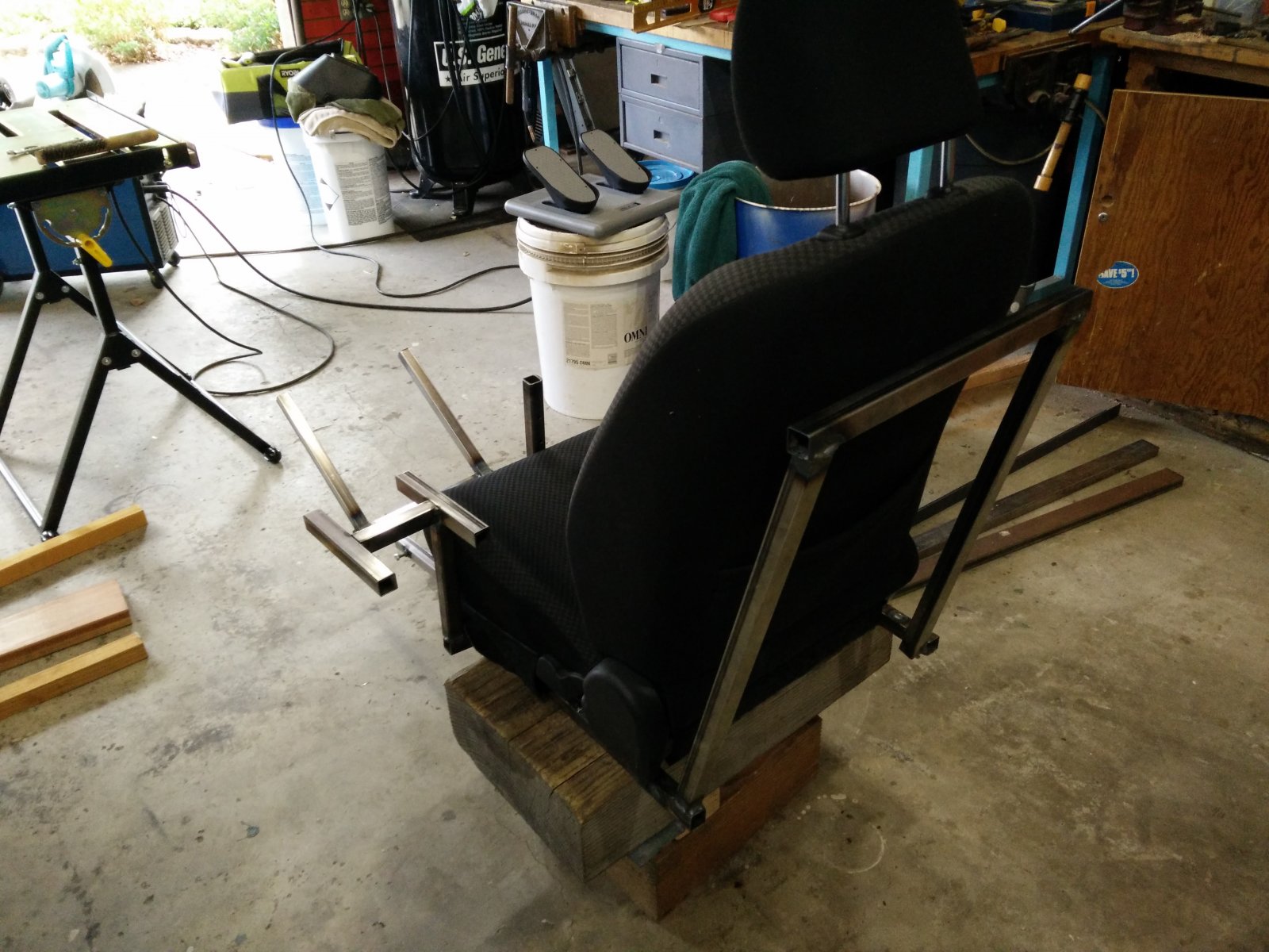

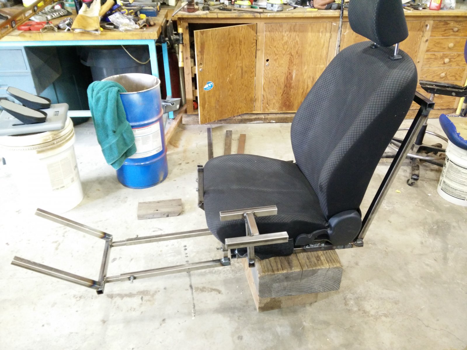

    Thanks for the advice. I've gotten the seat mounted to the frame and everything is looking good. I made one small mistake in that I could've mounted the ujoint a half inch closer to the seat but accidentally left some unneeded material in. My question is: is a small improvement like that worth grinding and rewelding? It would be pretty time consuming. Does .5 inches matter for the ujoint?
  20. noorbeast
    20,569
    145,232Coins
    +10,783 / 52 / -2
    I don't think it is worth it for half an inch.
