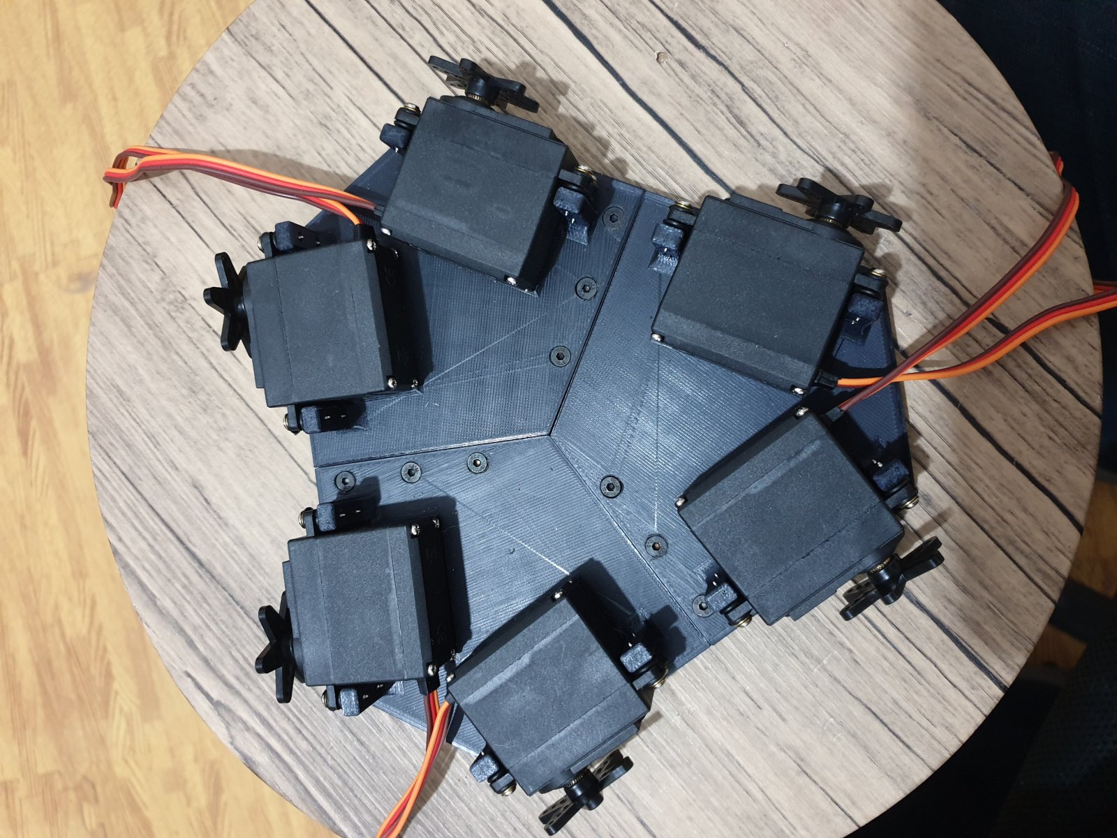

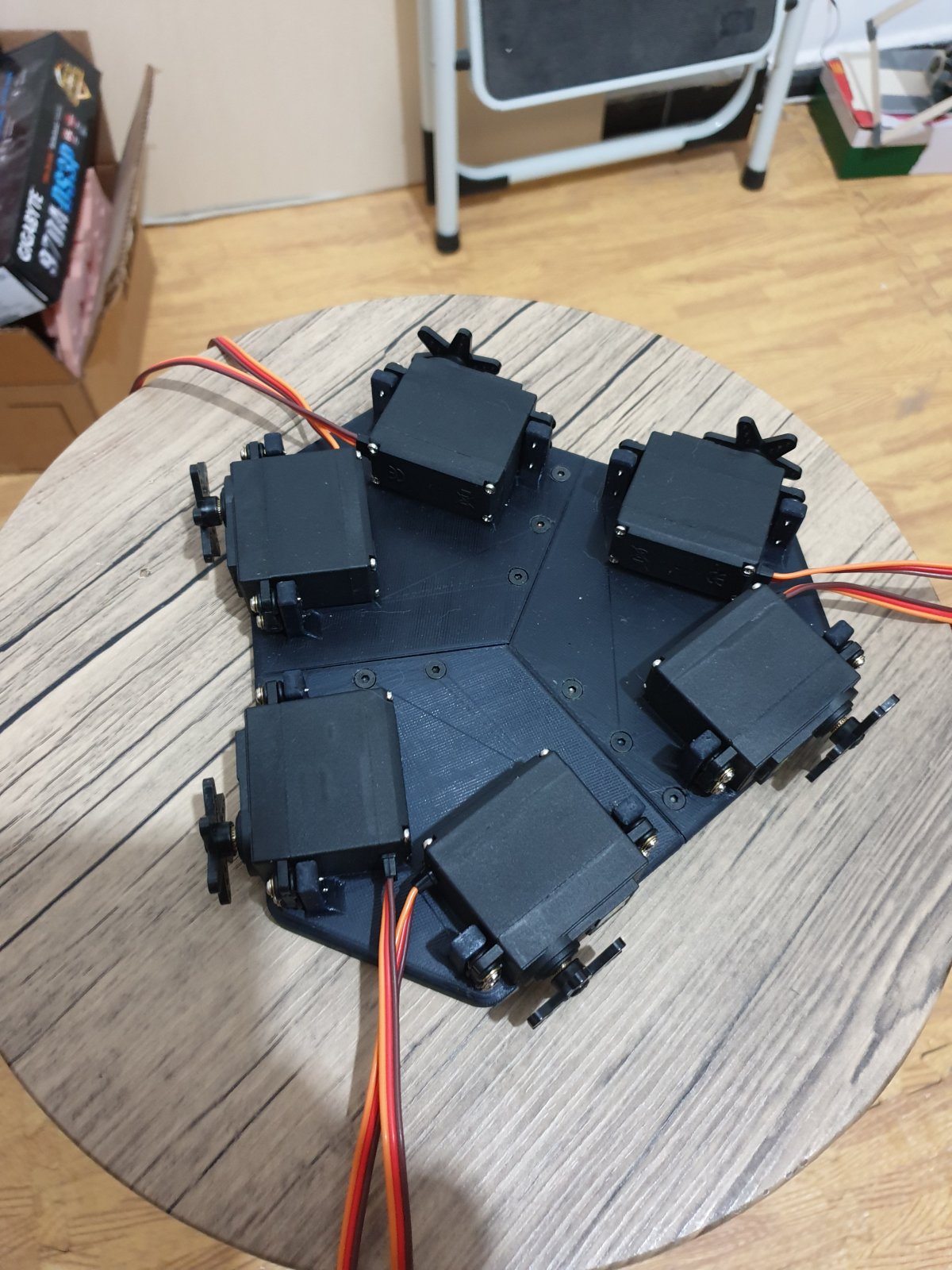

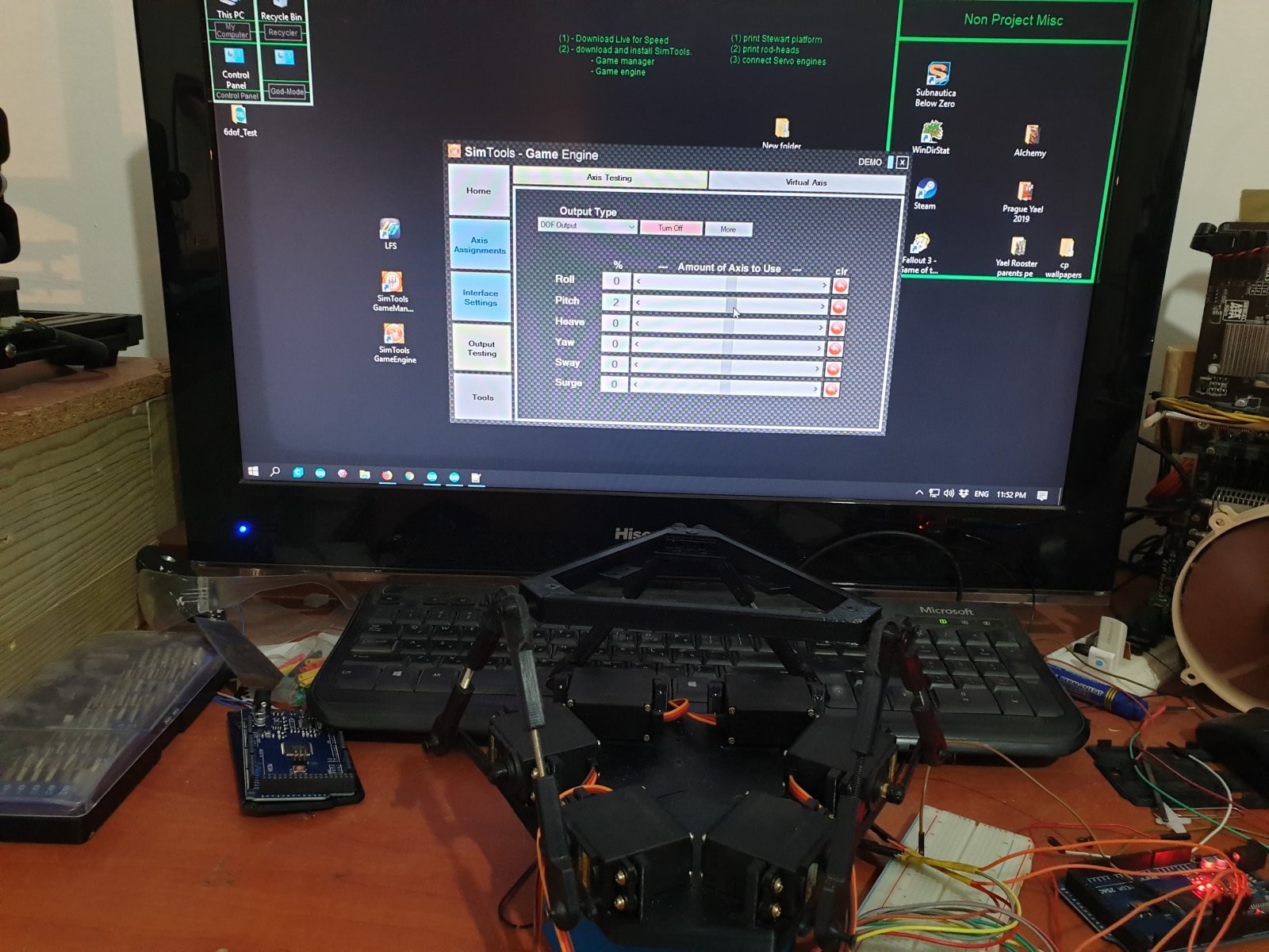

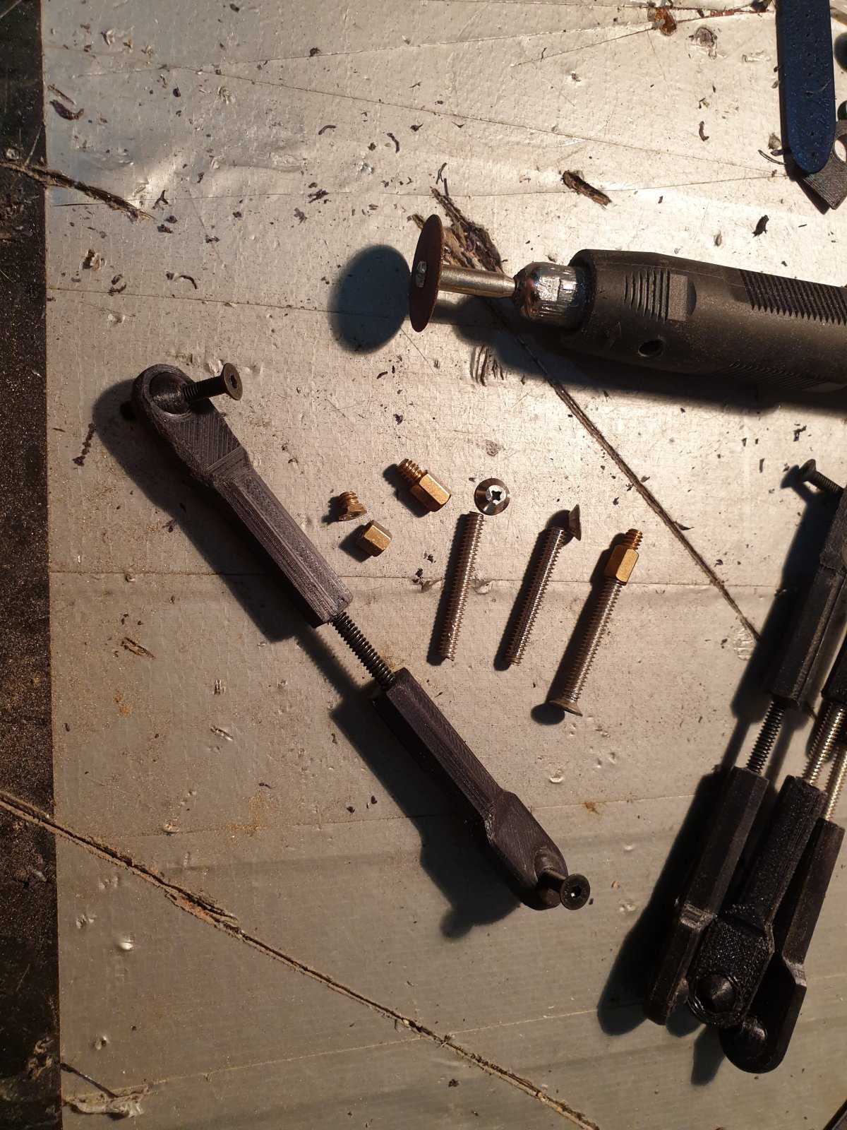

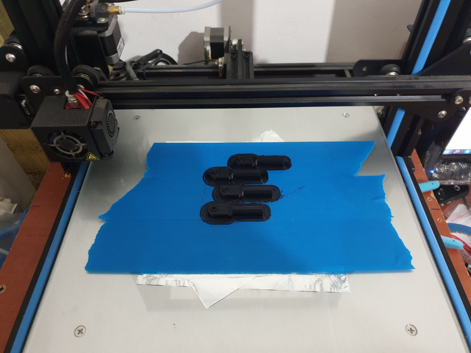

    Ok so - Weekend !!!
    While the printer was working hard, I downloaded Live for speed,
    and SimTools, and got a first feel of things with some micro servos and an Arduino.
    Was it perfect? no. not yet. Did it work?.. well not out of the box, BUT !!
    and that is a very big but - plug-and-play, the servo moved while I was doing things in the game.
    Conclusion?
    It works.
    So off to the next stage - a full on, 6dof, mini platform.

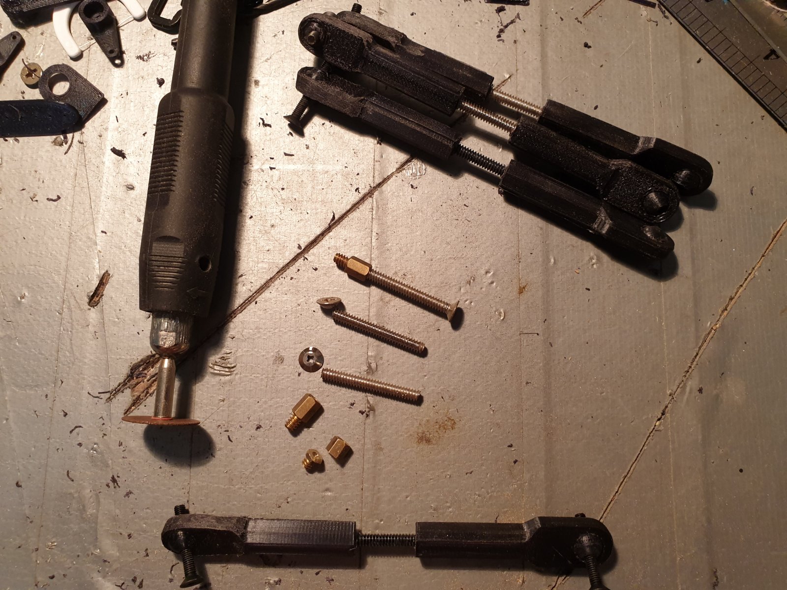

    Credit to - SF3DPrint, from Thingiverse
    https://www.thingiverse.com/thing:2916371
    for the platform.
    the "rod-heads" where taken from some other proj, also on Thingiverse
    https://www.thingiverse.com/thing:3119992
    and they needed some filing down (Dremel), but I've got them to work in about an hour or so.

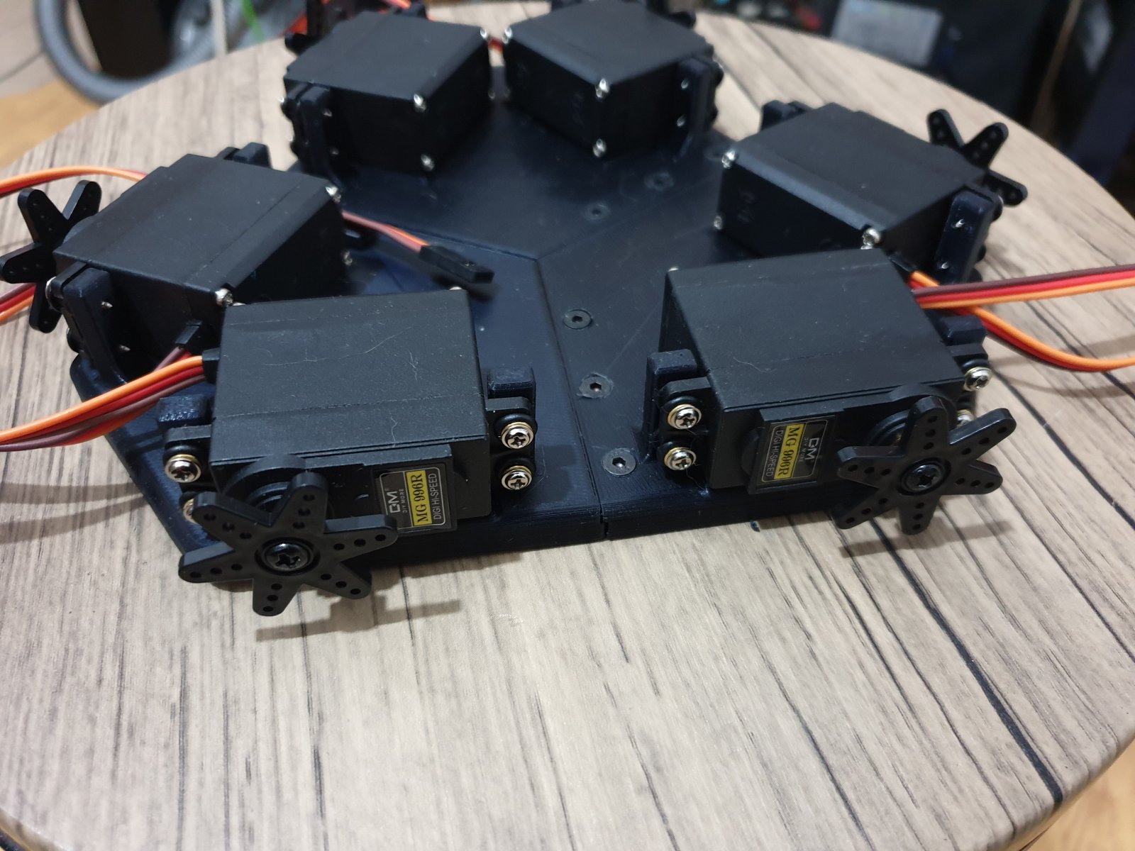

    Next - connect the joints with some paper clips, so I could modify the length,
    connect the servos to the Arduinos, and tweak the whole thing to work..

    Platform officially works.
    will upload a vid in the next few days.
    Next step - calibration.

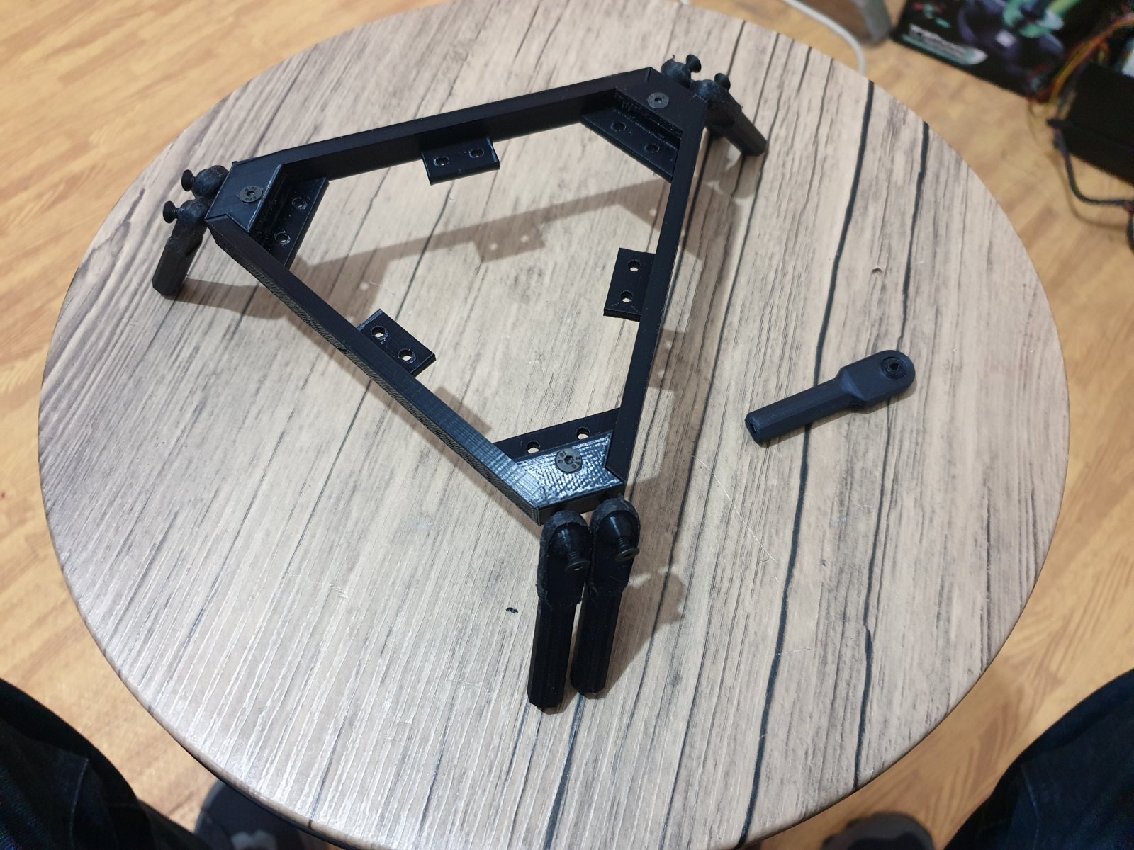

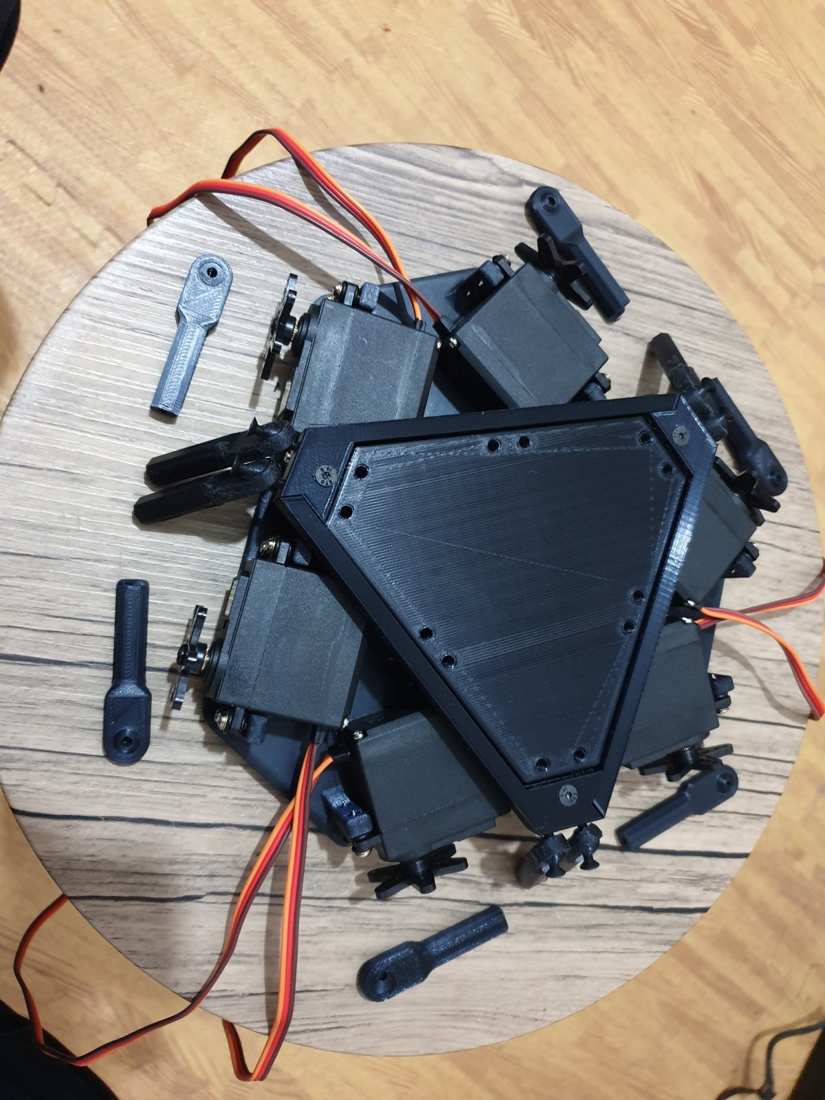

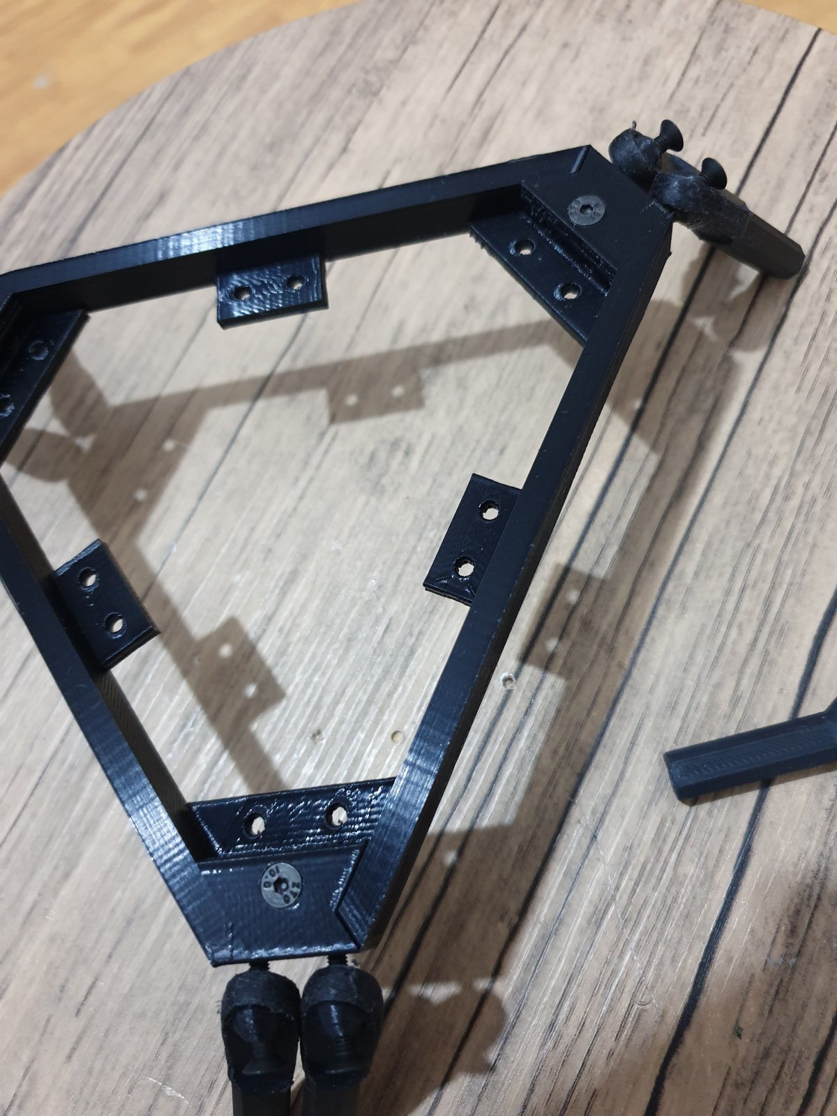

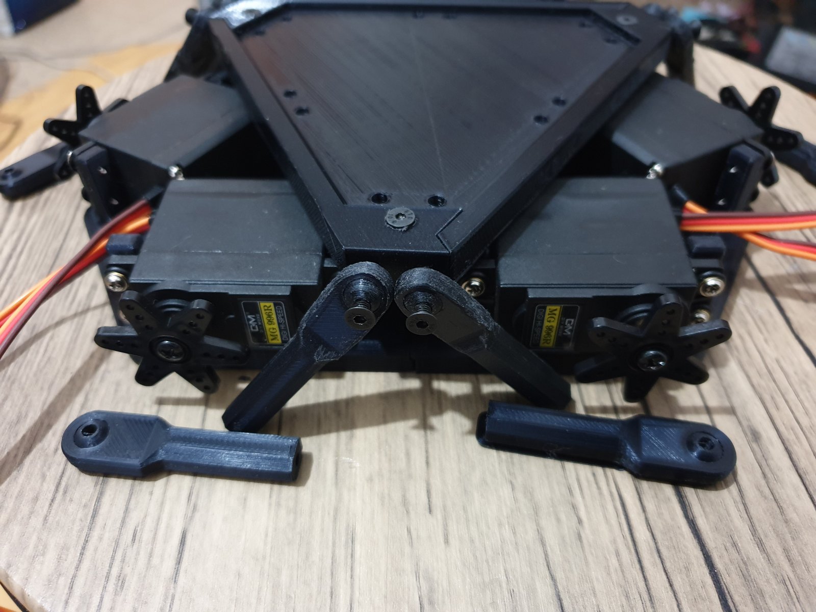

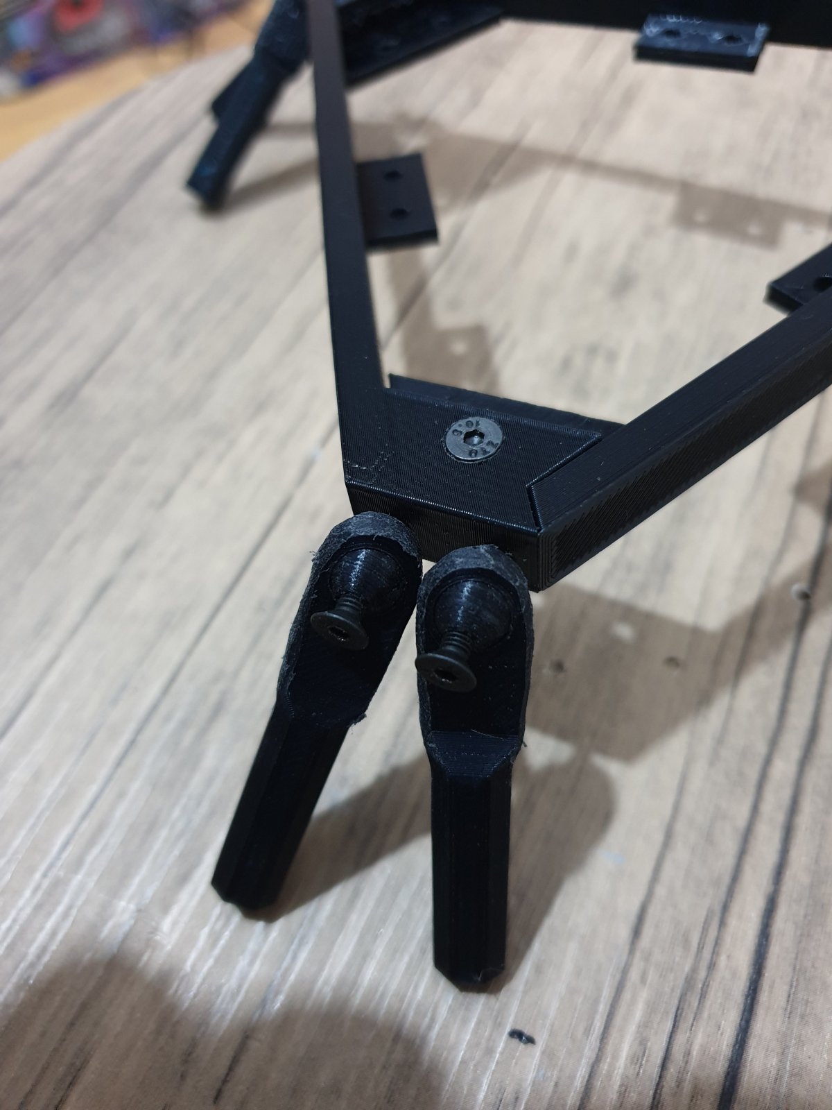

    THe last piece - creating turn-table part of the rods,
    and the actual platform

    And the test run ->
    :D Am a proud father.

    That looks great, good job! Out of interest, what software are you running on your desktop with the little green box and todo list?
