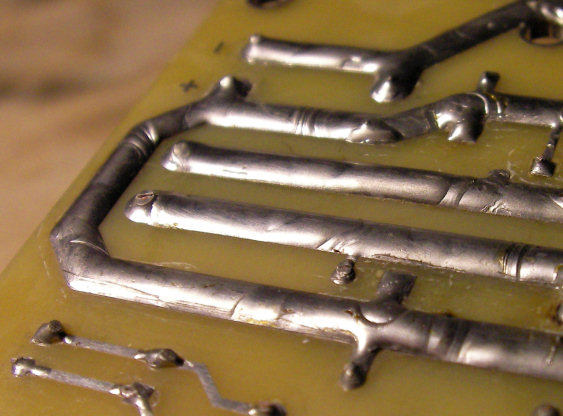

    This alternative works just as well with less hassle...but do it after placing all components using those traces.
    R-eng

    Yes R-eng, you are right, I would do so. But I think it's no option for one who is just learning to solder ;)
    And with the masked PCBs it will never work to tin the tracks.

    I should have been more clear. It would be the better option if, and when, he decides to do up new boards using ExpressPCB (which are not masked). IMHO it would not be too difficult to do with just a little practice. But maybe it is a little ambitious for now.

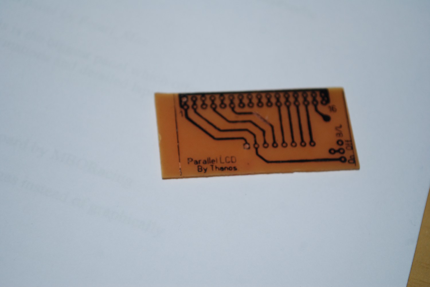

    I build a lcd board myself last weekend to see what happened, and the result is attached (one track I skratched just to check the resistence), but I tought the tracks were too dark in comparison with some results on online tutorials...just give me a quick tough on this if possible...

    You don't need to solder the wires all over the tracks. Just solder them to the solder joints (at the MOSFETs and the connectors) will be ok. Have a look at Thanos' example some posts before.
    No, the mask is a paint which can't be soldered. If you want to solder s.th. on it, you have to scatch the color off. In your case that's not neccessary. Just connect the wires to the solder joints will work fine.
