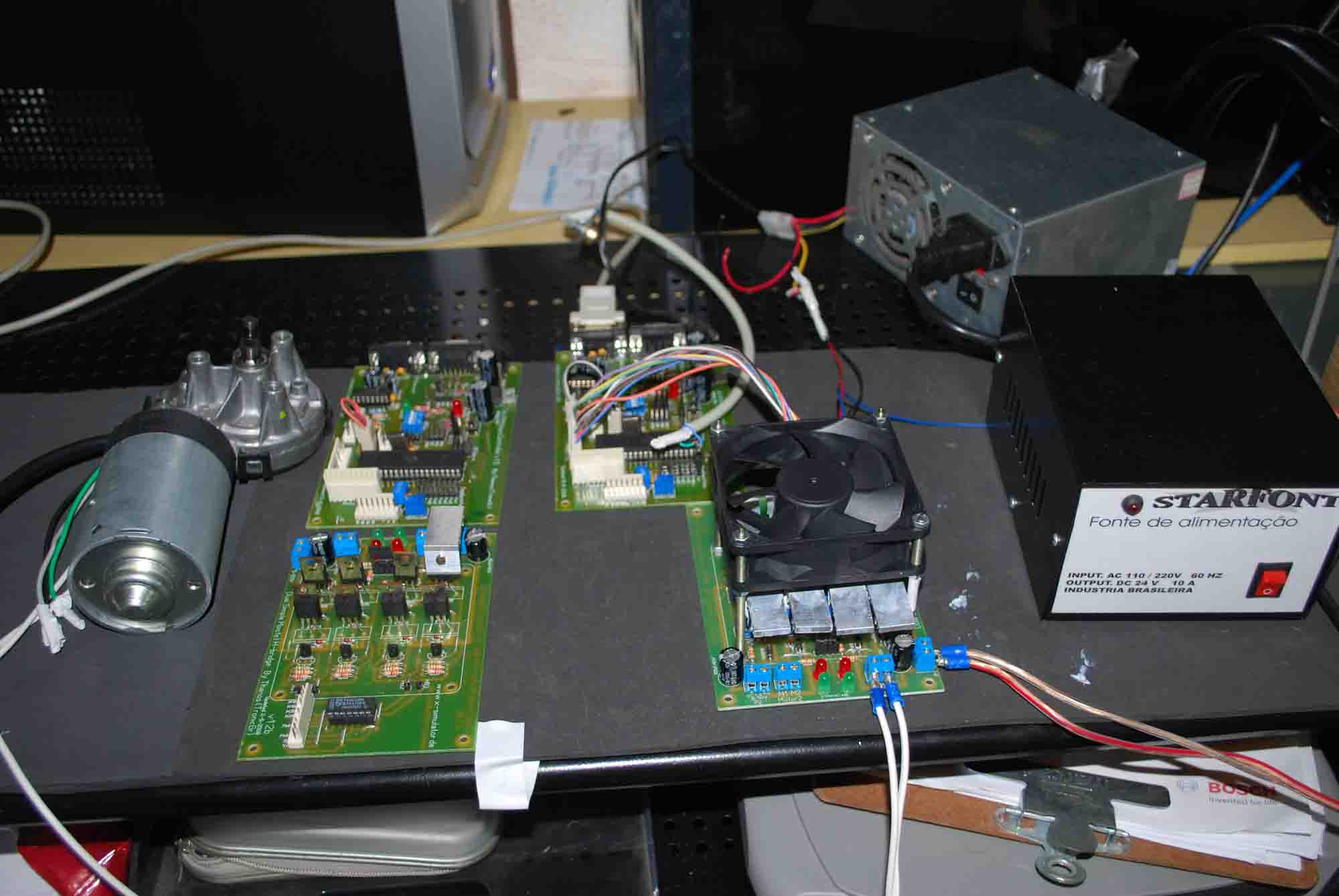

    hey guys...I will change all the mosfet from the board that is not working properly and check, I am sure they are the problem...
    the board that is working I just added the heatsink and tested, it worked fine. Now I added the cooler..it is working very good

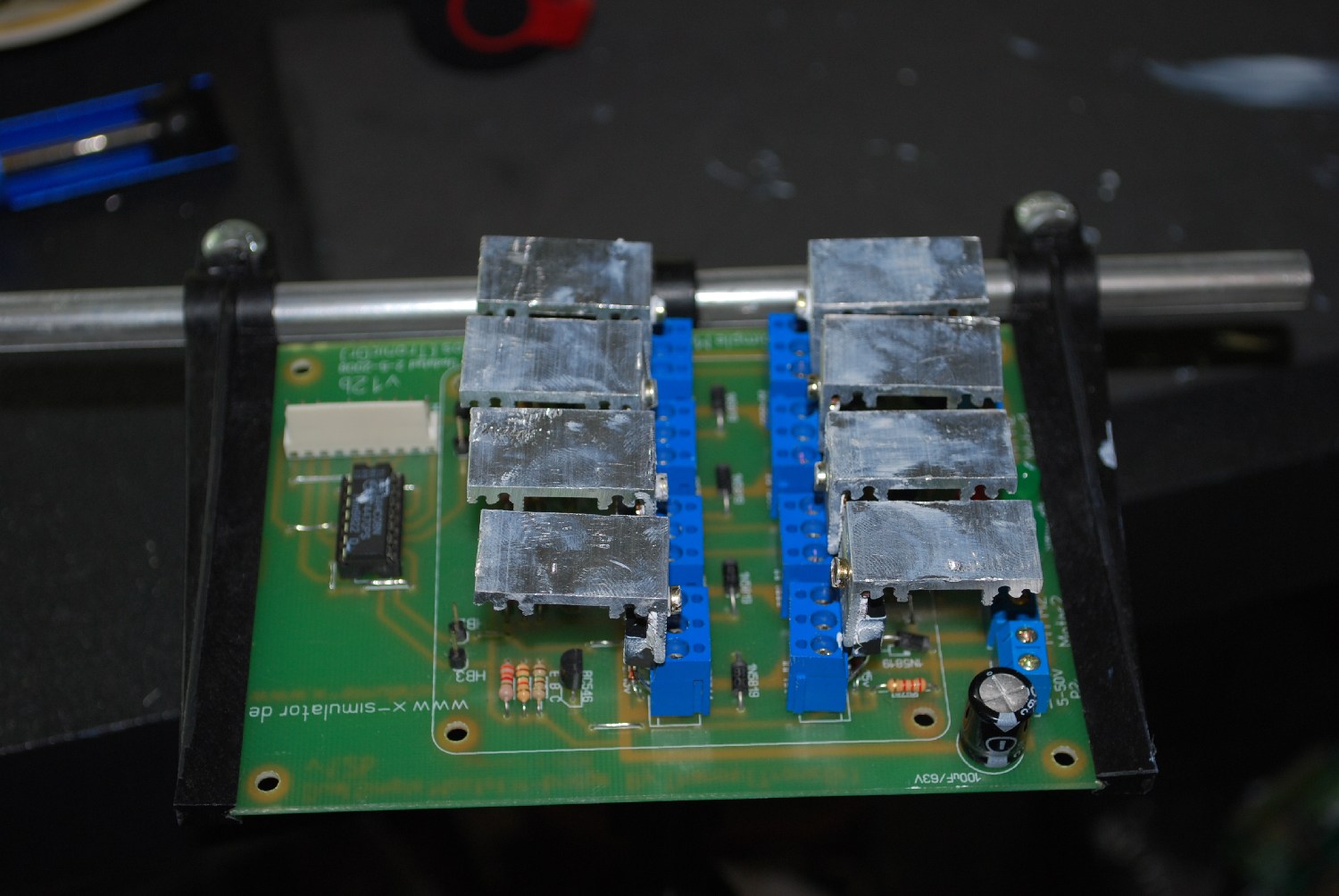

    let me know if the position of the heatsinks are ok

    Btw, heatsinks ar ok, as the are connected seperately anyway.

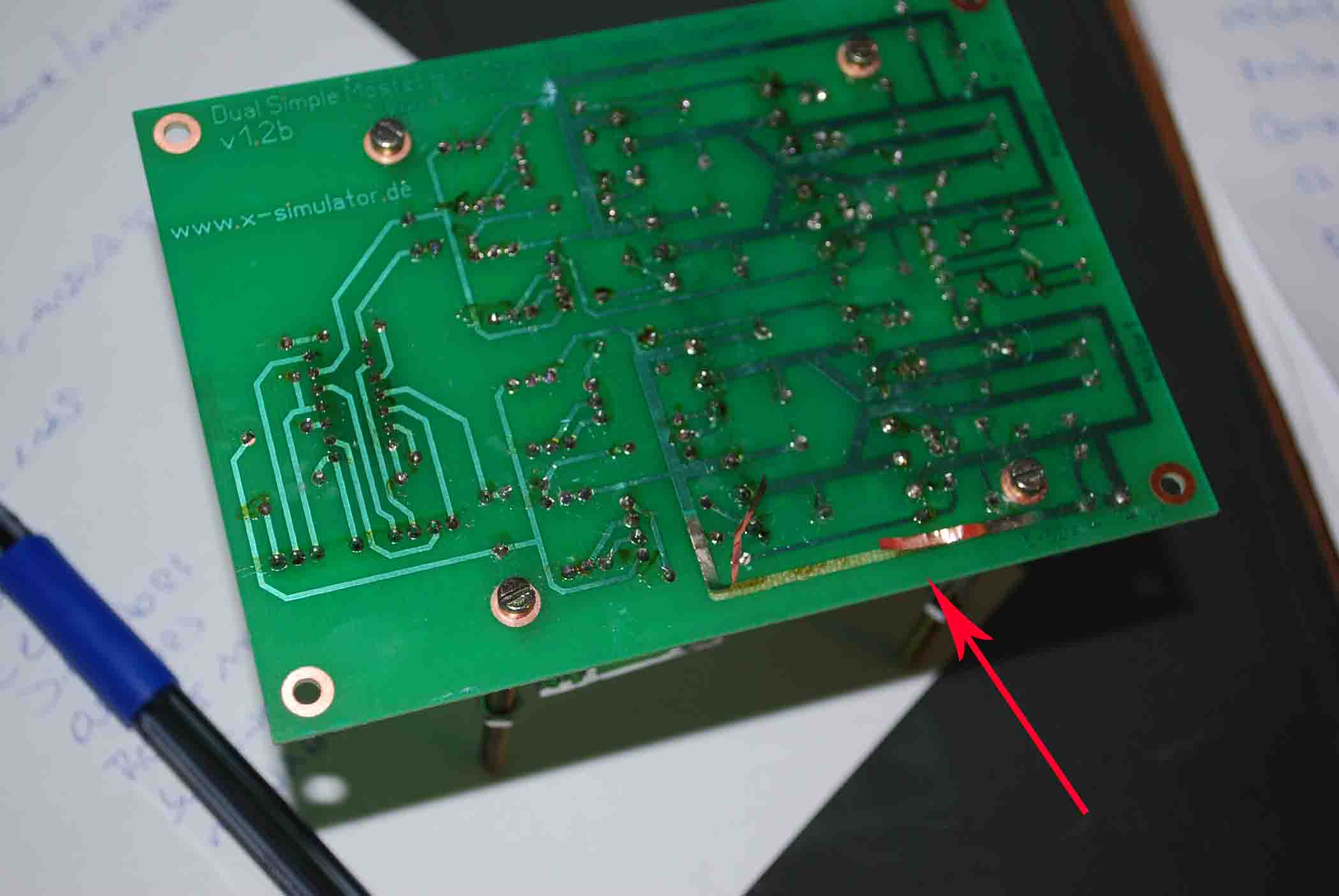

    the bad news is that 2 seconds after I stop recording, BUM..smoke, bad smell..all of those things you dont want to see... I think I burned one of my Mosfet...do they get burned with a few smoke and bad smell?? Yesterday I tested for much longer time than that and nothing happened...
    I hope the problem happened because I was moving the boards around trying to get a good angle and two things just touched causing a short..I hope nothing major ..lets face positively, now I realy need to learn how to check Mosfet :)
    the current situation now is that my h-bridge is not turning my motor and no leds...
    One thing I noticed is that the heatsink of one of my mosfet was almost nearly touching the screw holding the cooler...perhaps moving around the board to film, they touched and burned..heatsinks are very close to each other as well...what your guys tought about it??
    UPDATE:

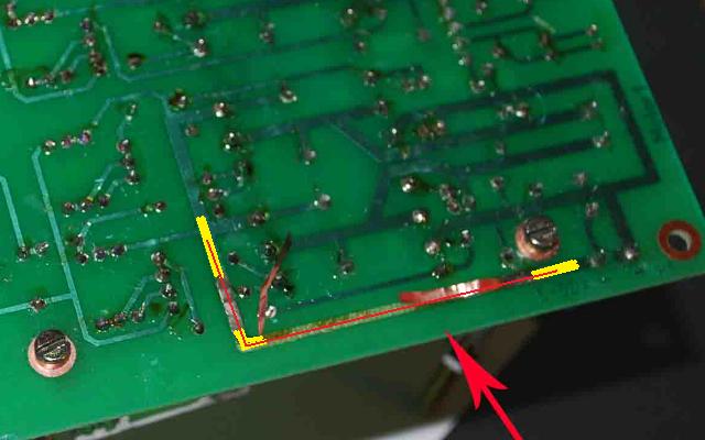

    REALLY BAD NEWS...I think this board is gone, I had the courage to take a closer look behind the board and the picture shows the mess...I think there is no way to fix that..correct?? please also help me with the possible cause so I dont do it again.. tks
  10. Kruemel
    Kruemel New Member
    Apr 5, 2009
    33
    0Coins
    That's not so bad, you can fix it.
    Look at the picture! Cut off the tracks which are burned and taken off. Remove the paint from the remaining tracks (yellow in the picture). Then take a piece of wire (copper, at least 1,5mm² - red in the picture) and solder it to the tracks.
    Have a look at your good one to see where the tracks are connected.

    The heatsinks cannot touch each other, correct? And if they are too close and I put some thermal paste between them?? does it help?
    I noticed also there were a few sparks when I pluged the gnd cable from the power source. (even with the power disconnected)...perhsps the problem is on the connector not on the mosfets..what do you think??
    PS. the second motor just arrived..need to buy second power supply now...100US$ here..a little salty
  12. Kruemel
    Kruemel New Member
    Apr 5, 2009
    33
    0Coins
    Thermal paste is not for isolation but it helps leading the heat from an electronic part (here MOSFET) to the heatsink.
    I would either use one big heatsink and screw the 4 MOSFETs in one row on it. These must be isolated i.e. by pads of silicone. You can buy these pads matching to your MOSFETs in every electronic store.
    Or if you want to use your heatsinks as they are now, I would cut some pieces of thin polycarbonate and glue it between the heatsinks so they can't touch each other. Usable polycarbonate films are available in 0.6 or 0.8 mm in nearly every DIY-store for small money.

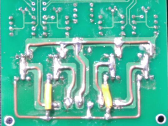

    Boy, what a FAIL !!!!!! MegaFAIL !!!! That dumb professional you have hired to make them, is really dumb!!! He should know that these track can't handle currents larger than 10 Amp !!!! And he used solder MASK over them???? This prevented the chance of beefing them later with lots of solder as I clearly suggest on my instructions!!!!!! :thbd:
    Maybe you should do this to fix it:
    (Just an example of how to place a thick wire replacing the tracks!!)
    Good luck !!! :gl:

    Do it as shown in Thanos' picture, that should be the easiest way.
    Bend the wires and solder it to the points, where the MOSFETs are already soldered. After bending tin the points of the wire where they were soldered afterwards. Use some flux (every acid-free no-clean-flux will work, ask in your electronic shop) that will make soldering a lot easier.
    Pay attention with the two (in Thanos' pic yellow) isolated wires, they must not touch any other line!
  18. tronicgr
    tronicgr
    This is just an example photo !!!! Its not the DSMhb1.2 board !!!!! Its a fix that a friend (Jim) used to fix his ocean's h-bridge (KT-xxxx , I really don't remember the model exactly)
    Anyway, I hope you get the idea...

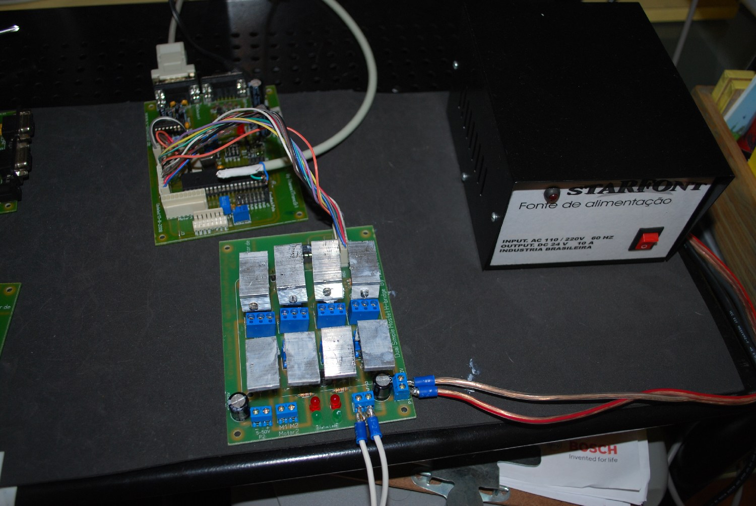

    One thing I would like to understand...I tested my board yesterday for longer periods and no problems...
    Right now...I removed all the mosfet from the Burned board and placed on the other board (the one which moved the motors only to one side) to do some testing..
    when I turned it on ..the motor moved to one side, then moved to the other side as supposed to.. but just after that it also burned the tracks.. F****.. this time the tracks for gnd and +5v are damaged...
    The Mosfets were ok from the burned board..Do you think the problem is only with the non reinforced lines??
    F*** 3 steps forward yesterday...and 2 steps back today... : :?
  20. tronicgr
    tronicgr
    All the power tracks need reinforcing before using them with the motors since most car wiper motors use 6ampere current just to rotate unloaded!!!!!! (and around 10Amp under load)
    So Beef up all the thick tracks you can see with think wire before doing any more testing. It will save you time from repairing things and save you some burned mosfets.
    I have blown a pair of mosfets on my DSMhb1.2 just once. This was during the Athens Digital Week show when I was giving interview to a TV station. They wanted to use one from their team (I thing the boom man) to sit on it and take a video with him driving it. But he was a little more heavier than he said and the position feedback sensor detached from the proper position resulting the motor axis pushed over the limits taking down 2 mosfets. Anyway. If you take the proper measures, the mosfets will handle very hard load conditions.
