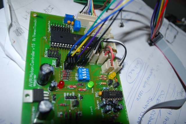

    Another thing I noticed on your boards, is that he used simple ceramic 22pF capacitors next to the crystal, while its preferred to use Ceramic Multi-Layer ones:
    http://uk.farnell.com/multicomp/2222-680-34229/capacitor-22pf-100v/dp/1138845
    The Multi-layer capacitors have a light mustard color and they are much smaller!!! They provide a more clean oscillation signal and they are preferred since Crystals depend on them to get start oscillating!
    Regards, Thanos

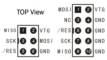

    My STK500 USB programmer just arrived,
    I think I am ok with the split cable, only the vcc connection I could not find on your ilustration..but I think it is ok

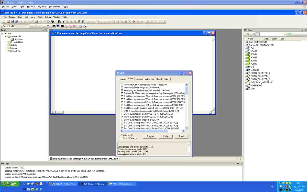

    I dont know if I am in the right track, but when I go to Auto Connect... AVR Studio it says:
    Setting Mode and Device Paramters...OK!
    Entering Programming Mode..OK!
    Reading Fuses . 0xD9, 0xE1, ..OK!
    Leaving Programming Mode.. OK!

    1. I tried then to set the fuses as in ponyprog and flash it in one of my boards, it gave me a wrong message and now I cant get into program mode anymore, it says:
    Entering Programming Mode...FAILED
    Maybe problem with the Crystal or I just did something wrong..maybe I set the wrong clock and locked my chip?? is that possible? (the other board is working fine)
    Update: I tried a different atmega and it worked again, I think it locked my atmega..right?
    2. Am I in the right track??
    3. Where do I get the latest firmware for the 18Mhz Crystal?
    4. I cant choose BOOTSZ1 and BOOTSZ0 at the same time on AVR Studio (only one at a time allowed). How do I set the right fuses on AVR studio to be able to upload the hex file?

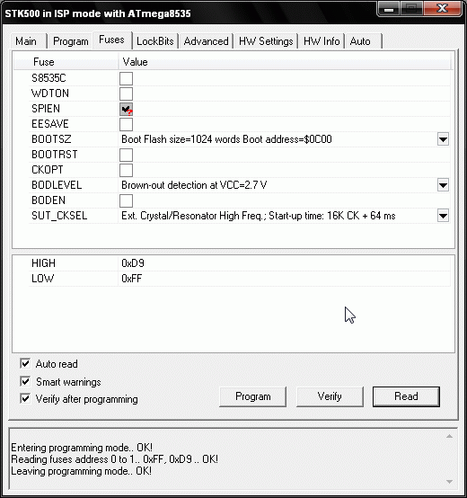

    I just need to know what are the correct fuses to set on AVR Studio that are compatible with the reference from Ponyprog...
    I been researching around but could not get the correct answer...perhaps someone here has already used AVR Studio with AMC programming..
    thanks in advance

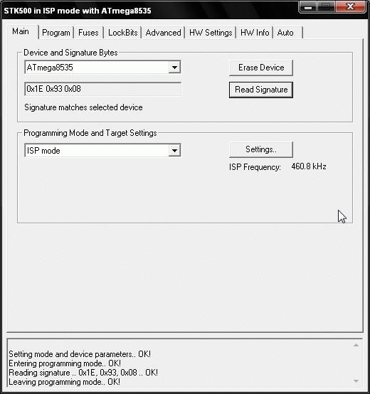

    These photos will help you set the correct device and fuses:
    A tip: You must have the AMC board powered with its own power source. Also you MUST connect the VCC pin from the AMC board to the VCC stk500 cable pin. This is used by the STK500 as voltage reference to be able to program it correctly regardless the operating voltage.
    Regards, Thanos

    vcc is the one after the 2 gnd pins, correct?
    I am searching for the correct vcc pin as I cant find on the diagram (or I am missing something)... how about the 3 jumpers? and the servo power jumper??

    Oups, sorry. on the STK500 this pin is named VTG (or Voltage Target):
    :cheers:
    You can use any PWM_AMC15_2DOF_V1_CRYSTALxx.HEX file you want. If the boards are ok it will power up and show some results on the LCD. You need the exact number to fit to your crystal to be able to make it communicate over serial connection with profiler.

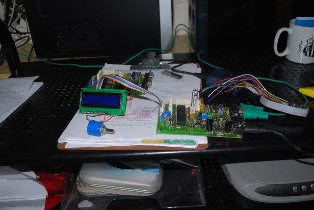

    thanks a lot man
    I went trhough the procedure, the red led flashed as indicated, AVR studio did the whole process and it was OK. The Dots on the LCD disappeared and there is nothing there anymore... the black dots were very light because of the blue backlight..but I could still see them..now I cant see anything on the LCD...
    could it be the blue backlight LCD..or something more serious?
    I am getting really frustrated with that :(
    I have a normal lcd (without blue light), and when I tried to move the lcd board to this one, I f*** it up...good I have another lcd board...but I am afraid to mess it up again moving to the green lcd...
    PS. When I try to open force sender...it says it cannot find a joystick :(
    let me know your thoughts...
    I will keep everyone updated
    regards
    Caue
  11. tronicgr
    tronicgr
    Can you find and post here a link to the datasheet of your LCDs? or their model and a photo... The blue backlight LCD needs contrast control potentiometer...
    Another thing you should do to be able to see messages on LCD is to turn on the first DIP switch!
    Regards, Thanos

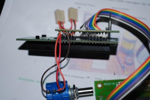

    Hi Thanos,

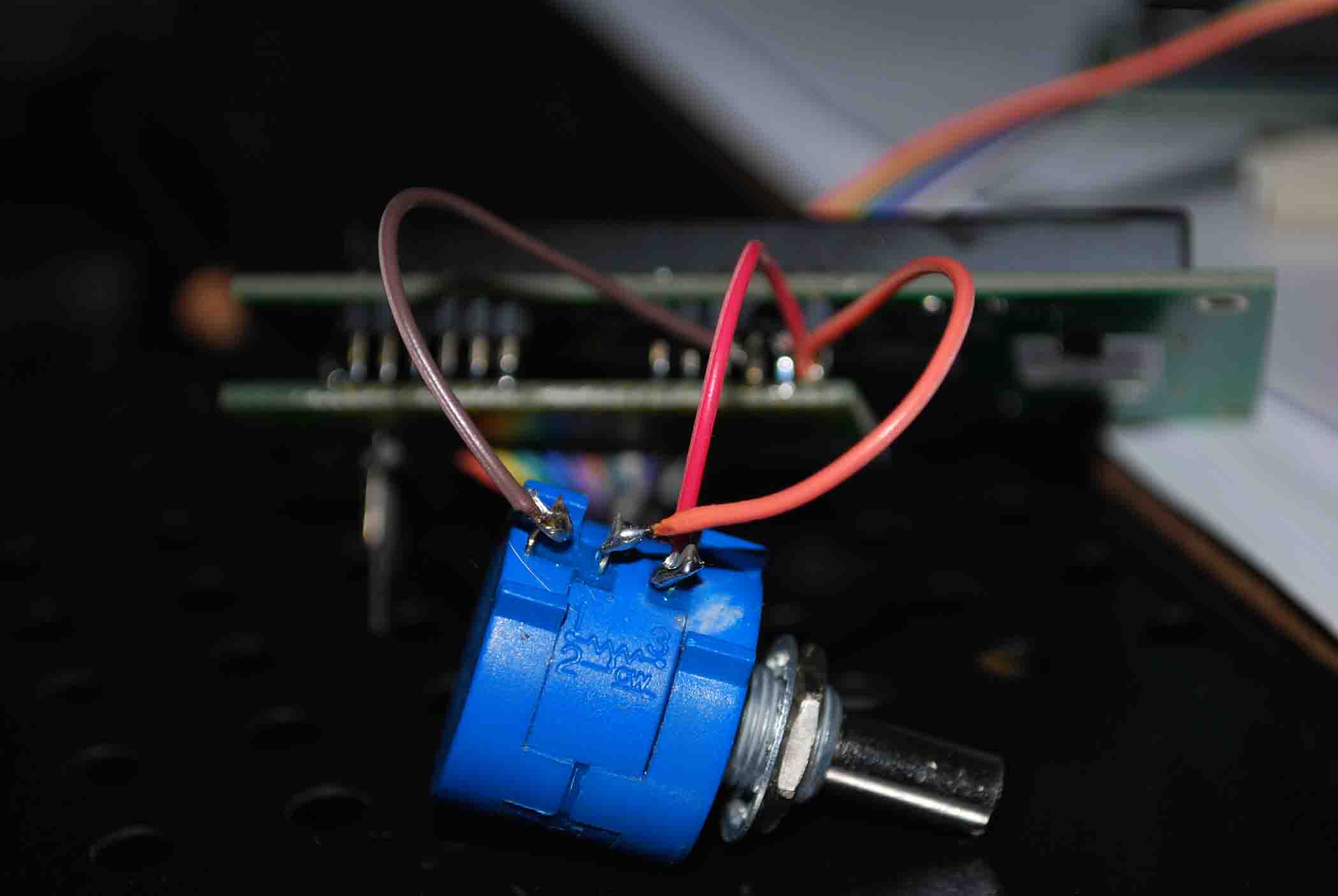

    I just built the potentiometer wires to control the contrast...it seems to work ok...when I turn to one side the whole board (LEDs) and LCD turns off..when I turn to the other side the LCD turns on (the black dots blink on the lcd) and the LEDS also turn on..but nothing is shown...as the pics below... The contrast went from 0 - max... nothing in between...something wrong with the wires..perhaps??
    PS. the wiper wire from my potentiomter is the left one...like in your video guide (blue baoter potentiometer )..i think...
    I will search for the LCD datasheet...

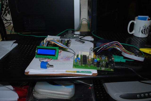

    some pics of my lcd and a video (sory for the low resolution but I only have my cell phone camera) of what is going on...
    http://www.youtube.com/watch?v=40GheOoiTpM
    is the problem on the
    1. LCD??
    2. AMC board?? or
    3. firmware was not installed correclty??
    4. Potentiometer connection...???
    sorry no good with symbols..what is what here ..perhaps the connction is wrong
    1www3
    2--|cw
    Update
    I also used a piece of wire to connect the middle pin of the jumper switch for the backlight with the input pin of the LM2940 that exists on the AMC1.5 board! as instructed and nothing changed
    :sos: :yippiee: :sos:

    3Coins
    i was not sure what were the correct wires from potentiometer to lcd, so I actually tried all the combinations :D ...some of them had the black stripe showing for more time than others...but all of them were blank after a few seconds...if it is showing the black dots normallyfor a few seconds (as it was not programmed)...it should show the firmware version clearly as well...right? perhaps problem with programming???
    ahhhhhhh I am going crazy here...

    the problem may be on the programming part...
    nothing on LCD..but the black blocks blink when the board is turned on...
    cant connect with hyperterminal...Force-Sender also cant find...
    any thoughts someone??

    one more thing, with the dip switch 2 ON, the black blocks are showing all the time on the lcd... dip switch 1 ON, the black blocks will blink for 2 seconds and goes blank
    The lcd is Winstar but I cant read its model..
    tomorrow I will try to build a new board for the green LCD (WinstarWH1602A)
    regards
