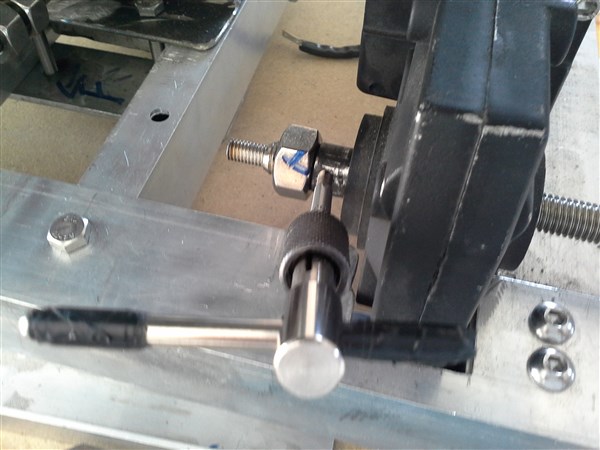

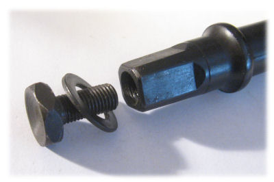

    The kind of keyway style fitting we're thinking of doing might be slightly different. The motors I have are hollow shaft so we're thinking about machining one single piece with a 6mm center sticking out one end to attach a flex couple to (for the pot) and on the other end possibly a square to press fit the lever onto (Interference fit). I'd like to hear from others who had the hollow shafted motors. Maybe the hollow part can be removed easily? I need to have a closer look.
    Something like this below, with or without the bolt on the end. Less welding, and less parts to connect maybe?

    Like others I have used threaded rod on hollow shaft motors, as seen in the same link...it is quick, easy and strong enough. A custom keyway shaft would be neat, if you have the equipment to do it.
    It is easy to split a hollow shaft gearbox to disassemble, they are just bolted together.

    Would there be any chance of the threaded bar and nut method slipping due to the fast movement?

    When I did mine I tapped through the hollow shaft and into the threaded rod and used a grub screw, in addition to the nuts either side, so there really is no chance of it slipping:

    "no chance" of slipping isn't 100% the case, Especially when your dealing with traction loss. This is what happens when the main bolt loosen's a hair and you start getting slop in the system but aren't clued into exactly whats going on and the end result is something like this. Set screws were "pinching" the Threaded rod with Flat spots i had made, Then had a Rather thin 4-40 bolt and nut.....Main Nut must have been a hair loose, Snapped the 4-40 bolt then it was riding on the set screw's which did all the damage. I remade the Threaded rod, Welded the Lever back on, Went with a 5-40 bolt this time and the same set screw's pinching the Threaded rod, No failures so far.

    That's always part of my worry when using threaded bar as in most cases it's not very hard.
    I have a friend with a lathe and a mill which is why I'm thinking the square end might be the answer.

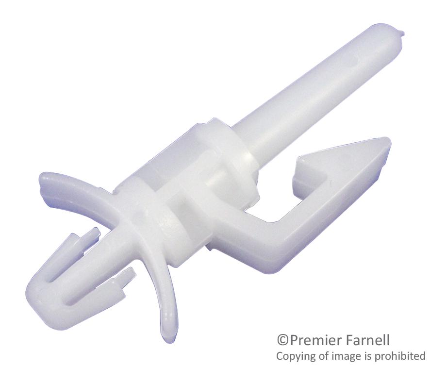

    My PCB edge holding clips have arrived from Farnell.

    That shaft slipping is my same issue. I think Im going to just either buy simexperience or new gear boxes with the key way. Im thoroughly frustrated with all of the little fixes that i have to do hear and there. 360 Hall sensors saved me from breaking pots at least. I tried dirlling the bolts and they just ended up shearing in half.

    I'll be speaking to my engineer friend tomorrow about getting the shafts made. He's been making parts for motors and hydraulic systems for 15 years so I have full confidence he'll come up with something solid that works.
    Threaded bar (even high tensile) will always be weaker than a solid bar through the middle. Then when you drill it, it halves the torsional strength at least. My idea is to make a shaft in one piece with a 6mm stud on one side for the flex coupler to fit, and a square or something similar on the other end. But ultimately the goal is to make the gearbox the weakest point.
