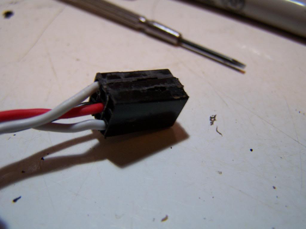

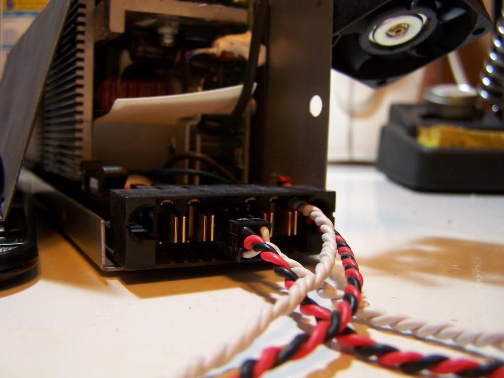

    Next up is to get the power supplies ready for action. They're HP server supplies - DPS-600PB
    So I just need to clarrify what I need to do with it.
    Can someone please tell me if this is correct.
    I connect pins 6, 8, and 10 together.
    Connect pin 4 to any GND connection.
    Put a 1K ohm betweeen pins 3 and 9
    Connect pin 8 to the GND connections and have the main GND wire coming from there.
    Connect the 2 larger +12V connection together and have the main 12V wire from here.
    My only other question is really about the wire size needed for these. Will I just use normal wire from a PC PSU?

    here is what i found for the psu i have the same

    Are these single pin interconnects good enough for bridging the pins on the power supplies?
  17. Nick Moxley
    17,057Coins
    +2,506 / 30 / -2
    Ya im sure those would work, Futaba RC radio/servo connector's can also be used. I just jumped the pins with a Very thin soldering tip (only suggested if your reasonably skilled with an iron.) ;)

    Cool. I used to solder chips so soldering wouldn't be a problem but I like the idea of having that plastic protection around the pin just in case it ever took a hit and bent them to short something out. I'll solder up the main Power and GND lines though. I think I have some spare cable from wiring up an amplifier in a car.

    easy and clean and here is where i found this mod

    Fantastic. That's just what I need.
