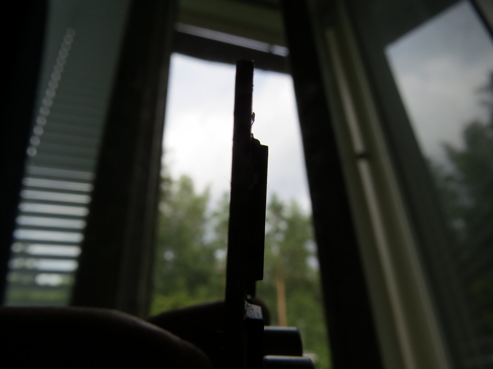

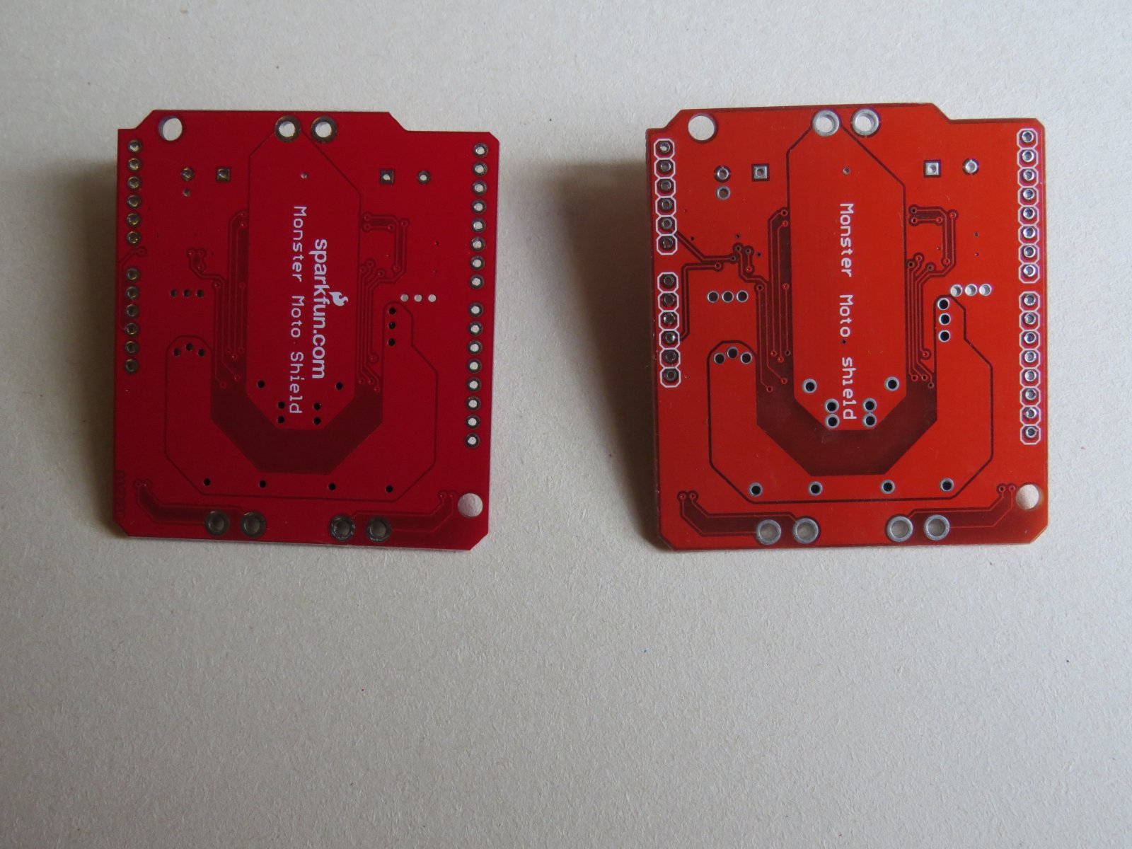

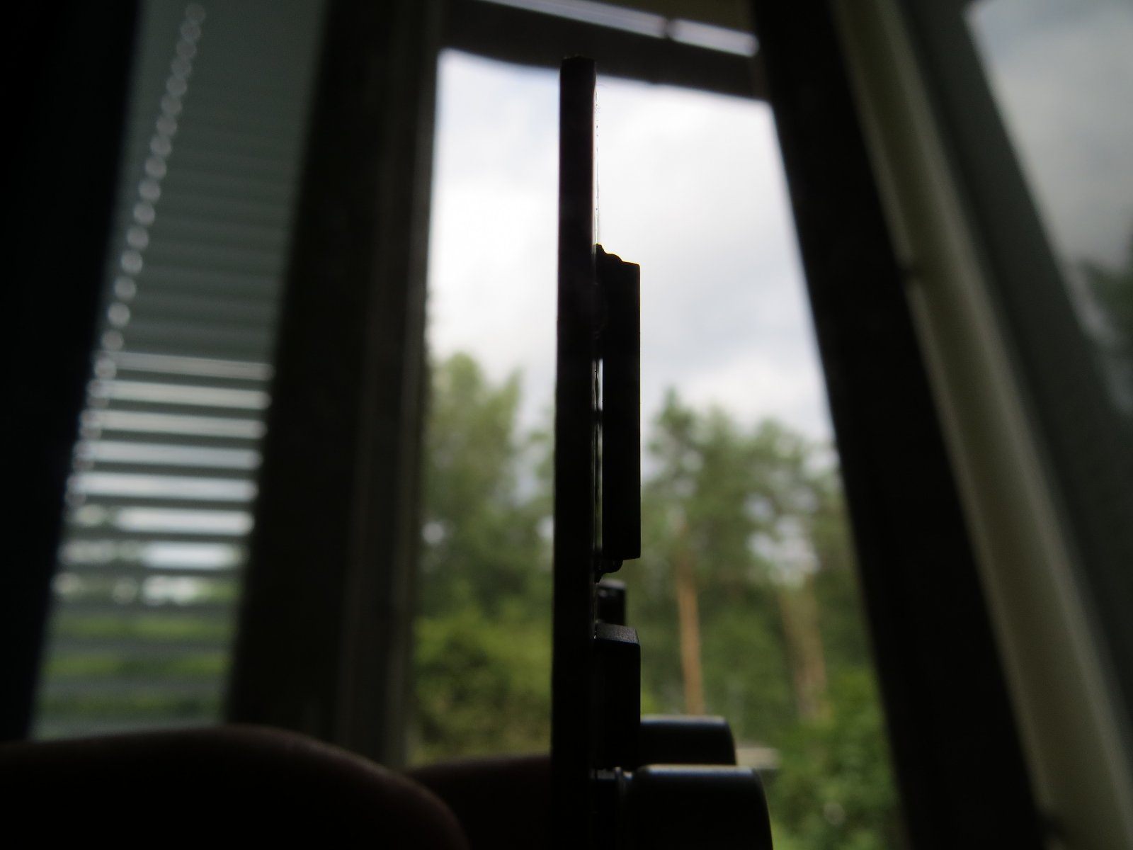

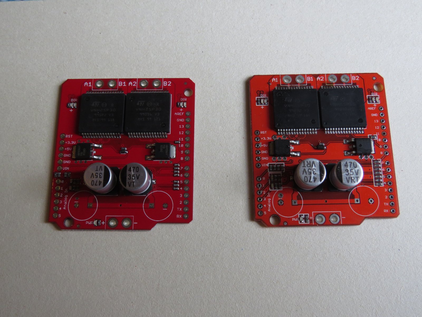

    Good to know. I just checked my new set what came yesterday and here they are:
    Clone has... suprise suprise (not) gap under the chips and guess what.. That wont work at all
    Copy versio was like it supposed to be. and work like it should be.
    Now i try to get money or another MM to this seller too
