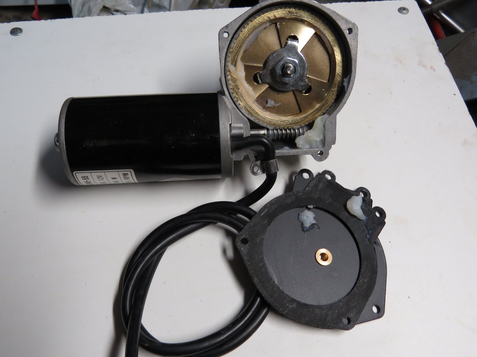

    Try the sim and find out why my motors go up and down a little weird. I haven't change sim setting bin to hex. Good there are enough pictures where I found the error. Now I find out that left motor has some problems and it stuck down if I put some load on chair. Maybe its broken or the mm has malfunction.
  2. mrbeginner
    mrbeginner Active Member Gold Contributor
    Apr 8, 2012
    153
    What ever come in my way
    Finland Niinisalo
    - 30Coins
    +55 / 2 / -0

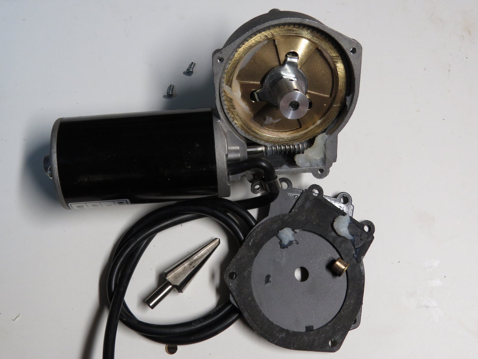

    Figured out what's the problem with my motor.. I check the resistance both of the motors and find out that left motor is about 100w and right 200w. Tomorrow i have to go local carpart shop to buy one motor more. Little more work to do but at least i didn't break nothing..

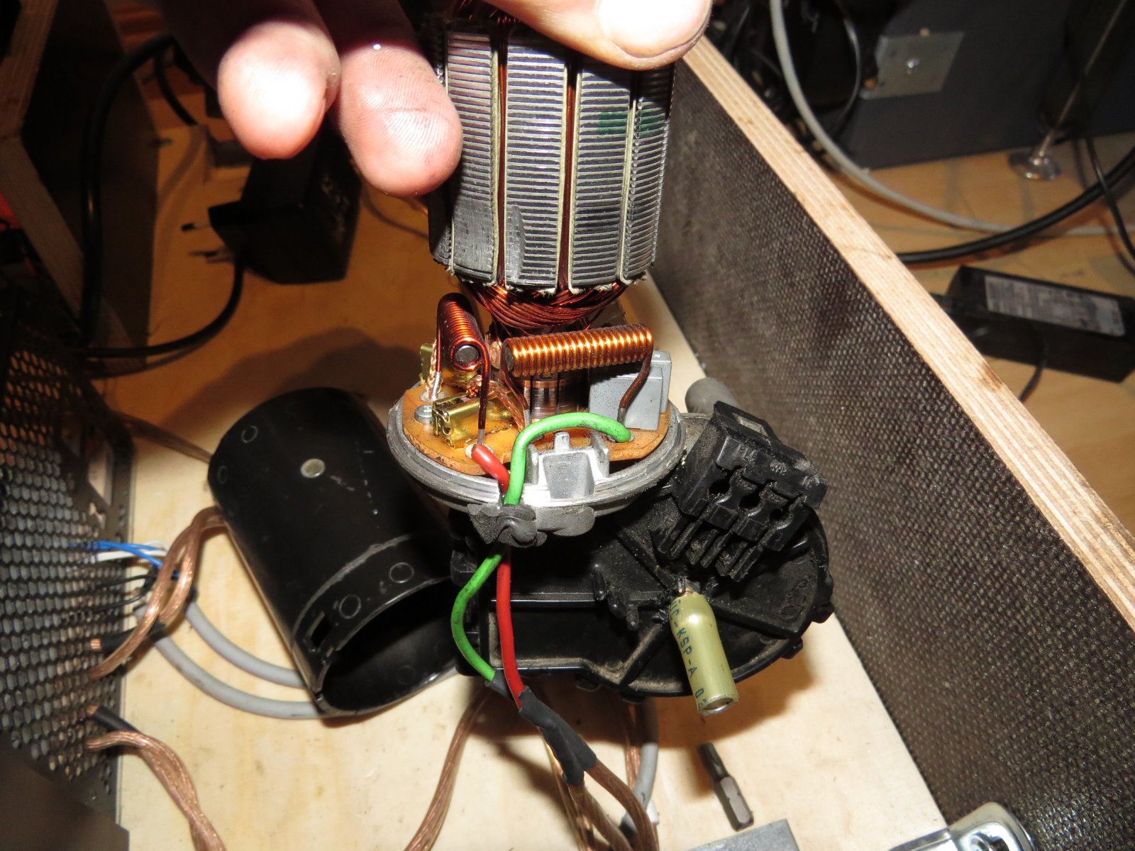

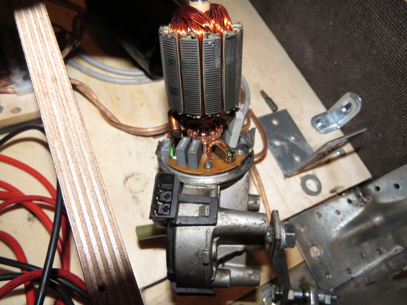

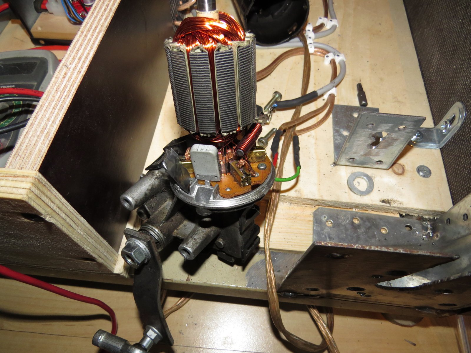

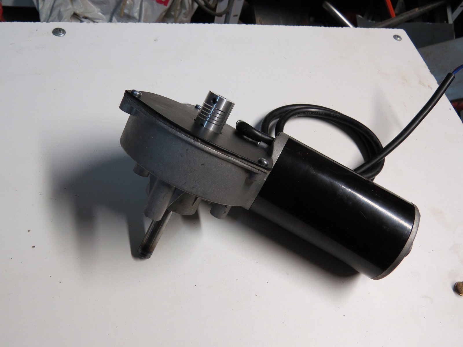

    Hi!
    Now i need some help if someone can tell me what the reason why my motors dont work. I buy 2 Ford transit wiper motors and customised them. But they work only one direction good. if i put them go counterclockwise they go slow few turns and after that motomonsters protection stop movement. If i turn potentiometer it's start to move again clockwise but if i turn it other direction it moves 2 rounds and stop. I tried to turn magnets but that don't help. Both of the motor work same way. If i change the polarity it don't change the problem so the motomonster isn't broken. IMG_6719.JPG IMG_6720.JPG IMG_6721.JPG

    @mrbeginner
    did you find the fast and low speed?
    did you ground isolate the motors before doing some tests with them attached to the rig?
    http://www.xsimulator.net/community/faq/wiper-motor-mandatory-ground-isolation.25/
    and i think you have done the above but wired wrong brushes.
    are you using MM without any cooling?
    if you have a multimeter get some measurements to see how many power your motor is drawing when working CW and CCW . Can do this test with motors connected directly to the power supply

    Thanks to you answer. I bypass all of capasitors an other and put wires directly to low speed and common brush and it start to work as good as it could. Nice to get some help when needed

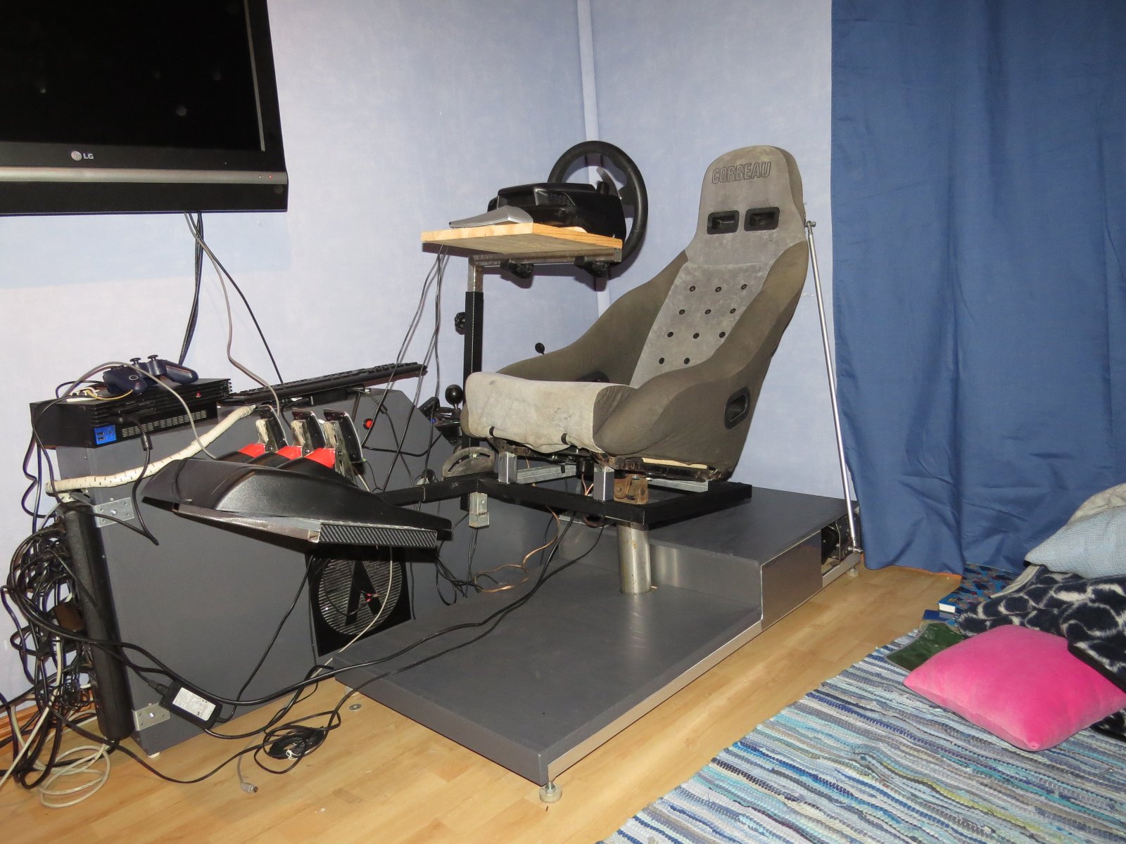

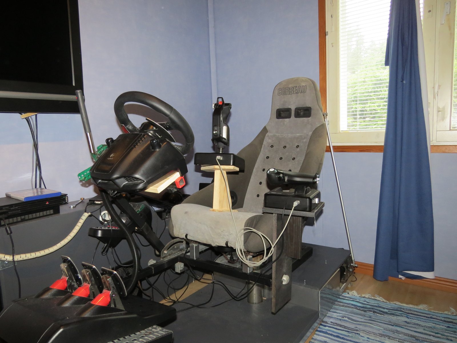

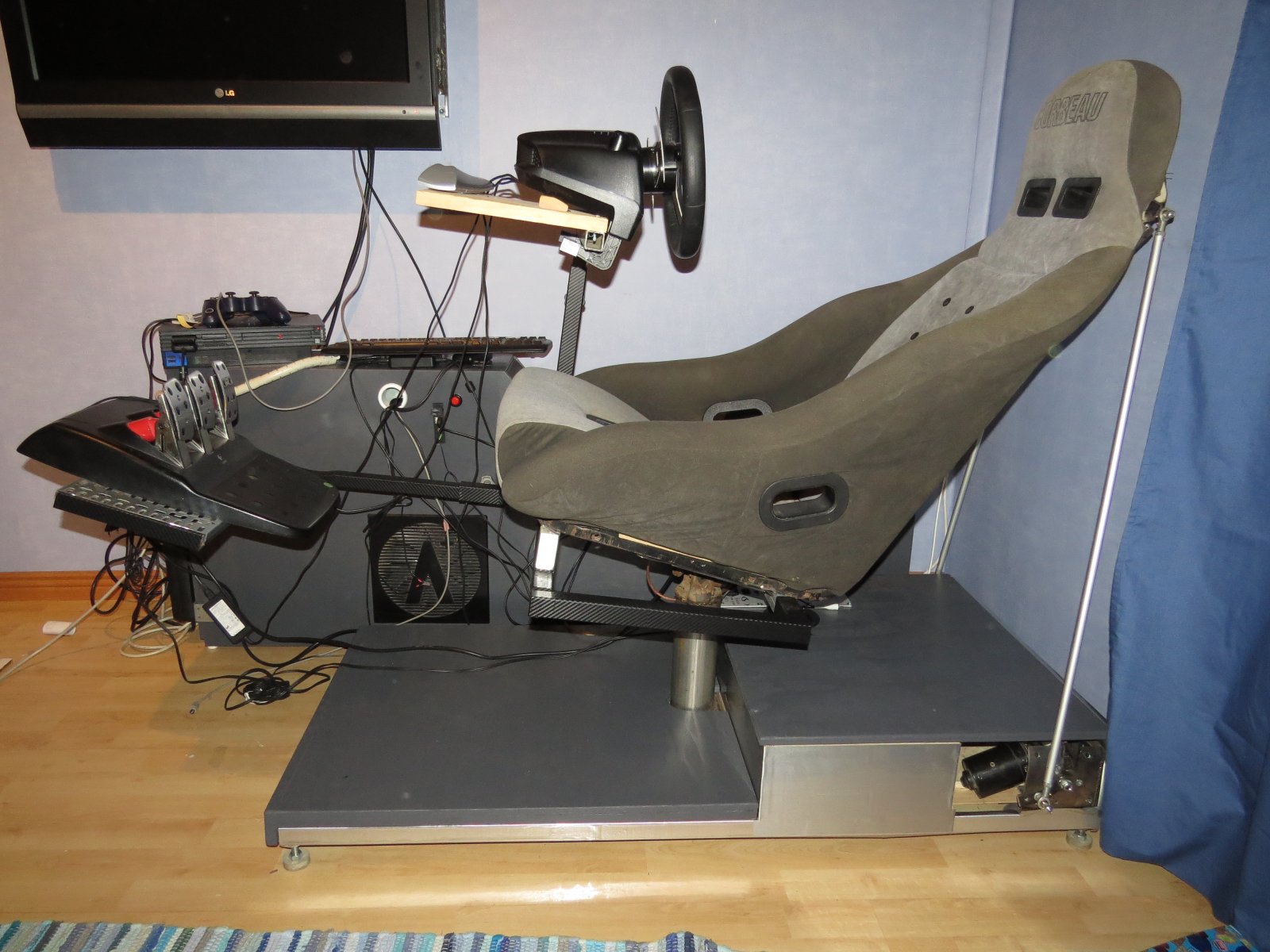

    Hi!
    Now the proto is almost done.
    Here's some pictures to proof it.
    Thank you for all who helped and give information when i don't find it myself.
    I have to say that after tweaking the rbr and ac few weeks i found that this is not so bad sim at all. the Foracer what i tested was too agressive and without the rift immersion was bad. So if someone want's to do sim this 2dof is good for practise and after that maybe a littla harder version..
    I use carbon fibre and aluminium lookalike tape and grey paint to make sim look "stylish". IMG_6731.JPG

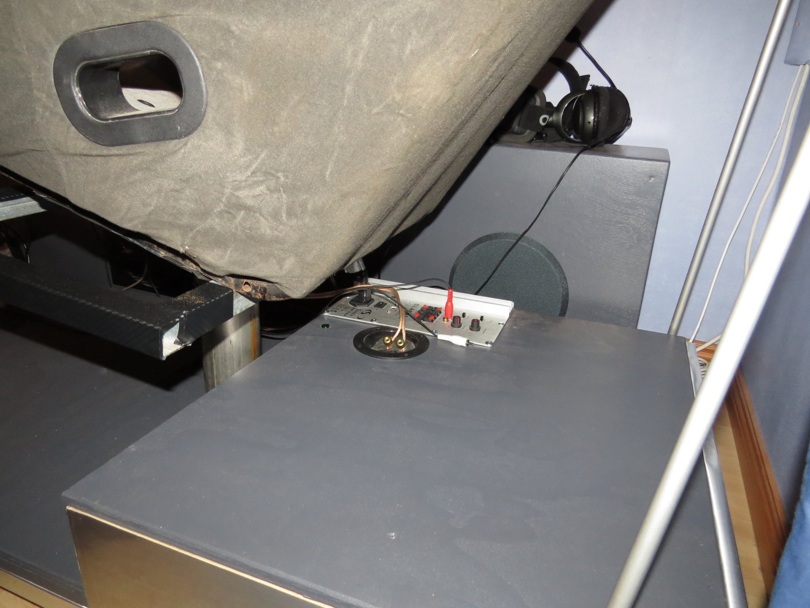

    I put my simex woofer amplifier in box and put power supply cord under the same power switch with amp. So when i put amplifier on the power supply starts too. I have emergency switch on a cord where i put the 12v on. IMG_6732.JPG
    I Know my motor is now wrong way, but i found that they go different speed counter clockwise so i try if it work's like this and it's ok for now. Next thing is to order better motors. Before that i make wheel table better looking and right angle. IMG_6733.JPG

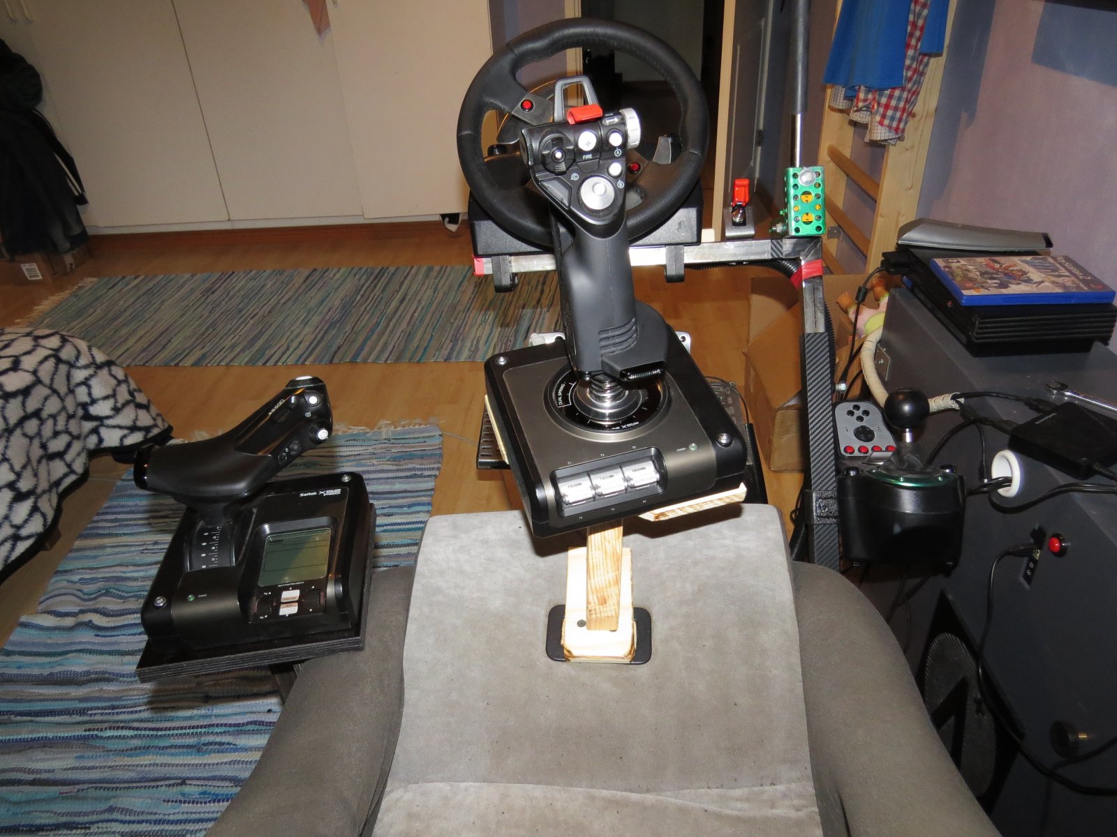

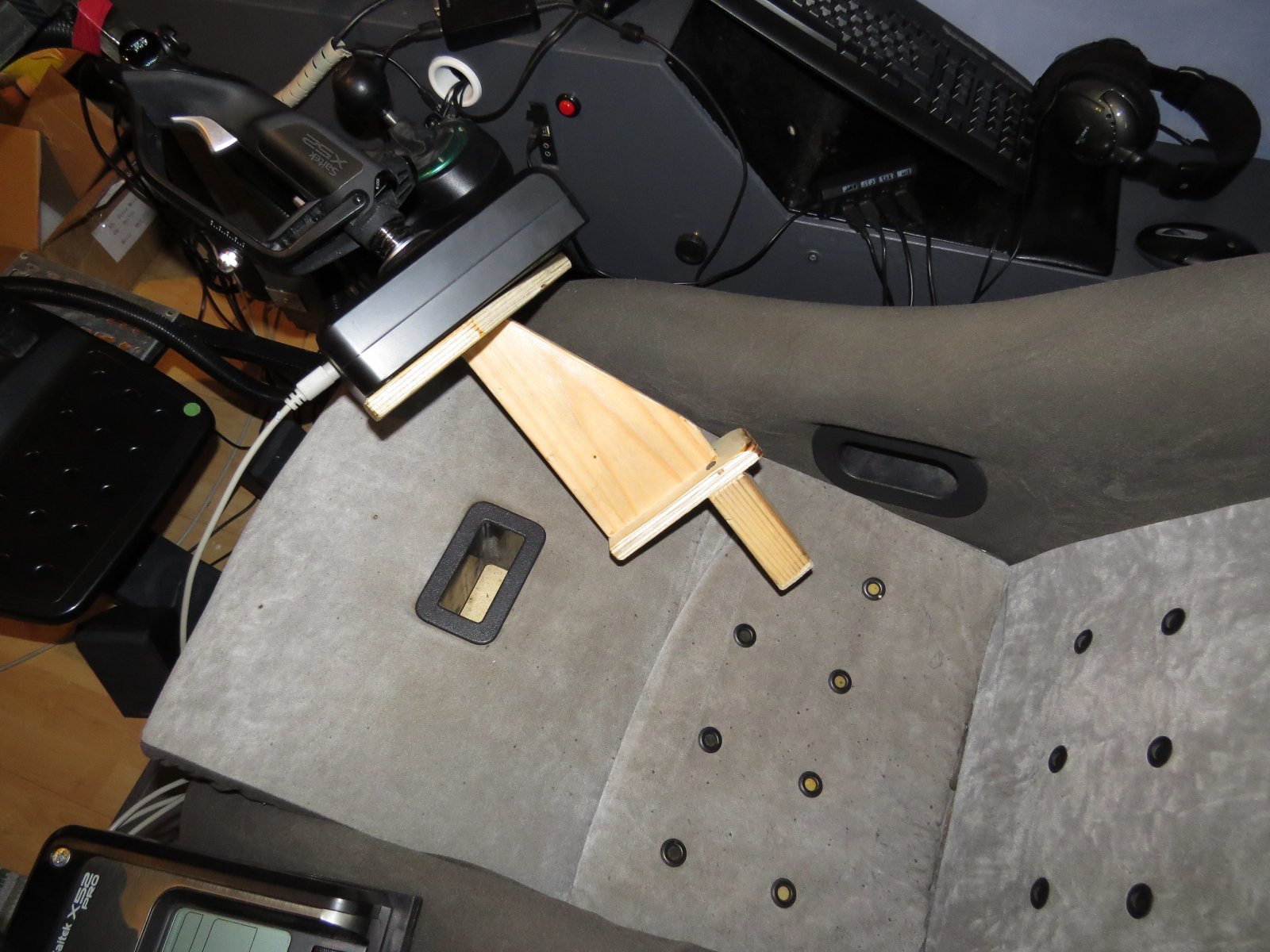

    Little update to the sim. I made holder for my Saitek X52 and now i just wait the war thunder to be stable and works with oculus without errors...
    Is there other flight sim what works with oculus and simtools?
    It's just plug and play for the joystick and rudder is in a place with m8 screw for easy installation
    Right you can see my green handbrake and that red hat switch is power supply on/off switch.

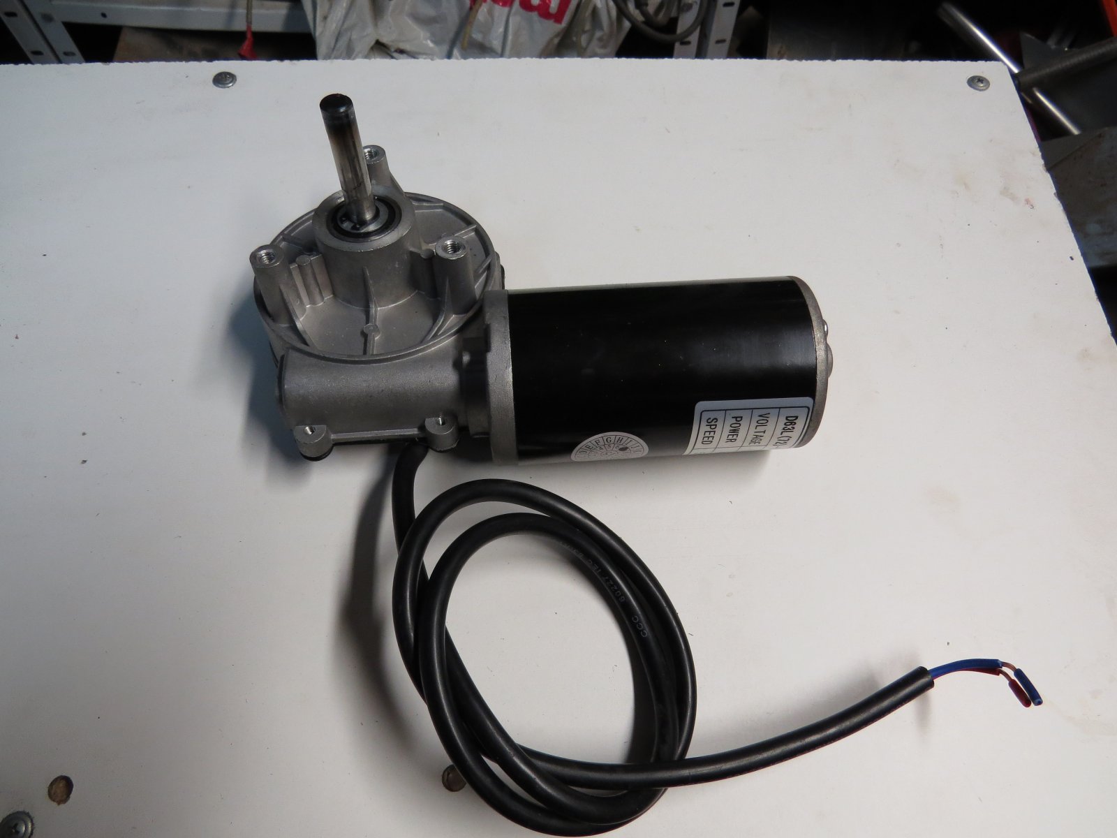

    F.. me sideways. I was thinking my moto monster was broken and it was. Both sides work one way but another way there is some problem. I change the Moto and now the right motor work good but left only one way. So now i have to order several more for just to make sure i get one perfect.

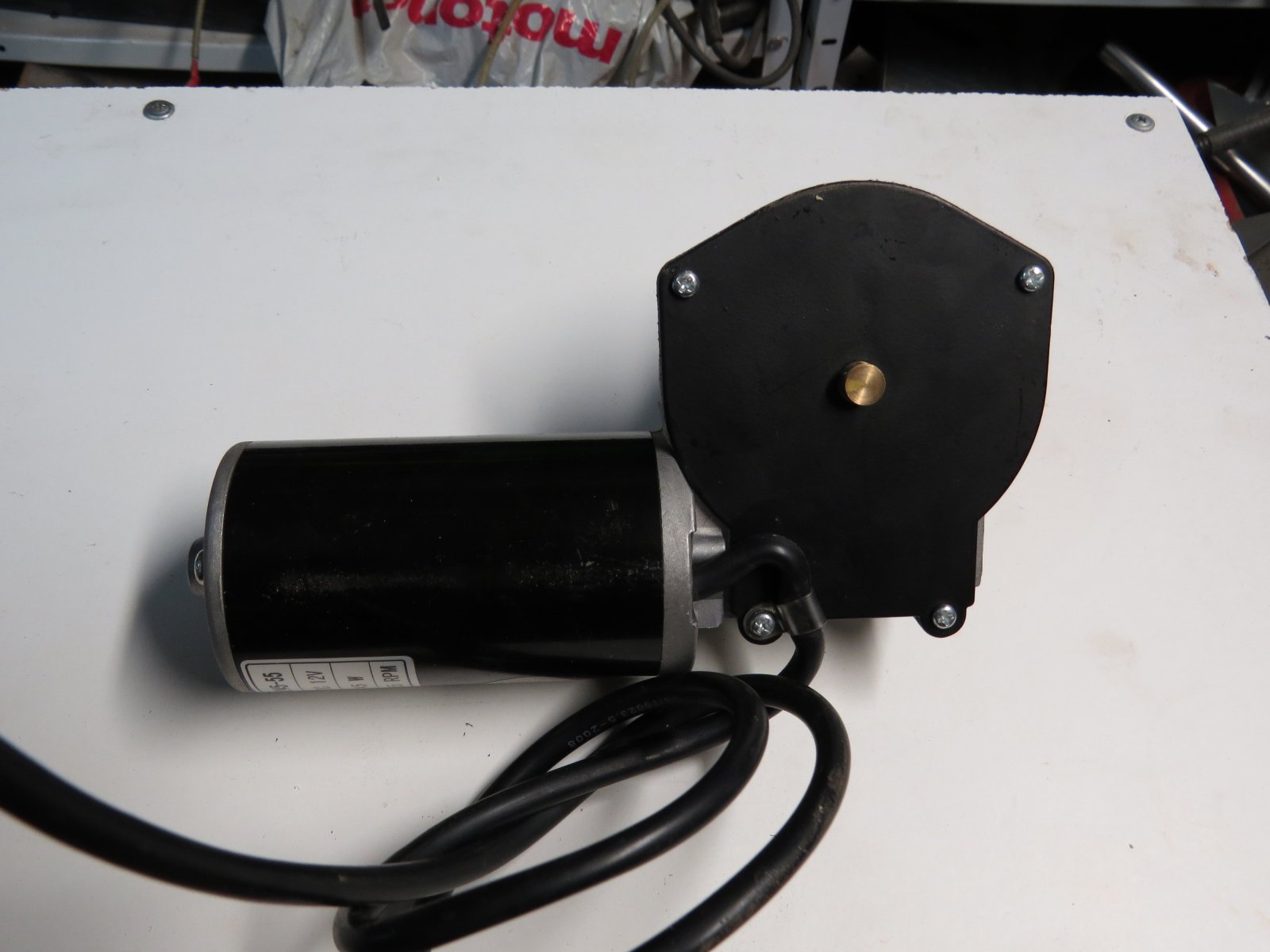

    I check and the output is 12v left and right but when direction change the second is 5.6v so theres your problem.
  19. mrbeginner
    Apr 8, 2012
    153
    Finland Niinisalo
    - 30Coins
    +55 / 2 / -0
    Now i measure those new motors and result was 12v 0,8ohm gives 15A = 180W. No load start take about 7A peak and no load running takes 2A continuous. Next week i try measure torque / current.
