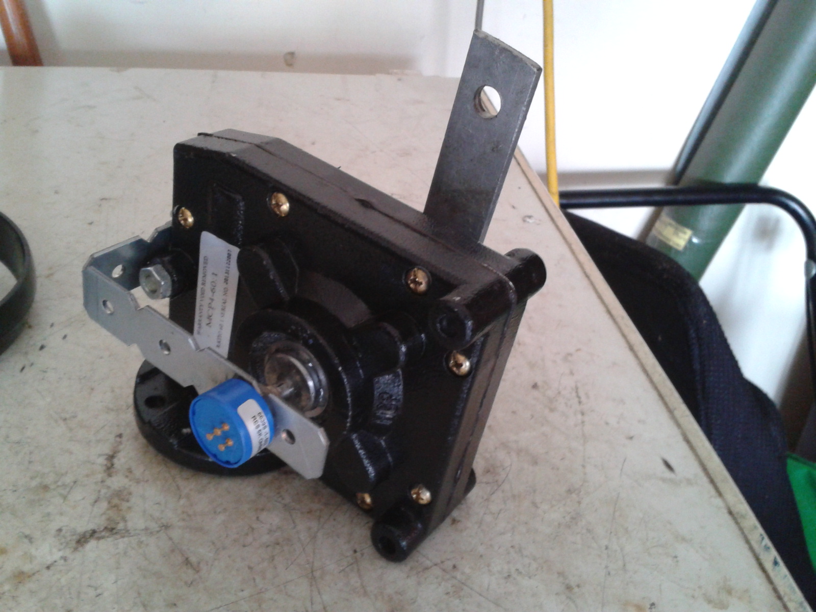

    Yep for sure Rob and or I can help you get setup with Simtools and jrks.
    Maybe you could put pots on the back like these single turn 360 deg pots

    Hi Bsft,
    yes.. still whipermotors , if i crash them i try some other motors - maybe winchmotors.
    For the pots i need some gearing/ transmission cause they are not 360 deg ones...
    Can i try something like this ? :

    @Mario Reinecke yes that will work just as well.
    Let me know where you need help.
    Jrks run fine with SimTools.

    Does it need special dimensions ( length of the arm or something ), or do i need to calibrate the pots later by JRK's software ? I dunno if the pots needed a special workingrange or not ?
  7. bsft
    you could always get the big motors from motion dynamics in Australia, just let me know if you do , I can pick them up and send them private post so you do not cop taxes and crap.
    The pots just get set like normal in JRK utility like you did before.
  8. bsft
    ive done that heaps of times before, its a good idea to use cheap pots so if the motor overshoots it doesnt break the pot

    Ok @Mario Reinecke , the length of arm is relevent to the amount of movement you will require for a seat mover style I would not got past 100mm of movement, meaning that the max position and the min position has a 100mm of travel between them.
    50mm up from horiziontal and 50mm down. This all is set in the Feedback tab of the Jrks.
    For the amount of range on the pot I would recommend as much as the 270 deg most cheap pots have so I would mount a motor and temporarily mount pot with lever as per video and experiment with the length so that about 100mm of movement equals near to the max of the pot, the more of the angle of the pot you use the better the resolution of movement (motion) will be achieved.
    The setup shown in the video is a good base to start from take a guess and have a play with one motor mounted and a pot, get use to setting up and using the Jrk Software to tune the PID and Feedback for the motor, once this is good you are ready to move on to SimTools.
