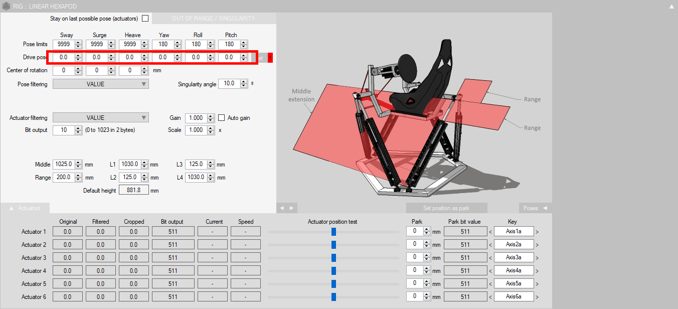

    Is there any way to make offset by software to where my center point is on the individual axis. I have enough travel on the actuators and want to be able to change may seat position from standard racing position to F1 position using only actuators. The entire rig is designed so this is possible.
    Any help is appreciated! :)

    You could try Mover.
    Added that feature, but in precdefined rigs for now.

    It's a motion software I made.
    Look here: https://www.xsimulator.net/community/threads/flypt-mover.13464/
    Depending on your rig, you can set what I call the drive pose (red rectangle)
    This defines the default rig position, so you can tilt, translate that position and all movements are made around that pose.
    Bellow is an image for an hexapod rig, but there's others included.

    ... It's a stand alone software that connects directly to games, but it can connect to Simtools also and use data from Simtools.
    Take a look at the link I posted
