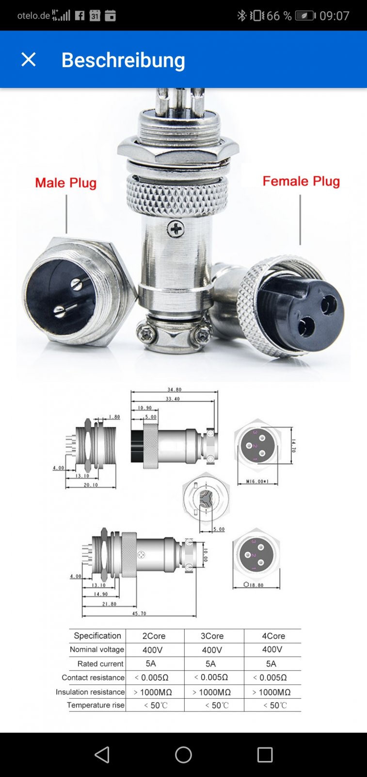

    I want to keep my new electronics box as tidy as possible and wanted to connect my motors and the psu to the housing externally via these aviation plugs:
    These are an example, I found some that are rated for 220V 15A/20A as per description.
    I was wondering if they could become a bottleneck for my sabertooths power supply?
    As the sabertooth should draw 16A on load for two motors.
    Is it even a good idea to "interrupt" the direct route from psu to sabertooths and sabertooths to motors?
    Are there alternatives to the plugs I currently have?

    I use 'Anderson' plugs. Reasonable cost and designed to carry high DC currents.

    Thank you for pointing me to them.
    I found some that already include mounting brackets in the right size for my existing holes from the aviation plug holes! :)

    I use aviation plugs and havn't have any problems,,,, i'm using monster moto's
