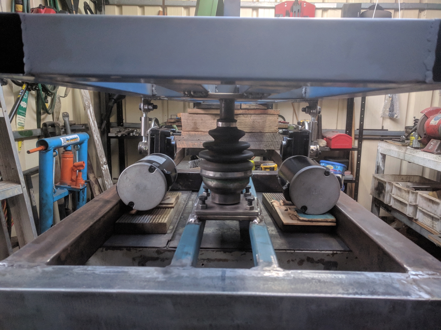

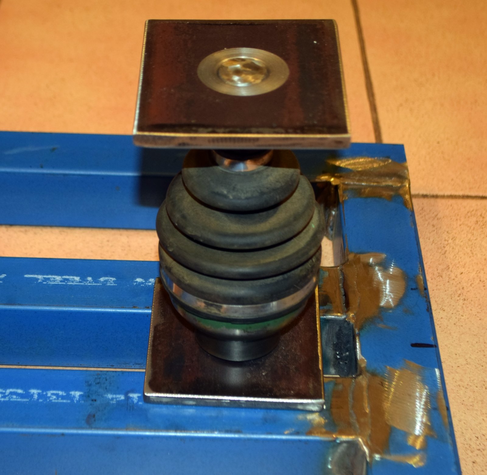

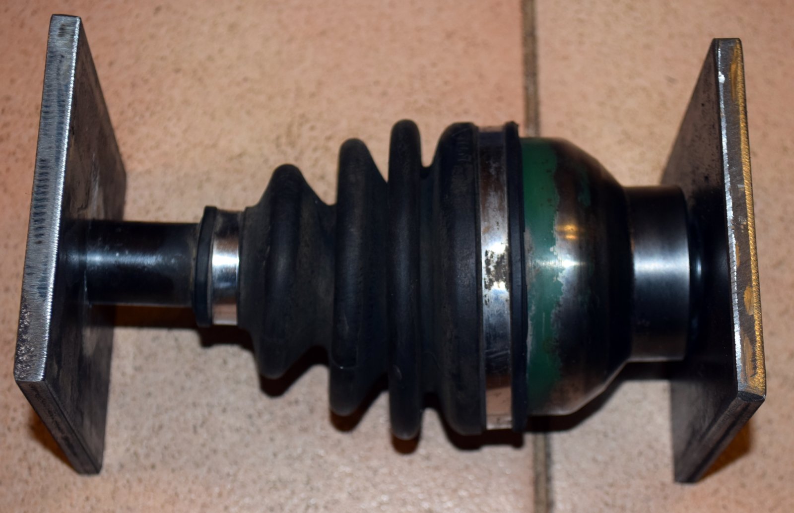

    Why not use a FWD CV Joint from any wreckers.
    Just lop one end off and weld on some mounting plates like I did on my 2Dof build I am doing.
    Cost = SFA , just stuff lying around the shed

    A car CV joints is better by design over a plain old universal yoke joint as the CV joint is meant to move in a planes due to suspension movement and steering inputs.
    And the fact that I had an old set of Subaru WRX CV's lying around was even better as they were $000 cost.
    Your local wreckers will probably give an old bent one for SFA.

    Making the mountings flanges are not hard if you have a decent drill and angle grinder with 1mm. cut off discs for cutting the plates and the shafts to suit
    and a welder of course.
    Having a lathe and mill also makes life a bit easier for boring the holes in the plates.
    I only had a max drill size of 20mm. so I used the lathe and a 4 jaw chuck to bore the holes in the plates out to the correct size which was about 25mm. maybe a bit more.

    Cool, Morphett Vale is only about 60 km each way, you get used to every trip being about a 100+ kms.
    The frame is the easy part, it just depends on what you want, fancy ally extrusion that just bolts together but expensive or a steel RHS tube welded frame like I did.
    The base of my frame is re- purposed stuff that I had lying around and the motion platform is new 50X 50 RHS. Simple but strong and moderate cost.
    I have plenty of time being retired and this is my new project to keep me entertained. https://www.xsimulator.net/community/threads/diy-2dof-budget-build.12377/#post-162521
