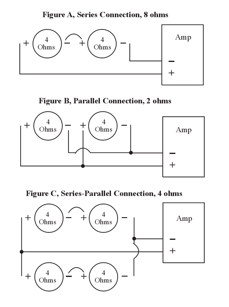

    Have ordered aura shaker for new upcoming rig, and the main question is will it work with buttkicker gamer 2 amp? Amp has 90W 2 ohm with 10-300hz and aura has 50W & 4 ohm - seems quite nice combo (at first I was thinking about brand new amp, but then I remembered that gamer 2 amp would be excellent for this purpose), but what concerned me more, is how I'll connect them with each other? will rca do the trick or it wil be diy? Gamer 2 shaker uses quite uniqe connection with the amp, but I guess there is any standart for this connection? Has anybody had experience with such connectors?

    this is the amp i use to power my auras. 1 aura per amp I have 2, that leaves you 4 channels open @ 45w for speakers also
    maybe you can compare the specs. 68 watts is enough,your amp is 300w you could run 4 of them, not sure about the ohms. my amp goes from 2 to 8 or something, it has a range, yours may as well refer to manufacturer specs.

    thanks for the reply! yeah i guess according to aura schematic i could attach 4 auras. But which one cable i should connect them? Just by simple wire?

    yes I use left over garage door opener button wire. 22awg solid

    Kickers are 8ohm so two will need to be connected in parallel to bring it down to 4ohms for the amp, so end system will consist of 8 kickers and one amp.
