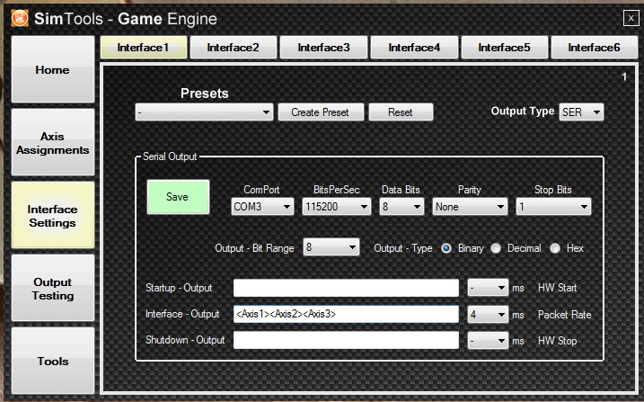

    Now I am trying to connect things and I am sorry I seem lost on your board but I did not know whether it was hardware or software. Now with the gent above you I got Virtual Connected to Live for Speed with the perimeters in the thread he posted now my goal is to get il2 Cliff of Dover Free Hunt .cs file to also get connected. Now I am not sure where to go next and if I need to post that under il2 Cliffs of dover so I can see under Com3 port like in LFS it shows the three axis point I need to work. Sent some private PMs to a guy who has it running and maybe I can get him to work out the script issue. Hang in their with me I am not a programmer. NOORBEAST Thank you very much for your Help Sir LFS is working.

    Il2 has nothing to do with your issue at this point. Posting in that thread obscures the issue.
  3. Historiker
    2,163
    9,212Coins
    +2,181 / 19 / -1
    Could you post your interface settings here? A screen shot would be best. You should not need to make any com port changes to your interface if you have it working in LFS. Are you getting telemetry out of LFS?
    Language barrier might be causing troubles for us as well. :)

    YES Cliffs of Dover is my issue at this point since I got LFS to work in Virtual Axis. When I try Cliffs with the proper script applied I should at least see the Virtual Axis working like in LFS.

    I agree that there might be an issue wit the plugin patching, etc. But you keep mentioning interface settings which are not specific to the game played. ;)

    Ok now that makes sence. I will reload LFS settings. and here is what I have.:

    After a long discussion on teamspeak we have Harry's issues worked out. :thumbs

    Actually the .cs script has to be in the corresponding mission folder: Example in Single player if you create a mission or want to fly all the Team Fusion Missions or even the Campaign missions-

    This text needs to be their other wise it will not work. After I added this to the Free Hunt Mission under single player everything worked great.

    Not unzipping the plugin before dragging it into the updater helped more. But good luck in your future endeavours.
