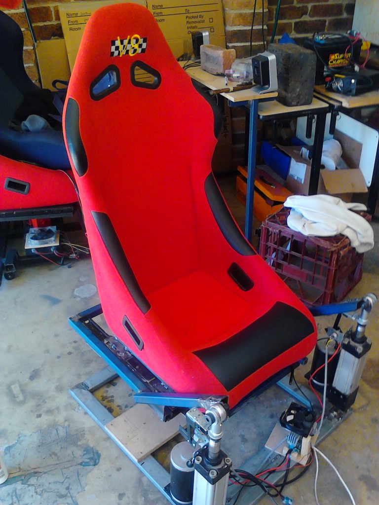

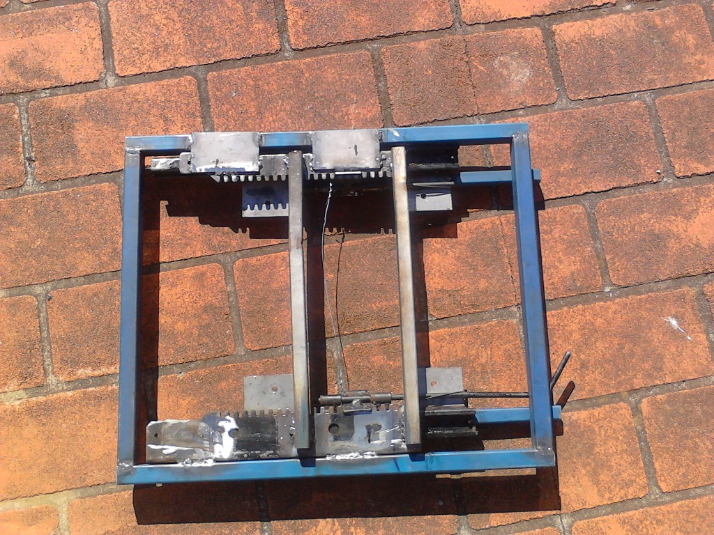

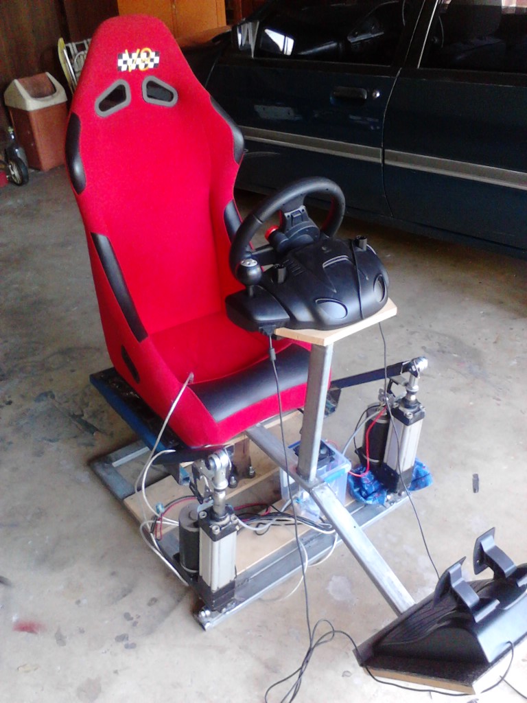

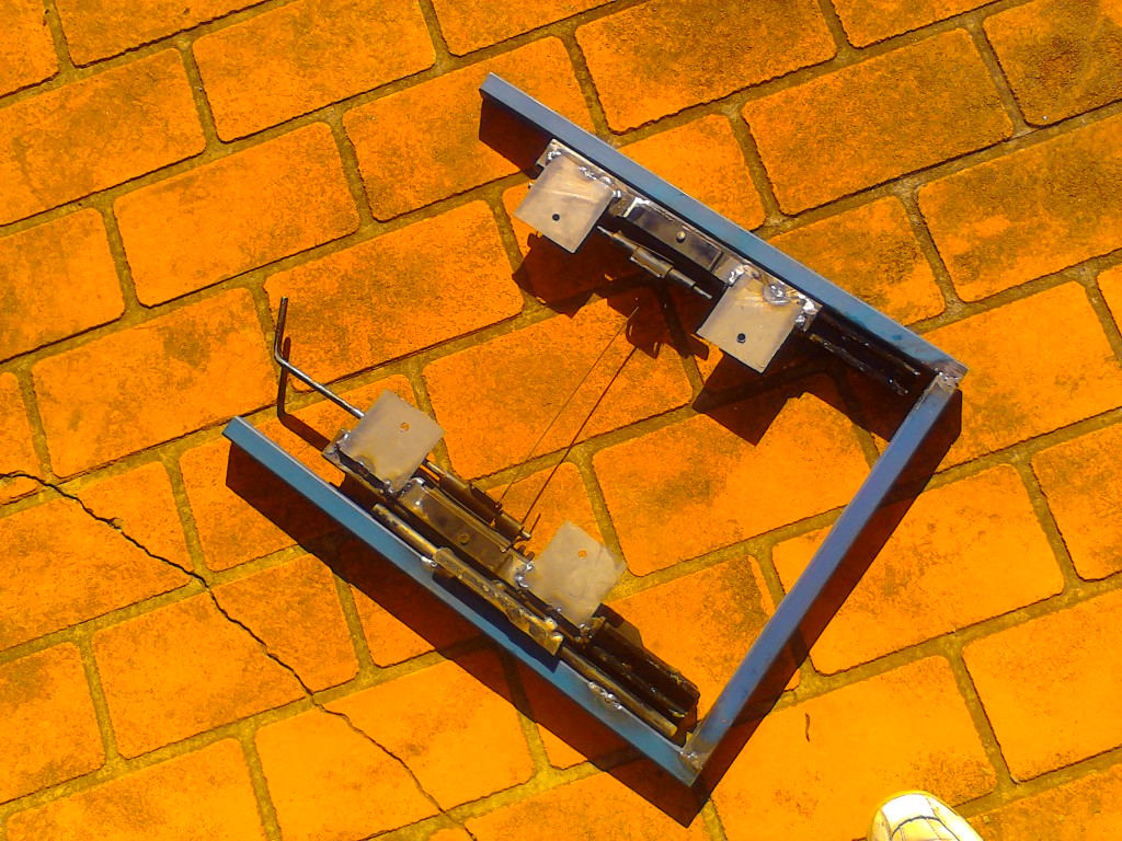

    I think the weigh compensation is simply a sliding table allowing the seat/frame to move back and forth, but the actuators and pivot stay still.
    I did this ages ago on a sim using seat rails
    In this case, I used it for balance between seat mover and full frame add on, however, it would work the same for adjusting for a heavier to lighter driver
    actuator sim 2 (1).jpg seat mover position
    actuator sim 2 (2).jpg full frame add on position
    You can see in the photos where its been moved back.

    You are correct. You can move the seat fore and aft over the pivot point and actuators to compensate for weight. The A2 has a separate adjustment for seat tilt. Yours is very similar to the A2. Nice job!
