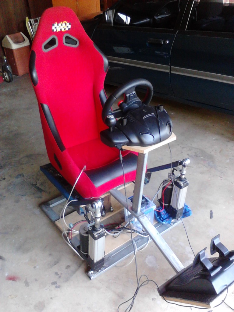

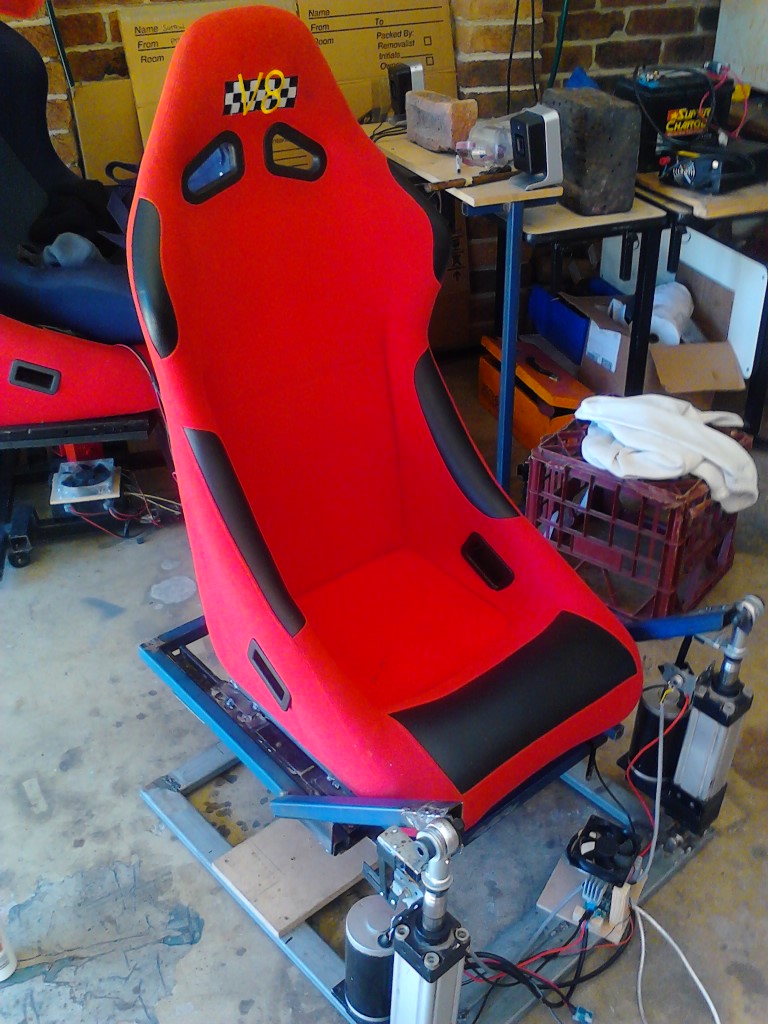

    I think it may be referring to the adjustment of weight balance. Which is possible. I did this test ages ago with a seat rails.
    The motors/actuators-pivot were connected to a frame. Then sitting on that was seat rails and another frame holding the seat and a bolt in arrangement for the pedals. The adjustment was moving the seat rails back or forth to suit the weight of the driver.
    Its worked well considering it was a trial. I used the idea more for a seat mover (rails forward) and full frame addition (rails back) . So I had the better of the two sim designs.

    Heres photos of the previous mentioned simulator.
    You can see in the photos the difference in placement of the seat- wheel pedal frame
    actuator sim 2 (1).jpg seat rails forward
    actuator sim 2 (2).jpg seat rails back

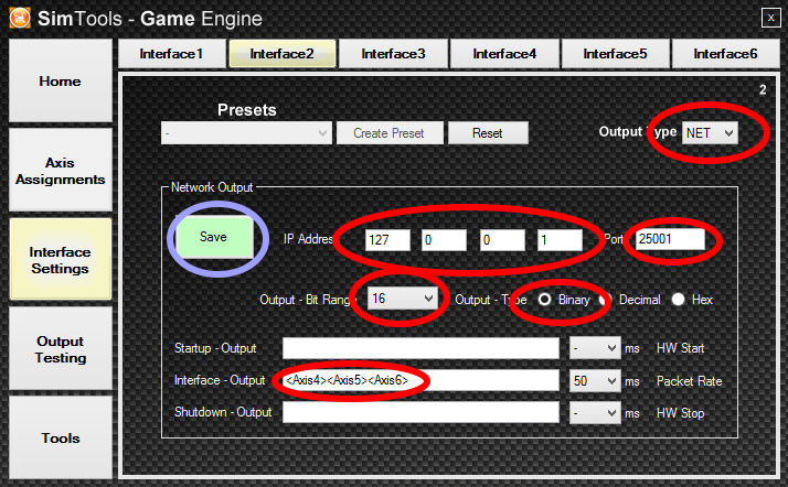

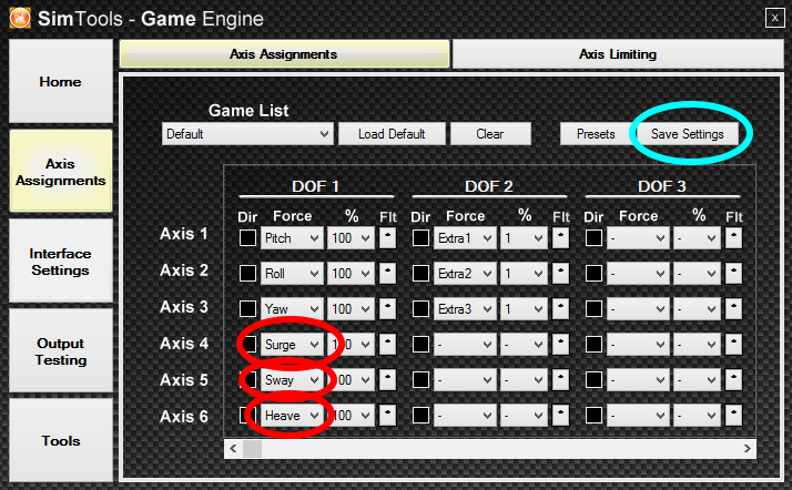

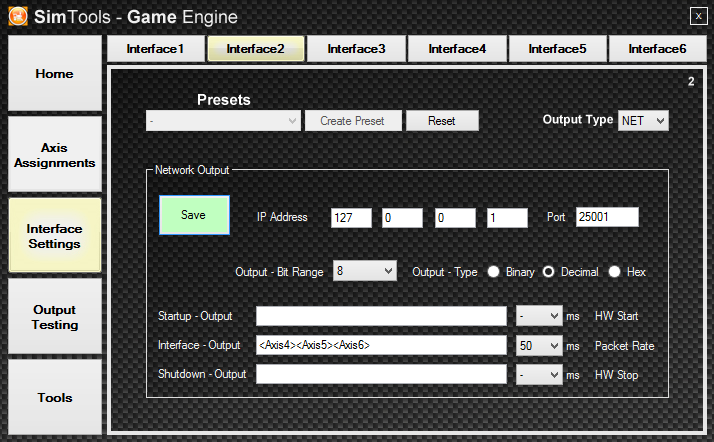

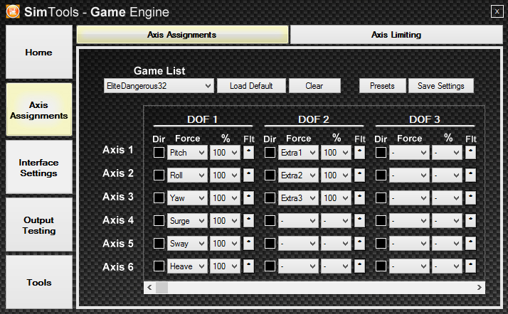

    @ohno, @jonmho, @rodoger: Having no Atomic I'm flying in the dark with the plugin. It might work – or not ;)
    Unpack simphynity_2_0_game_plugin.dll and copy it to your SimTools directory (e.g. C:\Program Files (x86)\SimTools)
    Set the axis and interface like in the examples below:
    Let me know if there is any reaction.

    Sorry, but you *must* select "binary" rather than "decimal" in the interface settings! I'll fix the picture later.

    @ohno, @jonmho, @rodoger: Next approach. This time I did some more debugging and my level of confidence is higher :) Still: It might work – or not ;)
    Unpack SimTools_GameEngine.dll.
    The DLL must be placed in the 'gameplugins' subdirectory of the main SIMPHYNITY installation directory.
    Please make sure you have the following settings in your SimTools axis and interface
    If you see no reaction please rename
    SimTools_GameEngine.dll to GameEngine.dll and SimTools_GameEngine.exe (in the SimTools directory) to GameEngine.exe
    The plugin will only include surge, sway and heave at the moment.
    Thank you for feedback!
