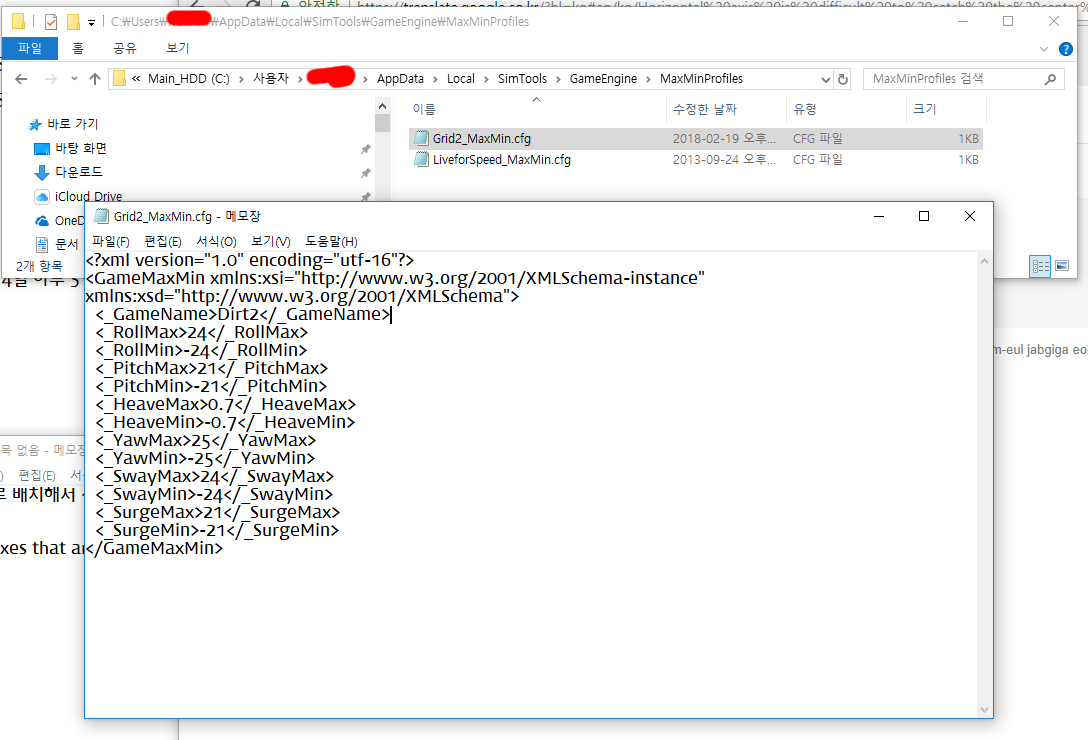

    C:\Users\<user>\AppData\Local\SimTools\GameEngine\MaxMinProfiles
    Have you checked the files in that folder?
    Sometimes I get a .net error when I change to an empty file.
    I check these files when I get a .net error.

    First, copy the other file and change its name.
    Open the file and modify '<_GameName> name </ _ GameName>' part.
    Normally, you just type in the file name.

    OK, a little confusing, would it be too much trouble to shoot me a screenshot of what you mean? Cheers mate, AussieStig

    Do you want this screen?
    If you run simtools from a Windows startup program without using the launcher, you may get the same error.

    Ta mate, I always start SimTools from the desktop icons. Thank you for the screenshot as well, so the image is of the content of the min/max folder in that location. I will check that out. Cheers mate, AussieStig

    Big shout out to YoBuddy, we have finally rectified the issue with my Game Engine quitting while loading a circuit in AC.
    It turns out that there were two files I needed to delete from Game Profiles and Game Engine which once done were re-built by SimTools.
    I started Game Engine and manager and behold, the ProSimu made some noise in place of the Windows Error Game Engine has stopped working.
    Very grateful to everyone that chipped in and tried to help. Cheers AussieStig.
