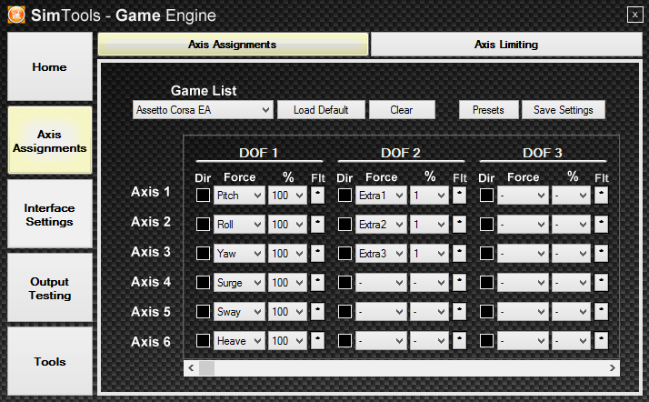

    How do your axis assignments look?

    thanks for your speed but i tested with your value but the game dont start with gameengine et gamemanager

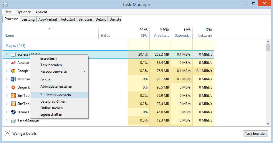

  6. value1
    Jan 9, 2011
    2,192
    Zug, Switzerland
    14,262Coins
    +3,361 / 12 / -1
    "…\Steam\SteamApps\common\assettocorsa" is the right path.
    Please run the Windows Task Manager (with Ctrl-Alt-Del) and check the name of Assetto.
    Under "details" you should find a entry acs.exe.
    Can you confirm?
  7. leonaikikai
    leonaikikai Member Gold Contributor
    Jan 27, 2014
    43
    45Coins
    +22 / 0 / -0
    when i launch the game and make taskmanager i dont see acs.exe but i see acs.exe in the file of directory of the game
  8. Nick Moxley
    17,057Coins
    +2,507 / 30 / -2
    You have to be On track for the acs.exe to be present. Sitting in the menu doesn't do it. weather thats the problem or not, Not sure.
  9. leonaikikai
    Jan 27, 2014
    43
    45Coins
    +22 / 0 / -0
    ok i go check this but the problem is that game engine and game manager dont change color (to the blue) when i launch the game asseto corsa
    with onother game , game engine and game manager change color (go blue)
    thank for your help

  13. leonaikikai
    Jan 27, 2014
    43
    45Coins
    +22 / 0 / -0
    Big thanks guys , asseto run i dont understand that the simu work only in race so i'm sorry .
