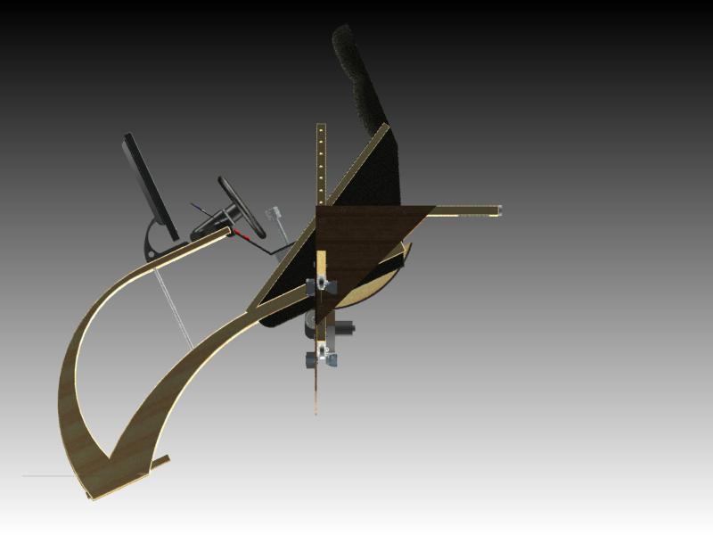

    Pitch forward is 26 degrees
    pitch backwards is 36 degrees
    Roll angle is 36 both ways.
    In theory its possible to make the roll all the way around for the high sensation seeker :D
    The challenge is pitch forward. It might be posible to make this angle range higher, but the seat itself limits it, and the whole plattform then has to be higher abowe the floor.

    I would really try to get the same movement range in all directions. If you think about it, in any car you will have greater breaking forces than acceleration forces, therefore the forward pitch will always be greater in maximum magnitude.
    If you brought only the seat (pitch axis) a bit forward and maybe a little bit upward relative to the roll axis rails, you could have more motion out of it. You can also adjust the bottom where you put your foot and the pedals for a bit more clearance to the ground.
    With your setup I am pretty confident that you can get more sideways movement as well, I would aim at 45deg, then see if it is practically doable.
    Robert, he plans to use drive belts and rollers with teeth, like in a car engine. There will be stress and some stretch, but not that much to cause problems. The whole sim will be balanced fairly good too.

    It looks like you intend to use 3/4 inch plywood (19mm) for a majority of the build. It seems like the pitch frame is very narrow in two spots. The frame right by the seat going down to the pedals and right behind the table for the monitor and steering wheel. I think that the stress might be to much for these points, especially during game play. You might want to do some tests on those parts of the design.

    Thanks folks for all inspiring and constructiv replies. I have little time nowadays to start build, so its only some late evenings available to make drawings. i will try to see if I can make a plan for more pitch movements forward. A relative of mine is a carpenter so I have good access to free wood materials and tools for it right where I live! I have not made to mutch attention to dimensions yet, so there might be some changes. The light coloured material is laminated wood (I can make this myself) The darker colored material is plywood (laminated) I agree some points it looks narrow. Laminated wood can be wery strong though. The front part of the inner frame only need to hold weight of the legs, but of course the steering wheel need some strong support.

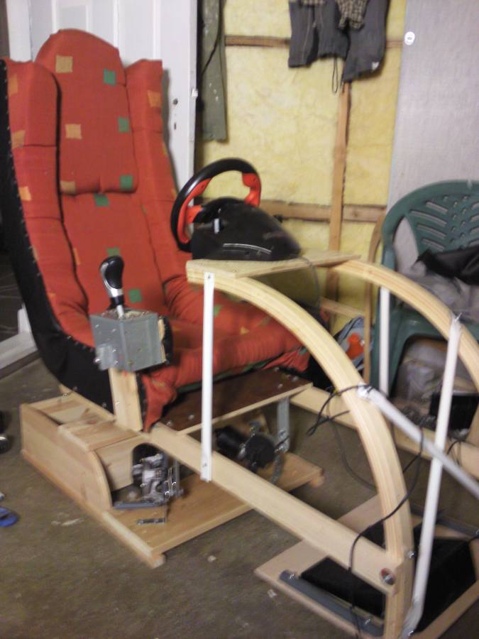

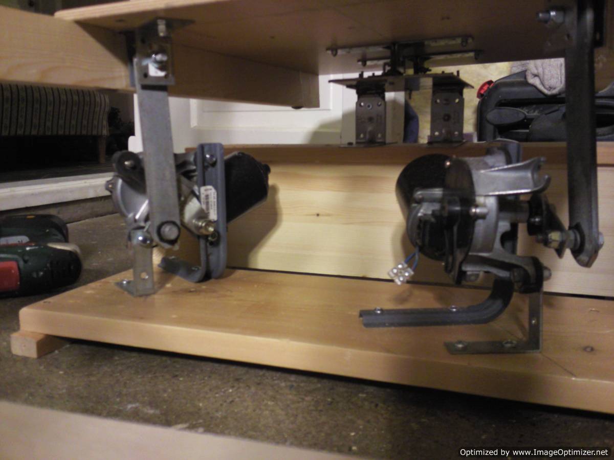

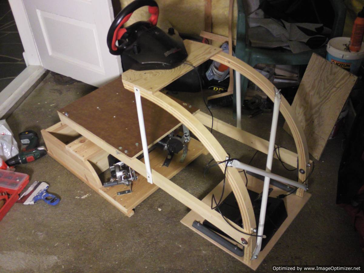

    Time to show some work in progress. I have build the rig now, and I want to post some pictures before I continue, to show the materials I have used. The rig will now get a paint job. I must do some adjustment before its ready for real testing. The next step is mounting potentiometers. I have made pivot as 2dof-simple-wipermotor-chair-by-ua6aak-t2512.html did, but the angels I used must be replaced by stronger ones, because there is a litle bit unwanted rotation. The rod between motor and seat are just ordinary metal rods, and no ball bearing. I support them with rubber spacers, and hope this will work. The seat can be adjustet forward and baccward with loosing some screws, so its easy balance it on the pivot. Credits to ua6aak and Deriy for ideas. Happy for all kinds of useful comments! :cheers:[ Bilde1077-Optimized.jpg Bilde1079-Optimized.jpg Bilde1076-Optimized.jpg

    So far so good!
    I wouldn't worry about the paint job as of yet. I'm sure you will modify it very soon.
    For power supplies you can get a standard PC power supply, look for +12V rails. 25-30A for each motor should do the job, you have to see how bad the load is.
    Other alternative is car battery. You can charge them with a smaller 12V power supply.
    MAKE SURE TO FUSE A BATTERY!!
