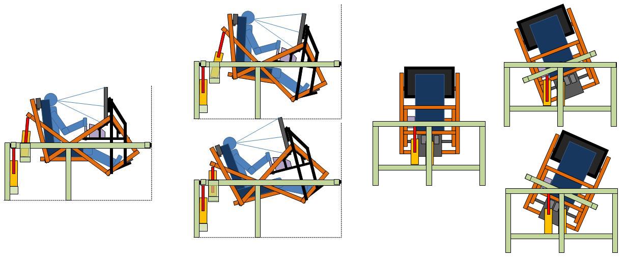

    The idea about joyrider is to make it balanced, so that it will need less force to move. In a prototype I think is a good idea to make the pivot points adjustable. I want to use laminated wood and as small dimensions as posible to make it lightweight. I dont know if i will manage to make it work before I have tried. I will use thin spruce planks and glue them together. Wood can be a strong material if you use it right, and I am trying to find a construktion that is as simple as possible. Ideas are welcome! 8)
    You are welcome to look at my blog to see my plans so far!
    Have you built your construction yet?
    Fred

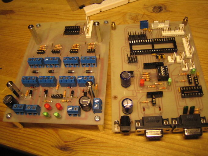

    Now I am almost finnished soldering H-bridge and Amc, but some of the parts was missed in the order, so i must wait some more weeks for some resistors and capacitors :no: But as said before; this is a project that will need some time. this is the first time I solder a pcb, so it will be exiting when i am ready to test it. I wish i had a local store with electronics... IMG_0081_1_1_1.JPG

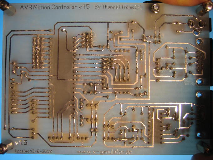

    Just a little update: I have done soldering AMC. The leds light up as they are supposed to, but I got the unknown device 24 error message in ponyprog when I tried to program the atmega 8535. I got some help from the forum to check connections, power and cables, an all of it seems to be right, but still unable to programme it. I have now ordered new parts and will solder a complete new AMC. It will be some weeks before there is any progress here!

    Hi Michael. I have tried a lot, and did get some help on the amc-topic-pages from page 76-82. http://www.x-simulator.de/forum/tro...ontroller-with-pwm-servo-output-t559-750.html This is the first circuitboard I have soldered (besides h-bridge) and I have little experience with electronics. So I believe its a good idea to solder a new in case of bad soldering. Before soldering a new one, I will try to replace the atmega. Have also ordered the atmega644 as I understand you have succesfully programmed. you I am using a com port in an older pentiumIII.

    Maybe you make a very high resolution photo from the back of the AMC Board an post it, perhaps someone could have a look on the soldering and find something. ;) .
    I have the ATmega644P but i think you better would take a ATmega644 (without P)

    In my blog http://4.bp.blogspot.com/_6MprTsBWm5Q/S ... -h/amc.JPG there is a higher rez picture of the soldering work on AMC. This is not the most beatiful soldering work in the world :blush: . One reason is because I placed a couple of components wrong and had to resolder, Easy to ruin traces on the pcb amc_2_1_1.JPG

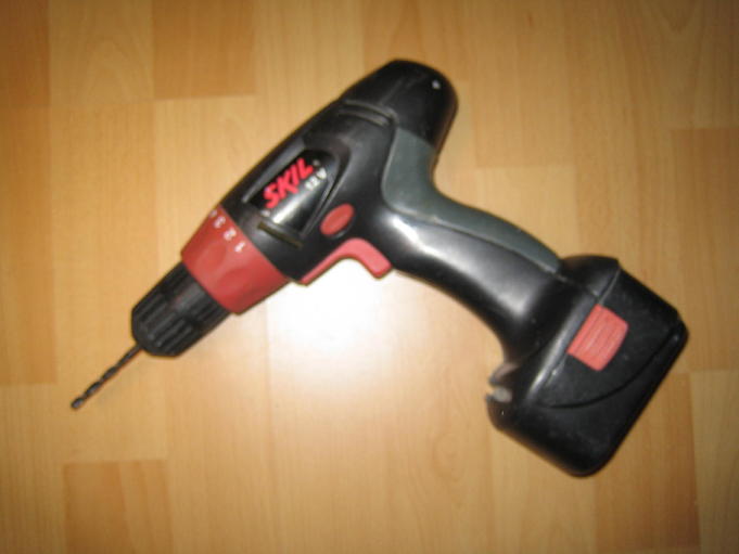

    I also have one question about motors: I have two battery drills that runs on 12v. Does anyone know if the motors in this can be used instead of wipermotors? and in case not, why? The reason for asking is that i I would like to use them as the batteries are ruined anyway (they were cheap) IMG_0146_1_1_1.JPG

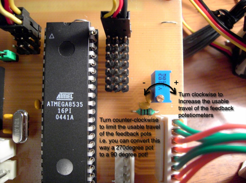

    Hello again :) My AMC finally is programmed! Look at AMC topic about what I had to do! Now I have assembled both AMC and DSMHB, and done a test with small dc-motors as Thanos recomend. The leds light as supposed to when i turn the pot. Red light only when no motor is connected and both red and green when motor is connected. I am really happy that it seems like AMC and DSMHB communicate, and i have posted a video of the first test on Youtube.
    Troubleshooting:
    The motor turns only in one direction as you can see in the video, and i see tre alternatives for that:
    -Wrong type of potentiometer ? (The type I have turns only about 300 degrees around)
    -something wrong with my h-bridge ?
    -Something wrong with programming/settings on the AMC
    Ofcourse i will read posts here and try to find the solutions, but if you have som ideas you are velcome to let me know
    BTW Thanos: Thankyou for sharing your boards. To me they look like art even before I have my sim up running. I will make a box for them, and I am thinking they should be in plexiglass or similar...like a juvel in a monter. 8)
    Fred
  19. tronicgr
    tronicgr
    -First check to see it you have this trimmer pot turned all the way clockwise.
    -Maybe one the mosfets on your h-bridge is bad and cant activated thus only one direction
    -Maybe you should check that you used correct resistors values on the DSMhb as proper values needed to turn on the mosfets.
    -Last check the connections, you may missing the a contact or have a loose connection on that pin for that direction.
    Thanos
