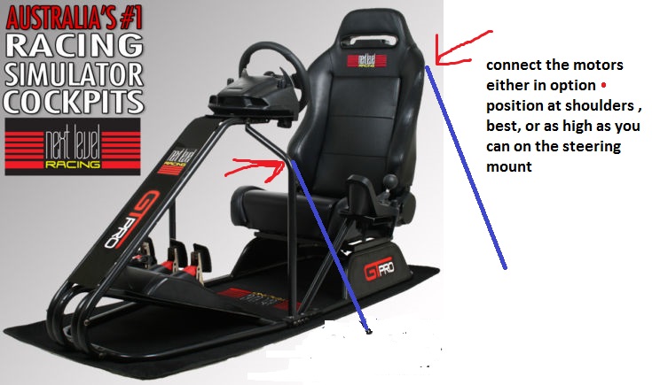

    Have not put together a frame as yet, however looking on ebay come across this:
    http://www.ebay.com.au/itm/Next-Lev...o_Game_Accessories&hash=item1c1e39f112&_uhb=1
    Was wondering if this frame could be used to fast track my project :) That way I only need be working on the motion side of the build.
    Thoughts?

    I am doing one for the playseat.. so Yes you can ..
    I'll have a board underneath my playseat and this board is on top of the swivel point..
    But I am doing a motor under the knee build.. No pictures as of yet.. waiting for my welded pivot point..
    So hopefully I can start a build thread soon, as I can use soe input here and there..
    Electronics, Arduino, Software, Motors, Pots etc are al there .. just need to get the swivel back :)
    But that Racing seat is a great one.. wish I had it :)
  19. bsft
    @Drewzy , @Michael Hensen
    refer to the picture, the best place to put the motor connections is a high as possible. I converted a frame like this for motion for a mate a while ago. I built another steel frame to go under it to support the whole thing, then balanced it on a pivot.
    We had to go shoulder mount at rear for best performance. That was using 25:1 boxes on the big worm gear motors. But he thought he needed 18 deg total throw (80mm ctc levers) and 25:1 boxes wouldnt move it, so we fitted 50:1 boxes to double torque. Problem solved.
    Mounting at or above the knees will work also, but remember, if its slow to move, you may need to consider bigger gearboxes . @Erwan960 found that out.
  20. Drewzy
    Drewzy New Member
    Apr 7, 2014
    Perth W.A
    492Coins
    Thank you so much for the heads up here :)
    I'm currently putting together my parts list after trolling through the forum, to get the "OK Dear" from herself :)
    Your info on positioning and choice of best worm gear motors in invaluable... Thank you
