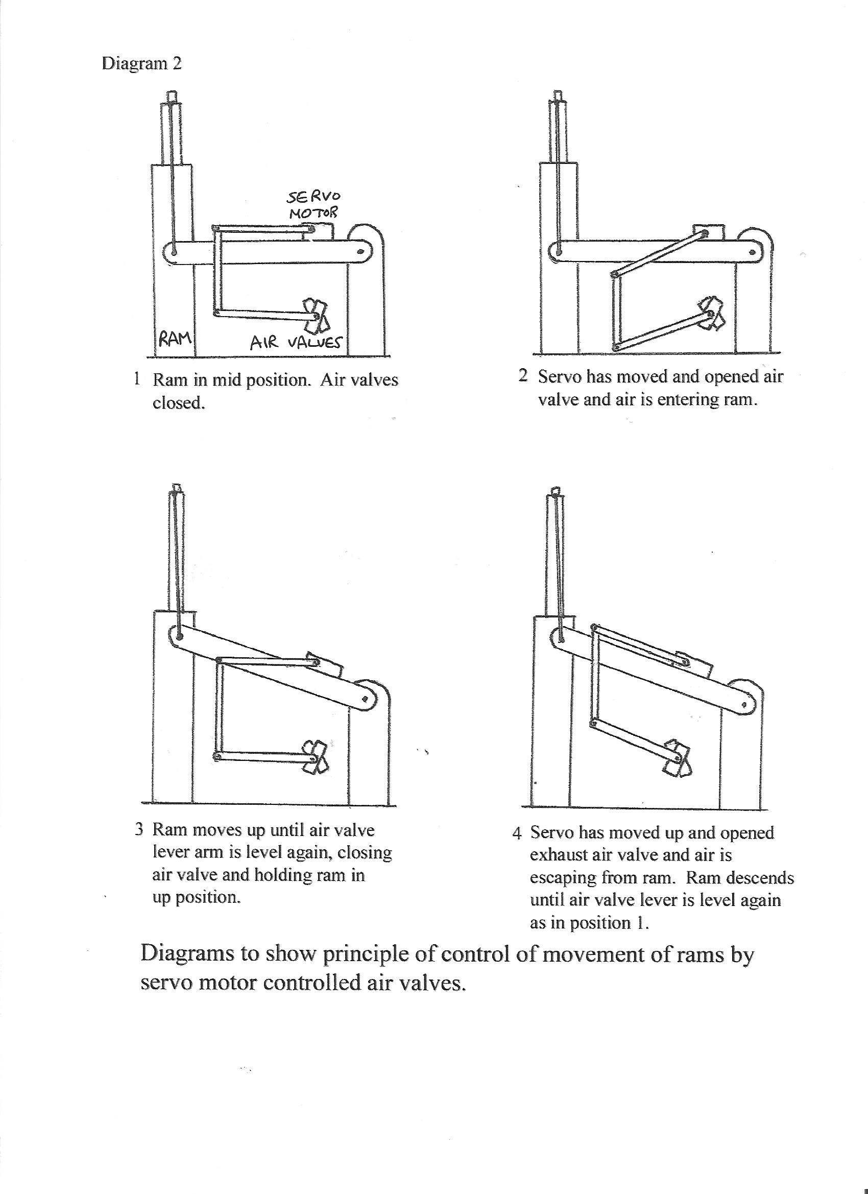

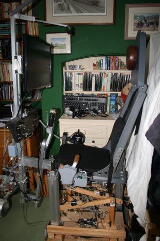

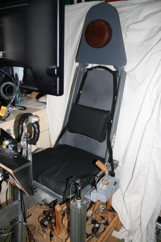

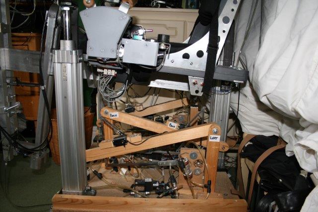

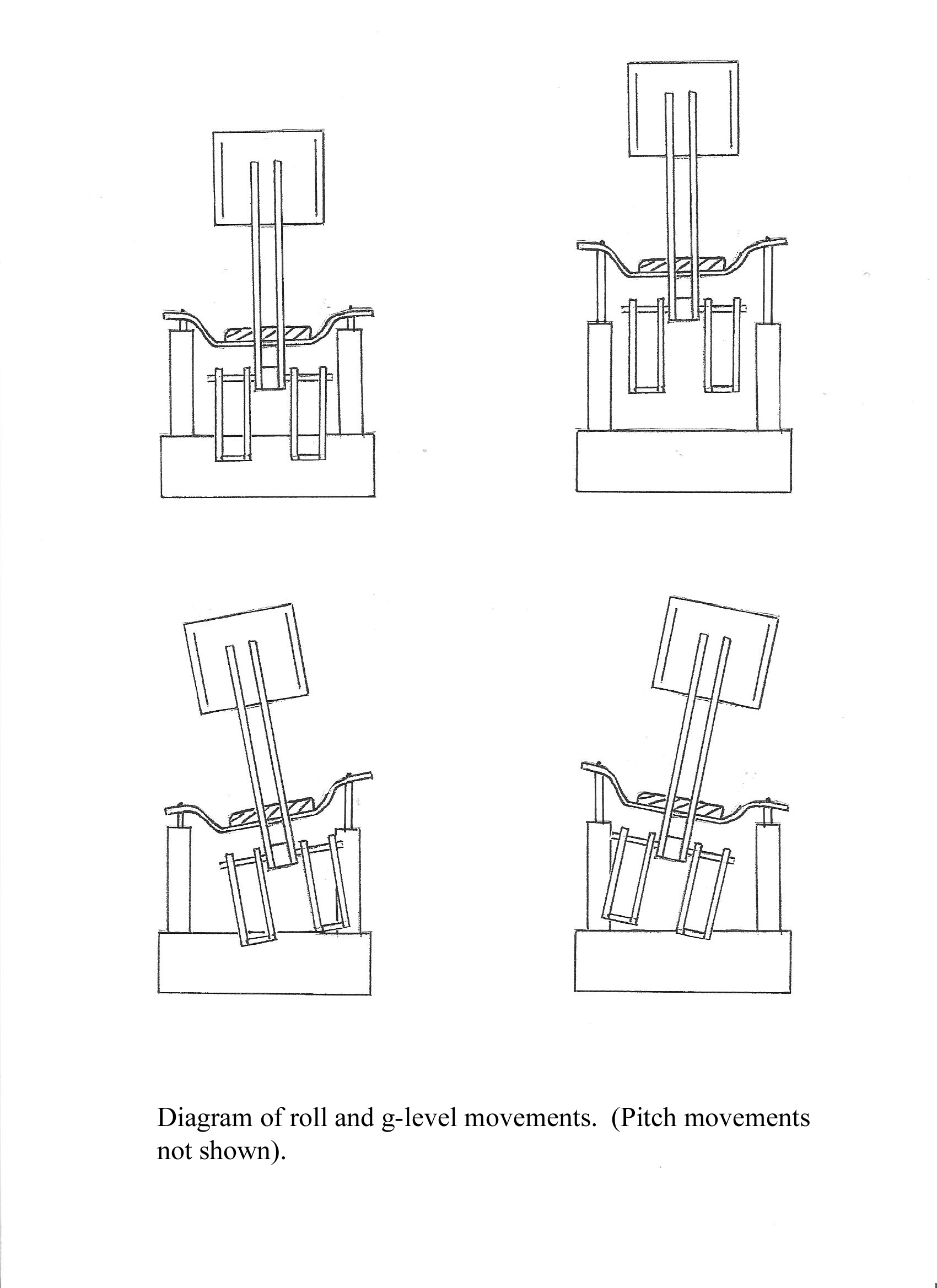

    Diag 3 001.jpg Movements-001.gif 10226 10226 10226 10226 10226 10226 Hi, thanks for your offer to help guide me with driving my servos in Cliffs of Dover and DCS. The Pololu Maestro boards look just the job. Which one do you think would suit best? I hope eventually to run 6 servos, which leads me to my next question: Will it be possible to have a servo driven by airspeed? Also, in a perfect world, I would like a servo which is driven by aileron position and one driven by elevator position. If this is not possible I can work around it, but airspeed is necessary as I have a control column which increases in resistance the faster you fly. I am posting some schematics of the way the power rams are driven and some photos of the seat as it is. Sorry it looks so cluttered, but it is rather cramped and not easy to photograph.

    I use a Arduino to control the servos, easier to set up but the other is usable indeed.
    mmm getting to right values out of the game is a wee bit tricky,
    Cliffs over Dover plugin provides pitch, roll, yaw and surge, sway, heave. so we could drive the servo via these.
