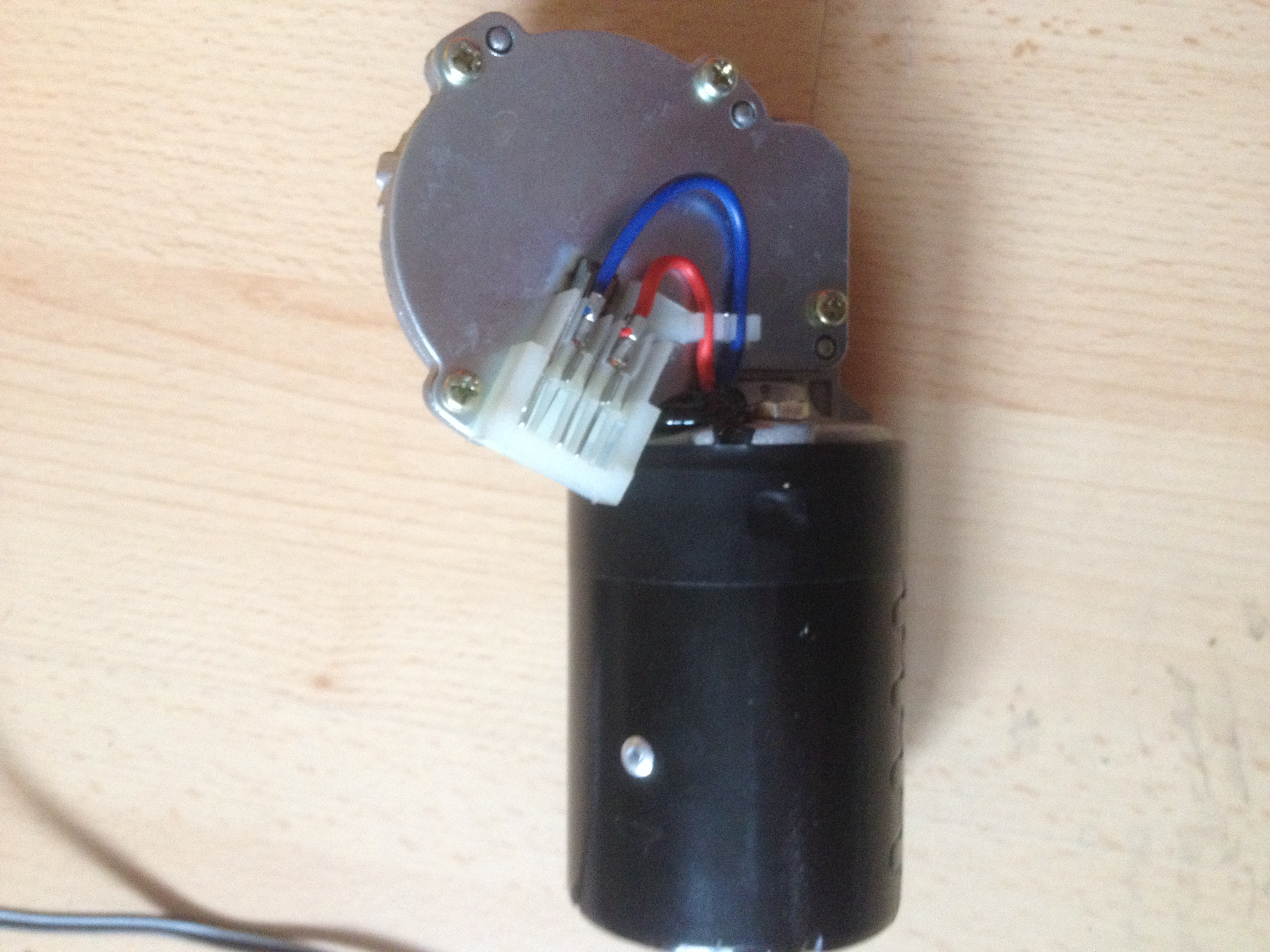

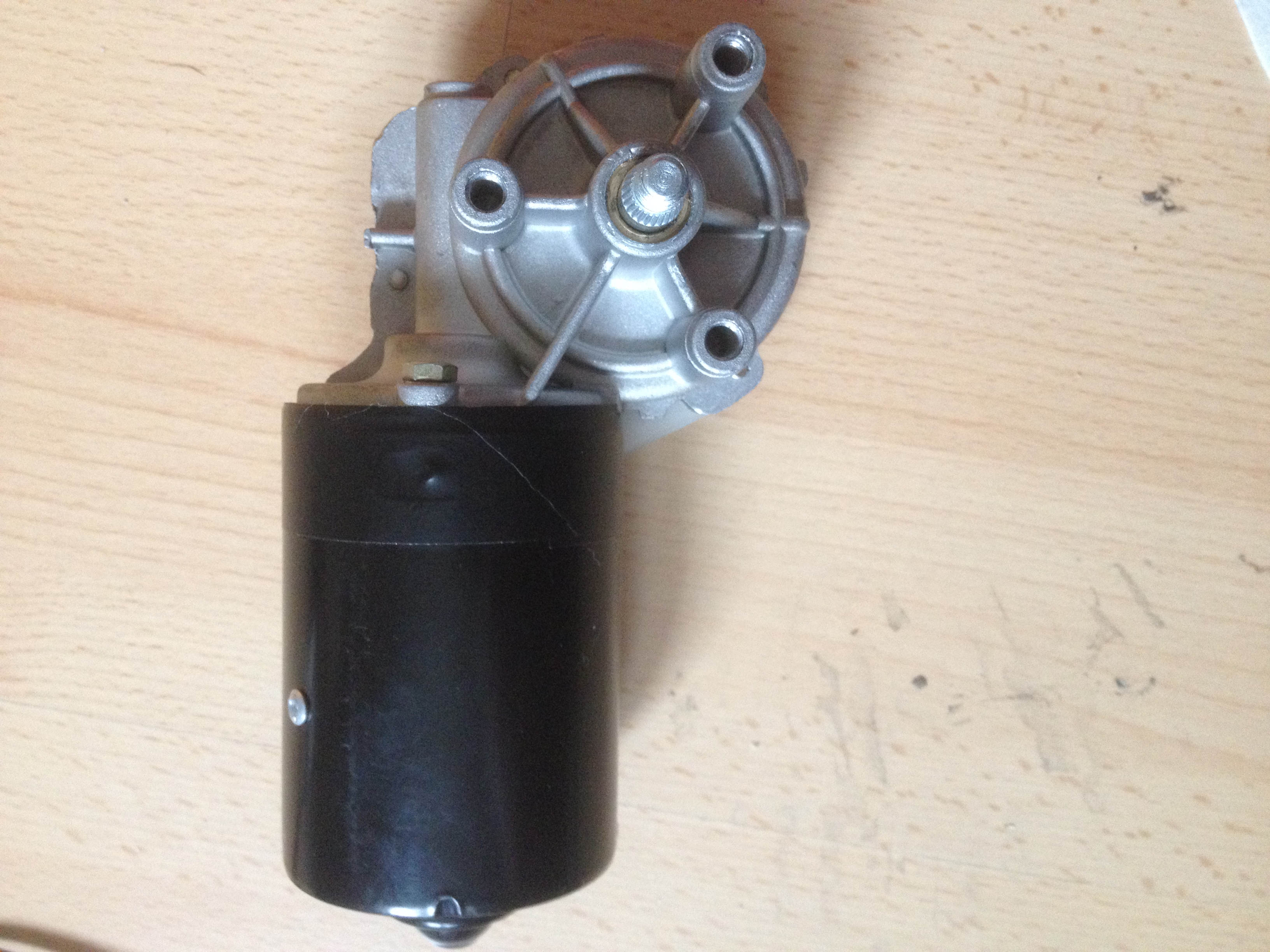

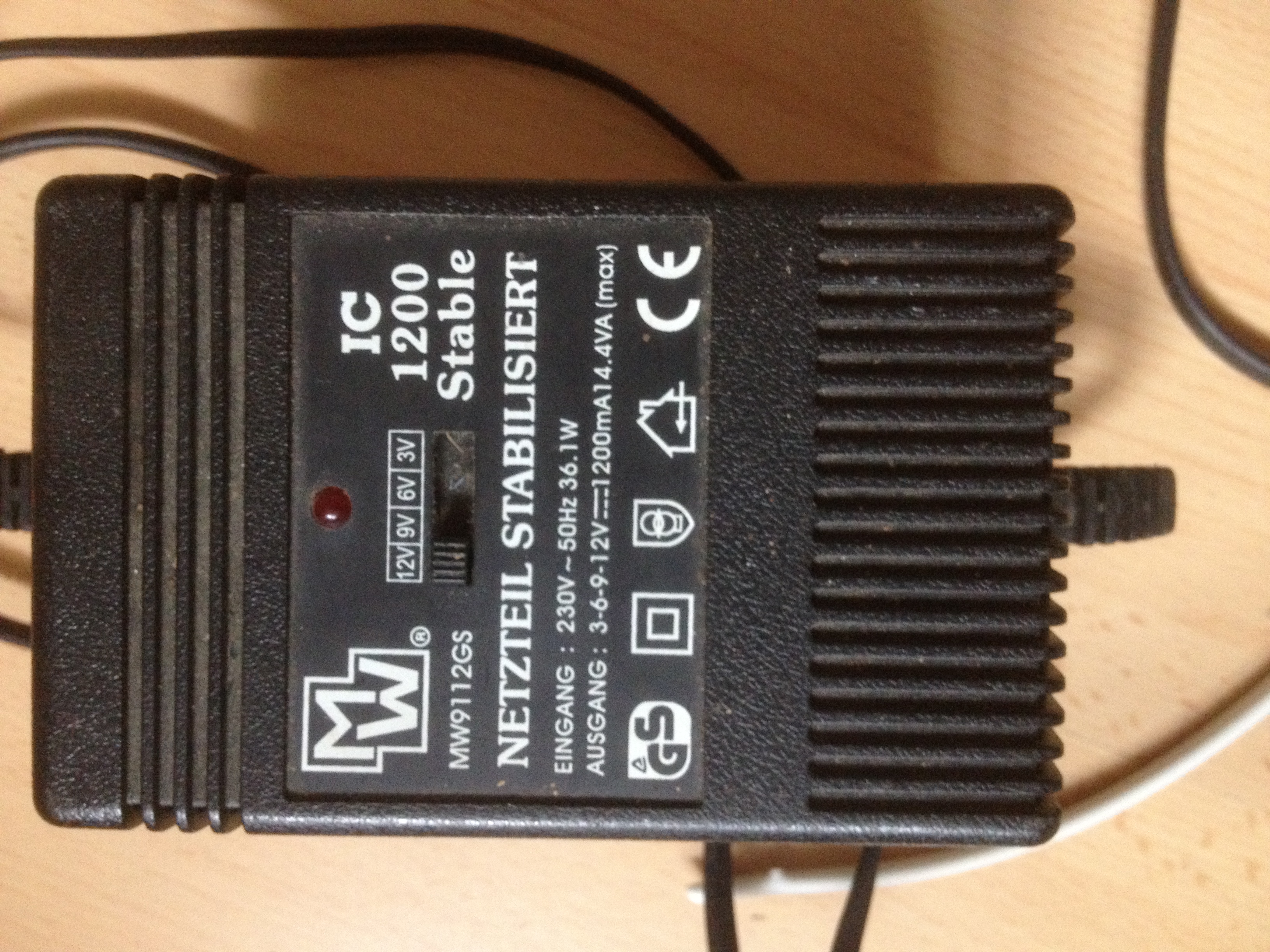

    I got my 3 JRK`s and my 3 wipermotors for testing today.
    i have a transformator or something like this, can i use it for a little testing?
    Only want to connect and test it with the jrks to see the motor running ?
    These are the Motors:
    sorry, to large images..
    [fixed, rgds, value1]

    The "Stromaufnahme bei 12 V" is only about 1,2 A which results in only about 15 W. This is by far too low to move anything. You will need like 200+ watts per motor for a sim. But, well, for that price… You can use it for testing purposes or so.

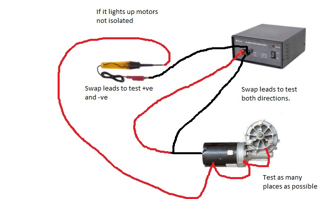

    beware of wiper please make sure the earth is isolated from the body of the wiper, or if you mount it on a steel frame when the motor goes in reverse , it sends a positive voltage through the earth, anything else electrically earthed to this frame now has 12v+ flowing through it. BOOM, fry. not good please check them.
  16. bsft
    Should be fine but make sure wipers are earth isolated , or you could blow the JRK to hell.
    Look at the photo, test to find if the motor is earthed to the case and fix it.
    Just one of the reasons I dont use wipers anymore, earth isolation issues. testing motor.jpg

    i read about it. I`ll let check that a friend of mine, he is a Master in electronic.
    Thank you
  20. eaorobbie
    20,506Coins
    +1,687 / 23 / -2
    Yes its an important step a lot of people miss. Can result in failure or motors and drivers doing unexplainable things.
