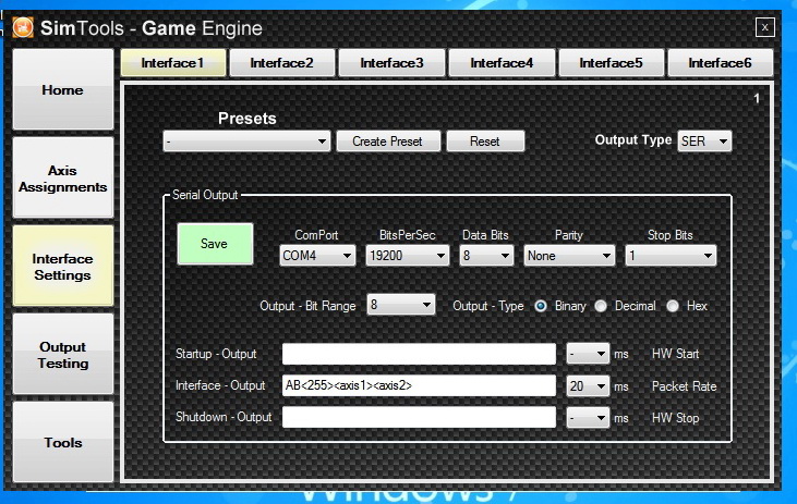

    Hi, Hooshang. You do not need to use startup and shutdown data
    Only set correct Baud for used firmware.

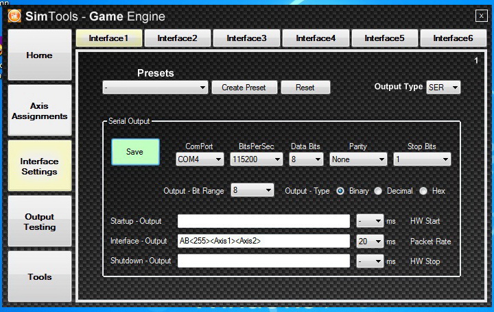

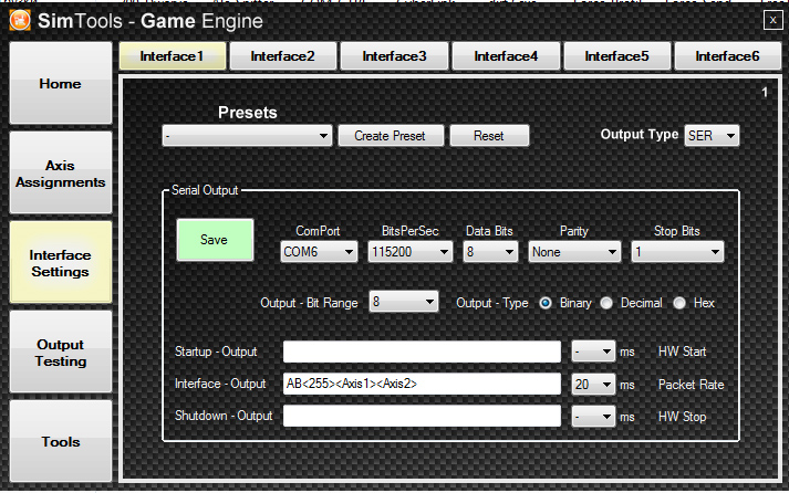

    @eaorobbie
    hi freind
    app? if you mean Xloader,yes i programmed my Arduino(Prilad code) with it.
    if somthing eles,i donno
    and here is my interface settingas Prilad said:
    thank you
    Hooshang
  16. prilad
    Apr 29, 2012
    380
    Dubna, Russia
    9,666Coins
    +513 / 1 / -0
    3DOF, DC motor, Arduino, 4DOF
    Why you set 115200 baud rate? You should set Yours Firmware Baud Rate (28800 or 19200)

    I'm not sure, but may be it can be important to write <Axis1> (with a capital letter) instead of the <axis1>.
    Xloader
    have upload firmware with BoudRate 115200 - for UNO its wright. But SimTools should be configured with BaudRate which used in Firmware.

    Eaorobbie said about the presetting with an app ?!
    Could you please tell What is he talkin about?
    Thank you
    hooshang
  20. eaorobbie
    20,503Coins
    +1,687 / 23 / -2
    Extracted from @prilad post on the firmware, not sure where the download is for it anymore.
