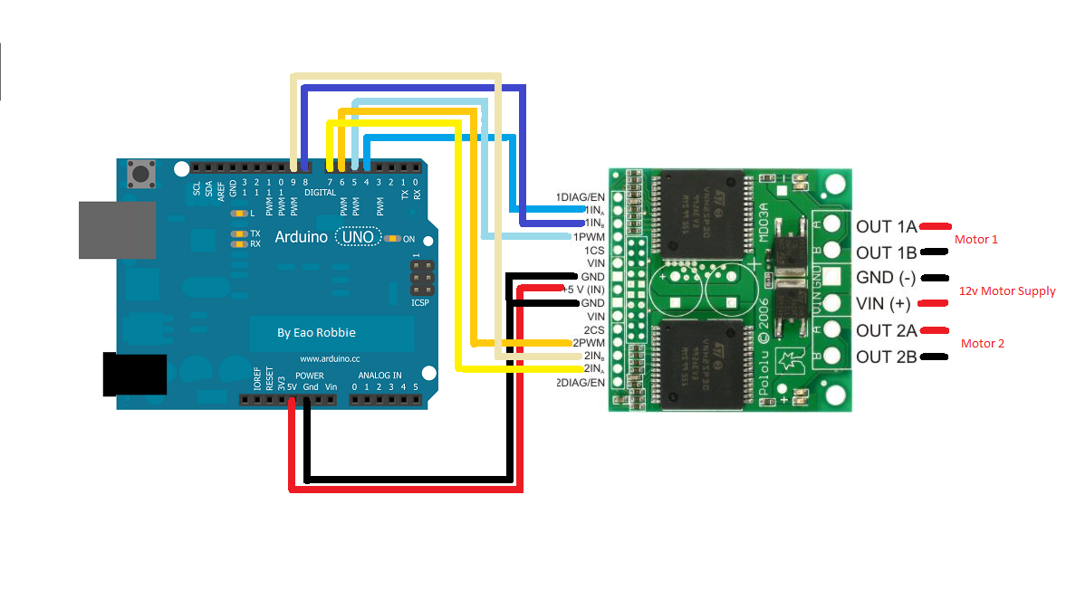

    hello freinds
    after having some problem with setting Thanos amc 1.5 with simtools,
    and plan to upgrade staff,finally i recieved my Arduino uno
    board,as i already have pololu vnh2sp30,can anybody help
    for wiring to connect them,
    thank you & regards

  10. eaorobbie
    20,400Coins
    +1,683 / 23 / -2
    This is what was posted not really a diagram of such, but pin out info.
    Arduino /..Motomonster1
    ......GND <-> GND pin
    ........5V <-> 5V
    .....pin 4 <-> pin 4 inA motor1
    .....pin 5 <-> pin 5 pwm1
    .....pin 6 <-> pin 6 pwm2
    .....pin 7 <-> pin 7 inA motor2
    .....pin 8 <-> pin 8 inB motor1
    .....pin 9 <-> pin 9 inB motor2
    such as Motomonster:
    Beware error in pin out found by @hooshang refer here:
    http://www.xsimulator.net/community/threads/arduino-uno-wiring-diagram.4908/page-2#post-47579

    Imho Helpful for people who do not know which pins must be connected together.
  12. eaorobbie
    20,400Coins
    +1,683 / 23 / -2
    Nice picture would have helped him more and others.

  14. hooshang
    hooshang Active Member
    Jul 6, 2011
    272
    289Coins
    +157 / 3 / -0
    its not all about the sketch
    Arduino is the open source board so first should know
    about program going to be load on atmega 328 and then make related wiring diagram.now we have the file HERE (thank you Mat)
    and a good freind here(eaorobbie),so it can be done..
    regards
    Hooshang

    I didnt mean it serious @eaorobbie nevertheless, the sketch looks really good.

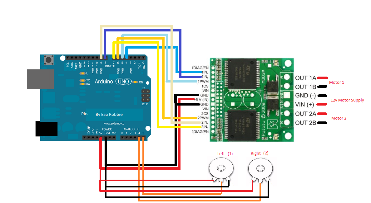

    and where the pots are?
  18. eaorobbie
    20,400Coins
    +1,683 / 23 / -2
    Not a problem thought I would add one for the driver that was actually asked for. Its there and @RacingMat can post it into his write up or even @hooshang can, there for everybody now. I actually have tested this driver to 30amp limits and it performs well, even if I had tested with the K8055 ages ago. I still have it.
    I will add the pots tonight mate then suppose its a complete schem. for the Ard Boys.
    Sorry I should have done that last night.

  20. eaorobbie
    20,400Coins
    +1,683 / 23 / -2
