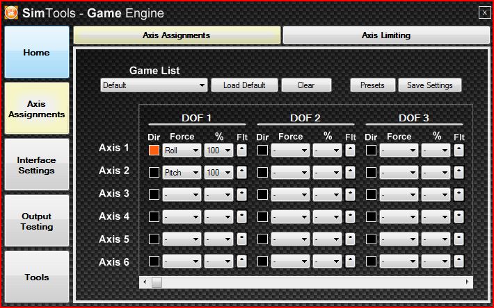

    Also, in your guide, I see your axis assignments were populated as follows:
    What would happen if I configured as follows:
    I will have some servos soon so I will be able to test then but am not 100% as to how to interpret the axis assignments table. If we have two servos, we have two axis. If we use Roll and Pitch, we have a 2 DOF Sim right? So we have 2 DOF associated with 2 axis, but we only populate the DOF1 column. Seems a little odd.
    I must be over-thinking things here.
